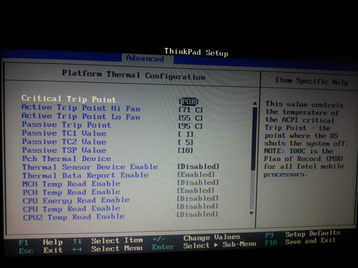

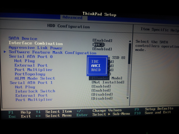

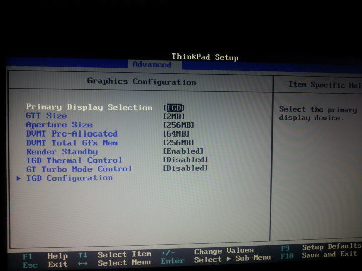

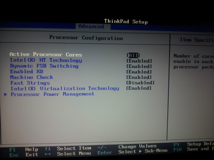

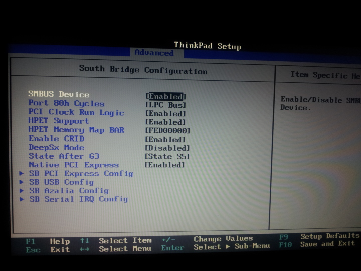

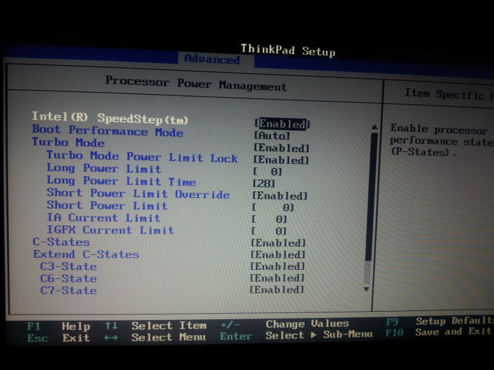

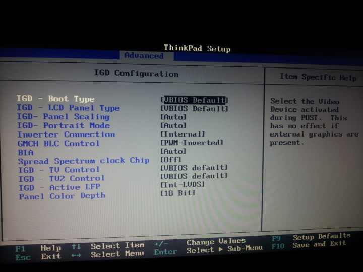

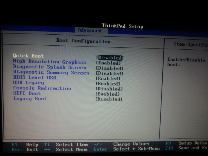

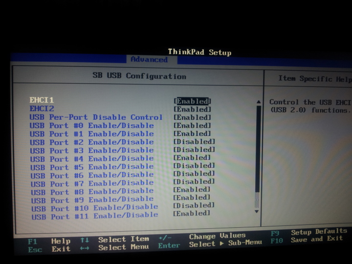

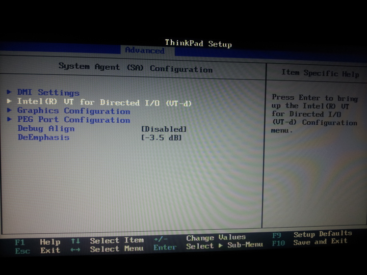

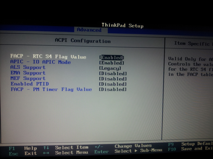

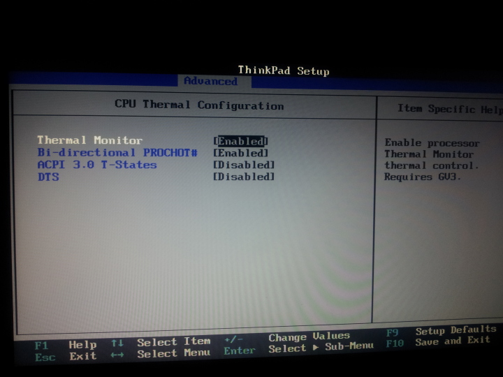

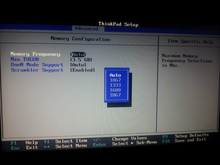

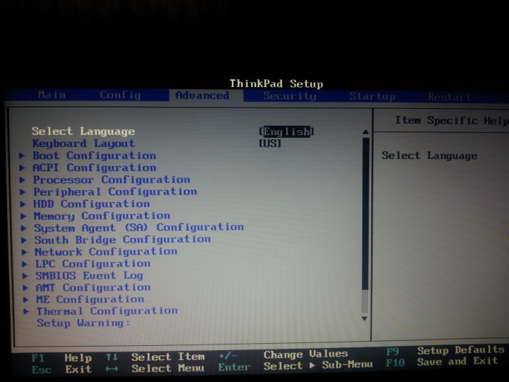

gromalle Posted August 19, 2016 Share Posted August 19, 2016 Just updated BIOS to 1.46 custom (whitelist deleted, Advanced menu available with a lot of settings) with fresh Intel VBIOS 2170, so with this bios I got high resolution Clover boot menu, OS X boot process (and Linux boot process). (link) Check out some advanced settings: 1 Link to comment https://www.insanelymac.com/forum/topic/285678-lenovo-thinkpad-t420-with-uefi-only/page/108/#findComment-2267831 Share on other sites More sharing options...

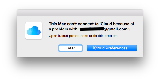

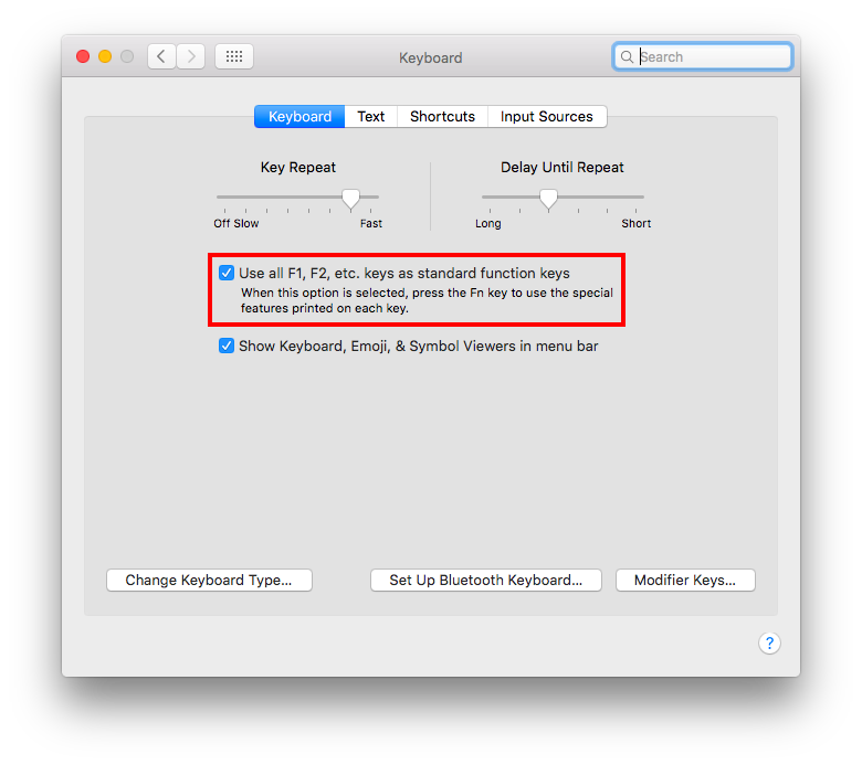

XSmile2008 Posted September 4, 2016 Share Posted September 4, 2016 Hi. How can I disable or enable touchpad now? I tried Fn+F8, F8, PrtSc, nothing of this combination worked. Also sometimes I have problem with iCloud (something with NVRAM?). After reboot i see message like this "There problem with your iCloud account...". I enter my iCloud password and everything works good until I reboot. And one more question about kexts, I prefer kext injection by Clover instead of copying all kexts into system folders. What kexts I need copy on my HD? Only bluetooth and audio? Other kexts will be work good being injected by Clover? Link to comment https://www.insanelymac.com/forum/topic/285678-lenovo-thinkpad-t420-with-uefi-only/page/108/#findComment-2273746 Share on other sites More sharing options...
tluck Posted September 4, 2016 Share Posted September 4, 2016 @xsmile2008 - do you have Emuvariable.efi still in Clover? - that may interfere with the native NVRAM. - well the new key mapping changes the PrtSc function around with F8. so surprising it doesn't work. does F11 and F12 control audio? if you don't like the mappings you can easily change or remove them in the VoodooPS2Controller keyboard kext - Info.plist. - i don't know about which kexts work or not if they are just in the ESP. i guess you can see pretty quick if you don't install any in the /Library/Extensions. i keep a copy there just the Installer support. Link to comment https://www.insanelymac.com/forum/topic/285678-lenovo-thinkpad-t420-with-uefi-only/page/108/#findComment-2273956 Share on other sites More sharing options...
XSmile2008 Posted September 5, 2016 Share Posted September 5, 2016 I don't find Emuvariable.efi in my CLOVER forlder. When I installed updated zip I delete old BOOT and CLOVER folders, so there no old files left. About touchpad: F8 works only if I uncheck "Use all F1, F2 etc as standart function keys". But in real Mac's if I use this all functions are usable by Fn+F1(F2, F3...). Link to comment https://www.insanelymac.com/forum/topic/285678-lenovo-thinkpad-t420-with-uefi-only/page/108/#findComment-2274207 Share on other sites More sharing options...
