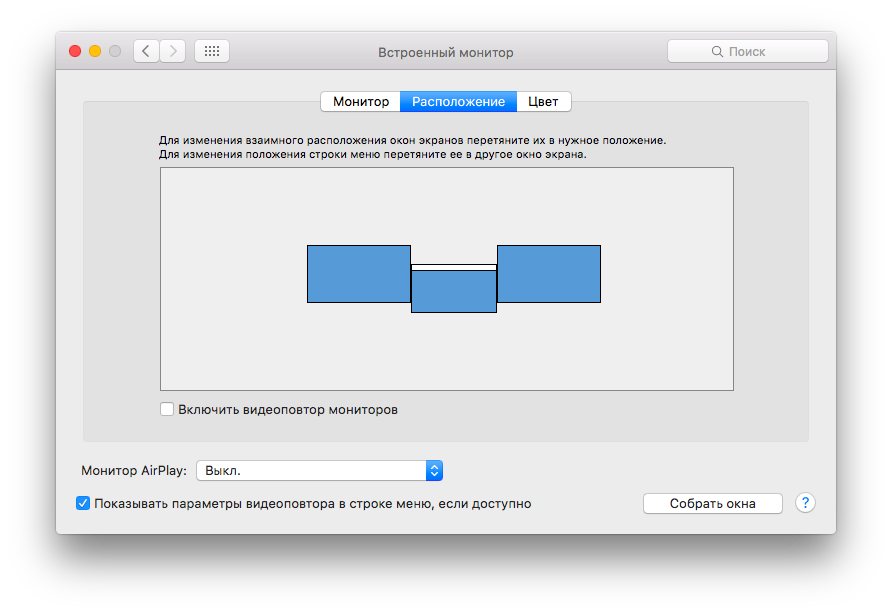

XSmile2008 Posted July 18, 2016 Share Posted July 18, 2016 Hi! I have problem when I try connect two external monitors. First monitor I connect via VGA and after sleep->wakeup cycle it works great. Second monitor I connect using DisplayPort->HDMI adapter. It also works great, but only if I not connect VGA monitor. If I connect two monitors in same time none of them work, just black screens, but they shows in settings. Link to comment https://www.insanelymac.com/forum/topic/285678-lenovo-thinkpad-t420-with-uefi-only/page/106/#findComment-2254089 Share on other sites More sharing options...

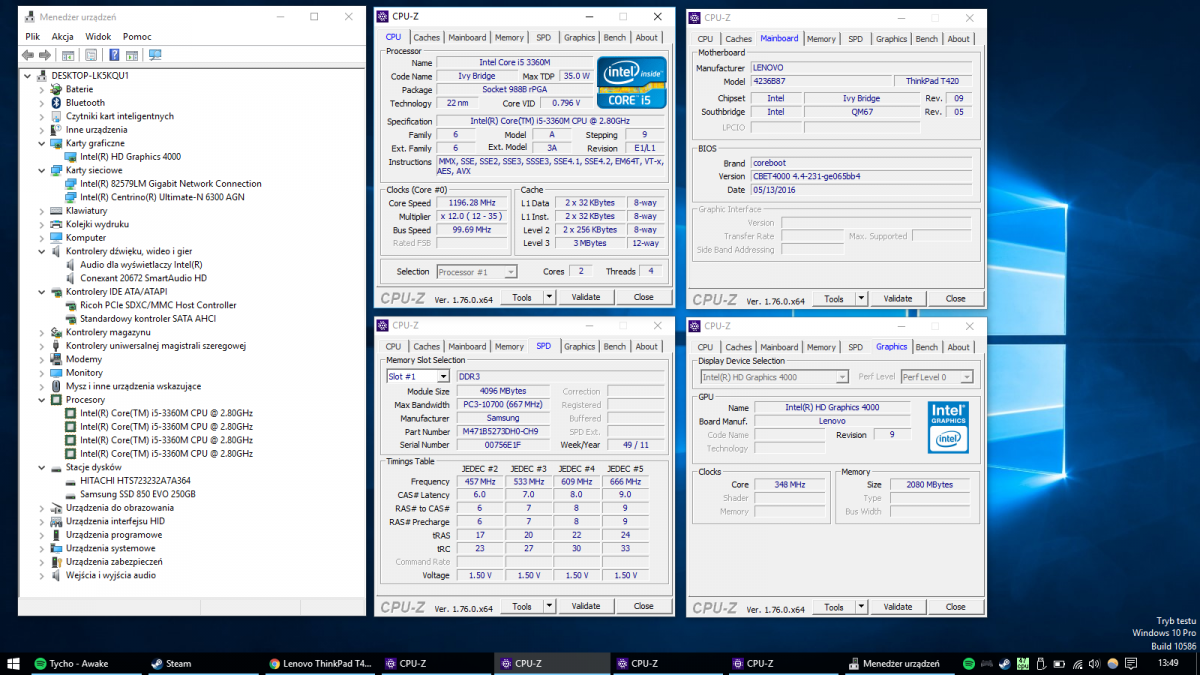

entrixo Posted July 18, 2016 Share Posted July 18, 2016 Here's some info on Coreboot on the T420: https://www.coreboot.org/Board:lenovo/t420 Beyond that, the talk is kind of spotty. There's this thread discussing Ivy Bridge (IVB) on the T420: https://www.bios-mods.com/forum/Thread-Lenovo-T420-Ivy-Bridge-Support-i7-3540M There are multiple sources speaking of Ivy Bridge support, including this: http://comments.gmane.org/gmane.linux.bios/81825- but not a lot of people appear to have actually done the mod. I am actually one of the few that flashed coreboot on their T420. I do have an Ivy Bridge CPU in it. Unfortunately, Clover insta-crashes but Chameleon seems to work OK. I haven't been able to get OS X running since I lack the time to mess around with it, but if @tluck is interested I could mess around with it after I come back from holidays. Link to comment https://www.insanelymac.com/forum/topic/285678-lenovo-thinkpad-t420-with-uefi-only/page/106/#findComment-2254162 Share on other sites More sharing options...
