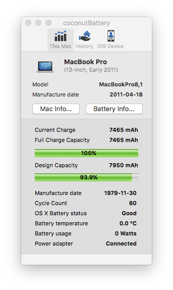

cydonia Posted September 27, 2016 Share Posted September 27, 2016 Here is a screenshot of my BatteryHealth app information. Apart from the obvious decay my battery has suffered, I am worried about the humungous battery usage (bottom of the image). This is what my thinkpad consumes while idle (I was using a different computer at the time). Link to comment https://www.insanelymac.com/forum/topic/285678-lenovo-thinkpad-t420-with-uefi-only/page/112/#findComment-2287314 Share on other sites More sharing options...
wijatka Posted September 27, 2016 Share Posted September 27, 2016 My battery usage is large too. After calibration my battery works about 1.10-1.20, so it is better. I see that after laptop restart the battery % power is even 40-70% smaller (on the newest ACPIBatteryManager):/ I installed older ACPIBatteryManager from the end of May, so let's see now. EDIT: On older ACPIBatteryManager after restarting it is ok. Link to comment https://www.insanelymac.com/forum/topic/285678-lenovo-thinkpad-t420-with-uefi-only/page/112/#findComment-2287320 Share on other sites More sharing options...

tluck Posted September 29, 2016 Share Posted September 29, 2016 a couple things to check and consider on the battery topic: 1) a laptop battery will degrade over time and will last 2-4 years - the T420 is 5 years old. 2) consider recalibrating your battery. 3) using 1800ma is not a battery problem but a system problem - i wondering what processes are running and consuming energy? 4) the ACPIbatterymanager kext is just reporting what values it finds on the battery. recalibrate will write new values for it to see/use. there is a debug version that will provide more info. Otherwise i suggest one to download a simple tool called coconutBattery.app it will show the "design" capacity of your battery vs current capacity. my T420 has a 6 cell batter with last night i recalibrate and got another 20% out of my battery charge ability went from about 82% of design capacity (7950 mAh) to 94%. so means about 1 more hour on battery. i replaced my battery about 2 years ago. so this is fairly new one. idle power usage is something like 8-10 watts with it full loaded: LCD, external monitor, SSD, internal disk, PCI card and 2 external disks . i will strip it down on the weekend and see what the basic power consumption is. Link to comment https://www.insanelymac.com/forum/topic/285678-lenovo-thinkpad-t420-with-uefi-only/page/112/#findComment-2288529 Share on other sites More sharing options...
cydonia Posted September 29, 2016 Share Posted September 29, 2016 I used Battery Health app to analize my battery, and squeezed an extra 10% battery; you can see my battery's info on the previous image. Is there any way to recalibrate the battery in OSX? I don't have a dual boot with Windows. Also my computer has massive battery usage while idle even after a fresh OSX install; with only Safari and a couple apps running (like battery health, popclip and bartender). Could it be something in the kexts? Link to comment https://www.insanelymac.com/forum/topic/285678-lenovo-thinkpad-t420-with-uefi-only/page/112/#findComment-2288641 Share on other sites More sharing options...

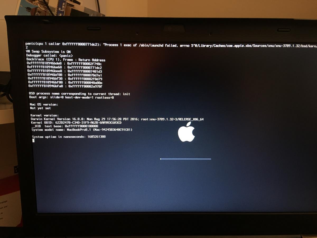

jus12 Posted September 29, 2016 Share Posted September 29, 2016 After few years with no issue after couple of days after migrating to Sierra I get this. Can I fix that withiut the need to install from start. Link to comment https://www.insanelymac.com/forum/topic/285678-lenovo-thinkpad-t420-with-uefi-only/page/112/#findComment-2288809 Share on other sites More sharing options...
