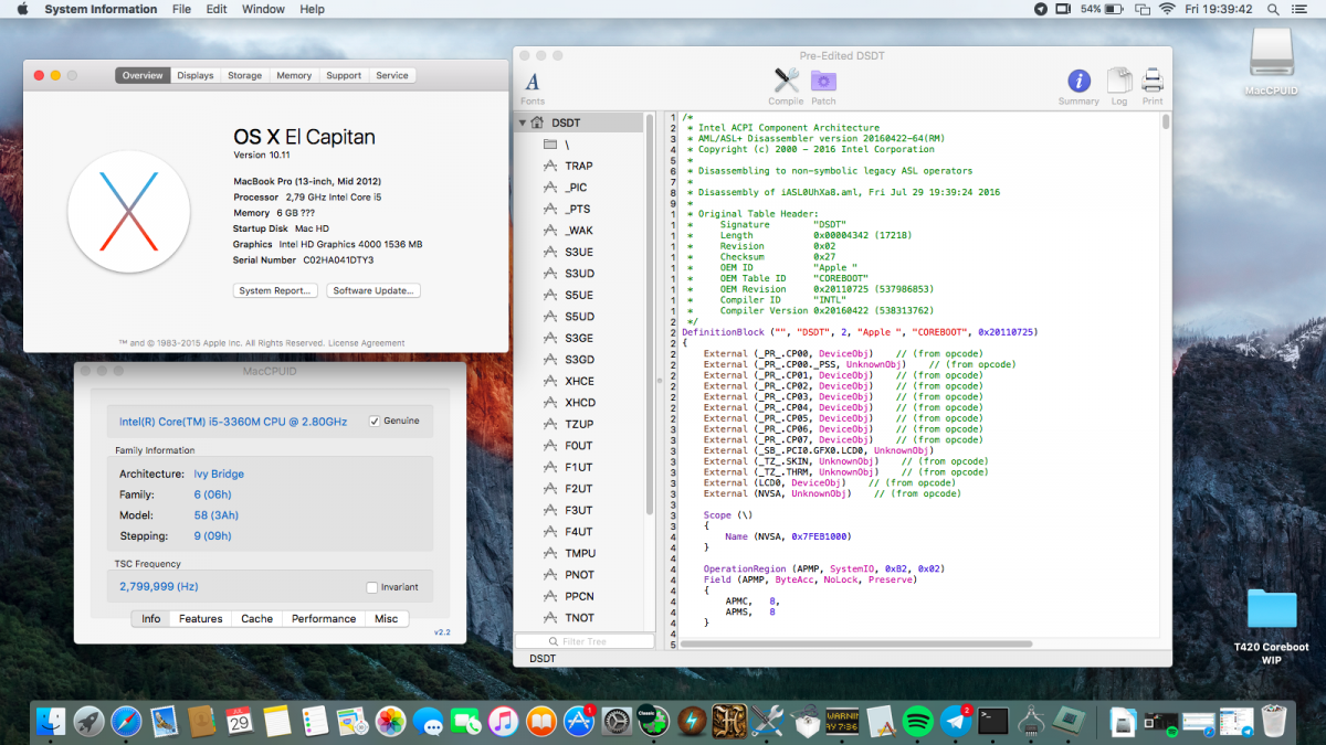

entrixo Posted July 29, 2016 Share Posted July 29, 2016 I got OS X working with coreboot with an Ivy Bridge CPU it's still a WIP though: USB needs fixing as only 2 ports work battery remaining time seems to be inaccurate (not sure though) the laptop wakes from sleep instantly last time I checked because of the USB. incomplete power management full backlight brightness at every boot Any help would be appreciated Link to comment https://www.insanelymac.com/forum/topic/285678-lenovo-thinkpad-t420-with-uefi-only/page/107/#findComment-2259765 Share on other sites More sharing options...

entrixo Posted July 29, 2016 Share Posted July 29, 2016 Use Rehabman's EHC1 to EH01, EHC2 to EH02 + USBInjectAll.kext for USB recognition, the uDP/Renesas USB 3.0 can only be used as a USB 2.0 with PXHCD.kext. Use Lenovo X220 (?) patch for battery. Use Rehabman's USB_PRW_0x0D patch for sleep problem ( remove XHC power management patch as yours isn't Intel ). Power management is due to AICPM and your generated SSDT, do not use -xcpm with M or QM CPU. Full backlight at boot can be something related to NVRAM not saving properly I'll try to get USB working following your tips The battery patch won't work - this is a completely new ACPI implementation of the entire system. (check out the coreboot github: src/mainboard/lenovo/t420 and src/ec/lenovo/h8) So should I generate an SSDT using ssdtPRGen and remove -xcpm? The NVRAM is emulated - unfortunately, the only way I could get an EFI implementation right now is through DuetPkg which is basically a floppy image that contains an UEFI implementation through BIOS (SeaBIOS in my case - it resides as a RAMDISK in my BIOS) Thanks for the tips, I'll try make some progress and I'll try to post my files as soon as I think it's stable enough (or someone asks me to upload it) EDIT: This is a T420, not a T430/T430s and I only have USB2.0 ports - no ExpressCard USB3.0 solutions either. Link to comment https://www.insanelymac.com/forum/topic/285678-lenovo-thinkpad-t420-with-uefi-only/page/107/#findComment-2259808 Share on other sites More sharing options...
