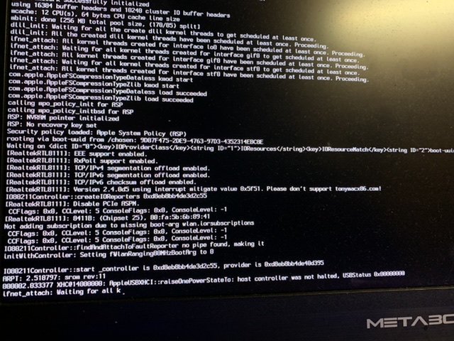

unfortunately I get similar result with beta 10 and clover.
If I boot non verbose I get a reboot but if I boot verbose my boot stalls and seems USB related.

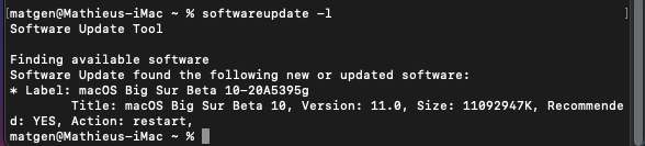

I read the Apple's Beta note. But Big Sur's SoftwareUpdate show other things. Strange !
I think Apple would still offer 11.0.1+ Update DMGs on the official site.
But yes, if we didn't solve this, Software Update would always download a full 11.0.1+ System Installer...

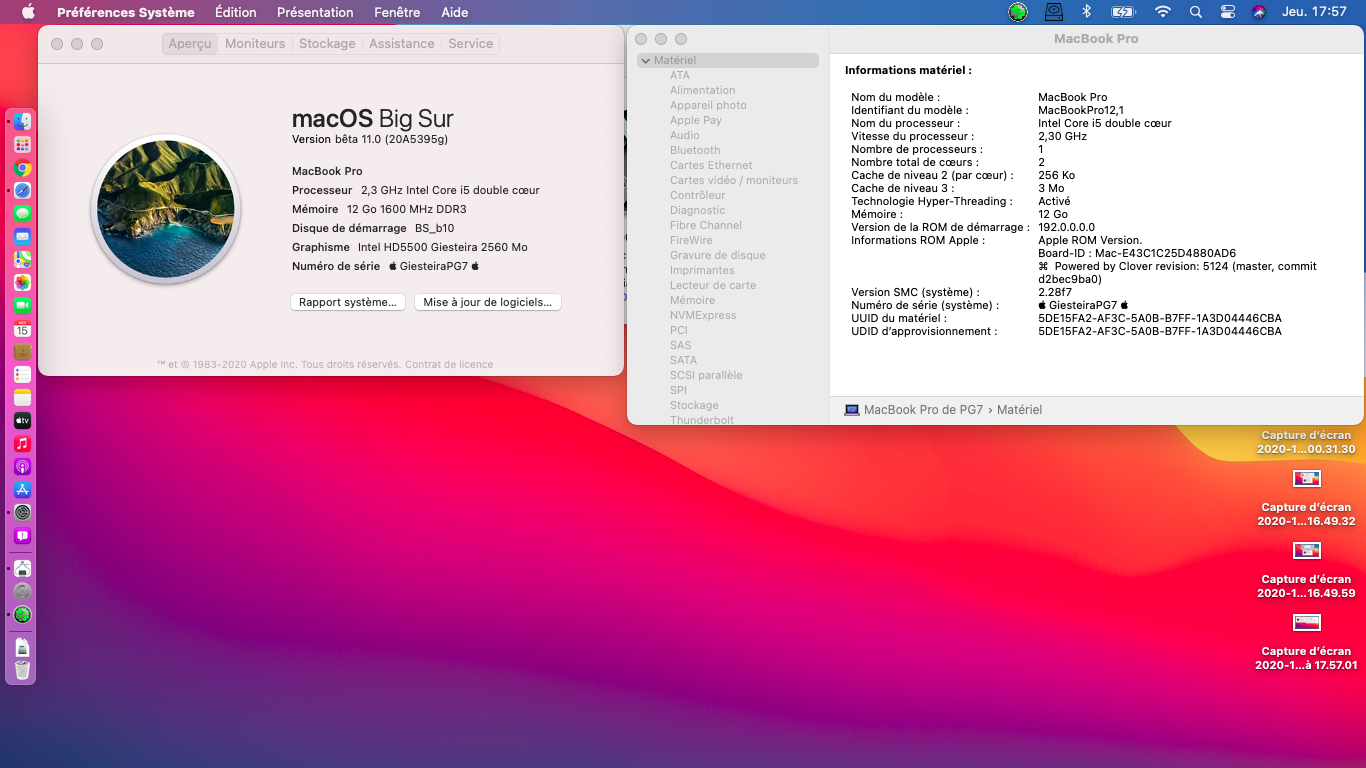

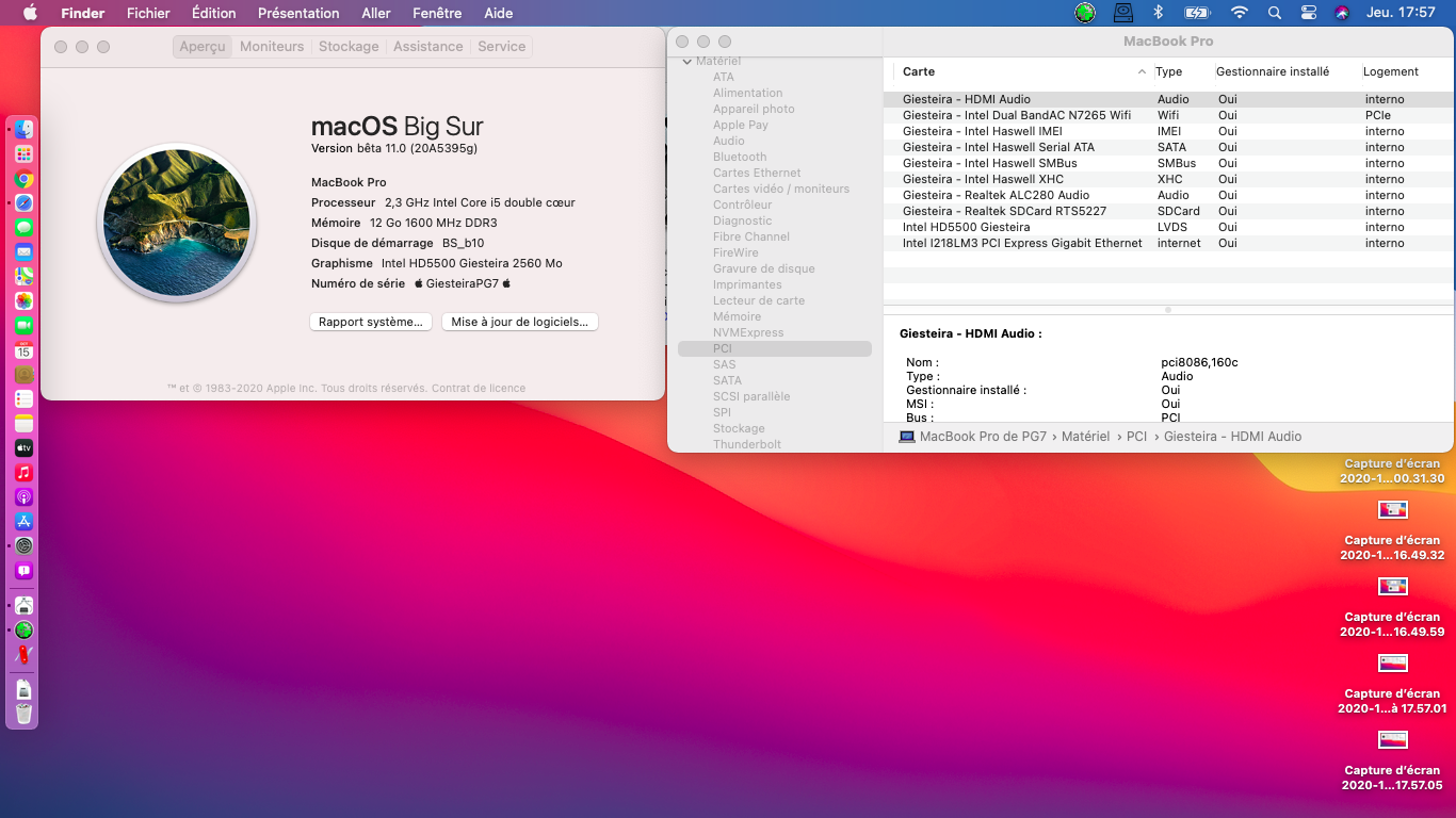

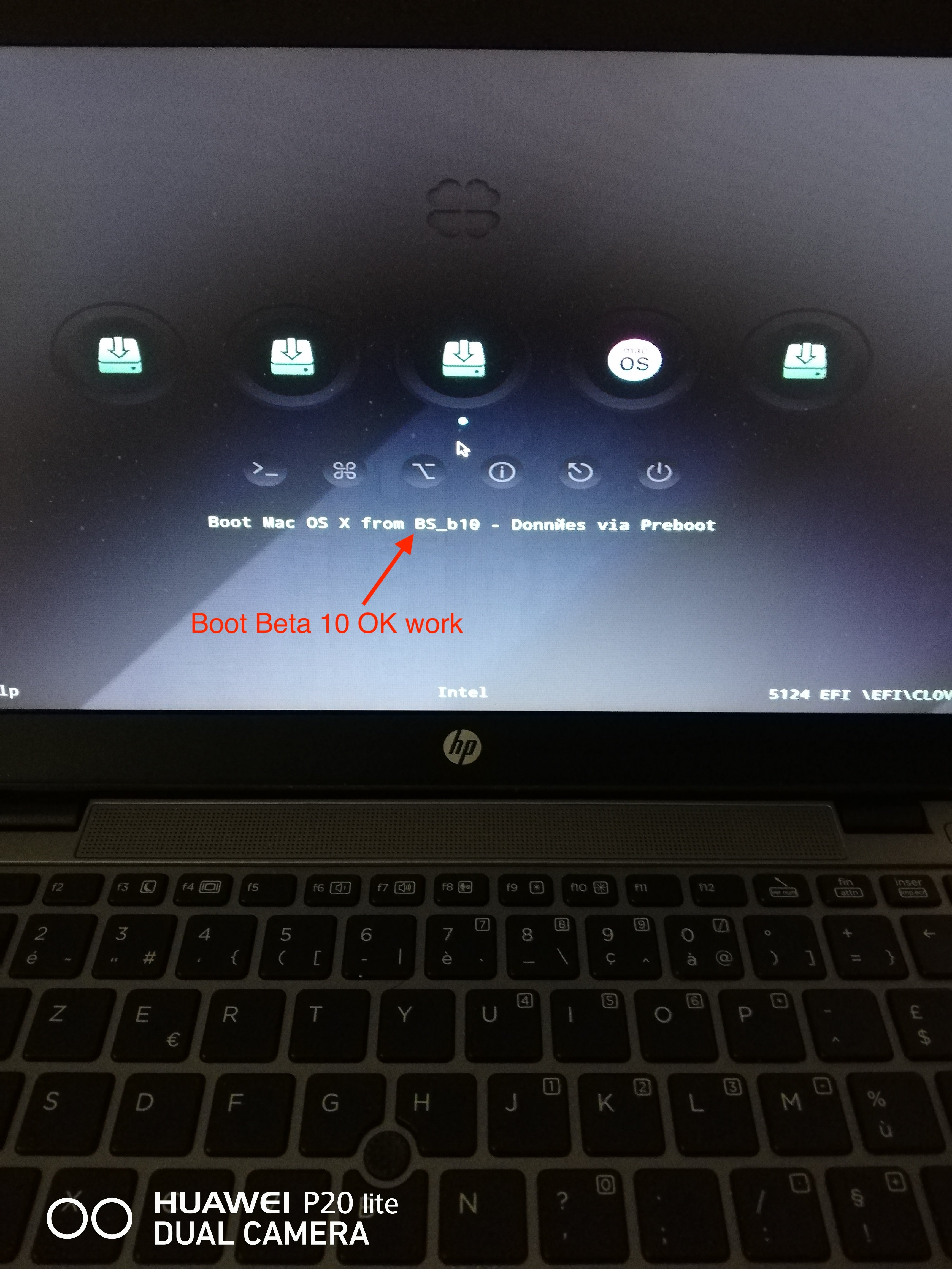

Good Morning
I confirm that you cannot boot Normal by the system as it was in
previous versions
to get the boot in beta 10 you have to do it from the Preboot
boot and not by the name you gave it
because in the case of sism it makes a kernel panic!
I'm doing another partition for new tests and I return the
result BUT I confirm by Preboot
mode how the installation can open and use the Beta 10
systm I did this tonight ...
what is still with the error is to update because Clover
does not have the SecureBootModel disabled
and it was necessary but for the rest Elite Elite 820 G2
intel i5-5300u hd 5500 installation of
beta 9 without problems and all pos installation of 10
can be done by the Clover r5124 on the first
commit (then mark the reference) r5124 commit d2bec9ba0
are on the right track!
forced
Google translate
1806618442_Capturedecran2020-10-15a17_57_34.thumb.png.7a61030983b810a34408ad7e903d1714.png

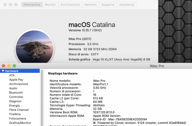

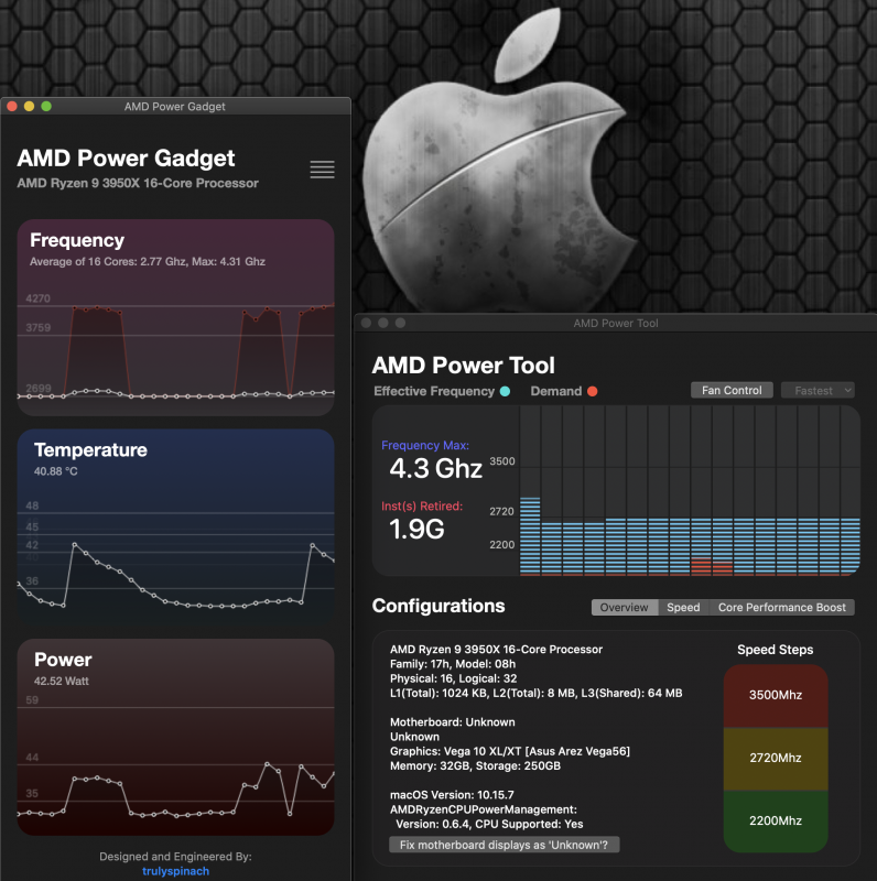

good new ones for AMD macache :D on my T-RyZo Clover last commit, brings me cheerfully to desktop with mojave and catalina :thumbsup_anim:
 I wanted to know from the developers @Slice @Jief_Machak if you can already use the kernel patches that I use with OC so that you can also start big sur

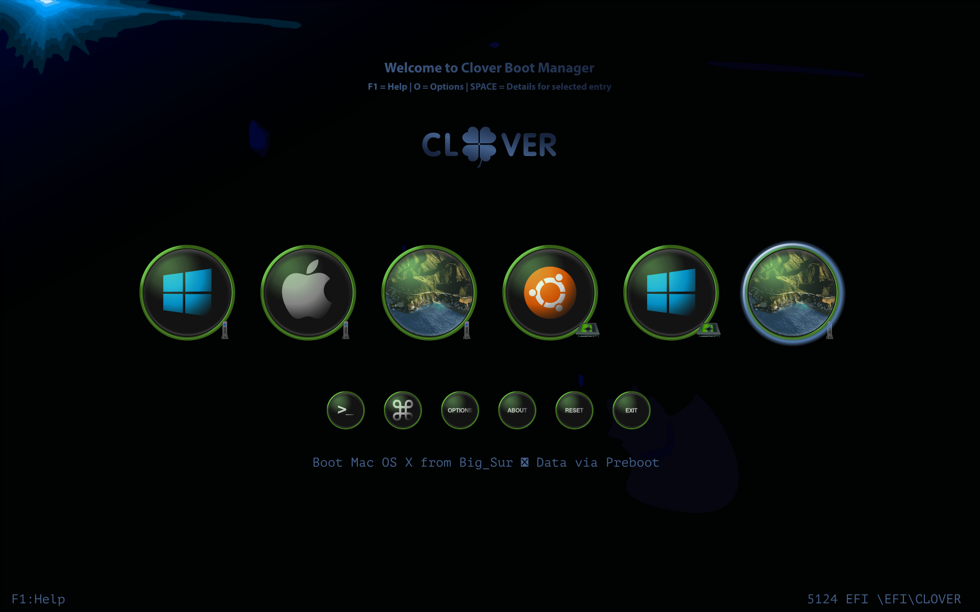

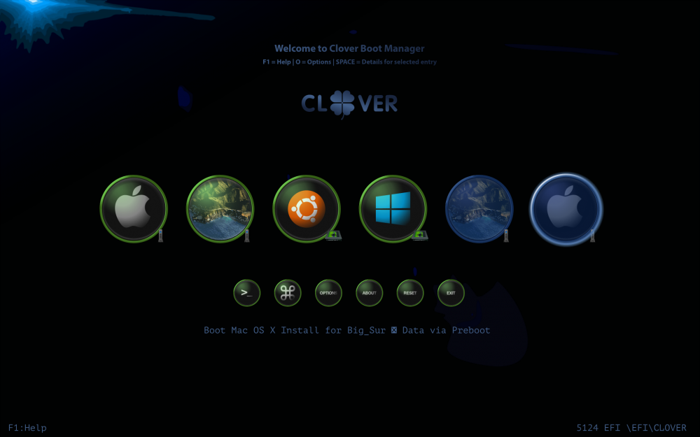

1 hour ago, PG7 said:
Good Morning
previous versions
forced
Google translate
Spoiler
  Reveal hidden contents
Spoiler
1719848489_Capturedecran2020-10-15a17_57_05.thumb.png.dbf5b64e567aa6a0db06a5da42e1af44.png

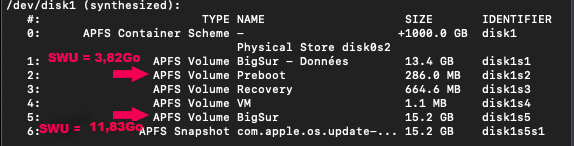

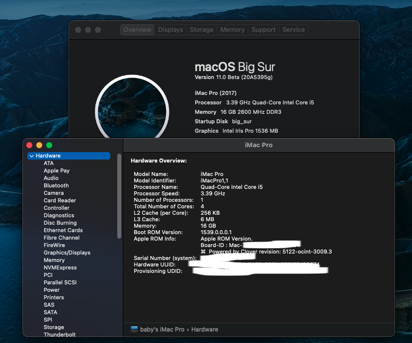

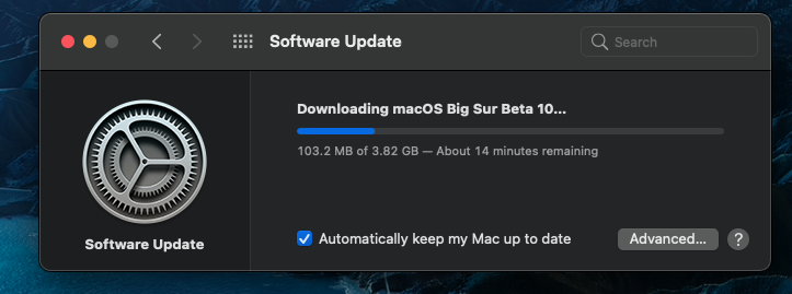

Hi @Slice @Jief_Machak
I confirm what @PG7 say: Clover r5124 commit 4d34c7b can also update Big Sur Beta 9 to Beta 10 (3,82Go), using preboot Volume (SIP = 0x67 available). It's strange but it's true :) If we use normal volume: Software Update tool show only the full installer (11,83Go). This behavior is different from that of Beta 9.
I think too that the reason: Clover doesn't have SecureBootModel=Disabled (embedded or in config.plist). This strange behavior does not exist on Opencore with SecureBootModel=Disabled.
Spoiler
Edited by Matgen84

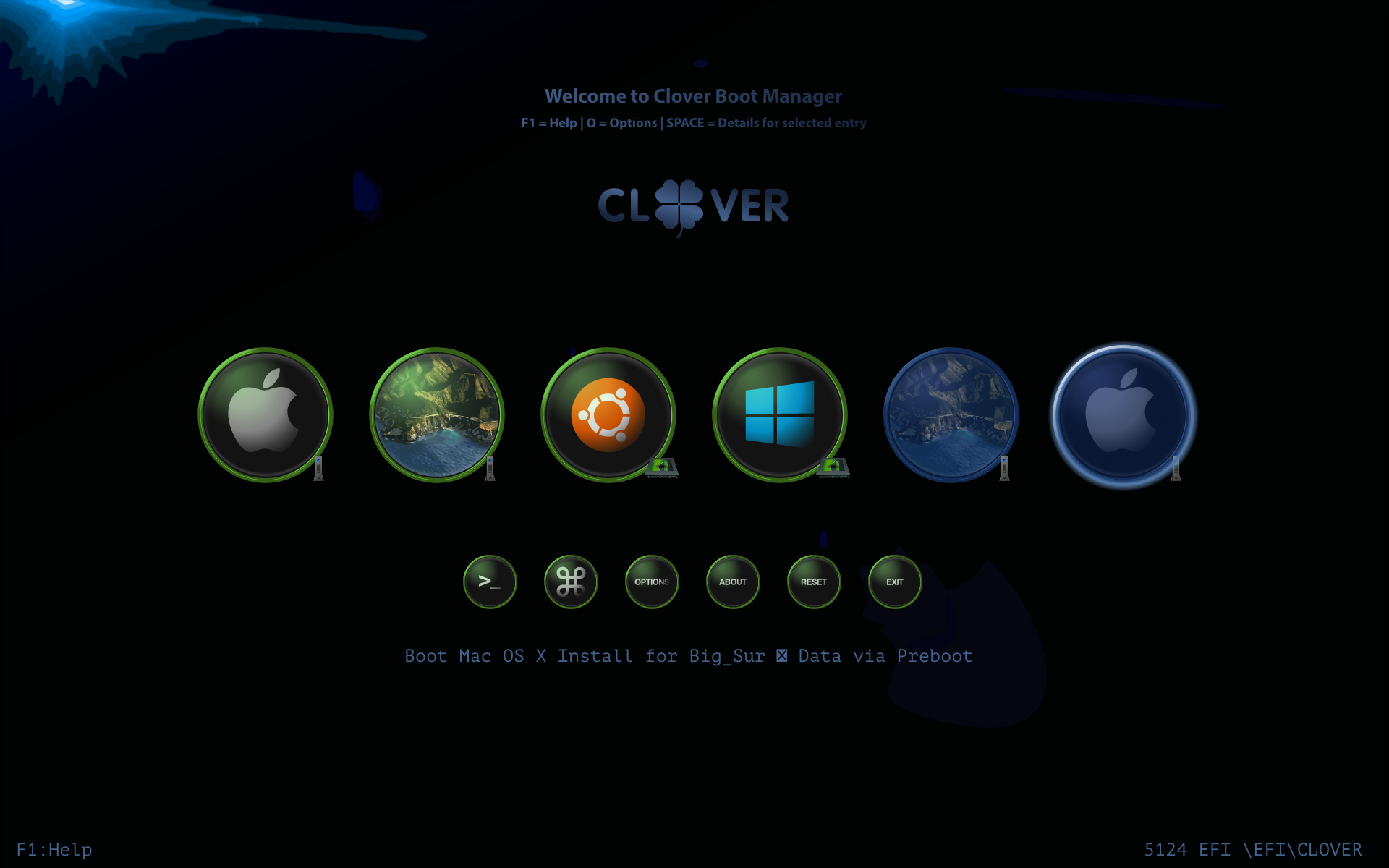

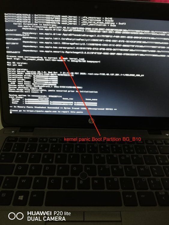

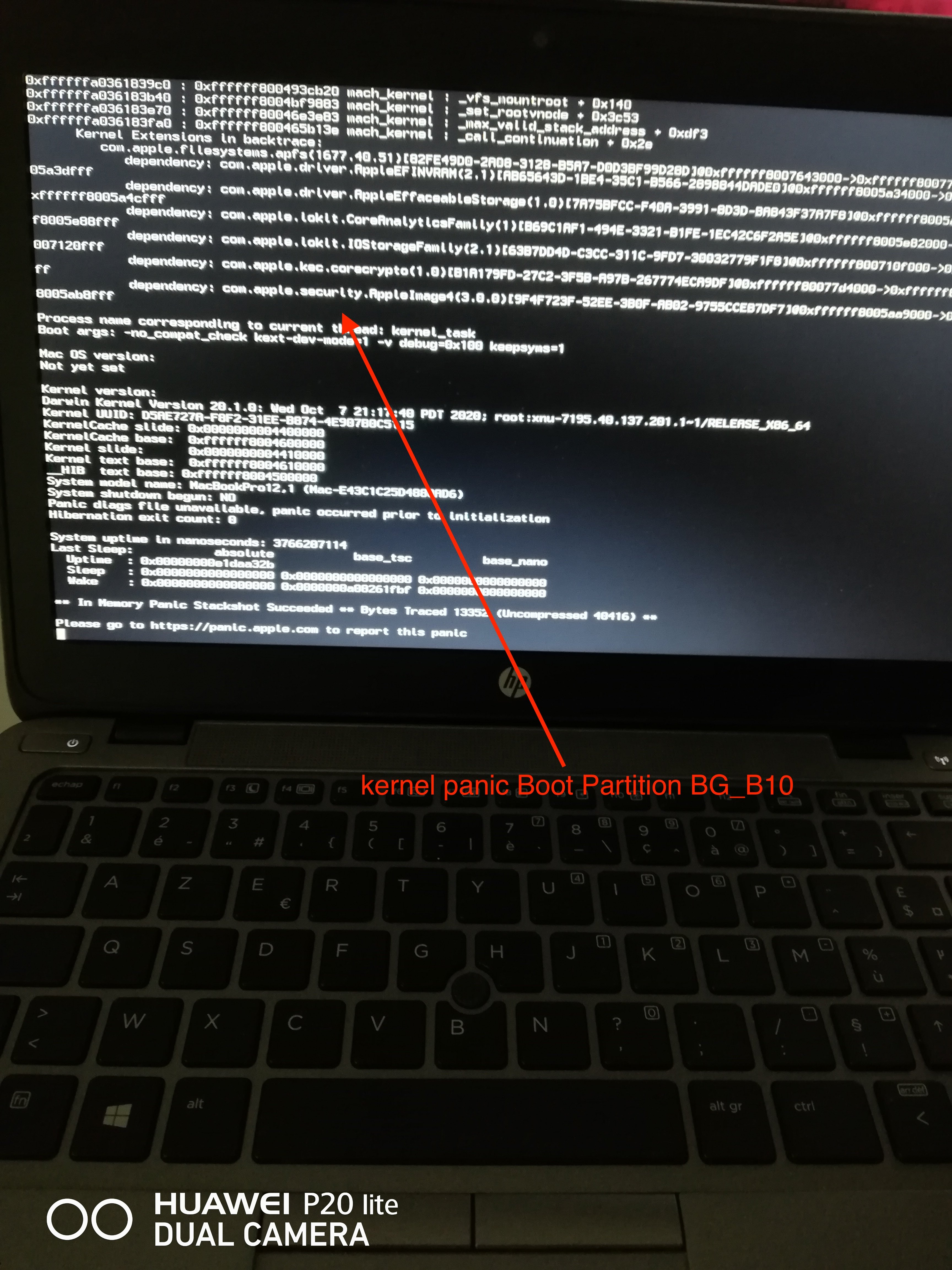

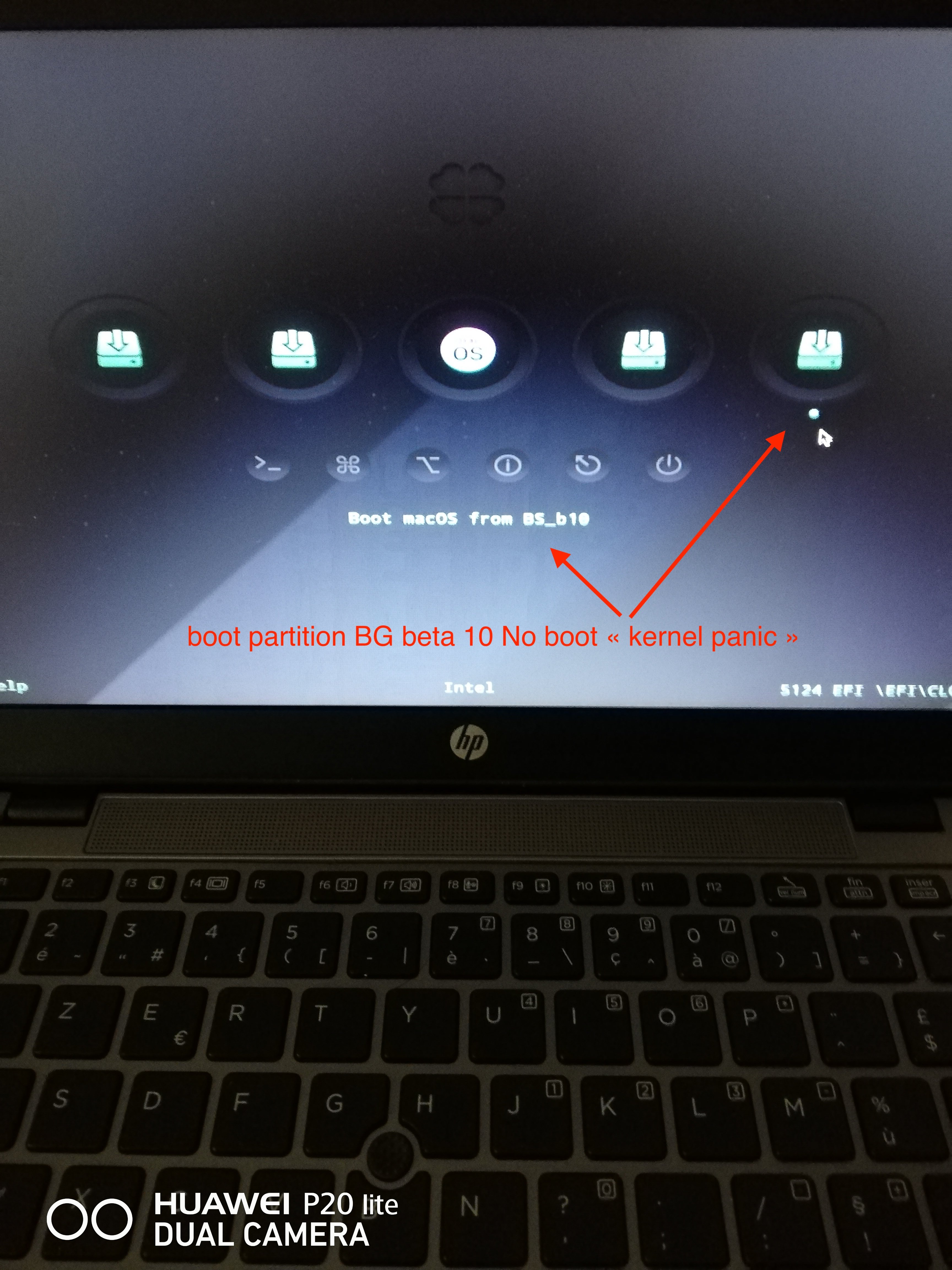

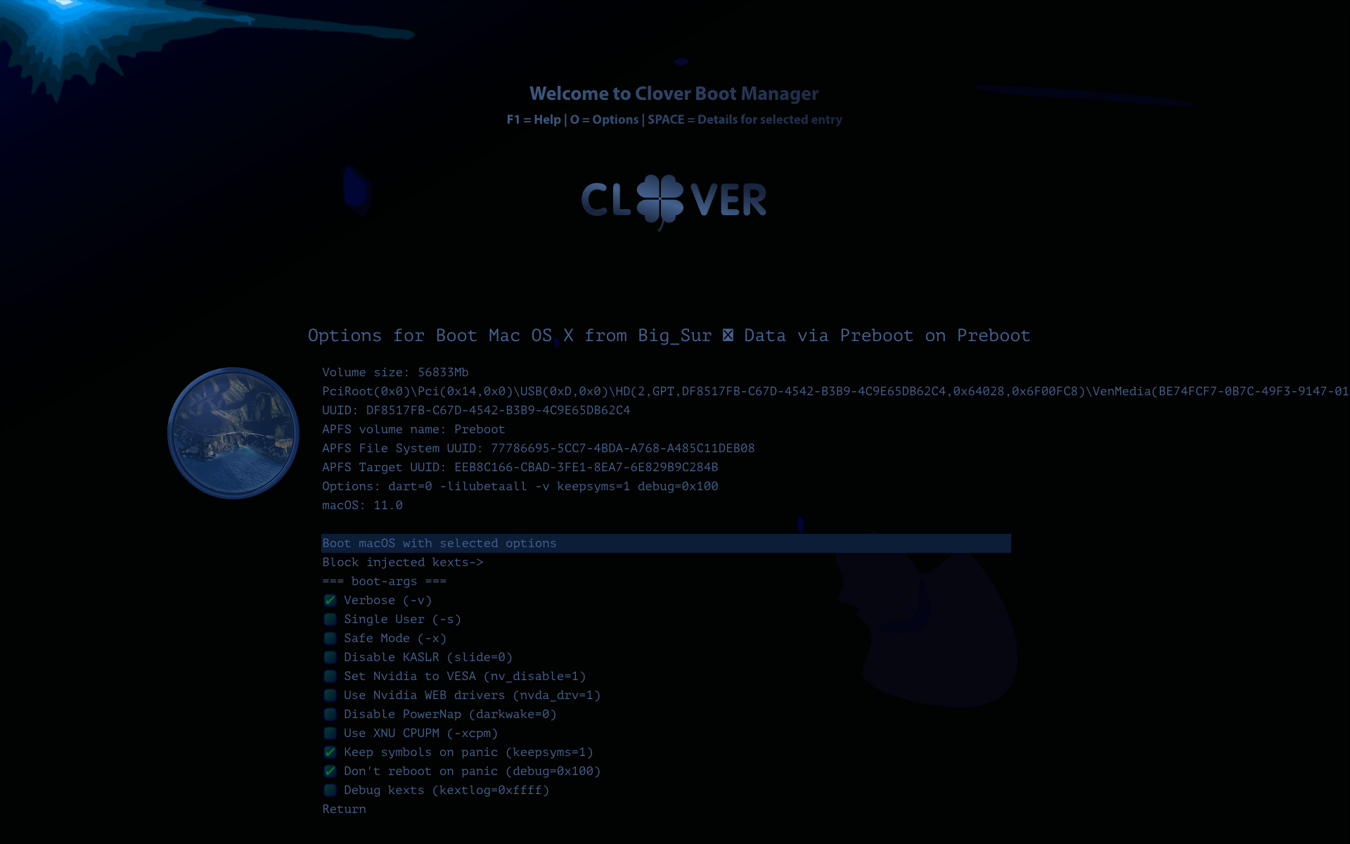

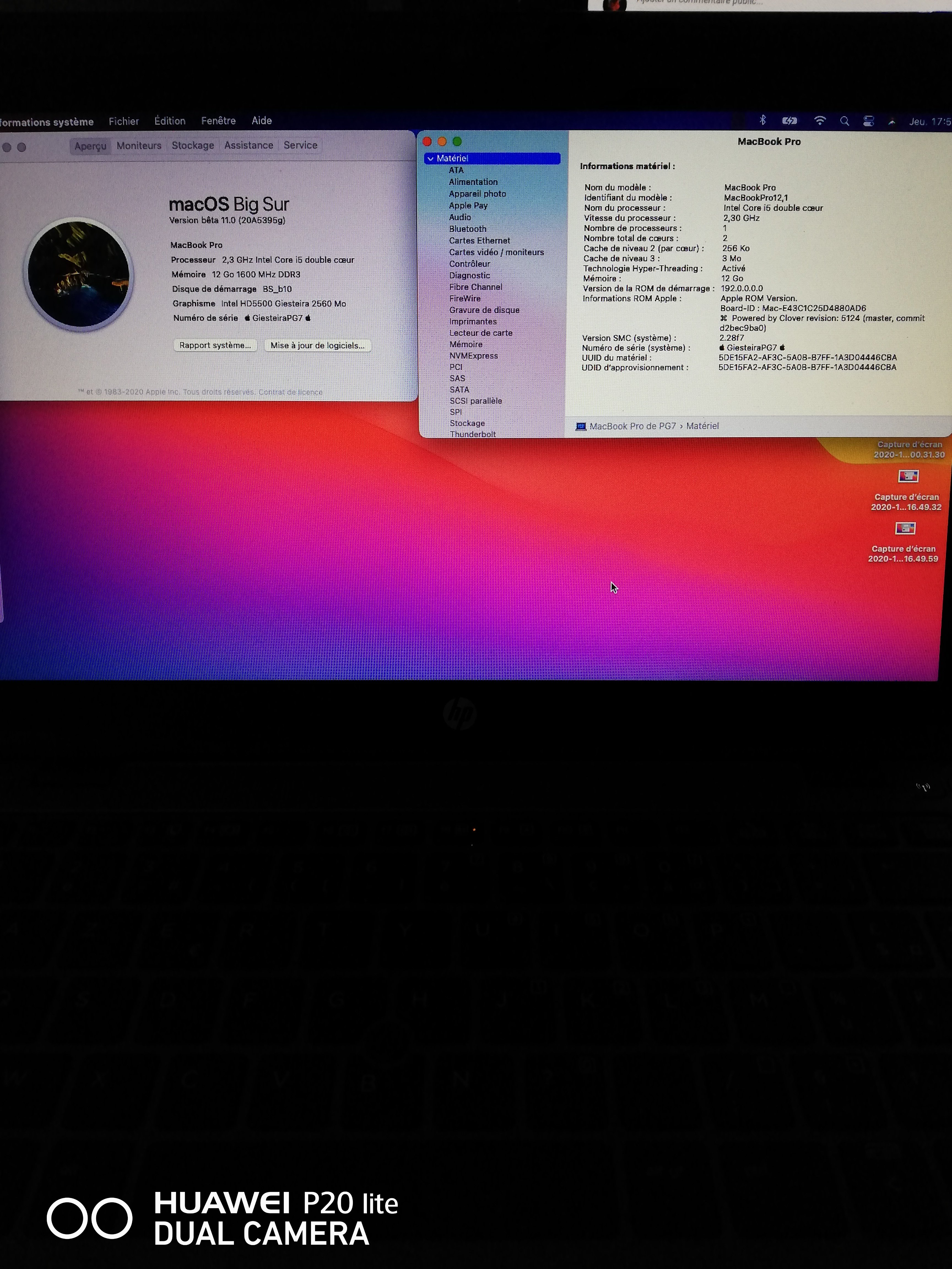

Clover Problem boot partition BG_b10
clover boot beta 10 disk Preboot !
print
boot kernel panic
Spoiler
1505076541_bootpartitionBGbeta10Nobootkernelpanic.thumb.jpg.71f83833f7aad0e998f45c83bf7c1149.jpg
Spoiler
Krenel panic
Spoiler
boot bigsur beta 10 OK Clover r5124 (disk Preboot)
Spoiler
Divulgacher
system Clover r5124 ok boot = Pré-démarrageIMG_20201015_175148.thumb.jpg.d8cd252ed011ece318e3cd4ebd41d7ce.jpg
print
boot kernel panic
  Hide contents
  Hide contents
Krenel panic
  Hide contents
  Hide contents
  Hide contents
Just like me
Spoiler
Edited by naiclub
  • Thanks 1

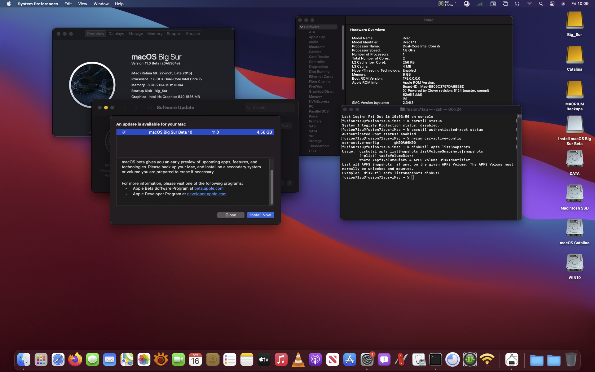

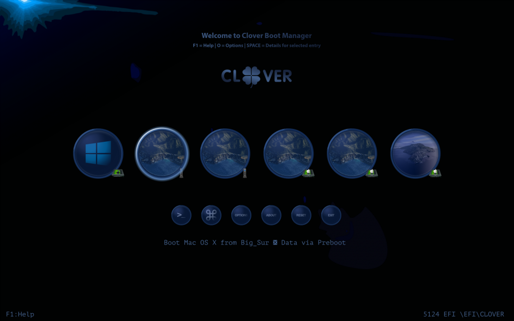

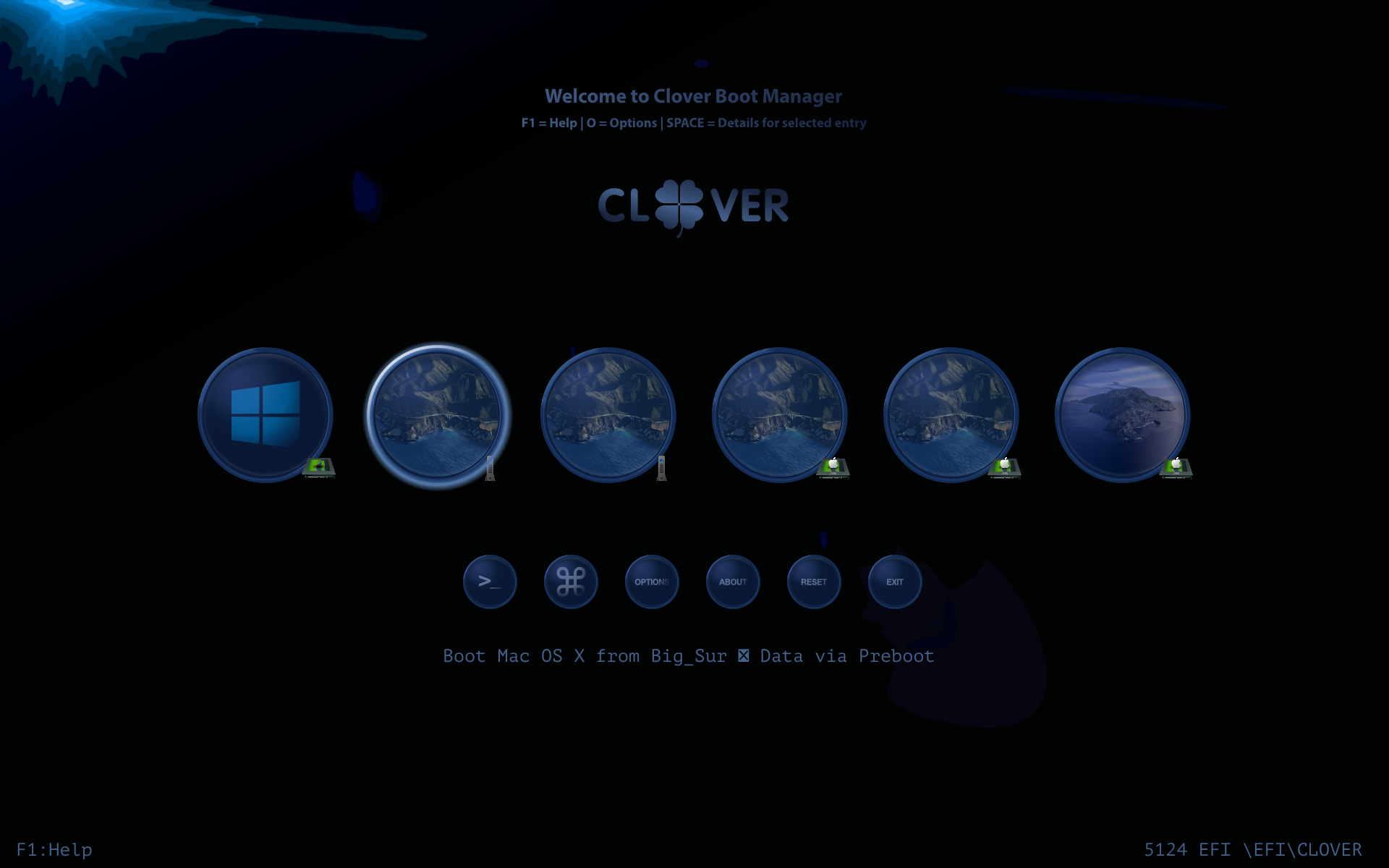

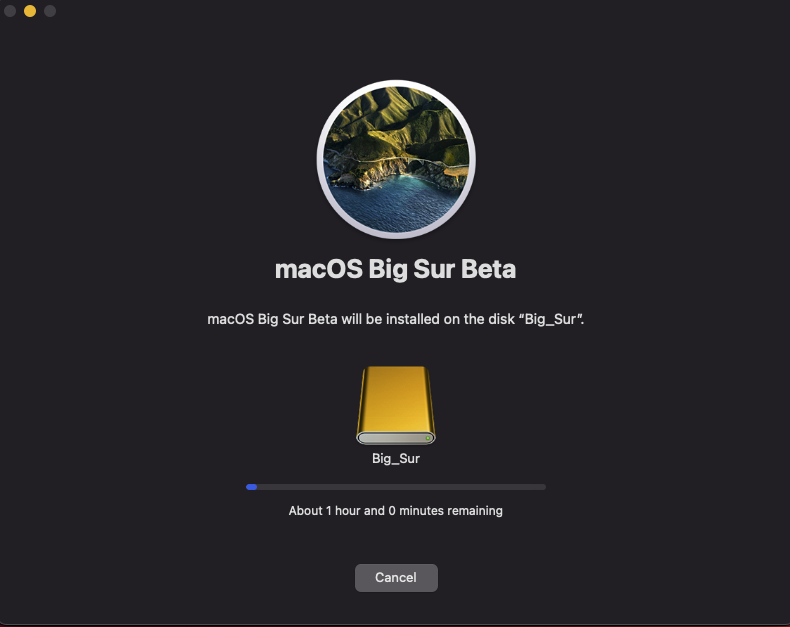

Hmmb, it's bit weird that I'm still unable to load Clover on my Legacy mach (GPT Scheme with 200MB ESP) since r5123. It just got stuck at boot6 / boot7. I've also tried using boot binaries from prev releases with same results, either re-erased my EFI partition several times then manually installing it using 'dd' under Linux following m13253's script (not using any macOS #atm). debug=true didn't help either, it gave me no log at all. Or, do I need using OpenCore legacy method for this? Thanks.
Yeah, it looks like the OC integration process has resulted in bad legacy boot files (boot6, boot7) that hang the boot process before reaching the Clover GUI.
Attached is the latest Clover_r5124_ 62e6f8ddd (with good boot6 from r5058) that you can manually install after mounting the EFI System Partition.
Some tips for converting over from old Clover r5122 to new ones with OC 0.6.1 integration in this post.

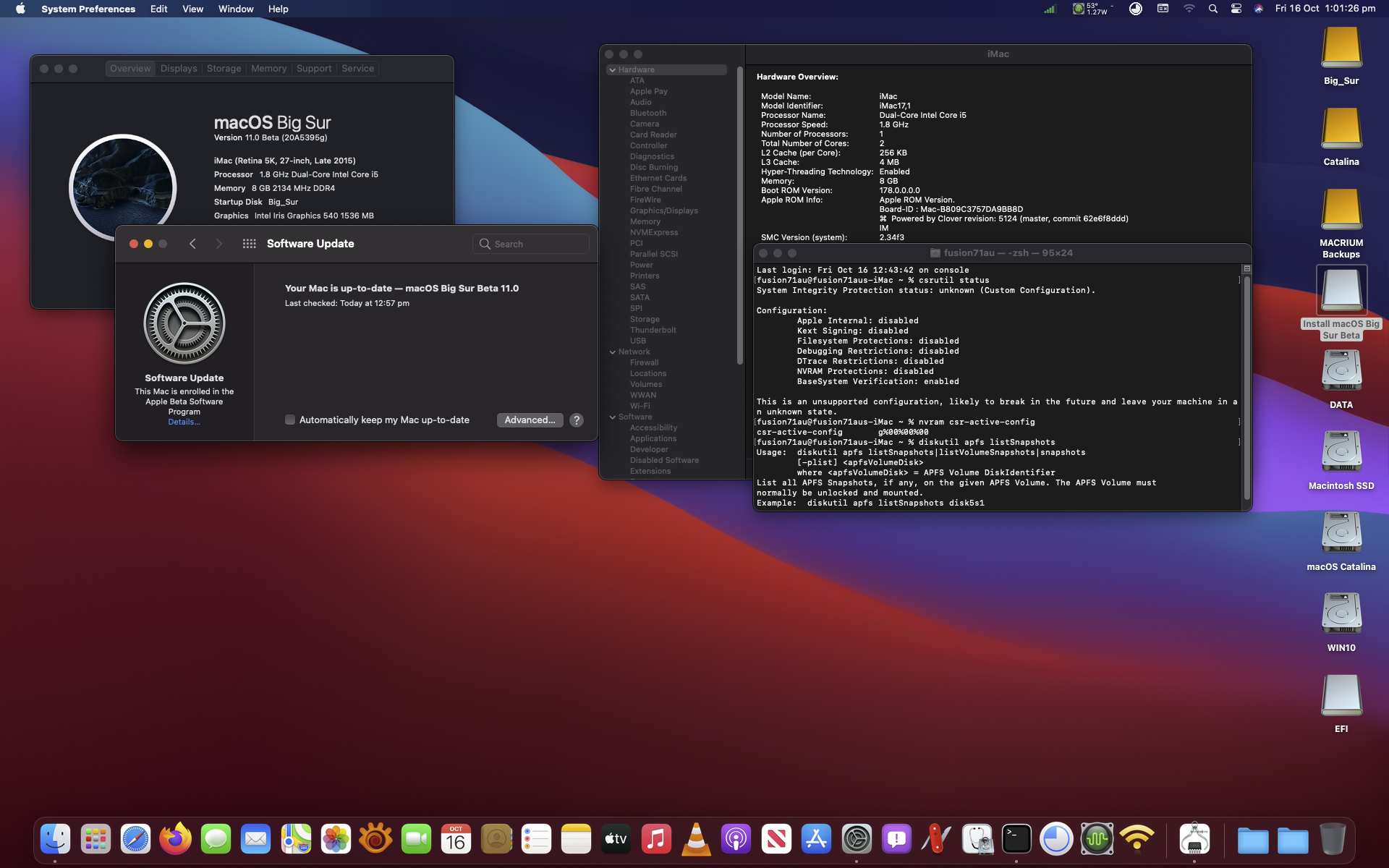

Works for both my legacy systems (System2, System3 in signature), booting OSX 10.6.8 to macOS Big Sur Beta10 (USB installer and already installed system).
Also tested on my Skylake NUC6i5SYH to successfully update Big Sur Beta6--->Beta10 on an external USB HD (running the full installer app in Beta6...link to Beta10 InstallAssistant.pkg (11.4GB size))
Spoiler
1742472991_B10update3.png.cc4e3eb17e8217ddca55c829283edb4e.pngReboot1_1.thumb.png.23f487c2184021b1b8634a01d8afe3b3.pngReboot2.thumb.png.145d84b5680863b311821384a3e7c46e.pngReboot3_1.thumb.png.1e4887186f27f2681d856cc9a95dce6b.pngReboot3_2.thumb.png.a0313340df3285cc3bc7b1258e3da2a2.png1396049986_NUC6i5SYHupdateinstallwithfullB10installerusingClover_r5124.thumb.png.cda1fe6adf44c4185ea1d9862b2781c3.png
PS - Can confirm delta OTA update is still offered through System Preferences/Software Update when you boot to older Big Sur beta through its Preboot volume eg boot to Beta6 via Preboot ---> offered Beta10 upgrade of 4.56GB...
Spoiler
878167467_NUC6i5SYHdeltaupdateB6toB10viaCloverr5124.thumb.png.637e169f4c11b99decce18af3774168c.png
