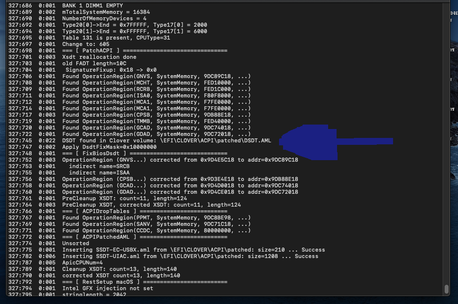

6 minutes ago, verleihnix said:

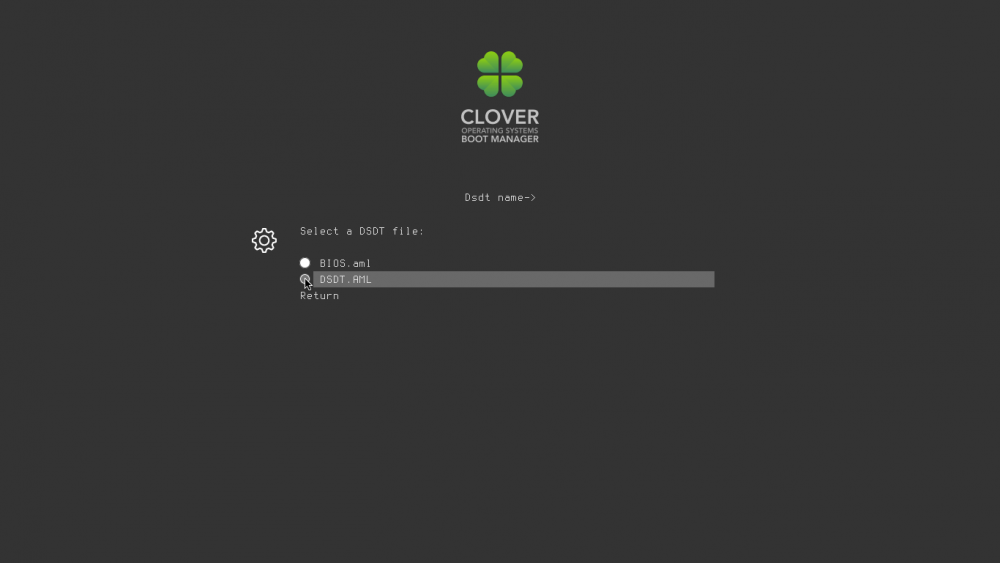

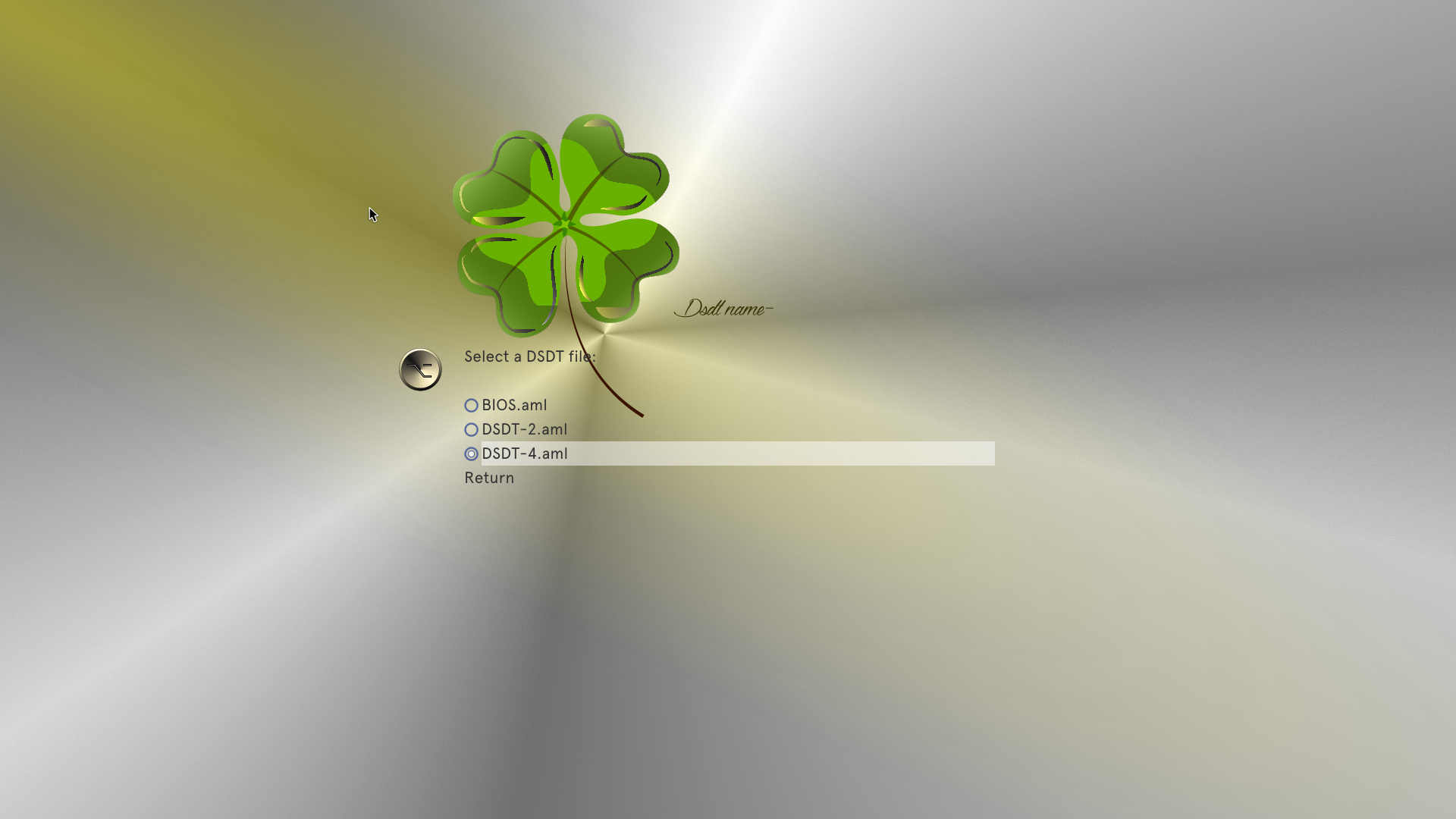

Tried that, but it makes no difference.
SSDT's are inserted, DSDT does not find its way into system.
Neither in Catalina nor BS booted from Preboot
AMI_X64_5125_(master,_commit_aee426fa3)_BootLog.txt

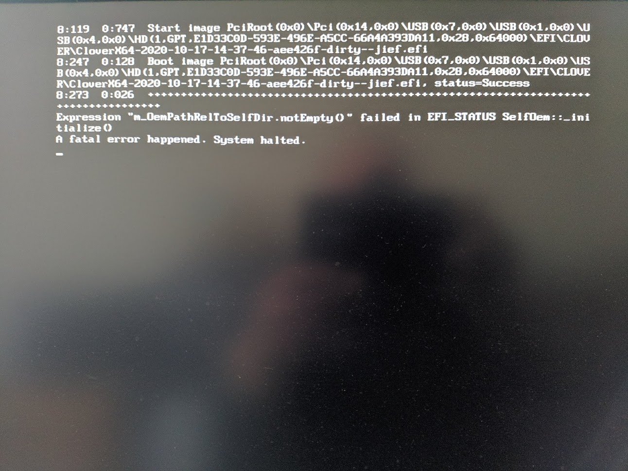

Try this CloverX64-2020-10-17-14-37-46-aee426f-dirty--jief.zip

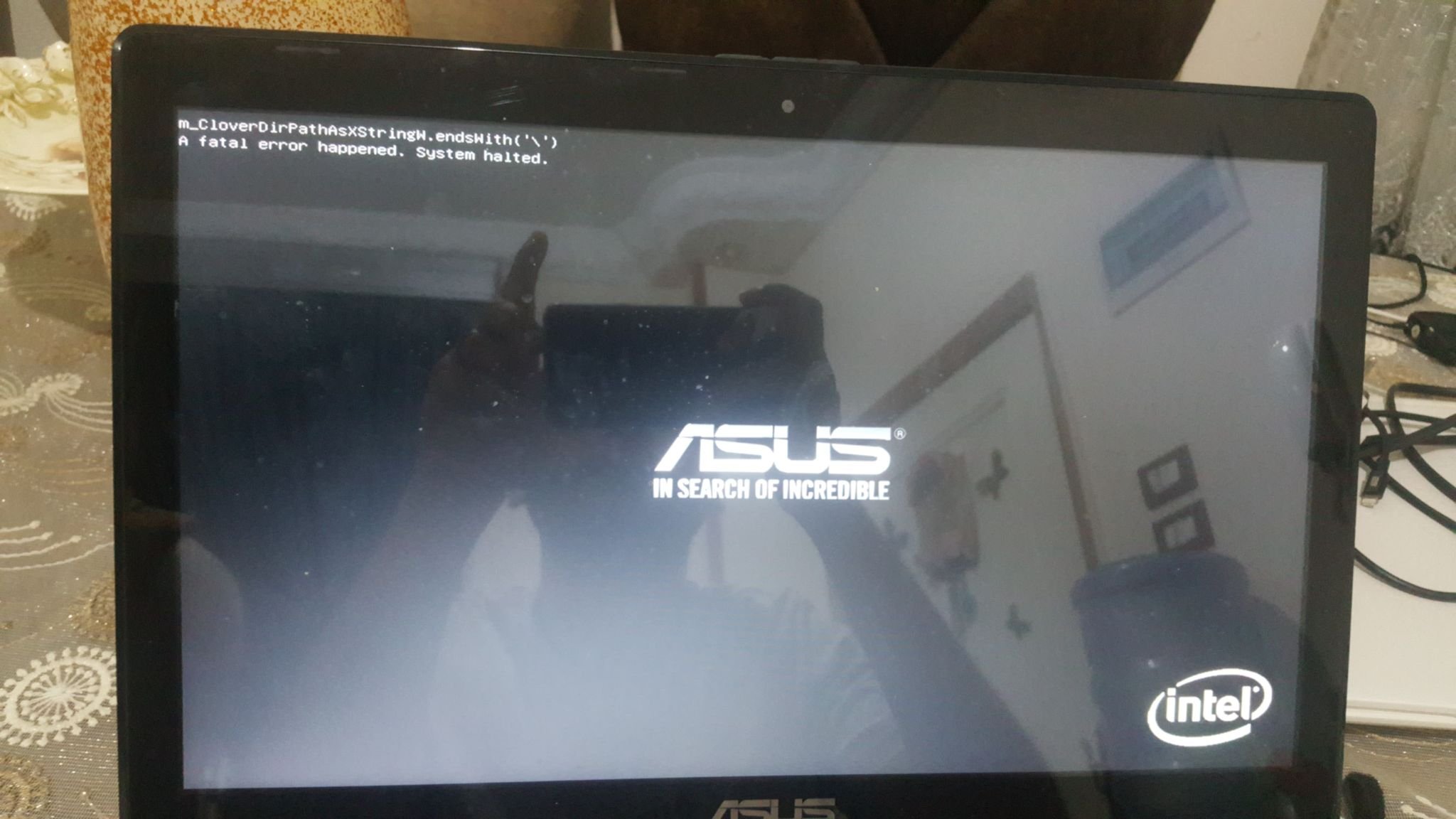

hi
I have some problems using last clover revision  5125
using usb flash memory to boot clover Mac OS Catalina boots but with no battery indicator no audio no touchpad
here is my new clover floder
CLOVER.zip
here is clover boot log
  Reveal hidden contents

all works fine with clover rev 5119
when trying to boot new clover revision from ssd efi folder clover can't start ! as on picture cloverdirpathasxstringw.endwith(\)
can't solve this problem
any help thanks on advance
Could you try the EFI file form the previous post ? It won't fix the problem this time, but will give me some more information. Take a picture like you did of the message.

I'm currently trying to improv and fix DSDT and log problems. I can't reproduce them here, that's why it's a bit difficult.
DSDT is still not in system

5:819  0:000  === [ Found DSDT tables ] =======================
5:822  0:003  - DSDT.AML
10:421  0:003  DSDT found in Clover volume: \EFI\CLOVER\ACPI\patched\\DSDT.aml
10:421  0:000  Apply DsdtFixMask=0x506600D4

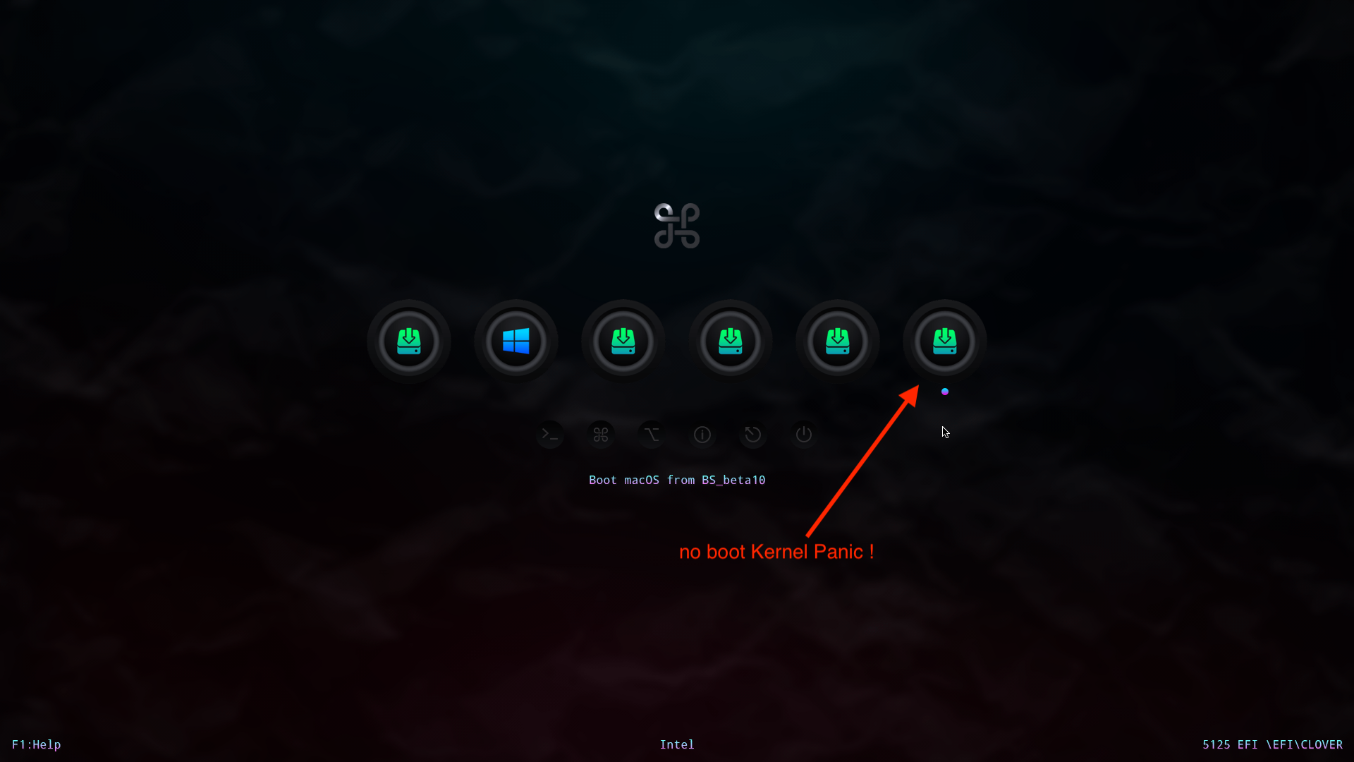

@Jief_Machak I can't boot Mojave with this commit on my IvyBridge system.
Spoiler
Edited by Matgen84

5:589  0:013  === [ Found DSDT tables ] =======================
5:601  0:012  - DSDT.AML
30:957  0:009  DSDT found in Clover volume: \EFI\CLOVER\ACPI\patched\DSDT.aml
30:970  0:013  Apply DsdtFixMask=0x50400000
  • Haha 1

10 minutes ago, naiclub said:
In this case, if 1 line is missing from the left That shows Clover can now load the modified DSDT.aml. But I tried version 5124-5125. Not change in the slightest
 Give an example=\EFI\CLOVER\ACPI\patched*\*DSDT.aml
? I understand nothing.
I always see DSDT.aml is loading.
  • Haha 1
Yes, it only loads the original. That has not been resolved If it loads the modified version I will be able to use everything.
I do not know how to describe it, you understand. I am not a developer.
Make a screenshot of EFI/CLOVER/ACPI/patched/ folder.
Do with me
Spoiler
log
101:278  0:081  DSDT found in Clover volume OEM folder: \EFI\CLOVER\ACPI\patched\\DSDT-4.aml
101:416  0:138  Output DSDT before patch to \EFI\CLOVER\ACPI\origin\DSDT-or.aml
101:924  0:507  Apply DsdtFixMask=0x179521DD
And then I compare this special DSDT with that is loaded into system.
  • Haha 1

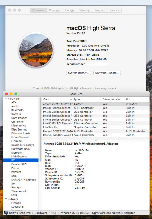

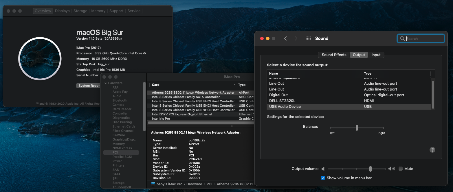

2 hours ago, Slice said:
How do you know this?
iMac: kextstat |grep LPC
   88    0 0xffffff7f8576b000 0x11000    0x11000    org.hwsensors.driver.LPCSensors (1800) EF5BB9DC-C33F-3EED-9F96-42A7F22D806F <46 13 12 8 6 5 3>
AppleLPC.kext does not show up
And all other fixes in DSDT doesn't as well.

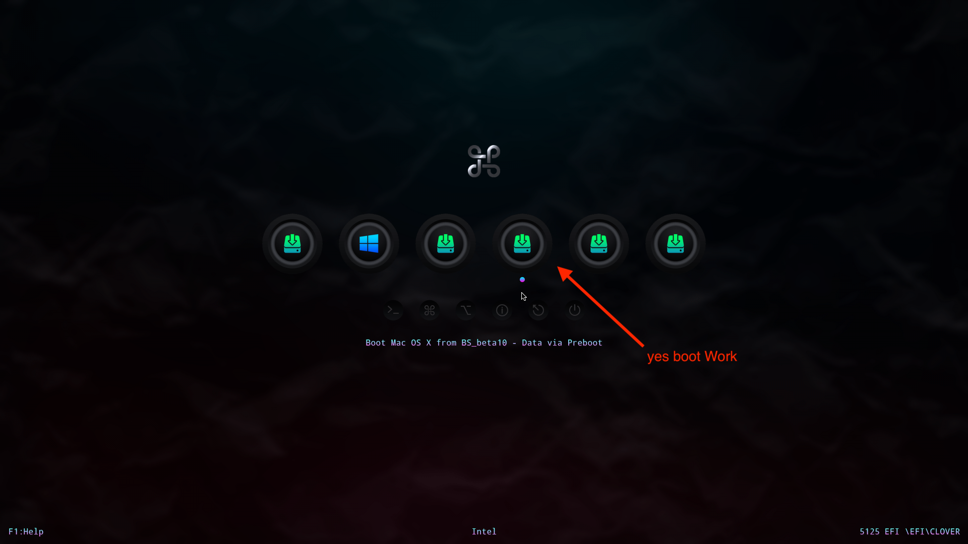

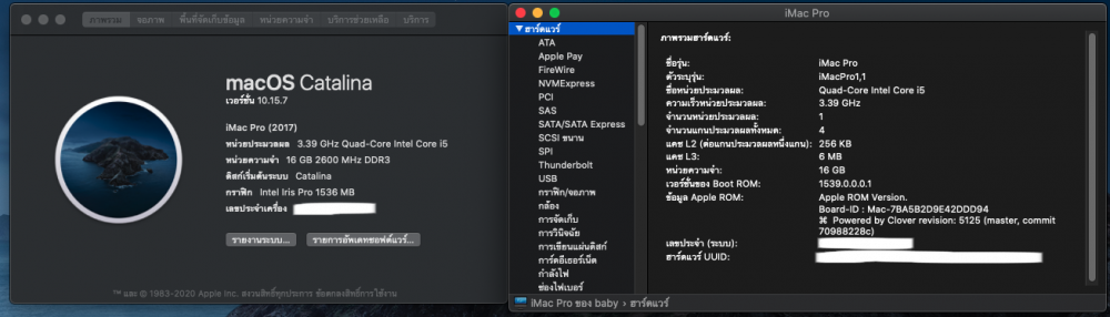

Do with me
log
Hello, I want to say that it is now successful.
Thank you very much
Spoiler
1251105718_2563-10-1723_05_11.thumb.png.2a7f9af905d913e0d21f9f42ee0642ec.png322013272_2563-10-1723_14_04.png.1a34d85371c2e1b47498b00c9105e44d.png1944810400_ScreenShot2563-10-17at23_59_58.thumb.png.d09aa9612f7a2cce17acbff72feb8c32.png2090380777_ScreenShot2563-10-17at23_41_53.thumb.png.4a6687034cf0a3cc31f9a0ec51424b63.png219406748_2563-10-1723_49_20.thumb.png.77c176e7fc5b6875fb94b817e5c17dab.png
Edited by naiclub

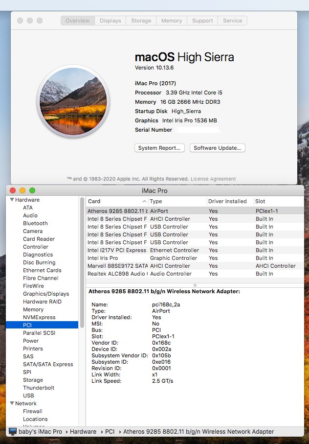

I have the same problem that my HP Envy Recline 23-K030EF i5-4590T does not load the DSDT
with both the Clover r5124 and r5125 already with the r5123 it loads without any problems!
still without being able to boot directly from the disk where the Beta10 system is but it can be done by Preboot,
something has improved so far I could not install it directly on any BigSur version now I can still do it
with trapeze but without having to go through on another pc!
I leave the debug so that the DEVs with time can check and make corrections or advise me something to
test I will be here for that!
Thank you all in advance!
