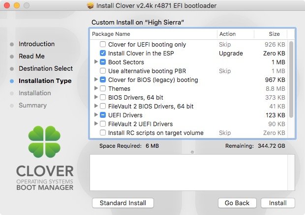

Maybe I missed it but can someone explain the need for FSInject and SMCHelper? I forgot to install them the last time and my machine boots and works just fine? Are they unnecessary for non-UEFI mobos? Or is it just not needed for High Sierra?
Also, not sure if this is really a needed fix but...when I got to install Clover, UEFI drivers are check by default and no BIOS drivers are checked even though the installer has "Clover EFI 64-bits BiosBlockIO" checked by default. So I assume the installer knows this is a legacy BIOS install.
I always have to uncheck the UEFI drivers and check the BIOS drivers I need.

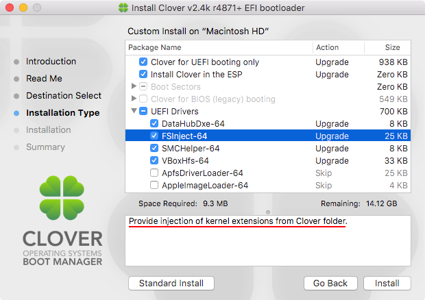

FS-Inject: is responsible for kext injection from Clover folder
SMCHelper: Restores SMC keys left in NVRAM by FakeSMC.
Now wether or not they're required for non-UEFI motherboards..., that I don't know. But since they're both under Drivers64UEFI, my guess is that they might not be...? Although...in order to boot, you still need FakeSMC, right? Which still needs to be injected from Clover/kexts. So...I really don't know.
Also, what you're describing looks more like a missing feature, maybe, more than a bug. But if my theory is correct and none of the Drivers64UEFI files is necessary for legacy booting...then, I guess there's just a matter of checking whether or not Clover Legacy is selected, before displaying UEFI drivers.
I don't know. I could be talking stupid. So don't take my word for it. Maybe someone has a better idea and understanding of what's going on in this case and whether or not those UEFI drivers should be checked when selecting Legacy booting. I personally haven't used that in a veeeery long time.

And as for the other question about BIOS drivers, it looks like your installer doesn’t  show or provide them (unless they are not on the screenshot). Below is the default selections when you first click on customize. You can see that no BIOS driver is selected but UEFI drivers are. Even though this is a legacy mobo.
Yep, on my case "Clover for UEFI booting only" option is selected, so "BIOS Drivers" are hidden. I still need them when booting on Legacy mode #BTW (with UEFI unchecked).

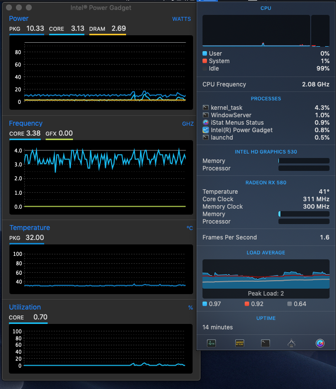

So i'm not sure where to post this but it may be clover related.
I am hoping the screen says what it needs too, iStat menus and IPG are both showing different CPU frequencies and i'm not sure why.
2008850902_ScreenShot2019-02-05at7_41_34pm.thumb.png.9be25d5d37f099e30c431f737b9a203e.png

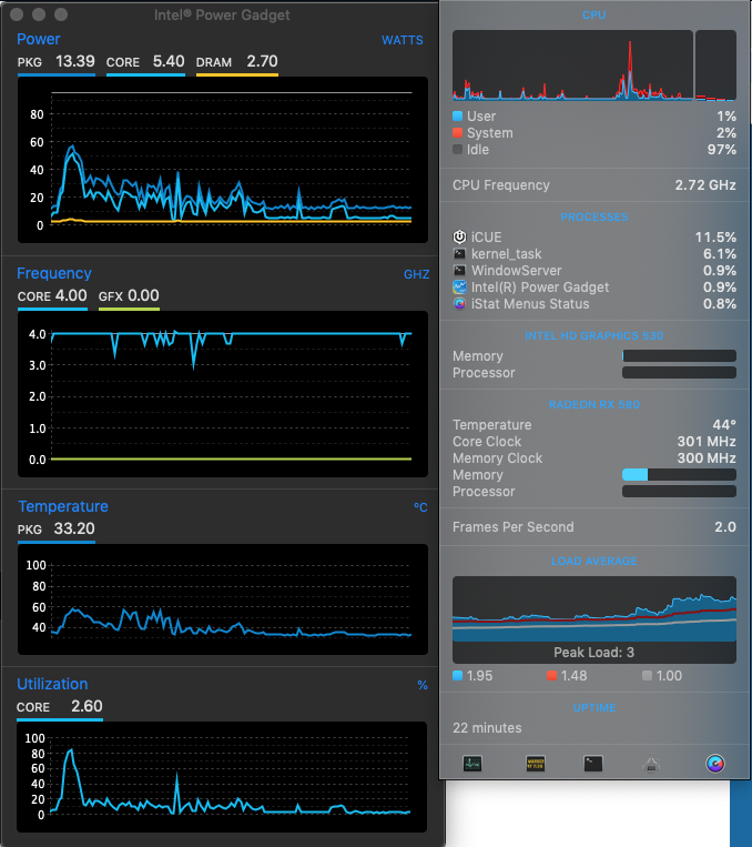

Also with corsair iCue running IPG gets pinned at 4ghz while iStat shows differently.
1727277581_ScreenShot2019-02-05at7_49_04pm.thumb.png.6f1fc3dbb34a469c84184078f4d80c16.png
Is this all cosmetic or do i have an issue?
FSInject used for Clover feature ForceInjectKext which allows to load system kexts like for exmaple AMD9000Controller even if it not matched the card. I am not sure if it is still necessary.
SMCHelper keeps some SMC keys left by FakeSMC to be used by boot.efi in case of Hibernation or FileVault2. Other cases SMC not used.
If you use VirtualSMC.kext then you have to replace SMCHelper.efi to VirtualSMC.efi which does the same but in pair with own kext.
runme.app files attached.
Send me iMac.zip
I think IPG is right.
  • Like 5
Are you able to check my files and tell me if everything is ok?

Plugin-type produces the difference what method for speedstep will be used. By Apple...kext or by xcpm in kernel.
I will not reproduce your result because I have no iStat and no wish to acquire it. I am using HWMonitorSMC2 by Vector_Sigma and I know it shows the same result as IPG.
