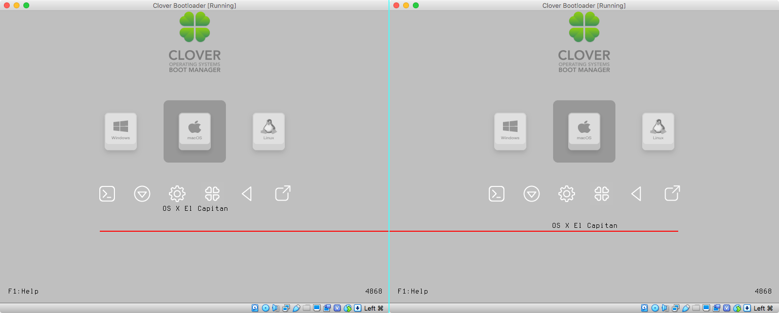

VirtualBox is also able to detect Audio device on preboot, using Host Audio Driver: Core Audio | Audio Controller: IntelHD under VM's Settings, as SigmaTel STAC9920/9921. HDA Codec (0x7680) is should be supported by AudioPkg as well.
So, having no sound is bcoz VirtualBox doesn't support Native NVRAM?
Device Description	Intel 82801FB(M) ICH6(-M) - High Definition Audio Controller [A-1]
Bus Type	PCI
Bus / Device / Function	0 / 5 / 0
Device ID	8086-2668
Subsystem ID	8384-7680
Revision	01
Hardware ID	PCI\VEN_8086&DEV_2668&SUBSYS_76808384&REV_01
Device Properties
Device Description	SigmaTel STAC9220 A1
Device Type	Audio
Bus Type	HDAUDIO
Device ID	8384-7680
Revision	1034
Hardware ID	HDAUDIO\FUNC_01&VEN_8384&DEV_7680&SUBSYS_83847680&REV_1034
