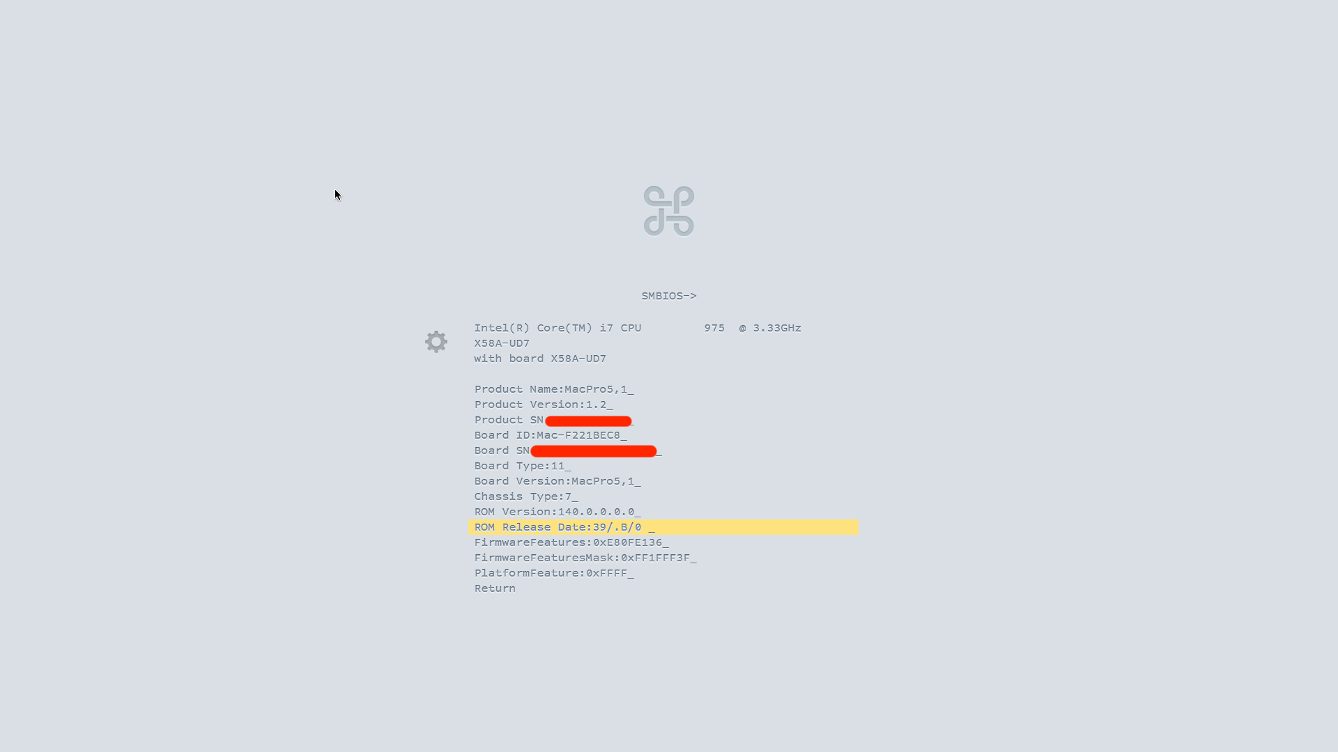

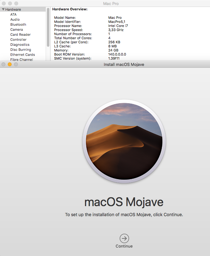

Hi! I've managed the new thing. When I manually update BootROM version to the "latest", I have an error.
My Hardware Overview has the wrong Boot ROM Version (MP51.F000.B00) which now should be 140.0.0.0 like here.
That is why I cant update my "MacPro5,1" to Mojave with metal-compatible card HD7770.
@slice, I think we now have to add this case for Mojave- compatible machines, like "EFI Version" BootROM version (EFI Version: 140.0.0.0.0) into Platformdata.c typedef struct:
$IBIOSI$ MP51.88Z.F000.B00.1809191555
Apple ROM Version
  Model:        MP51
  Date:         Wed Sep 19 15:49:52 2018
  Build Type:   Release
[mention=112217]slice[/mention], I think we now have to add this case for Mojave- compatible machines, like "EFI Version" BootROM version (EFI Version: 140.0.0.0.0) into Platformdata.c typedef struct:
$IBIOSI$ MP51.88Z.F000.B00.1809191555Apple ROM Version Model:        MP51 EFI Version:  140.0.0.0.0 Date:         Wed Sep 19 15:49:52 2018 Build Type:   Release
i also checked some models(MBP15,x/MP5,1/etc) changed biosversion part(?) or added EFI version part(?). probably seems changed it in 10.14.1 beta or 10.14 release. i think need DMI dump from realmac for clear between Boot Version and EFI version.
EDIT1
EFI version and BootROM version same? so no need BootROM? when you first reported, your biosversion is BootROM version. hmm.
From PB6 it has changed. Click.
Quote
20180813: BootROM 138.0.0.0.0
New BootROM 138.0.0.0.0 for Mac Pro 5,1 with updated microcodes (0x106A5 29 and 0x206C2 31), support for 5GT/s link speed on macOS/Windows without R17 mod, enabled HDMI audio on RX480 and new/improved firmware flasher on Mojave DP7/PB6 (18A365a) full installer.
1 minute ago, Sherlocks said:
thanks. new BootROM format can install HS?
or do we have to consider it for only mojave?
Maybe it can. Click.
Quote
13[8,9].0.0.0.0 don't change the ability of booting previous macOS versions.
Can you see at my screenshots $IBIOSI$ click and no EFI Version.
1600176331_2018-06-059_11_20.png.07c6ce53b96eb55a0e1158c7a0f00ef1.png.f7b8bbbe63ac76b722068b9aa58b40fa.png
0089 is the same.
But from EFI Version 138.0.0.0.0 a BIOS has more lines click:
Quote
$IBIOSI$
Apple ROM Version
Model
EFI Version
Date
983110840_2018-10-113_02_38.png.db5ed477bcc0de613b77cdcc682103d3.png.88abee17d512f3b16a080eb13bfcbecf.png
I attached ver 138.0.0.0.0 if you want to search with UEFITool. Try plz.
MP51.fd.zip
