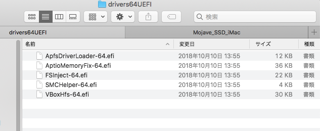

Slice Posted October 14, 2018 Share Posted October 14, 2018 15 hours ago, arimuras said: ApfsDriverLoader.efi APFS Format Fusion Drive Support ? Clover Scan Entries stuck Not boot Manualy add apfs.efi Boot Ok --- Mojave 10.14.0 Clover 4705 ApfsDriverLoader AppleSupport v2.0.4 What if you choose ApfsDriverLoader and other efi drivers from Clover release 4700 package? Exclude outer drivers like AppleSupport. 1 Link to comment https://www.insanelymac.com/forum/topic/284656-clover-general-discussion/page/721/#findComment-2640710 Share on other sites More sharing options...
arimuras Posted October 14, 2018 Share Posted October 14, 2018 13 minutes ago, Slice said: What if you choose ApfsDriverLoader and other efi drivers from Clover release 4700 package? Exclude outer drivers like AppleSupport. Clover release 4700 package Same problem Clover Scan Entries stuck attach, efi driver sorry for my bad english. 1 Link to comment https://www.insanelymac.com/forum/topic/284656-clover-general-discussion/page/721/#findComment-2640713 Share on other sites More sharing options...
Matgen84 Posted October 14, 2018 Share Posted October 14, 2018 51 minutes ago, arimuras said: Clover release 4700 package Same problem Clover Scan Entries stuck attach, efi driver sorry for my bad english. Did ApfsDriverLoader.efi work before? For compatibility with Fusion, I think you have to ask @savvas Link to comment https://www.insanelymac.com/forum/topic/284656-clover-general-discussion/page/721/#findComment-2640716 Share on other sites More sharing options...

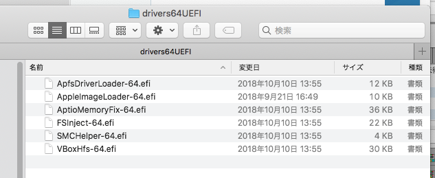

Andres ZeroCross Posted October 14, 2018 Share Posted October 14, 2018 1 hour ago, arimuras said: Clover release 4700 package Same problem Clover Scan Entries stuck attach, efi driver sorry for my bad english. Try to add "AppleImageLoader-64.efi" to avioid stuck. just use ApfsDriverLoader-6.efi instead APFS.efi Link to comment https://www.insanelymac.com/forum/topic/284656-clover-general-discussion/page/721/#findComment-2640719 Share on other sites More sharing options...
arimuras Posted October 14, 2018 Share Posted October 14, 2018 2 hours ago, Andres ZeroCross said: Try to add "AppleImageLoader-64.efi" to avioid stuck. just use ApfsDriverLoader-6.efi instead APFS.efi Thank you for your reply Clover release 4700 package Try to add AppleImageLoader-64.efi Same, Clover Scan Entries stuck Link to comment https://www.insanelymac.com/forum/topic/284656-clover-general-discussion/page/721/#findComment-2640737 Share on other sites More sharing options...
Andres ZeroCross Posted October 14, 2018 Share Posted October 14, 2018 5 minutes ago, arimuras said: Thank you for your reply Clover release 4700 package Try to add AppleImageLoader-64.efi Same, Clover Scan Entries stuck What of your boot mode?? Legacy or UEFI? Link to comment https://www.insanelymac.com/forum/topic/284656-clover-general-discussion/page/721/#findComment-2640738 Share on other sites More sharing options...
arimuras Posted October 14, 2018 Share Posted October 14, 2018 4 minutes ago, Andres ZeroCross said: What of your boot mode?? Legacy or UEFI? Boot mode "UEFI" Link to comment https://www.insanelymac.com/forum/topic/284656-clover-general-discussion/page/721/#findComment-2640739 Share on other sites More sharing options...
Andres ZeroCross Posted October 14, 2018 Share Posted October 14, 2018 Boot mode "UEFI" This is mine, maybe you can try it. Same filesSent from my Mi Note 2 using Tapatalk Link to comment https://www.insanelymac.com/forum/topic/284656-clover-general-discussion/page/721/#findComment-2640741 Share on other sites More sharing options...

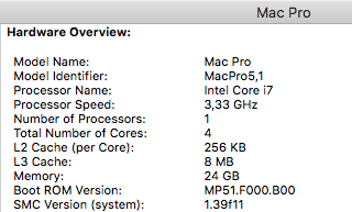

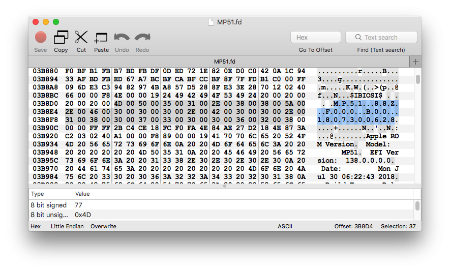

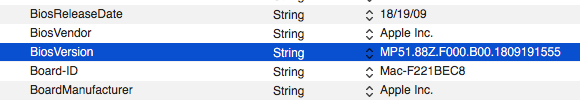

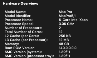

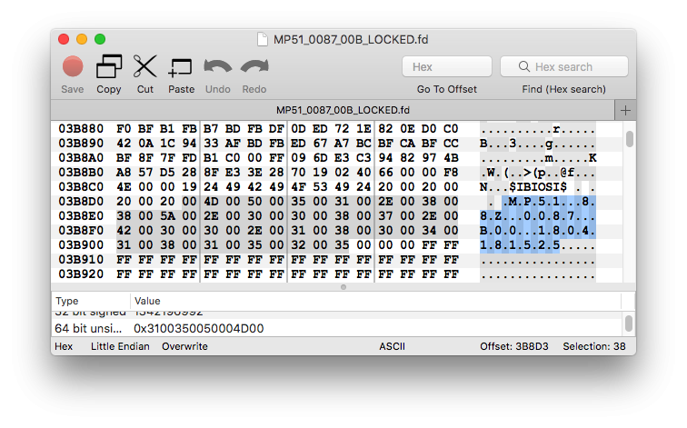

Moorre Posted October 14, 2018 Share Posted October 14, 2018 On 10/11/2018 at 12:49 PM, Sherlocks said: I updated biosversion from mojave 10.14.1 beta3. the most of updated models support mojave. Hi! I've managed the new thing. When I manually update BootROM version to the "latest", I have an error. My Hardware Overview has the wrong Boot ROM Version (MP51.F000.B00) which now should be 140.0.0.0 like here. That is why I cant update my "MacPro5,1" to Mojave with metal-compatible card HD7770. @slice, I think we now have to add this case for Mojave- compatible machines, like "EFI Version" BootROM version (EFI Version: 140.0.0.0.0) into Platformdata.c typedef struct: $IBIOSI$ MP51.88Z.F000.B00.1809191555 Apple ROM Version Model: MP51 EFI Version: 140.0.0.0.0 Date: Wed Sep 19 15:49:52 2018 Build Type: Release Link to comment https://www.insanelymac.com/forum/topic/284656-clover-general-discussion/page/721/#findComment-2640918 Share on other sites More sharing options...
Sherlocks Posted October 14, 2018 Share Posted October 14, 2018 Hi! I've managed the new thing. When I manually update BootROM version to the "latest", I have an error. My Hardware Overview has the wrong Boot ROM Version (MP51.F000.B00) which now should be 140.0.0.0 like here. That is why I cant update my "MacPro5,1" to Mojave with metal-compatible card HD7770. [mention=112217]slice[/mention], I think we now have to add this case for Mojave- compatible machines, like "EFI Version" BootROM version (EFI Version: 140.0.0.0.0) into Platformdata.c typedef struct:$IBIOSI$ MP51.88Z.F000.B00.1809191555Apple ROM Version Model: MP51 EFI Version: 140.0.0.0.0 Date: Wed Sep 19 15:49:52 2018 Build Type: Release i also checked some models(MBP15,x/MP5,1/etc) changed biosversion part(?) or added EFI version part(?). probably seems changed it in 10.14.1 beta or 10.14 release. i think need DMI dump from realmac for clear between Boot Version and EFI version. EDIT1EFI version and BootROM version same? so no need BootROM? when you first reported, your biosversion is BootROM version. hmm. 나의 LG-F800S 의 Tapatalk에서 보냄 Link to comment https://www.insanelymac.com/forum/topic/284656-clover-general-discussion/page/721/#findComment-2640920 Share on other sites More sharing options...
Moorre Posted October 14, 2018 Share Posted October 14, 2018 27 minutes ago, Sherlocks said: i also checked some models(MBP15,x/MP5,1/etc) changed biosversion part(?) or added EFI version part(?). probably seems changed it in 10.14.1 beta or 10.14 release. i think need DMI dump from realmac for clear between Boot Version and EFI version. From PB6 it has changed. Click. Quote 20180813: BootROM 138.0.0.0.0New BootROM 138.0.0.0.0 for Mac Pro 5,1 with updated microcodes (0x106A5 29 and 0x206C2 31), support for 5GT/s link speed on macOS/Windows without R17 mod, enabled HDMI audio on RX480 and new/improved firmware flasher on Mojave DP7/PB6 (18A365a) full installer. 1 Link to comment https://www.insanelymac.com/forum/topic/284656-clover-general-discussion/page/721/#findComment-2640927 Share on other sites More sharing options...
Sherlocks Posted October 14, 2018 Share Posted October 14, 2018 thanks. new BootROM format can install HS?or do we have to consider it for only mojave?나의 LG-F800S 의 Tapatalk에서 보냄 Link to comment https://www.insanelymac.com/forum/topic/284656-clover-general-discussion/page/721/#findComment-2640928 Share on other sites More sharing options...
Moorre Posted October 14, 2018 Share Posted October 14, 2018 1 minute ago, Sherlocks said: thanks. new BootROM format can install HS? or do we have to consider it for only mojave? Maybe it can. Click. Quote 13[8,9].0.0.0.0 don't change the ability of booting previous macOS versions. Can you see at my screenshots $IBIOSI$ click and no EFI Version. 0089 is the same. But from EFI Version 138.0.0.0.0 a BIOS has more lines click: Quote $IBIOSI$ Apple ROM Version Model EFI Version Date I attached ver 138.0.0.0.0 if you want to search with UEFITool. Try plz. MP51.fd.zip Link to comment https://www.insanelymac.com/forum/topic/284656-clover-general-discussion/page/721/#findComment-2640930 Share on other sites More sharing options...
