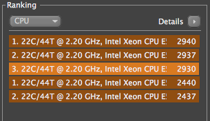

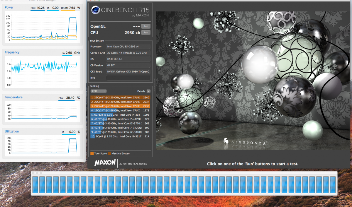

Do you know what okrasit patch does in case of an unsupported CPU if you have bios EIST function enabled?
It helps to reach in that case Higher states for cpu during loaded task
to explain better
EIST enabled no turboboost for (unsupported) CPU
ie cinebench15 benchmark in my rig has a correct value of 2950 with EIST disable and 2450 with EIST enabled and without this patch
to explain better

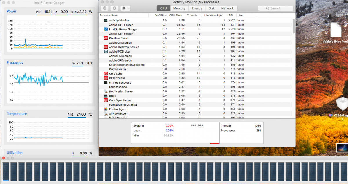

apianti, in OSX with EIST enabled in bios my and I think many other unsupported cpu do not reach higher turbo boost states
Okrasit time ago found this patches with (I think but I am not a guru like you) disable EIST
so in case you have windows and OSX you can Have EIST enabled in bios and then patch it via clover in OSX
I can't explain better

Yes, so as I said this patch is disabling speedstep, which is equivalent to NullCpuPowerManagement.kext, which is terrible and causes your CPU to run full speed all the time. Maybe a better solution would be to edit the p state data for the SMBIOS you are trying to use so that it reaches more and higher states since they are setup for the CPU models apple uses???
I see now you edit and this for me is a correct way to answer (also with a noob I can be here)
your statement about the equivalence is not correct at all
My cpu and also other "unsupported" cpu have all the steps it can allow from 12 to 37
in the past with null cpu kext only 3 steps 12 22 28
Power management is fine and time ago we have discussed with piker alpha to find a different solution because EIST enabled was fine but it has only that problem I have said before

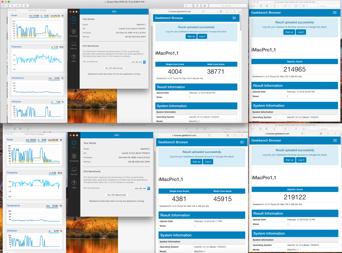

Then, 500 point less in benchmark is correct because cpu without patch and with EISt bounch from x22 to x 25 states during load
without EIST when system is loaded it stays for all 44 Threads @x26 so if you do some calculation... :)

​With that patch I am forcing to achieve higher states when cpu need of them
otherwise it is not possible (many tries with frequency vector and other things done)
however thank you for your point of view

You are continuing to say not exact things I don't understand why
My cpu has a TDP of 150W and could achieve a maximum of 180 w
It is a Xeon 2696 V4
In osx during full load it reach a maximum of 140 with some stress test
In real life a maximum of 125w
In windows it pass over 150 W in stress test also, in some benchmark it reaches for all cores/thread (44) 2.8 Ghz (cinebencz) in OSX only 2,6Ghz
also my wattage usage in idle is about 10w or less (it depends from services I have loaded)
the point of my first message about this patches is:
Now, thanks to the finding of PMHeart we (all) can use previously named Okrasit Performances fix patch also in 10.13.4.beta
No more of this
Then you are saying or understanding other things
Ie:
"You said that you were only getting x26 now on all 44 threads"
Why?
this is not enough for you? :)
X 28 is the max I can achieve for all cores and due some limitation in osx or AVX benchmark test it is limited for all cores to X26
2 cores limited to x37 and so on till x28 for all cores
