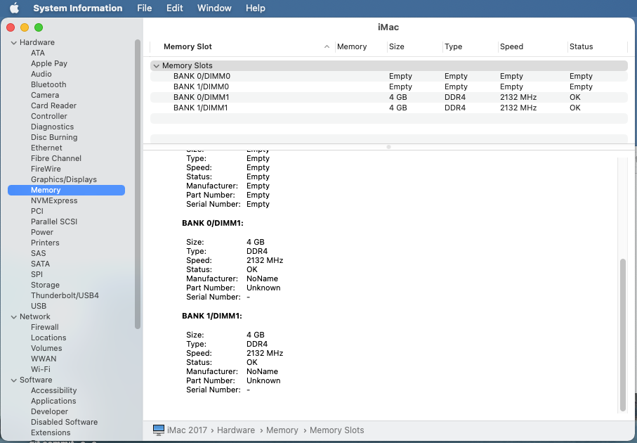

@Jief_Machak This CloverX64 can boot Monterey.
There is something wrong with memory detection: 2132MHZ instead of 3000MHZ
Now
SmbiosTable.Type17->Vendor = Corsair
SmbiosTable.Type17->SerialNumber = 00000000
SmbiosTable.Type17->PartNumber = CMK16GX4M2B3000C15
SMBIOS Type 17 Index = 2 => 2 1:
BANK 0 DIMM1 2132MHz 8192MB(Ext:0MB)
Table index 3:!trustSMBIOS !gRAM.SMBIOS.doesSlotForIndexExist(SMBIOSIndex)
SPD data in use:
SMBIOS Type 17 Index = 3 => 3 3:
BANK 1 DIMM1 2132MHz 8192MB(Ext:0MB)
mTotalSystemMemory = 16384

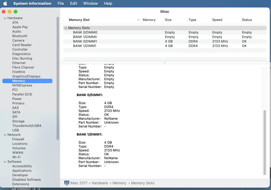

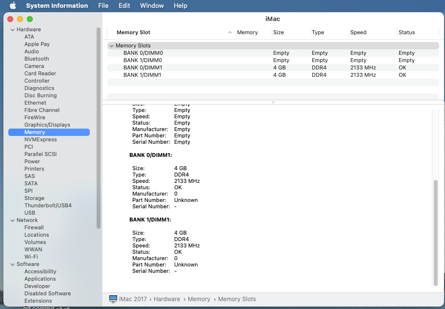

7 hours ago, Jief_Machak said:
Thanks @Slice for the first bug. Dual log was very helpful.
Thanks @yapan4, I found something else.
How about this one CloverX64-2021-10-01-11-18-28-83b9323-dirty-jief.zip ?
Successfully booted by the version.
There is non-significant memory difference with stock 5140
2133 is better then 2132 🤪
  • Like 3

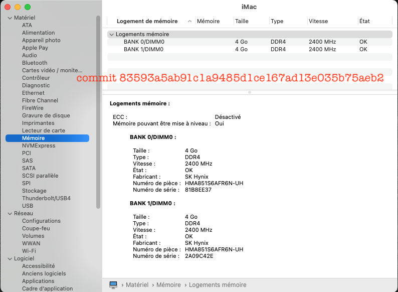

9 hours ago, maclinuxG4 said:
@jief: i propose that you reverse back before TMSC change,

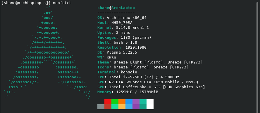

On 5140.1, Ubuntu shows the same as before.
You might want to check the debug logs for both versions.
The icon shows up just fine but trying to boot it gives a black screen. I’ll look into more later.
Have you booted Ubuntu? Or just looked at the icon?
Sent from my iPhone using Tapatalk
I'm sorry.
I just checked the boot.
As you can see, Grub2.04 booted and Ubuntu20.04 ran as usual.
Is your Linux loader ok?
Or, preparing a bootable stub may work. (cp /boot/EFI/arch_grub/grubx64.efi /boot/EFI/boot/bootx64.efi)
My Arch Linux boots fine from EFI I’ll check my config when I get a chance but I swear nothing has changed.

There is manufacturer 0 instead of NoName.
Which Clover version is the first screen, and which is the second ?

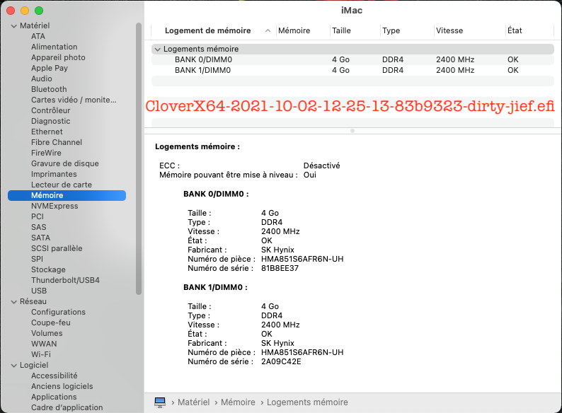

17 hours ago, yapan4 said:
Sorry, the last version I've sent contains debug code that overwrite memory modules info.
New version CloverX64-2021-10-02-12-25-13-83b9323-dirty-jief.zip
20 hours ago, MifJpnAlphaPlus said:
Clock are same...
Thanks for testing. But are you saying it's ok for you ?
Very simple question. 2132 is for your version, 2133 is for my version.
And the manufacture depends on Trust.

For what I understood, if SMBIOS is trusted, the manufacturer comes from that, else it comes from what is detected. Is that right ? It yes, it could make sense that they are different, right ?
What do you have in your smbios.plist ?
Send me a log in that case.
Yes sure. Way more readable that way. I guess it comes from copy/paste before I used a bool.
fixed.
I have no SMBIOS.plist. There is SMBIOS section in config.plist and almost all commented out.
config.plist.zip bootlog-6238.txt.zip
SMBIOS/DMI is always dynamic data created by BIOS or by the bootloader.
SMBIOS->Trust=true if we suppose BIOS makes good data. Trust=false if we read SPD and use it to fill SMBIOS data.
  • Like 3
