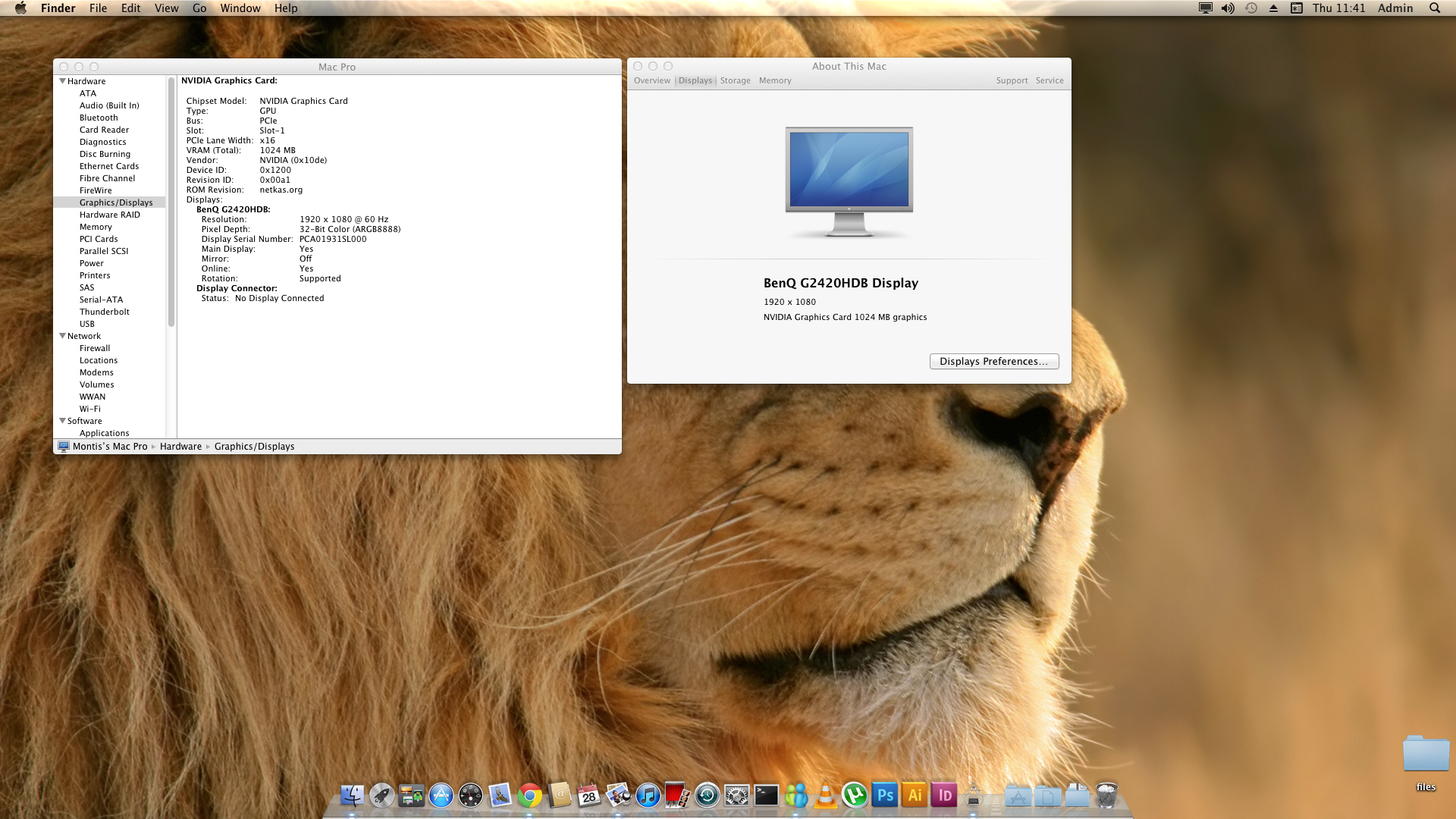

Ajhu Posted July 26, 2011 Share Posted July 26, 2011 HERE'S MY REPORT: GTX 560 Ti 1GB Running Chimera 1.4.1 with GraphicsEnabler=Yes Added Device ID to NVDAGF100Hal.kext Installed CUDA Drivers 4.0.21 Enabled OpenCL with netkas' hexedit to GeForceGLDriver.bundle Added modified info.plist to AppleGraphicsPowerManagement.kext During boot up in verbose mode I would always see that Chimera was correctly identifying my card and loading NVDAGF100Hal.kext Problem 1: Kept getting stuck at [PCI Configuration begin] This was strange because it didn't happen with my old GTX 260 using the same com.apple.Boot.plist minus the EFI string for it. PCIRootUID=0 and PCIRootUID=1 didn't work. Problem 1 Solution: I used npci=0x2000 to get passed it. Problem 2: Lion was now booting up in 1024x768 resolution with 3 MB video memory. I guess I had a malformed character in my com.apple.Boot.plist like zurie said??? Problem 2 Solution: I deleted my Extra folder and reran [url="http://www.insanelymac.com/forum/topic/279450-why-insanelymac-does-not-support-tonymacx86/"]#####[/url] (3.8.0 ) to create a new com.apple.Boot.plist and everything else. Yes I know I could have just deleted my com.apple.Boot.plist but I was desperate at this point. Now I was able to boot into Lion without npci=0x2000 Problem 3: Lion still booted up in 1024x768 resolution with 3 MB video memory. Problem 3 Solution: Created a custom GFX string using OSx86 Tools and added it to the device-properties key in my com.apple.Boot.plist. Lion now booted up in full 1920x1200 resolution with 1024 VRAM!!! YAY I used the following applications to perform OpenGL benchmarks and it seems like my results are slighty low and/or erratic. CINEBENCH 11.5 Xbench 1.3 OpenGL Extensions Viewer 4.0 smallOpenGL FPS Bench V1.3.1 Tried deleting AppleGraphicsPowerManagement.kext with no effect to my bench results. P.S. Keep in mind that I would always rebuild cache and kexts after installing/modifying/deleting any kexts. P.S.S. ALWAYS BACKUP YOUR ORIGINAL KEXTS AND MODIFIED KEXTS! I keep a Kext BU (Modified) and Kext BU (Original) folder for this purpose. EDIT: QUESTION: Is 30 fps in CINEBENCH 11.5 normal for a GTX 560 Ti 1GB? Hi can you tell me what is VRAM string for 1536mb. I'm facing the exact same problem as you did. And i also need to create a custom string for connector. I have HDMI(monitor)-DVI(gtx480) connection and i need know what is the string for HDMI-DVI. Link to comment https://www.insanelymac.com/forum/topic/260074-fermi-5xx-works-with-lion-dp4gm/page/6/#findComment-1723045 Share on other sites More sharing options...

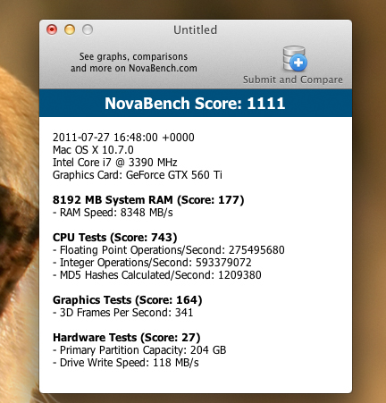

munale874 Posted July 28, 2011 Share Posted July 28, 2011 My graphic card: Geforce GTX 560 Ti 1GB Hi I have followed the guide step by step and im getting 1920x1080 but it feels laggy, and sometimes im experiencing a lag now and then. 1. Edited 0x108110de&0xffe0ffff to 0x120010de&0xffe0ffff 2. Used ATY_Init to get my card recognized. 3. Rebuild cache and kexts. 4. Installed CUDA 5. Enabled Open CL as told on post 1. ( I dont really know how to check if its enabled or not but i did as told) 6. Modify your AppleGraphicsPowerManagement kext with the info.plist (no results) so i did solution 2 7. Remove applegraphicspowermanagement.kext from /System/Library/Extensions. 8. Rebuild cache and kexts. (no results) It seems that i dont get full power from my graphic card. I did a test with NovaBench but i dont get any good results there either. What am i doing wrong? I appreciate all your help. Link to comment https://www.insanelymac.com/forum/topic/260074-fermi-5xx-works-with-lion-dp4gm/page/6/#findComment-1724559 Share on other sites More sharing options...
AdobeEditor Posted July 28, 2011 Share Posted July 28, 2011 My graphic card: Geforce GTX 560 Ti 1GB Hi I have followed the guide step by step and im getting 1920x1080 but it feels laggy, and sometimes im experiencing a lag now and then. 1. Edited 0x108110de&0xffe0ffff to 0x120010de&0xffe0ffff 2. Used ATY_Init to get my card recognized. 3. Rebuild cache and kexts. 4. Installed CUDA 5. Enabled Open CL as told on post 1. ( I dont really know how to check if its enabled or not but i did as told) 6. Modify your AppleGraphicsPowerManagement kext with the info.plist (no results) so i did solution 2 7. Remove applegraphicspowermanagement.kext from /System/Library/Extensions. 8. Rebuild cache and kexts. (no results) It seems that i dont get full power from my graphic card. I did a test with NovaBench but i dont get any good results there either. What am i doing wrong? I appreciate all your help. I have the same card and I feel that it is laggy too. Does yours seem to work a lot smoother after it has been on for a while? Sometimes mine will run perfectly and other times I try to open a fullscreen app or even the time machine window and I hear the fan on the card ramp up and the transition lags (almost like its trying to catch up). I was wondering whether there is anything else that can be done with the power management kext because it seems like that might be the problem. Also, can your hackintosh sleep? Mine will lock after I leave it for a while (I think it is just shutting off the display or something) but if I try to make it sleep on demand it will look like it is working and then it tries to boot back up again...weird. Link to comment https://www.insanelymac.com/forum/topic/260074-fermi-5xx-works-with-lion-dp4gm/page/6/#findComment-1724735 Share on other sites More sharing options...
whitegerry Posted July 28, 2011 Share Posted July 28, 2011 Does yours seem to work a lot smoother after it has been on for a while? Sometimes mine will run perfectly and other times I try to open a fullscreen app or even the time machine window and I hear the fan on the card ramp up and the transition lags (almost like its trying to catch up). I was wondering whether there is anything else that can be done with the power management kext because it seems like that might be the problem. My GT 435m has the same problem as yours in Lion. When dragging a window it will move with little lag just like the video card doesn't work when idle. But after dragging the window here and there quickly everything goes so smoothly. BUT when I use the displayport to connect a VGA everything goes smoothly with no lag. So confused... Link to comment https://www.insanelymac.com/forum/topic/260074-fermi-5xx-works-with-lion-dp4gm/page/6/#findComment-1724753 Share on other sites More sharing options...
munale874 Posted July 28, 2011 Share Posted July 28, 2011 I have the same card and I feel that it is laggy too. Does yours seem to work a lot smoother after it has been on for a while? Sometimes mine will run perfectly and other times I try to open a fullscreen app or even the time machine window and I hear the fan on the card ramp up and the transition lags (almost like its trying to catch up). I was wondering whether there is anything else that can be done with the power management kext because it seems like that might be the problem. Also, can your hackintosh sleep? Mine will lock after I leave it for a while (I think it is just shutting off the display or something) but if I try to make it sleep on demand it will look like it is working and then it tries to boot back up again...weird. Mine works fine the only thing is thats it a bit laggy and its not fully supported yett, i dont know about the fan thing, I will try to listen carefully and return with more info. My sleep dosent work but i think there is a fix for it somewhere in the ths forum. Link to comment https://www.insanelymac.com/forum/topic/260074-fermi-5xx-works-with-lion-dp4gm/page/6/#findComment-1724767 Share on other sites More sharing options...
