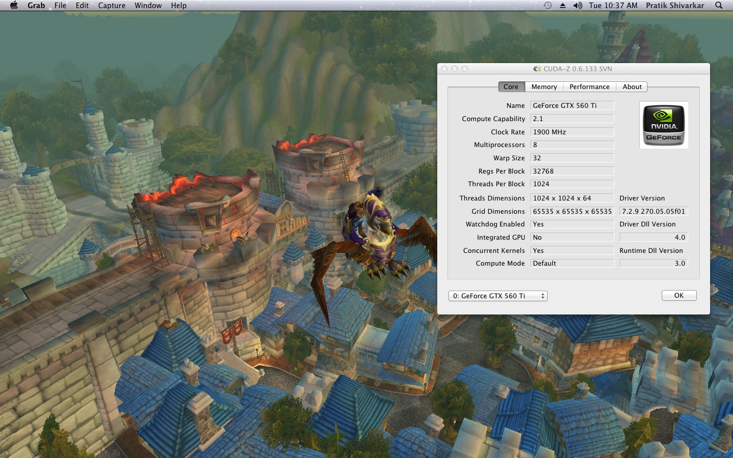

AdobeEditor Posted August 23, 2011 Share Posted August 23, 2011 Works yes!MSI N560GTX-Ti Hawk GeForce GTX 560 Ti Is the best! http://www.newegg.com/Product/Product.aspx...N82E16814127578 950 MHZ What is the 950 MHZ? If this is what you get when you test, how are you testing your setup and how does that compare with other graphics cards with full support already? Thanks much. Link to comment https://www.insanelymac.com/forum/topic/260074-fermi-5xx-works-with-lion-dp4gm/page/8/#findComment-1738814 Share on other sites More sharing options...

jpa Posted August 29, 2011 Share Posted August 29, 2011 What is the 950 MHZ? If this is what you get when you test, how are you testing your setup and how does that compare with other graphics cards with full support already? Thanks much. 52 fps in i7 2600K stock Link to comment https://www.insanelymac.com/forum/topic/260074-fermi-5xx-works-with-lion-dp4gm/page/8/#findComment-1741532 Share on other sites More sharing options...
AdobeEditor Posted August 29, 2011 Share Posted August 29, 2011 52 fps in i7 2600K stock Thanks. Link to comment https://www.insanelymac.com/forum/topic/260074-fermi-5xx-works-with-lion-dp4gm/page/8/#findComment-1741710 Share on other sites More sharing options...
