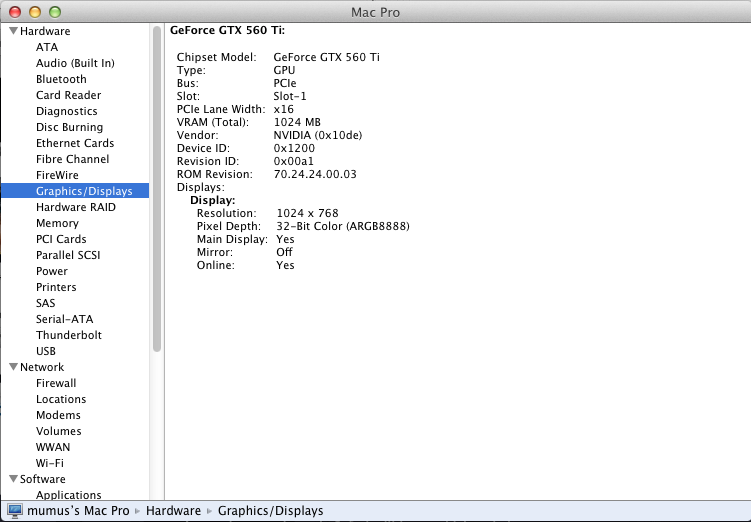

badbonez Posted November 24, 2011 Share Posted November 24, 2011 Hello all – I wanted to write up my process that I had to go through to get my ASUS GTX560 Ti working with Lion 10.7.2. First – thanks to all who wrote up their various solutions. But super big thanks to T. B. B. for starting the thread and Apple Pie for his clear write-up of the problems he had and the solutions he found. Ultimately, that’s what got me to a successful install. To begin: My original card was a GeForce 8800 GT and when I bought the GTX560 Ti I learned it was not going to work with SL. So I began the process of updating to Lion. First, I use iAtkos L2 installed from a USB drive. The only change I made to the stock options was clicking the GF100 box. When I booted into Lion with my original video card, it seemed to be working OK. I didn’t do any Open CL/QE tests but it booted up, no problem. I then swapped cards. When using the 560 it would boot to the Apple logo, but it would not go any farther. I was not getting the spinning wheel icon. In verbose mode (-v) I saw the process was freexzing up at the PCI Configuration Begin point. So after reading from Apple Pie’s post, I used the npci=0x2000 flag and it worked. I was in 1024x768 mode but the system profiler did recognize the 560 and its gig of ram. Now the big problem for a long, long time was trying to figure out how to boot into the system without having to type that flag. It took a lot of fiddling and reading many posts but eventually I figured out the problem when I used [url="http://www.insanelymac.com/forum/topic/279450-why-insanelymac-does-not-support-tonymacx86/"]#####[/url] to write the npci flag to my com.chameleon.org.Boot.plist. What it did was add it to the kernal flag. And when I rebooted, I didn’t need to enter that flag manually. So I modified my boot.plist like this: <key>Kernal Flags</key> <string>npci=0x2000</string> Where the original boot loader looked like this: <key>npci</key> <string>0x2000</string> I don’t know why but that small problem took up several days of my time and many reinstallations of my old video card. So hopefully that tip will help someone. So moving on: Now it’s time to get the system to recognize the card. In the original post TBB talks about editing the NVDAGF100Hal.kext by adding the device ID. I did that, repaired permissions and rebooted and was rewarded with 1680x1050 resolution. Next I downloaded this GeForceGL.bundle: http://www.osx86.net/downloads.php?do=file&id=1761 which includes the fix from Netkas. Theoretically it gives you 100% GPU capabilities. And after rebooting, things looked good. But when I use LuxMark, it would stop at an error. So I took the advice of this post: http://www.insanelymac.com/forum/index.php?showtopic=266318 and now when I run LuxMark there are no errors and I get a score of about 4300 or so (although I don’t know what that means). In between all this I tried many other suggestiongs, like the ATY enabler (didn’t help). And a few other things. But in the end, the key was to edit the Kernal Flags in my Boot.plist. After that I was able to follow the instructions in the OP, download a new geforceGL bundle with the netkas fixes and edited part of that. Seems to be working fine, even the HDMI video is working. So thanks again to all the posters, it helps to see what other people try and then see what works for you. I do have a couple questions: 1) How do I test the FPS? 2) What’s that LuxMark score mean? How would I improver it other than a new CPU? When I run it on a different hard drive with a separate installation of Lion, I get a higher score (5200). 3) Does the HDMI Audio work for anyone? Is it supposed to? Thanks again to all who contributed. PS: If anyone cares, as for audio I am using the same drivers I used in 10.6.2. 1 Link to comment https://www.insanelymac.com/forum/topic/260074-fermi-5xx-works-with-lion-dp4gm/page/11/#findComment-1773242 Share on other sites More sharing options...
