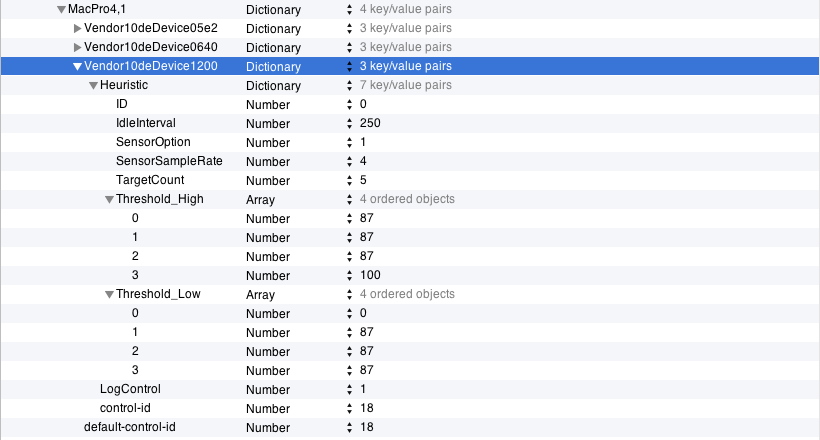

camoguy Posted July 19, 2011 Share Posted July 19, 2011 Instead of throwing AGPM.kext out, I modified it for my card. Once I restarted, my benchmark scores went through the roof. My system is a MacPro4,1 with the GraphicsEnabler=yes option, GraphicsMode 1920x1200x32, I was using dsdt for the graphics solution before but I went back to a regular dsdt file. Link to comment https://www.insanelymac.com/forum/topic/260074-fermi-5xx-works-with-lion-dp4gm/page/3/#findComment-1716887 Share on other sites More sharing options...

Pluskat5000Schiffe Posted July 19, 2011 Share Posted July 19, 2011 Instead of throwing AGPM.kext out, I modified it for my card. Once I restarted, my benchmark scores went through the roof. Thats even more perfect, How did you adjust that file ? My GTX580 has indentifier 1080, in your example you modified a dev id 1200 card. Should I copy your part or another part and adjust the dev id to 1080 and fill in your values ? I kicked AGPM out of the library but I think my card has even more potential because the fans aren't spinning up running Cinebench and the cards stays at ambient temps. Glad I made a copy of the AGPM so I can dig into this tonight. But a little more indepth instructions are realy welcome Off topic: Lion is much more picky regarding overclocking. Windows runs 24 X 7 stable at 4,4Ghz, In lion I had to lower it to 4,1 GHz otherwise I got a panic with geekbench. But hey whatever it hits almost 14000 points. Link to comment https://www.insanelymac.com/forum/topic/260074-fermi-5xx-works-with-lion-dp4gm/page/3/#findComment-1716972 Share on other sites More sharing options...

camoguy Posted July 19, 2011 Share Posted July 19, 2011 Here's my info.plist file from AGPM.kext. My cinebench opengl score was 33 after I added this entry, it was 7 before. I simply copied another entry and created a sibling, also note that in this plist, I enabled LogControl = 1, so my log shows each time the graphics card is switching gears. Last night I played starcraft ii at full effect, amazing! and the fan would spin up gradually, it was perfect, just like windows. Info.plist.zip Link to comment https://www.insanelymac.com/forum/topic/260074-fermi-5xx-works-with-lion-dp4gm/page/3/#findComment-1717084 Share on other sites More sharing options...
VooD Posted July 19, 2011 Share Posted July 19, 2011 Here's my info.plist file from AGPM.kext. My cinebench opengl score was 33 after I added this entry, it was 7 before.I simply copied another entry and created a sibling, also note that in this plist, I enabled LogControl = 1, so my log shows each time the graphics card is switching gears. Last night I played starcraft ii at full effect, amazing! and the fan would spin up gradually, it was perfect, just like windows. Info.plist.zip Great. Then the 560 ti is the way to go Physix in Windows, CUDA in both, OpenCL, and just a bit slower than the 6870 and a bit more power hungry. Link to comment https://www.insanelymac.com/forum/topic/260074-fermi-5xx-works-with-lion-dp4gm/page/3/#findComment-1717096 Share on other sites More sharing options...
