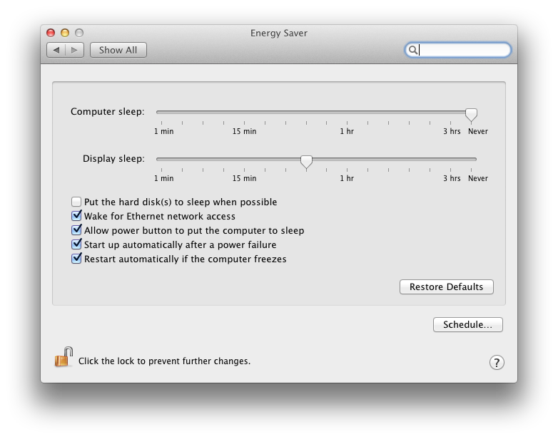

Gringo Vermelho Posted March 8, 2012 Share Posted March 8, 2012 Several users, including myself, have reported that the new drivers break wake from S3 sleep. This is on clean 10.7.3 with GraphicsEnabler=y and a Geforce GTX 460. Wake from S3 was working with the 10.7.3 Nvidia drivers. EDIT I tried this new darkwake kernel flag, did some sporadic reading and it looks like it has to do with Wake-on-LAN? I can't seem to find anywhere what it actually does. With darkwake=1 added to kernel flags, wake from S3 works for me with the new nvidia drivers. This is kind of strange because from what I've found so far, darkwake=1 is the default for darkwake. Maybe it's necessary to set it anyway when running OS X on a PC. Maybe because there's no NVRAM to store settings in like on a real Mac? The log has some mysterious things in it though, what's "special message 1f"? Tea is ready? And what's NVRM, Nvidia-something? Is D3 a power state? Mar 10 14:04:40 Gringos-Mac-Pro kernel[0]: NVRM: 0x702a called in D3 Mar 10 14:04:40 Gringos-Mac-Pro kernel[0]: Mar 10 14:04:57 Gringos-Mac-Pro kernel[0]: Wake reason: UHC3 Mar 10 14:04:57 Gringos-Mac-Pro kernel[0]: The USB device USB Receiver (Port 2 of Hub at 0x5d000000) may have caused a wake by issuing a remote wakeup (2) Mar 10 14:04:57 Gringos-Mac-Pro kernel[0]: Failed to send special message 1f Mar 10 14:04:59 Gringos-Mac-Pro kernel[0]: Ethernet [AppleYukon2]: Link up on en0, 100-Megabit, Full-duplex, Symmetric flow-control, Debug [796d,6f48,0de1,0200,45e1,4000] Mar 10 14:05:03 Gringos-Mac-Pro kernel[0]: 0 0 AppleUSBCDC: start - initDevice failed Link to comment https://www.insanelymac.com/forum/topic/260074-fermi-5xx-works-with-lion-dp4gm/page/13/#findComment-1804505 Share on other sites More sharing options...
