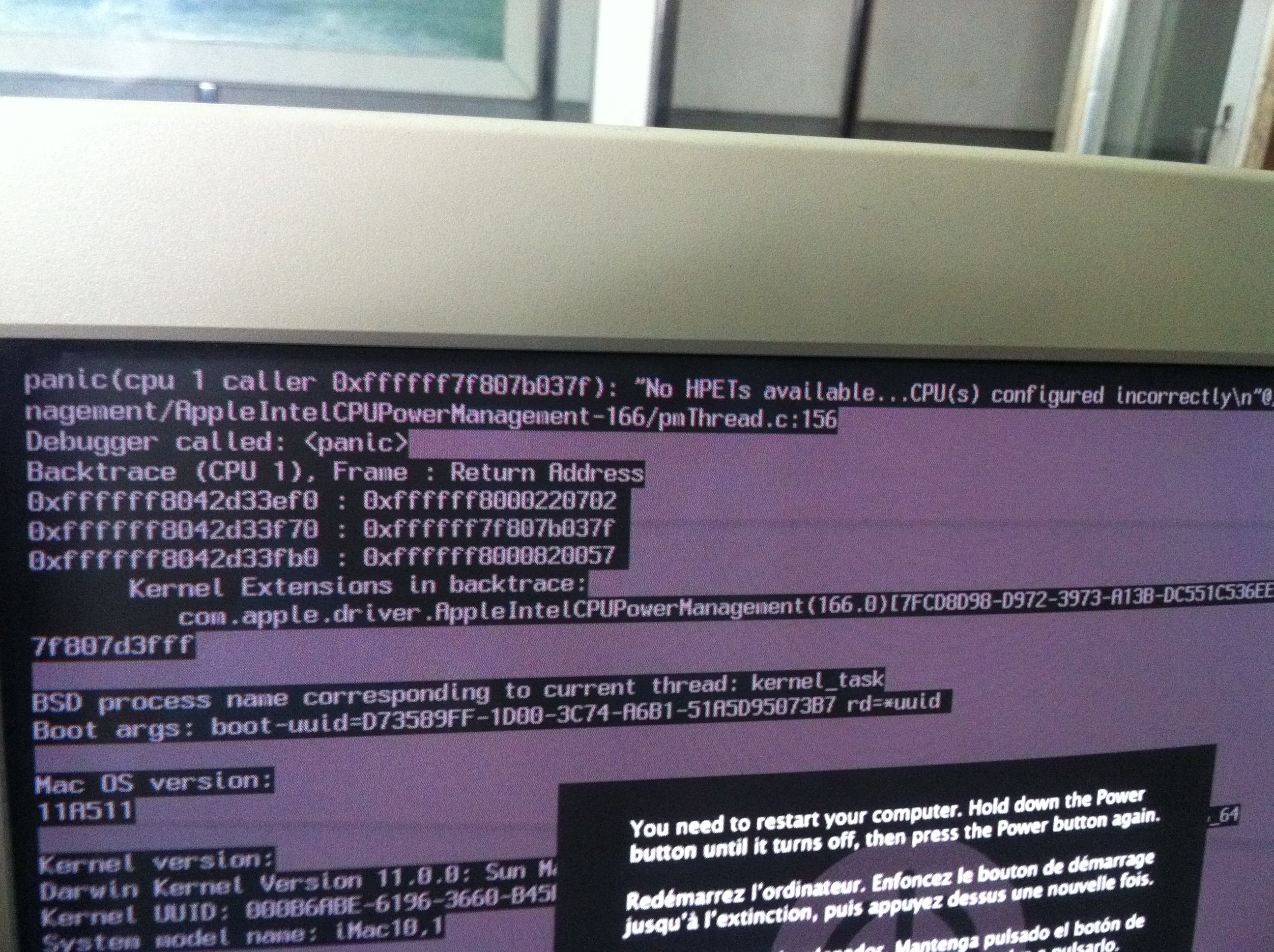

demian12 Posted August 19, 2011 Share Posted August 19, 2011 Hello I followed all the steps without problem, but when booting with the pen usb, sample the following picture: PS: I not generate the: DSDT.aml Link to comment https://www.insanelymac.com/forum/topic/256729-lion-installation-via-usb-stick-using-chameleon/page/47/#findComment-1736986 Share on other sites More sharing options...
MaLd0n Posted August 19, 2011 Author Share Posted August 19, 2011 Hello I followed all the steps without problem, but when booting with the pen usb, sample the following picture: PS: I not generate the: DSDT.aml try with a cpus=1 http://www.insanelymac.com/forum/index.php...t&p=1718824 Link to comment https://www.insanelymac.com/forum/topic/256729-lion-installation-via-usb-stick-using-chameleon/page/47/#findComment-1736988 Share on other sites More sharing options...

demian12 Posted August 19, 2011 Share Posted August 19, 2011 try with a cpus=1 thanks, it worked. Link to comment https://www.insanelymac.com/forum/topic/256729-lion-installation-via-usb-stick-using-chameleon/page/47/#findComment-1737165 Share on other sites More sharing options...

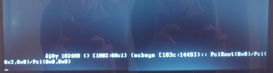

demian12 Posted August 19, 2011 Share Posted August 19, 2011 after installing lion, in the boot load a list of pkg and others, and then this image appears: Ps: the image are 2 parts together Ps2: if you boot with: GraphicsEnabler=No (reboot automatically), graphich card: ati 5650 1gb Link to comment https://www.insanelymac.com/forum/topic/256729-lion-installation-via-usb-stick-using-chameleon/page/47/#findComment-1737358 Share on other sites More sharing options...

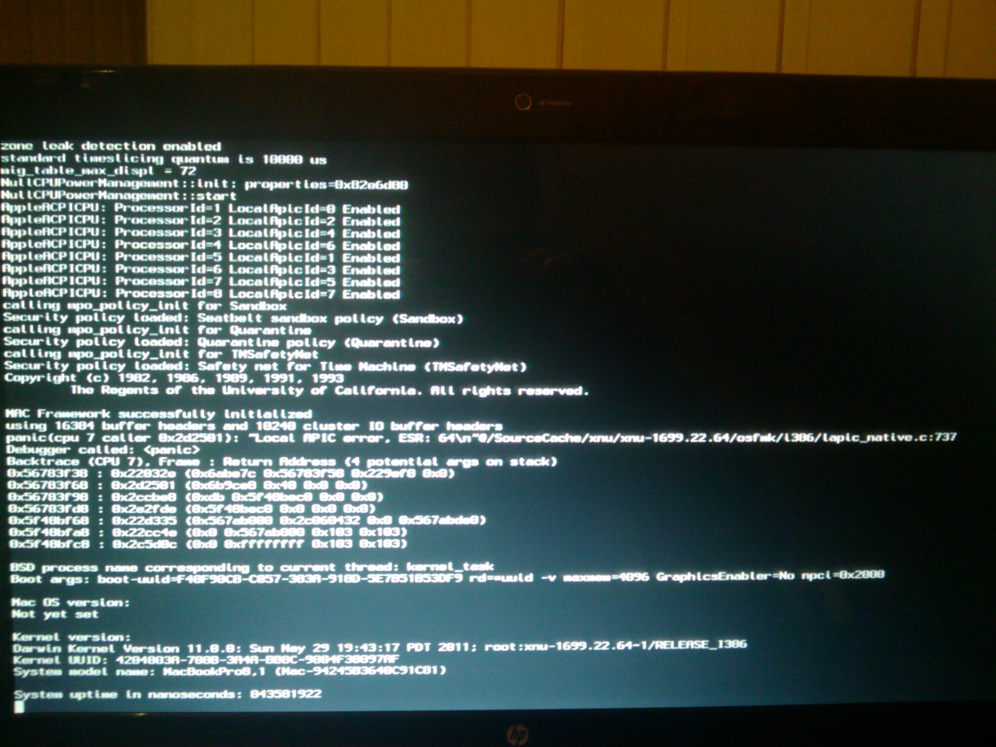

twinstorm Posted August 25, 2011 Share Posted August 25, 2011 Hey everyone xD I got a DV6-6195ca here. And no matter how i try to get it booting, the thing wins all the time and reboots itself without me even seeing a single error. Thinking my dsdt could be at fault here Its got a 2630qm, a radeon 6770m 2 gigs with the usual hd3000. I'm totally at loss here.. this lappy would be a total macbook pro killer if i'd get it up. Any help? Link to comment https://www.insanelymac.com/forum/topic/256729-lion-installation-via-usb-stick-using-chameleon/page/47/#findComment-1739656 Share on other sites More sharing options...
