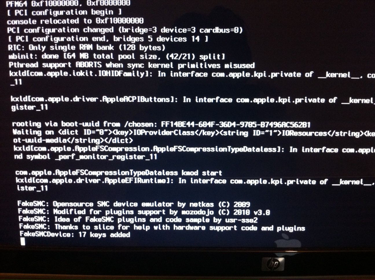

besweeet Posted August 14, 2011 Share Posted August 14, 2011 Followed the guide but I fail when trying to boot the USB Lion Installer... I get the boot menu fine, I choose the Base System USB Partition. It looks like it's going well in verbose mode but the last few messages I see before it freezes are: Previous Shutdown Cause: 3 No interval found for . Using 80000000 nstat_lookup_entry failed: 2 nstat_lookup_entry failed: 2 ACPI_SMC_PlatformPlugin::startForReal - waitForService(resourceMatching(AppleIntelCPUPowerManagement) timed out Transcript Offline - Buffer Pool Allocate [181000] failed DSMOS has arrived After this point computer freezes. My hardware is: ASUS K53E Laptop: Sandy Bridge i5 2410M 6GB Ram (4GB + 2GB) Intel 3000 Graphics I'm using the GM disc image and have followed the above instructions exactly. Any ideas? Thanks Just wanted to let you know that I've experienced the same issue. I was using the VGA port on my MSI H67MA-E35 board (Core i3-2100). Switching to the DVI port resulted in a perfect boot. Link to comment https://www.insanelymac.com/forum/topic/256729-lion-installation-via-usb-stick-using-chameleon/page/45/#findComment-1734489 Share on other sites More sharing options...
