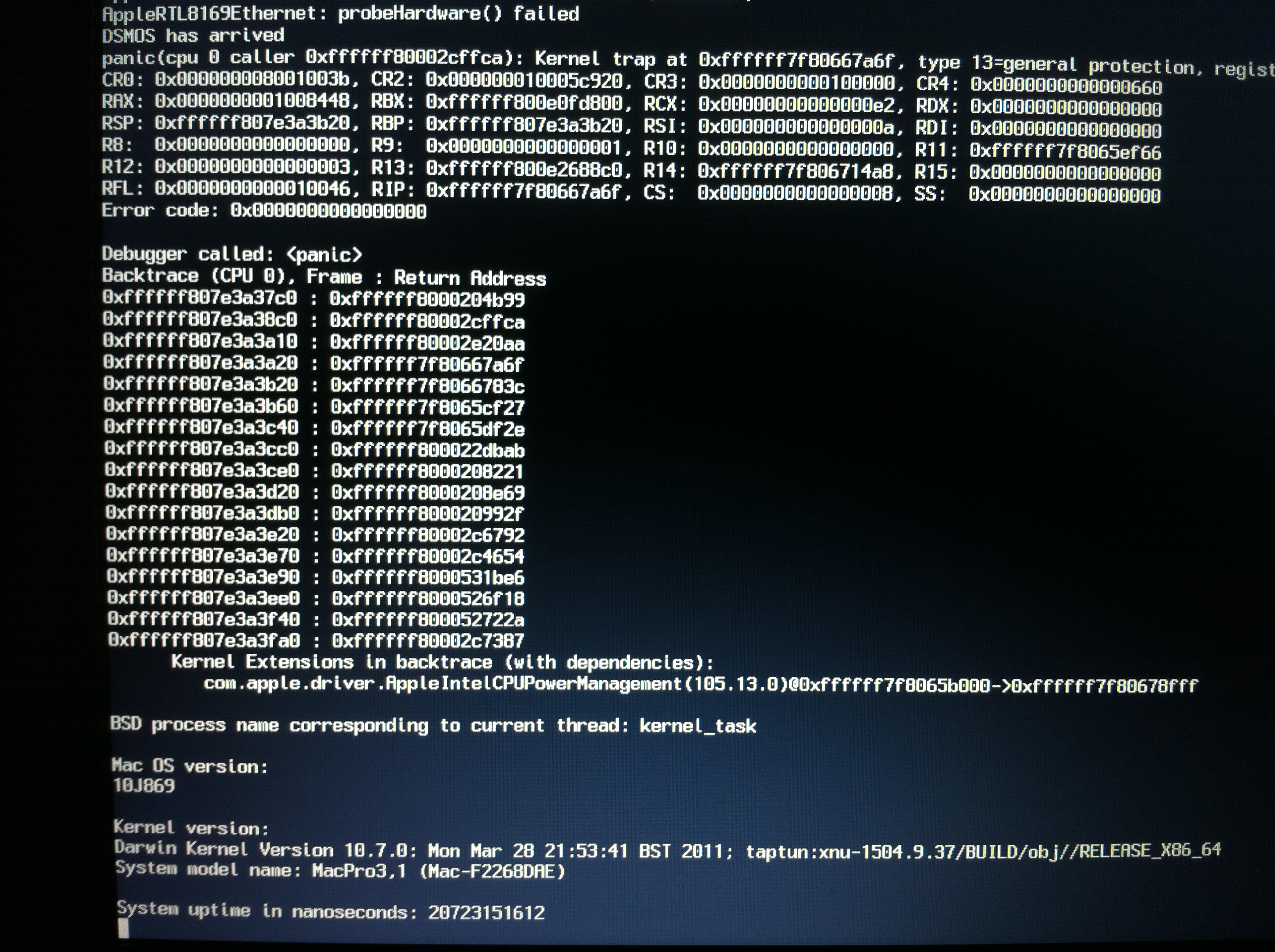

stargex Posted April 11, 2011 Share Posted April 11, 2011 Hey Guys, So I'm coming back to the OSx86 project scene after being away for many years and trying to get my HP Dv6 setup working. I'm currently stuck in two spots. First, I am just trying to get a bootable OS X 10.6.7 install working. I was able to boot into 10.6.3 and update to 10.6.7 as per the guides. Problem now is that I get a kernel panic during boot. Seems to be a problem with the AppleIntelCPUPowerManagement.kext. I have tried using no DSDT and using a clean DSDT I created from Ubuntu and none of them seem to work. I have also tried multiple boot flags and I have not got any of those to work as well. Any ideas? Sorry I'm still a little new to the new processes. They have changed quite a bit since I last tried to create a hack. I have attach a screenshot of the KP in case that helps anyone. Also I have placed my clean DSDT in case someone sees a problem with that. Secondly I am trying to recover my Windows 7 install with SRD as per the guides and the fix Mammoth gave to it. The recovery seemed to work fine; however, now when I boot to Windows 7 I am getting an error that bootmgr is missing. Anyway to fix this? I tried booting into recovery mode from a Windows 7 adding the bootmgr from the disk, setting the partition active, running the Startup repair and then setting the active partition back to chameleon. This allowed me to boot to my Windows 7 recovery; however, I was then unable to attempt to boot back into OS X. Chameleon seemed to complain about being unable to find the kernel. I have since blown this away and have now installed OS X back to the state it was before. So I'm lost at this too. Thanks for any help and all the work everyone has put it! Comp specs are in the sig. DSDT.zip Link to comment https://www.insanelymac.com/forum/topic/250849-guide-mammoth-method-v200-hp-dvx-106x-fast-easy-comprehensive-installation-new-mammoth-boot-cd-for-i5-i3/page/16/#findComment-1668729 Share on other sites More sharing options...
atlee Posted April 11, 2011 Share Posted April 11, 2011 @Mammoth or anybody is it me or the new AppleHDA i'm trying to binpatch but cannot find the ID's, wondering if Apple have moved them? Can't find {censored}e @stargex Looks like you are using a autopatched DSDT? Because Realtek should be 8111D/8168 not 8169. And if i can remember that autopatch for dv6t does a lot of things that is not your model specific. Also i cannot use taptun, so install legacy and use it. legacy boot using busratio=20 i think. If further problems boot with machkernel cpus=1 busratio=20. Link to comment https://www.insanelymac.com/forum/topic/250849-guide-mammoth-method-v200-hp-dvx-106x-fast-easy-comprehensive-installation-new-mammoth-boot-cd-for-i5-i3/page/16/#findComment-1668731 Share on other sites More sharing options...
ddduckman Posted April 11, 2011 Share Posted April 11, 2011 First, I am just trying to get a bootable OS X 10.6.7 install working. I was able to boot into 10.6.3 and update to 10.6.7 as per the guides. Problem now is that I get a kernel panic during boot. Seems to be a problem with the AppleIntelCPUPowerManagement.kext. I have tried using no DSDT and using a clean DSDT I created from Ubuntu and none of them seem to work. I have also tried multiple boot flags and I have not got any of those to work as well. Any ideas? Sorry I'm still a little new to the new processes. They have changed quite a bit since I last tried to create a hack. I have attach a screenshot of the KP in case that helps anyone. Also I have placed my clean DSDT in case someone sees a problem with that. Same problem here, i didn't remember how i fixed it but now it show me the "dsmos has arrived" message, hdd continues to work for 1-2 minutes and than stops. EDIT: Tried with my clean dsdt and without it, no changes same message, no autopatch used. Also tried with legacy and mach kernel, always same message. Link to comment https://www.insanelymac.com/forum/topic/250849-guide-mammoth-method-v200-hp-dvx-106x-fast-easy-comprehensive-installation-new-mammoth-boot-cd-for-i5-i3/page/16/#findComment-1668763 Share on other sites More sharing options...
atlee Posted April 11, 2011 Share Posted April 11, 2011 Same problem here, i didn't remember how i fixed it but now it show me the "dsmos has arrived" message. EDIT: Tried with my clean dsdt and without it, no changes same message, no autopatch used. NULLCPUPowerManagement fixes the kernel panic that you are getting, If your DSDT is not for your system can cause KP's, with a correct DSDT you dont need NULLCPU kext. 2 kext's are needed for a system without a DSDT fakesmc and NULLCPU. then boot using mach_kernel cpus=1 busratio=20 for that core i5 580m or busratio=12 for my core i7 720QM. Link to comment https://www.insanelymac.com/forum/topic/250849-guide-mammoth-method-v200-hp-dvx-106x-fast-easy-comprehensive-installation-new-mammoth-boot-cd-for-i5-i3/page/16/#findComment-1668773 Share on other sites More sharing options...
ddduckman Posted April 11, 2011 Share Posted April 11, 2011 NULLCPUPowerManagement fixes the kernel panic that you are getting, If your DSDT is not for your system can cause KP's, with a correct DSDT you dont need NULLCPU kext. 2 kext's are needed for a system without a DSDT fakesmc and NULLCPU. then boot using mach_kernel cpus=1 busratio=20 for that core i5 580m or busratio=12 for my core i7 720QM. i'm using a clean dsdt generated from my machine. Now my problem is "dsmos has arrived" message... Before updating to the 10.6.7 the system worked fine and it's strange because mammoth said that 10.6.3 is incompatible with i5 Link to comment https://www.insanelymac.com/forum/topic/250849-guide-mammoth-method-v200-hp-dvx-106x-fast-easy-comprehensive-installation-new-mammoth-boot-cd-for-i5-i3/page/16/#findComment-1668784 Share on other sites More sharing options...

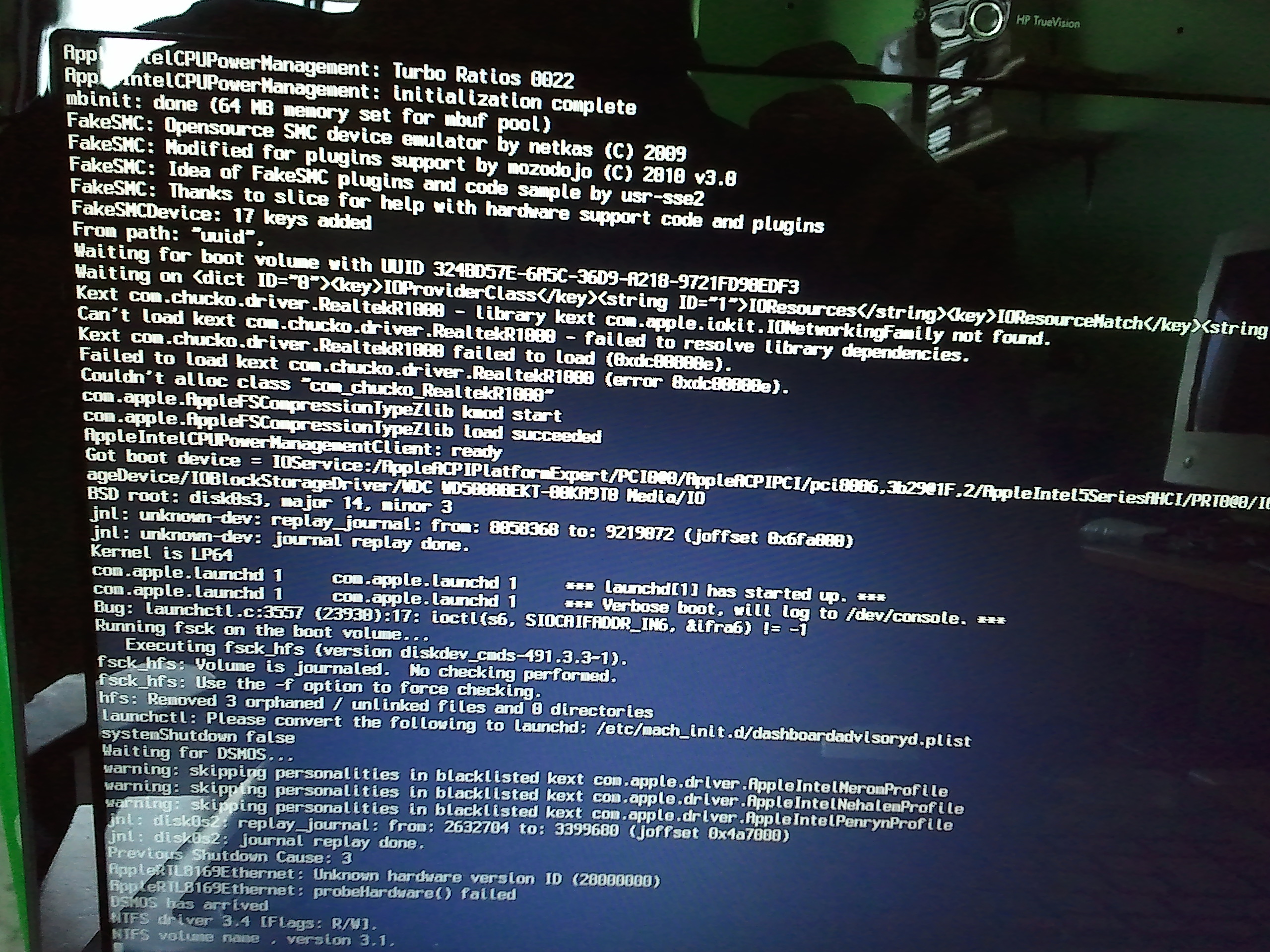

ddduckman Posted April 11, 2011 Share Posted April 11, 2011 back from scratch: Installed 10.6.3 following Mammoth guide (no dsdt, MIIF_DVx_i5i3, Mammoth DVxt Boot CD - v1.15a_i5i3); Snow leopard started perfectly; Changed Boot.plist following guide to use taptune1067 kernel; Installed 10.6.7 combo update; Restart and get this: Link to comment https://www.insanelymac.com/forum/topic/250849-guide-mammoth-method-v200-hp-dvx-106x-fast-easy-comprehensive-installation-new-mammoth-boot-cd-for-i5-i3/page/16/#findComment-1668797 Share on other sites More sharing options...

atlee Posted April 11, 2011 Share Posted April 11, 2011 back from scratch:Installed 10.6.3 following Mammoth guide (no dsdt, MIIF_DVx_i5i3, Mammoth DVxt Boot CD - v1.15a_i5i3); Snow leopard started perfectly; Changed Boot.plist following guide to use taptune1067 kernel; Installed 10.6.7 combo update; Restart and get this: This screenshot shows everything loading, you did not screenshot the KP error? i'm using a clean dsdt generated from my machine.Now my problem is "dsmos has arrived" message... Before updating to the 10.6.7 the system worked fine and it's strange because mammoth said that 10.6.3 is incompatible with i5 What Mammoth says is true, it's either DSDT or kext related or you have a hardware id that isn't liked by the kernel but i doubt the hardware id thing. @Mammoth will rework my DSDT got sleep to work but i think it's conflicting with LID0 fix, will look into it. Will redo DSDT from scracth again easier from ground up. then you can post it to DSDT library. I can't seem to get my gfx card to work through the dsdt. I'm still using GraphicsEnabler=yes. Any ideas (steps) on how to do this? To be honest I've not looked through the guide lately, so it could be there. Just download DSDT already made inside the MIIF's section and then look for the Nvidia fix, a long with nvidia fix the brightness fix is for your card too, a long with OS definition patch also. Link to comment https://www.insanelymac.com/forum/topic/250849-guide-mammoth-method-v200-hp-dvx-106x-fast-easy-comprehensive-installation-new-mammoth-boot-cd-for-i5-i3/page/16/#findComment-1668811 Share on other sites More sharing options...
stargex Posted April 11, 2011 Share Posted April 11, 2011 @stargexLooks like you are using a autopatched DSDT? Because Realtek should be 8111D/8168 not 8169. And if i can remember that autopatch for dv6t does a lot of things that is not your model specific. Also i cannot use taptun, so install legacy and use it. legacy boot using busratio=20 i think. If further problems boot with machkernel cpus=1 busratio=20. @Atlee, Actually my DSDT was created clean using Ubuntu. Thought this was supposed to create a clean DSDT that should work for my system.... Sorry still new to DSDTs. @all I'll try out what everyone suggested and see it it works for me tonight. Thanks! Link to comment https://www.insanelymac.com/forum/topic/250849-guide-mammoth-method-v200-hp-dvx-106x-fast-easy-comprehensive-installation-new-mammoth-boot-cd-for-i5-i3/page/16/#findComment-1668836 Share on other sites More sharing options...
ddduckman Posted April 11, 2011 Share Posted April 11, 2011 This screenshot shows everything loading, you did not screenshot the KP error? the problem is that it does not go beyond this screen, it remains stuck here Link to comment https://www.insanelymac.com/forum/topic/250849-guide-mammoth-method-v200-hp-dvx-106x-fast-easy-comprehensive-installation-new-mammoth-boot-cd-for-i5-i3/page/16/#findComment-1668843 Share on other sites More sharing options...

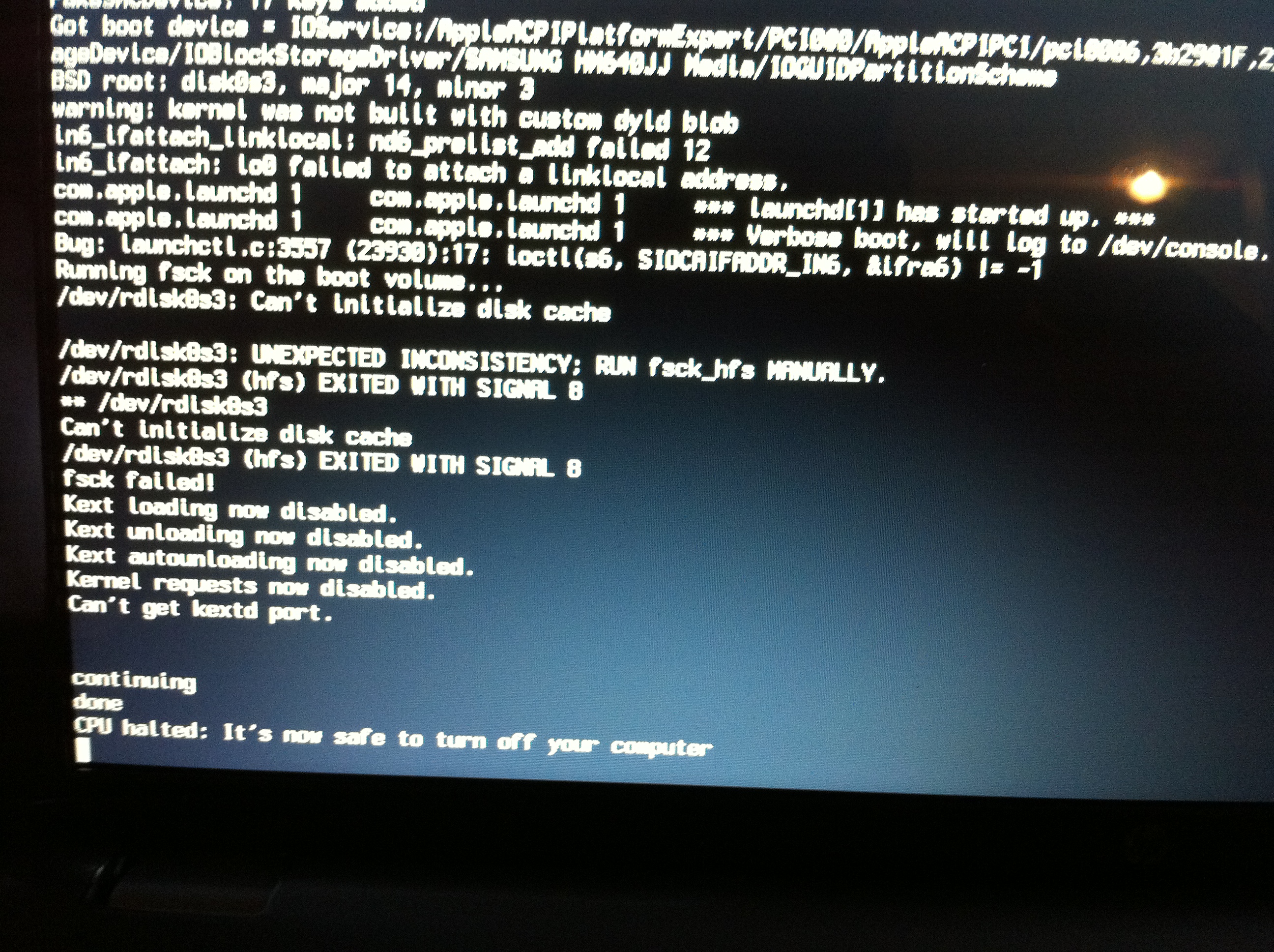

stargex Posted April 12, 2011 Share Posted April 12, 2011 Well I got a little farther today. I tried using the legacy_kernel; however, I couldn't get that to work using busratio=20 (20 for my CPU). I then tried cpus=1 busratio=20 and that didn't work. I took a picture of the output I got. Little blurry as the screen is only on for a few seconds before a reboot. I also had the same problem while booting to 10.6.3. Bilieved this was also using the legacy_kernel since I am using the MIIF i5i3. In order to get that to boot I had use the arguments "-v maxmem=4096 arch=i386". Problem is I was unable to use my trackpad (I have only ever been able to use it once and that was via the i5i3 boot cd), any USB, or keyboard. So I couldn't go any farther. I then tried the mach_kernel; however I couldn't get anything going with that at all. Seemed to be unable to find the right version i think. I can grab a picture of it if it would help. Anyone have any ideas. I'm completely at a loss. I tried this all with and without the DSDT I made earlier... Link to comment https://www.insanelymac.com/forum/topic/250849-guide-mammoth-method-v200-hp-dvx-106x-fast-easy-comprehensive-installation-new-mammoth-boot-cd-for-i5-i3/page/16/#findComment-1669014 Share on other sites More sharing options...
