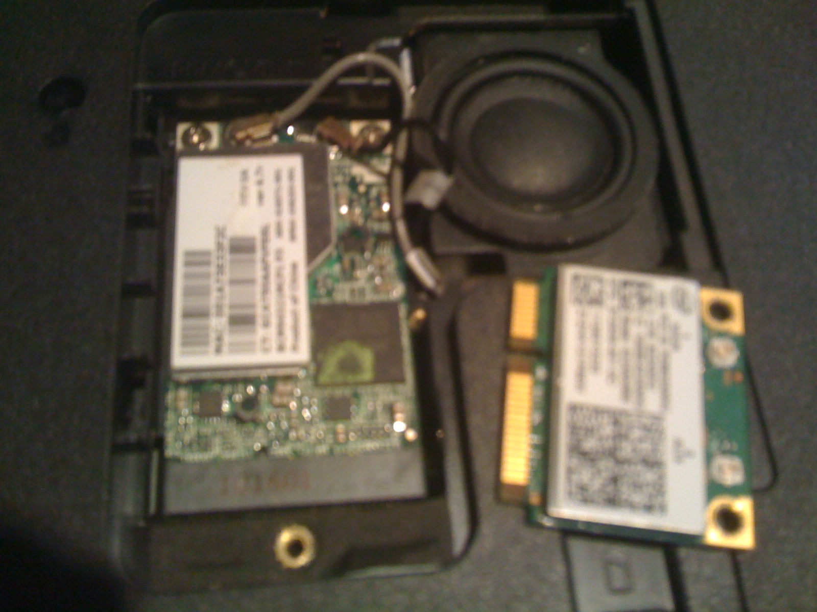

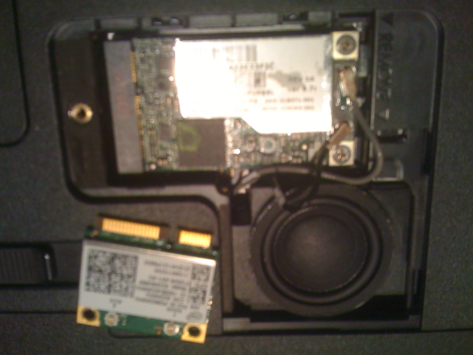

dgrx Posted April 3, 2011 Share Posted April 3, 2011 Does it work? Btw, where did you get that card from? .HP Compatible AR5BXB92 New Apple Original wireless wifi card Atheros AR5BXB92 Found these on ebay. Have not received the card yet. Expecting it some time this week, got an email saying it's on the way. The HP Compatible one list some DVx's that it works native with. Does not list my DVx, but I'm keeping my fingers crossed. If it does not work natively franky-402 said he has it working on his DVx with the BIOS Mod in the guides. Mammoth also said that any airport card will work, that's the other link. Found this one to..... it's for a Dell, but it's the same chip set and a half mini card With the BIOS Mod ? Atheros Half ar9280 wireless wifi n card 300m Dual-Band I cannot confirm these work, because I have not received it yet, but franky-402 had luck with one. I ordered the "HP Compatible One". Link to comment https://www.insanelymac.com/forum/topic/250849-guide-mammoth-method-v200-hp-dvx-106x-fast-easy-comprehensive-installation-new-mammoth-boot-cd-for-i5-i3/page/11/#findComment-1665321 Share on other sites More sharing options...
