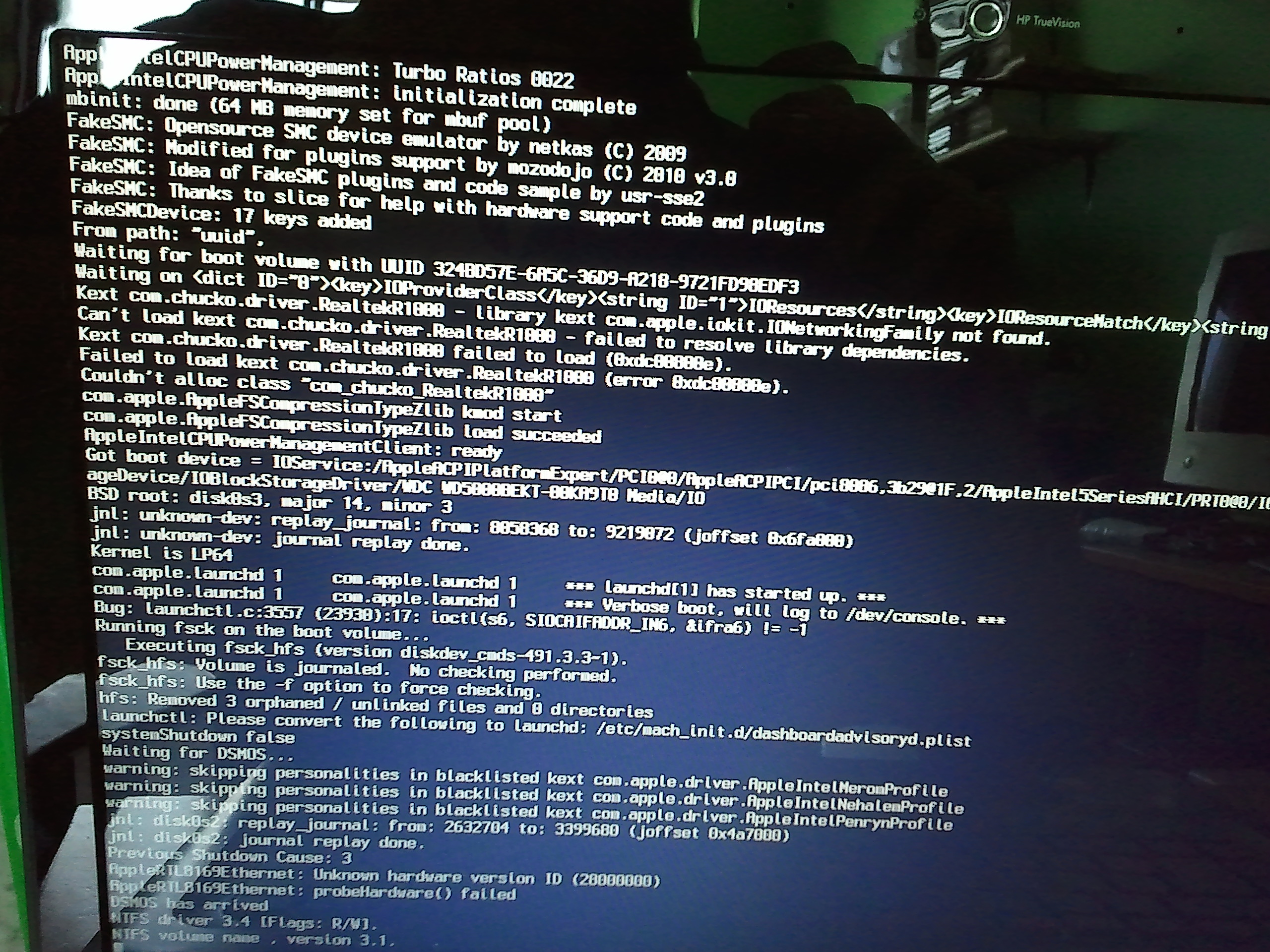

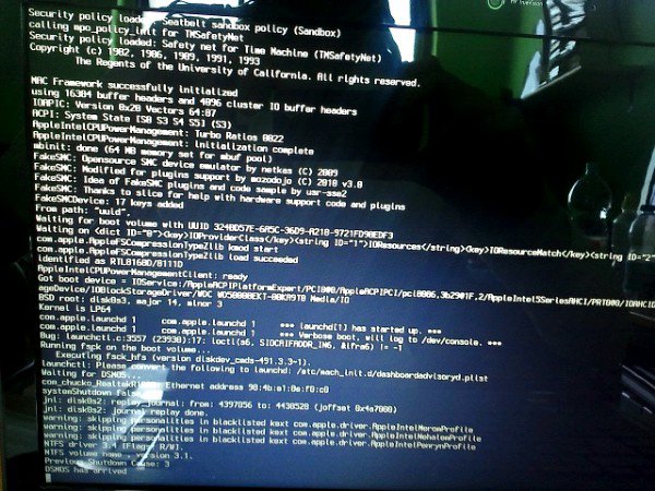

ddduckman Posted April 12, 2011 Share Posted April 12, 2011 help... After Atlee's answer i'm going crazy... how is possible that there are no errors in this screenshot? after the update is this what i get.... Link to comment https://www.insanelymac.com/forum/topic/250849-guide-mammoth-method-v200-hp-dvx-106x-fast-easy-comprehensive-installation-new-mammoth-boot-cd-for-i5-i3/page/17/#findComment-1669212 Share on other sites More sharing options...

atlee Posted April 13, 2011 Share Posted April 13, 2011 help... After Atlee's answer i'm going crazy... how is possible that there are no errors in this screenshot? after the update is this what i get.... that's normal loading procedure, if it stops at NTFS it finds an NTFS drive attached, if it pauses there, are you messing around with graphics? i can see your Realtek network kext is not loading. no panics here. what error can you see? Hi oskr,i found that "Device (HDAU)" is not added in your DSDT so i added it, try the attached DSDT and give me a feedback oskr_s_dsdt.zip why are you adding a Device to a DSDT that did not originally support it? if it does not support it, just add the HDMI DSM method below either HDM1, 2 or 3 you can add it to all. EXAMPLE: Before Device (HDM1) { Name (_ADR, 0x0210) Method (_DCS, 0, NotSerialized) { Store ("HDMI TV -- _DCS", Debug) If (HDT1) { Return (0x1F) } Else { Return (0x1D) } } Method (_DGS, 0, NotSerialized) { Store ("HDMI TV -- _DCS", Debug) If (HDT1) { Return (One) } Else { Return (Zero) } } Method (_DSS, 1, NotSerialized) { Store ("HDMI TV -- _DSS", Debug) } } After Device (HDM1) { Name (_ADR, 0x0210) Method (_DCS, 0, NotSerialized) { Store ("HDMI TV -- _DCS", Debug) If (HDT1) { Return (0x1F) } Else { Return (0x1D) } } Method (_DGS, 0, NotSerialized) { Store ("HDMI TV -- _DCS", Debug) If (HDT1) { Return (One) } Else { Return (Zero) } } Method (_DSS, 1, NotSerialized) { Store ("HDMI TV -- _DSS", Debug) } Method (_DSM, 4, NotSerialized) { Store (Package (0x02) { "hda-gfx", Buffer (0x0A) { "onboard-1" } }, Local0) DTGP (Arg0, Arg1, Arg2, Arg3, RefOf (Local0)) Return (Local0) } } Link to comment https://www.insanelymac.com/forum/topic/250849-guide-mammoth-method-v200-hp-dvx-106x-fast-easy-comprehensive-installation-new-mammoth-boot-cd-for-i5-i3/page/17/#findComment-1669535 Share on other sites More sharing options...
ddduckman Posted April 13, 2011 Share Posted April 13, 2011 that's normal loading procedure, if it stops at NTFS it finds an NTFS drive attached, if it pauses there, are you messing around with graphics? i can see your Realtek network kext is not loading. no panics here. what error can you see? i have another partition NTFS with windows 7, could be this the problem? hangs on the line ntfs Link to comment https://www.insanelymac.com/forum/topic/250849-guide-mammoth-method-v200-hp-dvx-106x-fast-easy-comprehensive-installation-new-mammoth-boot-cd-for-i5-i3/page/17/#findComment-1669556 Share on other sites More sharing options...
atlee Posted April 13, 2011 Share Posted April 13, 2011 i have another partition NTFS with windows 7, could be this the problem?hangs on the line ntfs NTFS loading is normal but if your loading is pausing it's either a kext or chamelon preventing it going to the desktop, if you have ati card, specifically 5000 series, remove ati5000controller, atisupport,atiframebuffer then reboot using graphicsenabler=no, it should make it to the desktop. you have to tell me your specs so i can isolate the problem. I bet you if you had sharing enabled you can VNC in your Mac and look around, this would definitely tell you it's kext related. @Mammoth,3 things on my list and we have a model which can be added to the complete list. Sound still working on, GFX works but still dodgy ass drivers, finger print sensor i will look into this. Apart from that everything else is great. i will be spending a lot more time in this thread helping others but i do have a lot of study work to do. few more units till my degree. Link to comment https://www.insanelymac.com/forum/topic/250849-guide-mammoth-method-v200-hp-dvx-106x-fast-easy-comprehensive-installation-new-mammoth-boot-cd-for-i5-i3/page/17/#findComment-1669560 Share on other sites More sharing options...

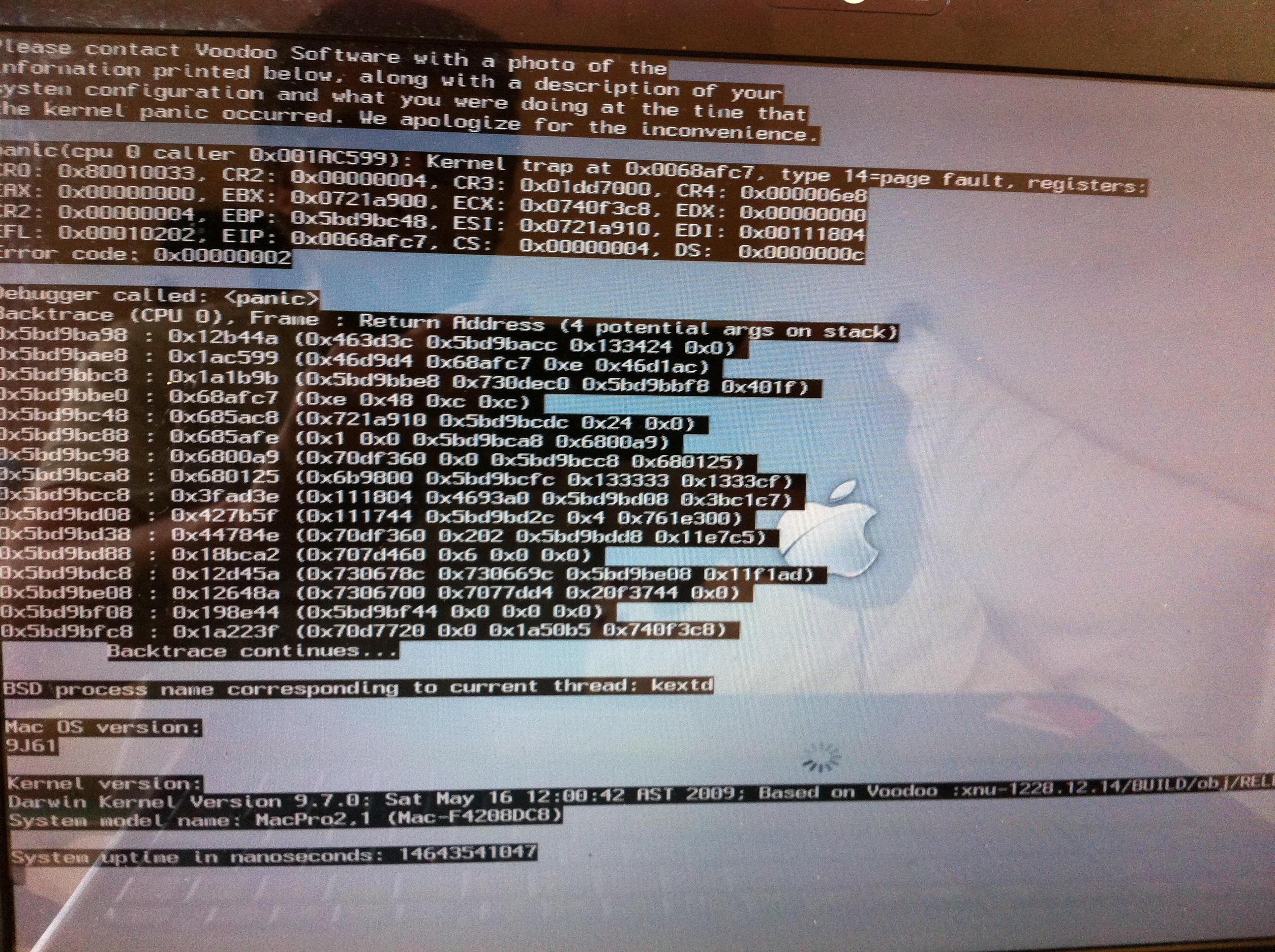

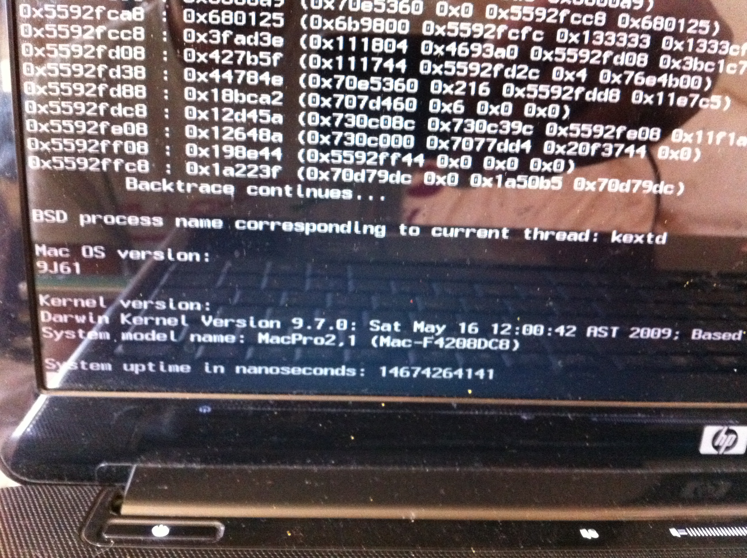

ddduckman Posted April 13, 2011 Share Posted April 13, 2011 NTFS loading is normal but if your loading is pausing it's either a kext or chamelon preventing it going to the desktop, if you have ati card, specifically 5000 series, remove ati5000controller, atisupport,atiframebuffer then reboot using graphicsenabler=no, it should make it to the desktop. you have to tell me your specs so i can isolate the problem. I bet you if you had sharing enabled you can VNC in your Mac and look around, this would definitely tell you it's kext related. my specs are in my sign i've ATI 6550 mobility series, i'll try and let you know Link to comment https://www.insanelymac.com/forum/topic/250849-guide-mammoth-method-v200-hp-dvx-106x-fast-easy-comprehensive-installation-new-mammoth-boot-cd-for-i5-i3/page/17/#findComment-1669610 Share on other sites More sharing options...
atlee Posted April 13, 2011 Share Posted April 13, 2011 my specs are in my sign i've ATI 6550 mobility series, i'll try and let you know Startup using -s flag. /sbin/mount -uw / rm -Rf /System/Library/Extensions/ATI5000Controller.kext rm -Rf /System/Library/Extensions/ATISupport.kext rm -Rf /System/Library/Extensions/ATIFramebuffer.kext rm -Rf /System/Library/Extensions/ATIRadeonX3000.kext reboot Startup using GraphicsEnabler=No flag. If this gets you to desktop then the Chamelon does not have your card id and it is trying to load ATI kexts. Have you tryed using Lion DP2 kexts? Then booting with Kabyl's RC5 branch and using the flag ATIConfig=RadeonFramebuffer. Or even MBP2011 kexts booting with that Radeon framebuffer. Link to comment https://www.insanelymac.com/forum/topic/250849-guide-mammoth-method-v200-hp-dvx-106x-fast-easy-comprehensive-installation-new-mammoth-boot-cd-for-i5-i3/page/17/#findComment-1669614 Share on other sites More sharing options...
ddduckman Posted April 13, 2011 Share Posted April 13, 2011 Startup using -s flag./sbin/mount -uw / rm -Rf /System/Library/Extensions/ATI5000Controller.kext rm -Rf /System/Library/Extensions/ATISupport.kext rm -Rf /System/Library/Extensions/ATIFramebuffer.kext rm -Rf /System/Library/Extensions/ATIRadeonX3000.kext reboot Startup using GraphicsEnabler=No flag. Here it is.... Link to comment https://www.insanelymac.com/forum/topic/250849-guide-mammoth-method-v200-hp-dvx-106x-fast-easy-comprehensive-installation-new-mammoth-boot-cd-for-i5-i3/page/17/#findComment-1669637 Share on other sites More sharing options...
