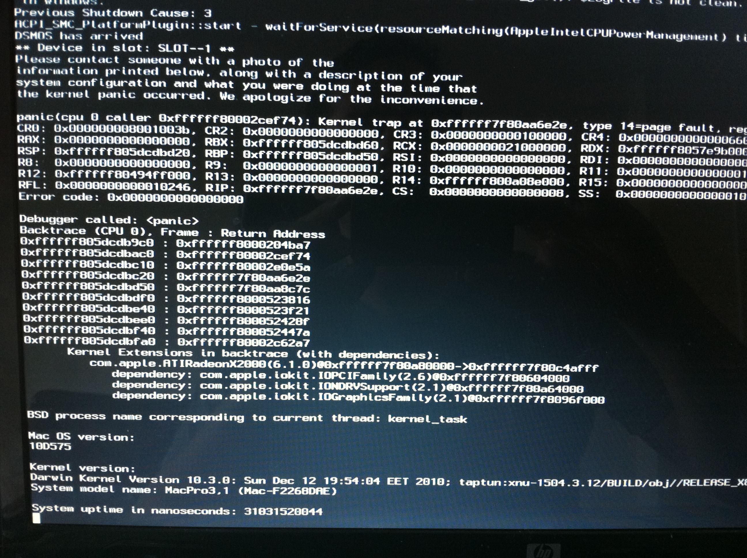

pablo101 Posted April 1, 2011 Share Posted April 1, 2011 Hi All, Alright, managed to get past that boot1: error. Issue I have now is, after updating to 10.6.6, OS does not boot, it gets stuck at a line which says "System uptime in nanoseconds: 40294268705" With the x's being the time taken for it but it just stays there. This is for the 10.6.6 taptun kernel. When I try to boot using the MIID which has the legacy kernel, I am able to boot into the system but my mouse and keyboard do not work. Neither do USB ports. Any ideas? Thanks in advance. Did you replace the com.boot.plist as instructed when finishing the 10.6.6 update? Try re-booting with the kernel flag taptun1063_kernel so you will be using the 10.6.3 kernel, will throw some errors but will work... then you can try diagnosing! Link to comment https://www.insanelymac.com/forum/topic/250849-guide-mammoth-method-v200-hp-dvx-106x-fast-easy-comprehensive-installation-new-mammoth-boot-cd-for-i5-i3/page/10/#findComment-1664608 Share on other sites More sharing options...

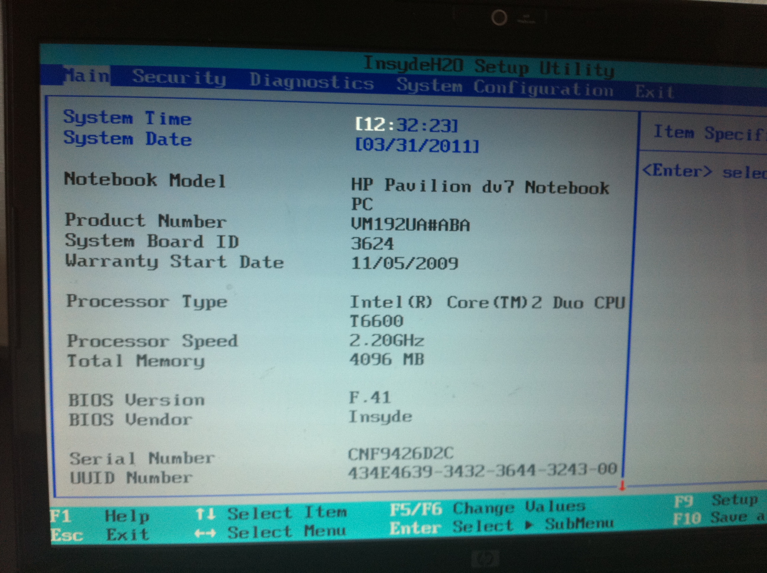

franky_402 Posted April 1, 2011 Share Posted April 1, 2011 Thanks for the info guys! Mammoth is correct, at least for my DV7. Went digging in hp online manuals, and found that the blue tooth is a separate module Pulled the broadcom 43225 card out.... and rebooted. I still had functional bluetooth in osx. Ordered an HP Compatible AR5BXB92 from ebay. I going to try just popping it in without the bios mod first, and see what happens. I'll give and update after it arrives. Great, love to hear how it works out, this would be excellent information for the front page so everyone knows there options with wireless cards. Link to comment https://www.insanelymac.com/forum/topic/250849-guide-mammoth-method-v200-hp-dvx-106x-fast-easy-comprehensive-installation-new-mammoth-boot-cd-for-i5-i3/page/10/#findComment-1664624 Share on other sites More sharing options...
bradholland Posted April 2, 2011 Share Posted April 2, 2011 Hey Guys. Im getting a KP on cd boot. First i'll explain. I have followed the guides and created my MIID, all is ok there. obviously with my machine not being a dv8 I dont have a proper DSDT. the device wouldnt boot without the dsdt so I followed mammoths advice and created my DSDT.aml from the ubuntu live cd. I placed this into my MIID but still get the same KP. As far as i can tell its the GFX driver thats flaking out on me. Here is a screenshot of my KP. and here is a screen shot of my BIOS info (just in case it helps) I have attached my DSDT.aml just in case its something that someone can help me with straight off the bat. Of course as i get this closer to fully working I will share this with others who have the same machine as me. thanks for any assistance you can offer guys. Best, Brad P.s. Just reaslised, I think im the longest running member in this thread. Cant believe how many members there are on this site now. Link to comment https://www.insanelymac.com/forum/topic/250849-guide-mammoth-method-v200-hp-dvx-106x-fast-easy-comprehensive-installation-new-mammoth-boot-cd-for-i5-i3/page/10/#findComment-1664716 Share on other sites More sharing options...
ekwj Posted April 2, 2011 Share Posted April 2, 2011 Did you replace the com.boot.plist as instructed when finishing the 10.6.6 update? Try re-booting with the kernel flag taptun1063_kernel so you will be using the 10.6.3 kernel, will throw some errors but will work... then you can try diagnosing! Yupp, did replace the com.boot.plist and that's when it didn't wanna boot. I got that error with the taptun 1066 kernel. The taptun 1063 kernel would put my comp into an infinite boot loop like it did with the original 1.15a boot DVD so I had to use the legacy_kernel from Nawcom. Will have a look at Nawcom's boot and see what files in there I could use to help. Will report on how things go =D Thanks for the help Pablo. Update: After sticking with the Nawcom legacy_kernel. I have a working 10.6.6. Unfortunately taptun 1063 and 1066 doesn't work for my system. 1063 puts my laptop on an infinite boot loop and 1066 just would not boot. Mouse and keyboard works by using IOUSBFamily & IOUSBMassStorage kexts from 10.6.3. I placed them in C/E/E and ran ChamExtUp and it worked =] Further Update: Lotsa things not working. Will need lots of work to get this machine working properly. Below's a list of things that I know don't work at the moment. 1) Sleep doesn't work, tried a sleepenabler kext as well as swapped from mode 3 to mode 0 for the sleep setting. 2) Wifi on my Atheros AR5B95 doesn't work although I did get it showing up on my top bar once and it was able to find networks. After restarting my computer, it shows as airport off. So no idea what's happened there. 3) Sound isn't working, but it's worked before so it's prob just a matter of finding the right kext. 4) ATI GPU yet to be worked on. Again, this is a matter of getting the right kext as Atlee's done it. 5) 2 out of 3 USB ports working. Two on the right works while the sole port on the left doesn't. So yeah... looks like a lot of work. =[ Link to comment https://www.insanelymac.com/forum/topic/250849-guide-mammoth-method-v200-hp-dvx-106x-fast-easy-comprehensive-installation-new-mammoth-boot-cd-for-i5-i3/page/10/#findComment-1664718 Share on other sites More sharing options...
