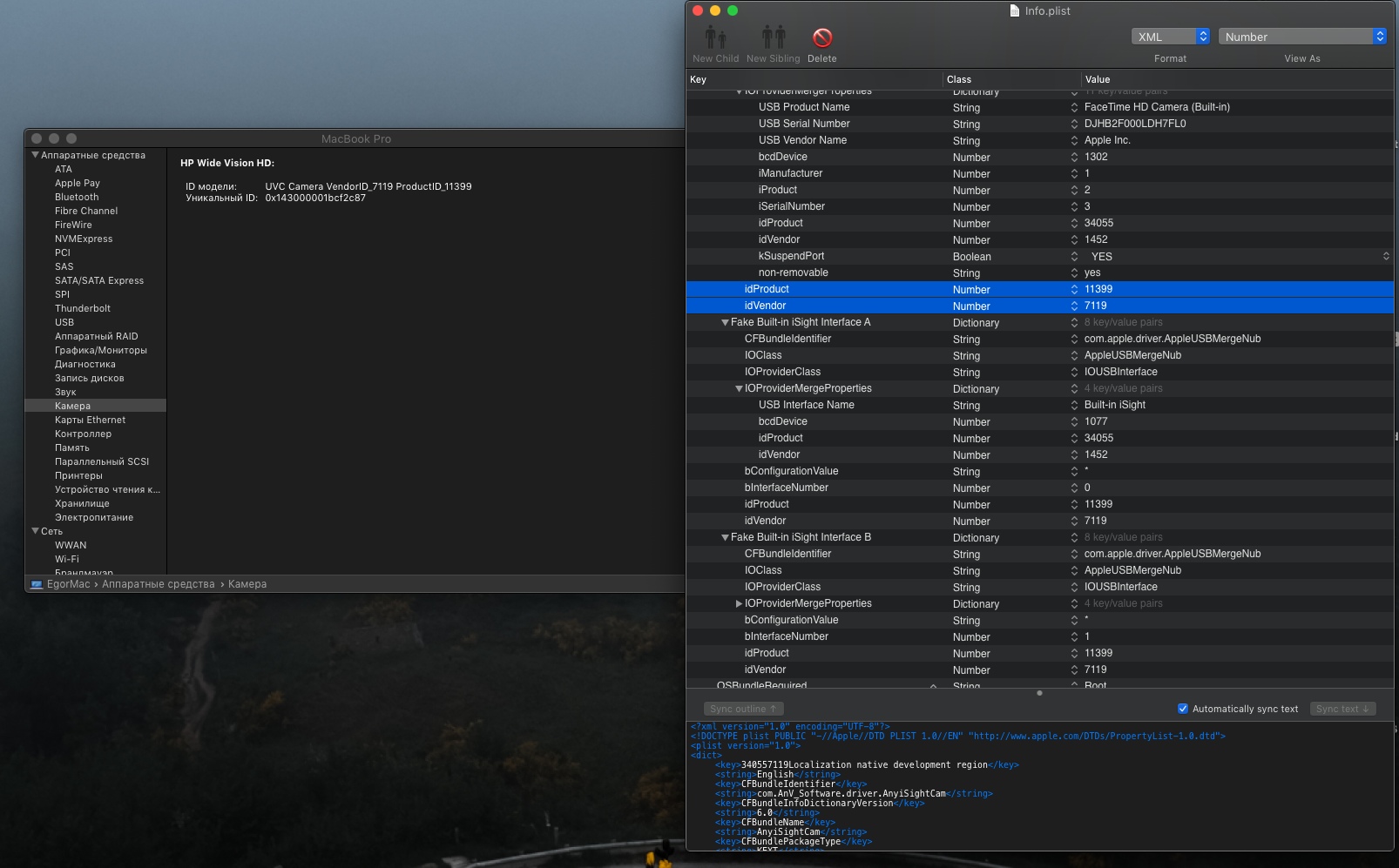

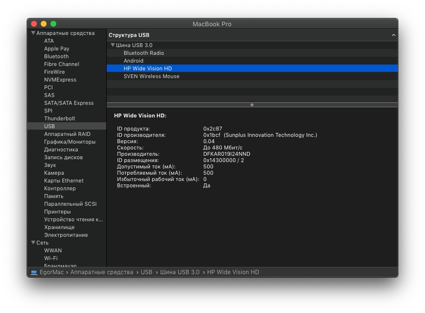

Drovosek Posted July 5, 2019 Share Posted July 5, 2019 I tried to use the AnyiSightCam.kext cake in Info.plist, which replaced VendorID and ProductID values with those specified in the system report about my camera, but nothing has changed. I tried to put this kext only in / kexts / Other, then I deleted it and moved it to / S / L / E, then I deleted it and put it in / L / E. Between these iterations, I reset the cache of cache and reboot the laptop, but nothing has changed. My webcam in the HP Pavilion 15-au028ur laptop is recognized in Hackintosh as HP Wide Vision HD and in Windows 10 it can take photos and videos in HD as 1280x720, but in macOS Mojave 10.14.5 in PhotoBooth the photos are 640x426 . I never managed to get the camera to take photos and videos in HD format. Maybe there are some ideas how to fix this? P.S. In principle, in Windows 10, photos and videos are grainy, so maybe HP lied and in fact there is a poor quality photo module inside and using drivers they make Windows think that it is an HD camera and therefore it takes pictures in this size, but this is just my hypothesis. Spoiler https://pp.userapi.com/c855032/v855032856/82dca/pCYbjYhD8dk.jpg https://pp.userapi.com/c855032/v855032856/82dd4/fAq_aRfX7rs.jpg Link to comment https://www.insanelymac.com/forum/topic/238847-get-your-uvc-webcam-working-as-apple-isight/page/4/#findComment-2680337 Share on other sites More sharing options...
