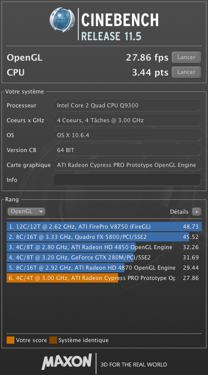

Altimeter88 Posted October 24, 2010 Share Posted October 24, 2010 I am looking to get a 5870 this week to replace my 4890 on my hackintosh. Three quick questions after reading through this forum before taking the plunge: 1. Any problems with running my Dell u2711 at full res 2560x1440 (saw a few posts w/high res issues here). 2. Are there any known "bad" 5870s, or 5870s to avoid due to incompatibilities? It seems like most work even the 6-port 2gb eyefinity versions but I don't want to buy the wrong brand or overclocked card if there are some known "don't buy this particular 5870 because it doesn't seem to work in OSX like brand X does..." 3. Cinebench scores seem to be kinda low right now ~30 not sure why, the new 2010 Mac Pro Hex's are scoring ~50. Is this possibly due to the Mac Pro's having Hex cores/lots of RAM vs. some lower specked hackintoshes here possibly with dual cores/lower specs or does it appear to be a slight incompatibility with the OSX driver + non Apple spec'd 5870? Thanks guys, great progress so far. Here are my specs: Gigabyte X58A-UD5, Intel 930@3.53Ghz, 12GB RAM, ATI 4890, Vertex 2/Corsair Force SSDs, OSX and Win7x64, Dell U2711, Dell 2405. Link to comment Share on other sites More sharing options...

Altimeter88 Posted October 25, 2010 Share Posted October 25, 2010 concrete evidence for > 50 fr ? Sorry I was mistaken, I checked the youtube video again and yes a fully decked out 2010 Mac Pro 12-core w/5870 scored just over 30: Anyway if anyone knows if an overclocked MSI 5870 Lightning II will work I am thinking of getting that one and if there are known problems running dual monitors both at high res (2560x1440 and second monitor 1920x1200). Link to comment Share on other sites More sharing options...

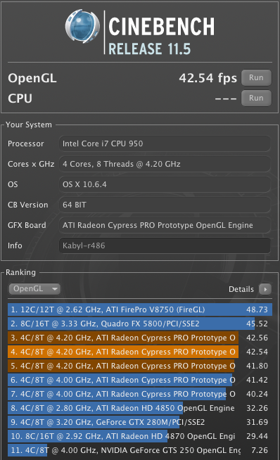

Lyle M Posted October 25, 2010 Share Posted October 25, 2010 Sorry I was mistaken, I checked the youtube video again and yes a fully decked out 2010 Mac Pro 12-core w/5870 scored just over 30: It's weird that the 5870 has such a low score. How much does CPU clock speed impact the OpenGL test in Cinebench? This score is for an overclocked 5850 on a 4.2GHz i7 950. If I wasn't lazy, I'd lower my OC and test. Sorry for the 'off-topic' post. Link to comment Share on other sites More sharing options...
sch8mid Posted October 25, 2010 Share Posted October 25, 2010 It's weird that the 5870 has such a low score. How much does CPU clock speed impact the OpenGL test in Cinebench? This score is for an overclocked 5850 on a 4.2GHz i7 950. If I wasn't lazy, I'd lower my OC and test. Sorry for the 'off-topic' post. look at my HD 5770 Cinebench and OpenCl-database in my sig (i7 results stock and oc) CPU and Ramspeed impacts the OpenGl results in Cinebench 11.5 by a high margin Apple usually clocks cards lower than their PC counterparts by about 10 % but their driver implementation a.t.m. is extremely weak I am sure that with a little more time and a 64 bit win 7 100 fr. would be in reach. :-) so far i had one run with 90,2 fr. @ 950/1400 and thats with a 100 Euro HD 5770 ... Link to comment Share on other sites More sharing options...

LoLL Posted October 25, 2010 Share Posted October 25, 2010 Maybe OT but for info, cinebench result for hd5850 :-( Link to comment Share on other sites More sharing options...
