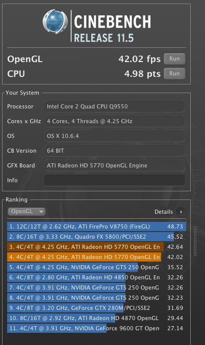

stevekicks Posted October 14, 2010 Share Posted October 14, 2010 can anyone with a 5770 run a cinebench opengl test? for some reason im only getting 13.61fps. cinebench is also only detecting my cpu as a 2core/4thread processor when its a 4 core processor Link to comment https://www.insanelymac.com/forum/topic/231768-ati-radeon-hd6000-hd5000-and-hd4000-series-support-in-chameleon/page/8/#findComment-1564263 Share on other sites More sharing options...

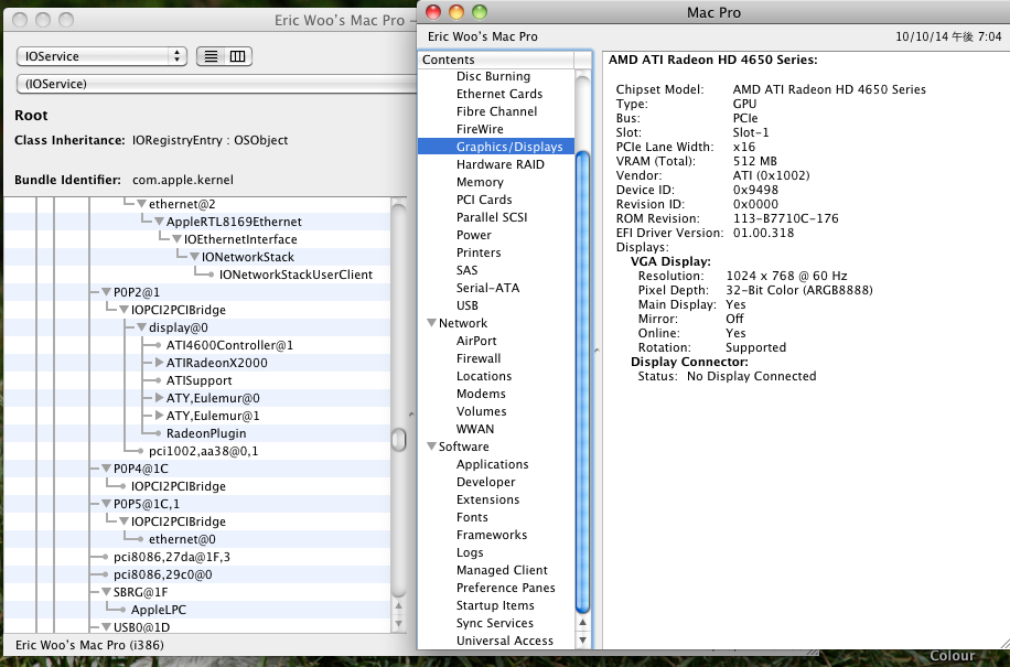

eric028 Posted October 14, 2010 Share Posted October 14, 2010 For my HIS ATI Radeon HD 4650 512MB, VGA output only work with QE/CI when Framebuffer "Eulemur" used. Link to comment https://www.insanelymac.com/forum/topic/231768-ati-radeon-hd6000-hd5000-and-hd4000-series-support-in-chameleon/page/8/#findComment-1564335 Share on other sites More sharing options...
mm67 Posted October 14, 2010 Share Posted October 14, 2010 can anyone with a 5770 run a cinebench opengl test? for some reason im only getting 13.61fps. cinebench is also only detecting my cpu as a 2core/4thread processor when its a 4 core processor Link to comment https://www.insanelymac.com/forum/topic/231768-ati-radeon-hd6000-hd5000-and-hd4000-series-support-in-chameleon/page/8/#findComment-1564411 Share on other sites More sharing options...
sch8mid Posted October 14, 2010 Share Posted October 14, 2010 can anyone with a 5770 run a cinebench opengl test? for some reason im only getting 13.61fps. cinebench is also only detecting my cpu as a 2core/4thread processor when its a 4 core processor Way too low . with a 4 core i 7 @ stock you have to get about 32-36 fr. Look here : http://www.insanelymac.com/forum/index.php...p;#entry1554521 @ MM67 very good results -about the maximum you can squeeze out of a 9550/HD 5770 combo Link to comment https://www.insanelymac.com/forum/topic/231768-ati-radeon-hd6000-hd5000-and-hd4000-series-support-in-chameleon/page/8/#findComment-1564438 Share on other sites More sharing options...
ed_co Posted October 15, 2010 Share Posted October 15, 2010 I get 36 with my 5870... I am doing something wrong? My specs are in my signature. Link to comment https://www.insanelymac.com/forum/topic/231768-ati-radeon-hd6000-hd5000-and-hd4000-series-support-in-chameleon/page/8/#findComment-1564710 Share on other sites More sharing options...
@ddi Posted October 15, 2010 Share Posted October 15, 2010 I get 36 with my 5870... I am doing something wrong?My specs are in my signature. You are even getting more than me I am at about 30.2 ... so don't really know what to think Link to comment https://www.insanelymac.com/forum/topic/231768-ati-radeon-hd6000-hd5000-and-hd4000-series-support-in-chameleon/page/8/#findComment-1564745 Share on other sites More sharing options...
aleister Crowley Posted October 15, 2010 Share Posted October 15, 2010 I get 36 with my 5870... I am doing something wrong?My specs are in my signature. I get 30.31 with a 5750, i would bet your 5870 should easily claim up to around 45 ? Link to comment https://www.insanelymac.com/forum/topic/231768-ati-radeon-hd6000-hd5000-and-hd4000-series-support-in-chameleon/page/8/#findComment-1564790 Share on other sites More sharing options...

@ddi Posted October 15, 2010 Share Posted October 15, 2010 I get 30.31 with a 5750, i would bet your 5870 should easily claim up to around 45 ? I know on win7 is about 50; so I think need to wait for a better driver or better support Link to comment https://www.insanelymac.com/forum/topic/231768-ati-radeon-hd6000-hd5000-and-hd4000-series-support-in-chameleon/page/8/#findComment-1564856 Share on other sites More sharing options...
stevekicks Posted October 15, 2010 Share Posted October 15, 2010 I stumbled onto this thread and changed my smbios file from imac11,3 to Macpro4,1 and here are the results: cinebench results using imac11,3: cinebench results using macpro4,1: I have however noticed two things while changing over to macpro4,1: im getting a few graphics artifacts in certain windows (ie if i open up a large image in preview, theres little flashing artifacts on the screen). cpu fan (stock cooler) is spinning up more - equivalent to how it does when i have windows running. anyway - still not sure why my chip is detected as 2C/4T instead of 4C/4T Link to comment https://www.insanelymac.com/forum/topic/231768-ati-radeon-hd6000-hd5000-and-hd4000-series-support-in-chameleon/page/8/#findComment-1564888 Share on other sites More sharing options...

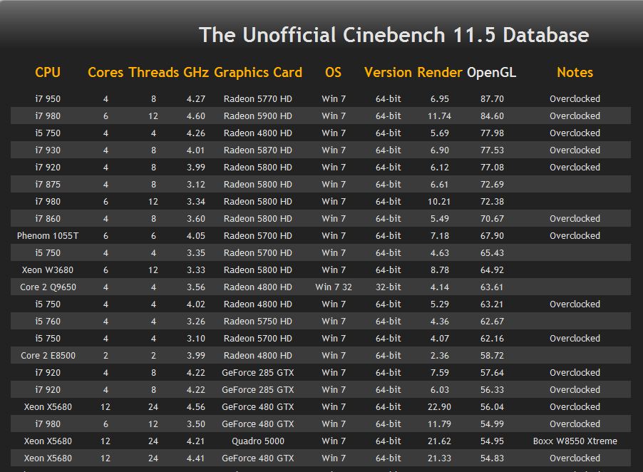

sch8mid Posted October 15, 2010 Share Posted October 15, 2010 OpenGl drivers are slightly flakey on Win 7 und much more on OSX 10.6.4 for ATI 59xx , 58xx series you can see it easily here : I got 87,70 fr . ( 88,15 fr . with a second run) with an i 7 950 OC and a HD 5770 , better than every 59xx, 58xx But where the 59xx, 58xx really shines is in OpenCL Much , Much faster than every HD 5770 card and in real world OpenCl apps. (Starfire) the 58xx flies. You can test your cards with smalllux opencl bench (OSX 10.6 port by Mitch.de ..) as an orientation see some HD 5770 results (click in my sig) Link to comment https://www.insanelymac.com/forum/topic/231768-ati-radeon-hd6000-hd5000-and-hd4000-series-support-in-chameleon/page/8/#findComment-1565079 Share on other sites More sharing options...
