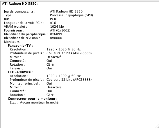

tube94 Posted October 16, 2010 Share Posted October 16, 2010 Thanks to you all!! (especially to Kabyl of couse) I ve just happily switched from nvidia 8800GT to radeon HD5850: On my system (newly installed Gigabyte GV R585OC-1GD radeon HD5850 card, on my GA-EP43-S3L motherboard, with intel Q9650 CPU and 6GB DDR2800 ram) this boot file is working without problems. Had it working at first attempt with Graphics Update 1.0 with QE/CI on 1st DVI port (the closest to card PCB) in 64 Bit Kernel and with GraphicsEnabler=Yes in com.apple.boot.plist (But I have not yet tested 2nd DVI nor DisplayPort or HDMI port) Hi Ricky, All of you folks Thanks for the Job I have spend a lot of time and it is not working yet, on R585OC get Kernel Panic in com.apple.ATIRadeonX3000 (wrong one) (Q6600-3Ghz + GA-EP35-DS3R + 4Go DDR2-1066 + GigaByte HD5850-R585OC +IIYama ProLite E2607WS) could you list all patches applied since i go throw a mess. It Get stuck. Link to comment https://www.insanelymac.com/forum/topic/231768-ati-radeon-hd6000-hd5000-and-hd4000-series-support-in-chameleon/page/9/#findComment-1565287 Share on other sites More sharing options...

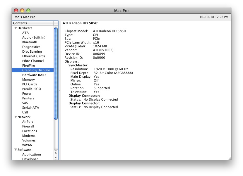

LoLL Posted October 16, 2010 Share Posted October 16, 2010 Re, Drop my old HD4890 vapor-x for a new Sapphire HD5850 toxic (Gain 35W under Finder !) All runs fine. No touch at anythink between swap (still got exotic patch from netkas but it should not modify HD5xxx drivers i think). I try both DVI port and Desktop re-appears fine after cable plug. Nothing to try another ports (display port and HDMI). Btw, Nice work ! Enclosed ioreg for dvi1 & dvi, lspci and systemprofiler snapshoot. Sapphire_HD5850Toxic_1002_6899.zip Link to comment https://www.insanelymac.com/forum/topic/231768-ati-radeon-hd6000-hd5000-and-hd4000-series-support-in-chameleon/page/9/#findComment-1565302 Share on other sites More sharing options...
meisterk Posted October 16, 2010 Share Posted October 16, 2010 Thanks to you all!! (especially to Kabyl of couse) I ve just happily switched from nvidia 8800GT to radeon HD5850: On my system (newly installed Gigabyte GV R585OC-1GD radeon HD5850 card, on my GA-EP43-S3L motherboard, with intel Q9650 CPU and 6GB DDR2800 ram) this boot file is working without problems. Had it working at first attempt with Graphics Update 1.0 with QE/CI on 1st DVI port (the closest to card PCB) in 64 Bit Kernel and with GraphicsEnabler=Yes in com.apple.boot.plist (But I have not yet tested 2nd DVI nor DisplayPort or HDMI port) Yay, here also I flawlessly switched from a 8800GT to a Sapphire Radeon HD5850. Just copied the boot file, rebooted, and it worked. GraphicsEnabler was already enabled in my com.apple.boot.plist file. Oh, and pluging my Panny plasma TV to the second HDMI port (away from PCB) worked without a glitch too. Running 10.6.4 with Graphics Update installed. Thanks to all who have contributed, this is awesome. ioreg dump and screenshot attached edit: corrected screenshot attachment ioreg.zip Link to comment https://www.insanelymac.com/forum/topic/231768-ati-radeon-hd6000-hd5000-and-hd4000-series-support-in-chameleon/page/9/#findComment-1565423 Share on other sites More sharing options...

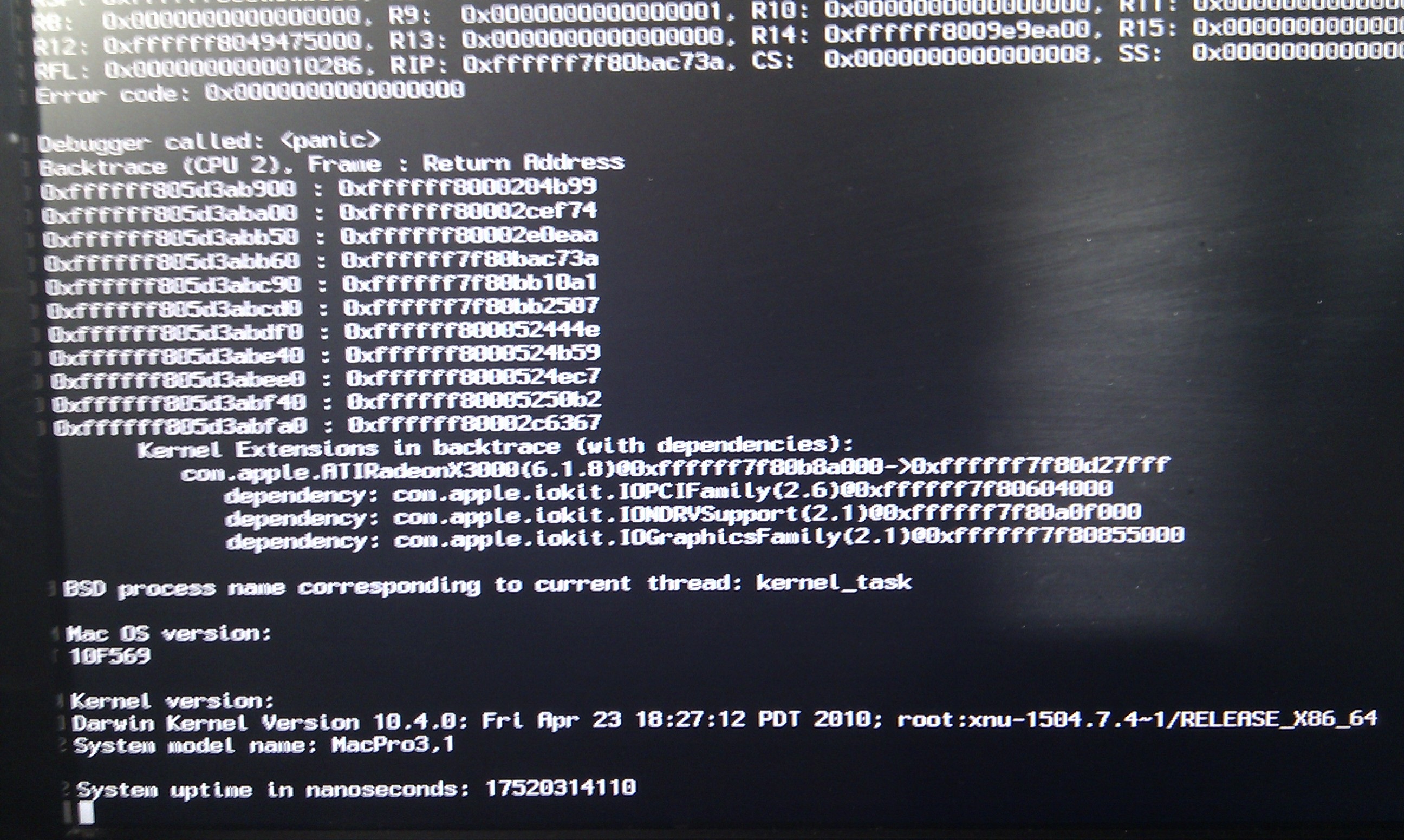

ricky mac Posted October 16, 2010 Share Posted October 16, 2010 Hi Ricky, All of you folks Thanks for the JobI have spend a lot of time and it is not working yet, on R585OC get Kernel Panic in com.apple.ATIRadeonX3000 (wrong one) (Q6600-3Ghz + GA-EP35-DS3R + 4Go DDR2-1066 + GigaByte HD5850-R585OC +IIYama ProLite E2607WS) could you list all patches applied since i go throw a mess. It Get stuck. @Tube94 As I read in previous posts in this thread, it seems that your KP depends on the need to inject the correct device id for your card into the .plist file of X3000 kext. Please refer to the previous posts to have further informations, as I have no experience of KP with my gigabyte HD5850: luckily, I did not have to modify anything besides replacing the /boot file from my previous chameleonRC5 bootloader with kabyl's one. In my config I have a vanilla 10.6.4 installation with only the minimum set of additional kexts in /extra/extensions (JMicron36xATA.kext; NullCPUPowerManagement.kext; IOAHCIBlockStorageInjector.kext; fakesmc.kext) and GraphicsEnabler=Yes in /extra/com.apple.boot.plist. This seems to be enough to have my new graphic card working at all resolutions, with QE/CI. As Meisterk stated in post#208, Nvidia-Ati switching is peculiar since in most cases the new card works OOTB with only few modifications. Good luck for your HD5850, which is IMHO a very good graphics card. Link to comment https://www.insanelymac.com/forum/topic/231768-ati-radeon-hd6000-hd5000-and-hd4000-series-support-in-chameleon/page/9/#findComment-1565466 Share on other sites More sharing options...

tube94 Posted October 17, 2010 Share Posted October 17, 2010 Following my Last Post Did a Fresh reinstall + all steps with boot in / used one from topic 1 but i still have KP like before One thing is that Prom as been updated with Gigabyte new revision to cancel glitches in videos Rom image was written 1002_6899.rom in /Extra folter. Hop this will help! Regards Alain Link to comment https://www.insanelymac.com/forum/topic/231768-ati-radeon-hd6000-hd5000-and-hd4000-series-support-in-chameleon/page/9/#findComment-1565884 Share on other sites More sharing options...
Garm Posted October 18, 2010 Share Posted October 18, 2010 Following my Last Post Did a Fresh reinstall + all steps with boot in / used one from topic 1 but i still have KP like before One thing is that Prom as been updated with Gigabyte new revision to cancel glitches in videos Rom image was written 1002_6899.rom in /Extra folter. Hop this will help! Regards Alain Post the contents of your com.apple.boot.plist Link to comment https://www.insanelymac.com/forum/topic/231768-ati-radeon-hd6000-hd5000-and-hd4000-series-support-in-chameleon/page/9/#findComment-1566000 Share on other sites More sharing options...
