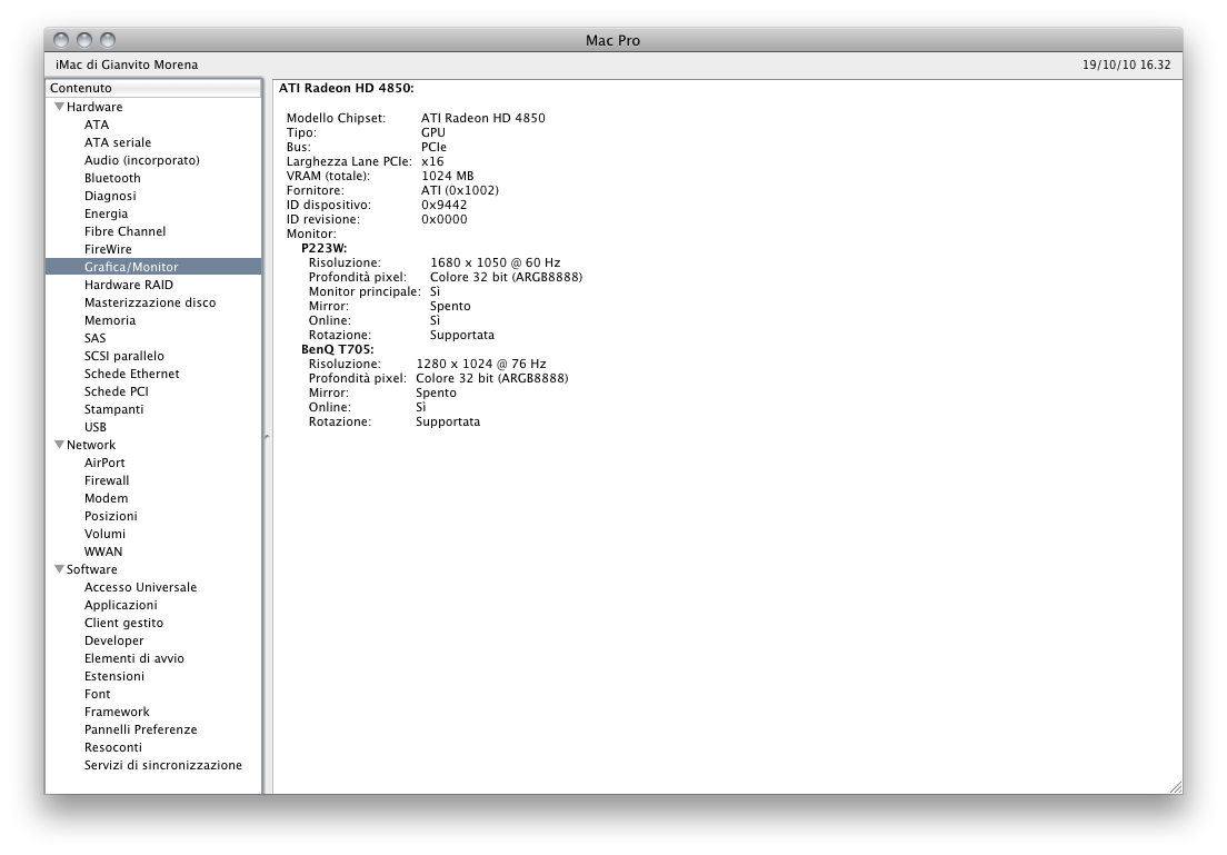

Gianvito M Posted October 19, 2010 Share Posted October 19, 2010 Card: Gainward HD4850 Golden Sample 1GB Framebuffer: Cardinal Working configurations: Dual monitor: DVI-VGA+DVI-VGA Single monitor: DVI-VGA on port 1 (Next to the motherboard) DVI-VGA on port 2 Both my monitors are VGA so I can't test DVI connections. Removing 1 DVI-VGA adapter with only 1 monitor, I've got a black screen. Graphic tab screenshot: IoReg dump: dvi_vga_dvi_vga.zip Thanks for your work Link to comment https://www.insanelymac.com/forum/topic/231768-ati-radeon-hd6000-hd5000-and-hd4000-series-support-in-chameleon/page/10/#findComment-1566719 Share on other sites More sharing options...

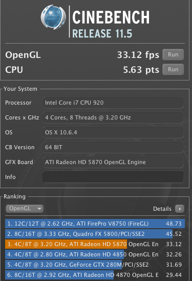

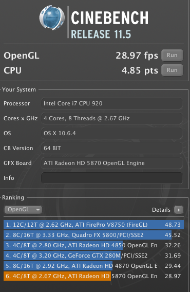

blackwalker Posted October 19, 2010 Share Posted October 19, 2010 And how much 5870 is more expensive 5770? nice result...looks like my 5870 suck My 5870 is a Gigabyte HD 5870 - "GV-R587D5-1GB-B" what about flasing one of these bios: techPowerUp Video Bios ??? the newest bios version is this: http://www.techpowerup.com/vgabios/75059/G...024.100416.html but i see that its for "GV-R587UD-1GD/F6" and i have "GV-R587D5-1GB-B" I think i dont have any problem using this bios, the model is almost the same. the question is i'll get better perfromance? what do you think? Link to comment https://www.insanelymac.com/forum/topic/231768-ati-radeon-hd6000-hd5000-and-hd4000-series-support-in-chameleon/page/10/#findComment-1566824 Share on other sites More sharing options...

@ddi Posted October 20, 2010 Share Posted October 20, 2010 tested and nothing changed...i check around and using the rom file its different, and its not like you posted... i think i have to try another method to make it work! I too score about 30 in cinebench with a 5870 and as I said before I think it should score around 50. Anyway until this will be figured out I really happy to be just be able to use it, even if underpowered Link to comment https://www.insanelymac.com/forum/topic/231768-ati-radeon-hd6000-hd5000-and-hd4000-series-support-in-chameleon/page/10/#findComment-1567297 Share on other sites More sharing options...

blackwalker Posted October 21, 2010 Share Posted October 21, 2010 i'd like to see your cinebench results!! Link to comment https://www.insanelymac.com/forum/topic/231768-ati-radeon-hd6000-hd5000-and-hd4000-series-support-in-chameleon/page/10/#findComment-1567623 Share on other sites More sharing options...
