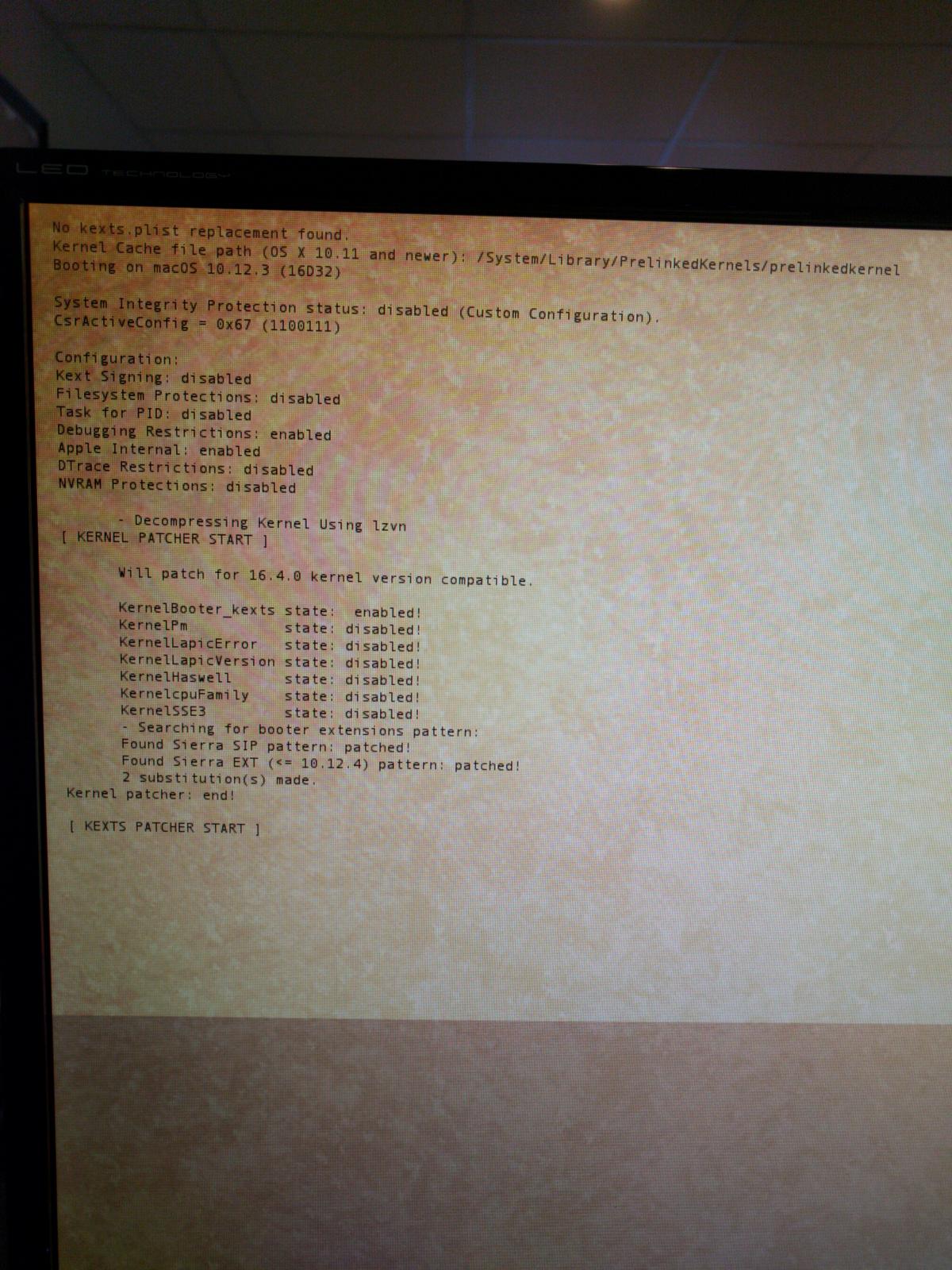

tikizondo94 Posted April 2, 2017 Share Posted April 2, 2017 Just updated to the latest enoch r2877 and for some reason my system wont boot anymore. Using this on my AMD machine. Im seeing it get stuck at "Kext Patcher Started" Yet i dont have any kext.plist setup? Im sure im doing something wrong. Could anymore lead me in the right direction?? Extra.zip Link to comment https://www.insanelymac.com/forum/topic/231075-chameleon-24svn-official-pkg-installer/page/165/#findComment-2397519 Share on other sites More sharing options...
Micky1979 Posted April 2, 2017 Share Posted April 2, 2017 type SkipKextsPatcher=Yes use this Extra folder, and ensure you are using Enoch (not Chameleon) Extra.zip Link to comment https://www.insanelymac.com/forum/topic/231075-chameleon-24svn-official-pkg-installer/page/165/#findComment-2397521 Share on other sites More sharing options...

jsl Posted April 3, 2017 Share Posted April 3, 2017 Micky1979: Thanks for this Enoch r2877 which has solved previous NvidiaWebDriver issue in 10.12.x. However its KextsPatcher function seems not working for IONVMeFamily in my Z87 hackintosh. Maybe I have some errors in my kexts.plist. Could you take a look and help me fixing it ? The boot log for Ench_2877, Clover_4035 (IONVMeFamily working by Clover bootloader) and kexts.plist are attached below. Enoch_2877.zip Clover_4035.zip kexts.plist.zip Link to comment https://www.insanelymac.com/forum/topic/231075-chameleon-24svn-official-pkg-installer/page/165/#findComment-2397653 Share on other sites More sharing options...

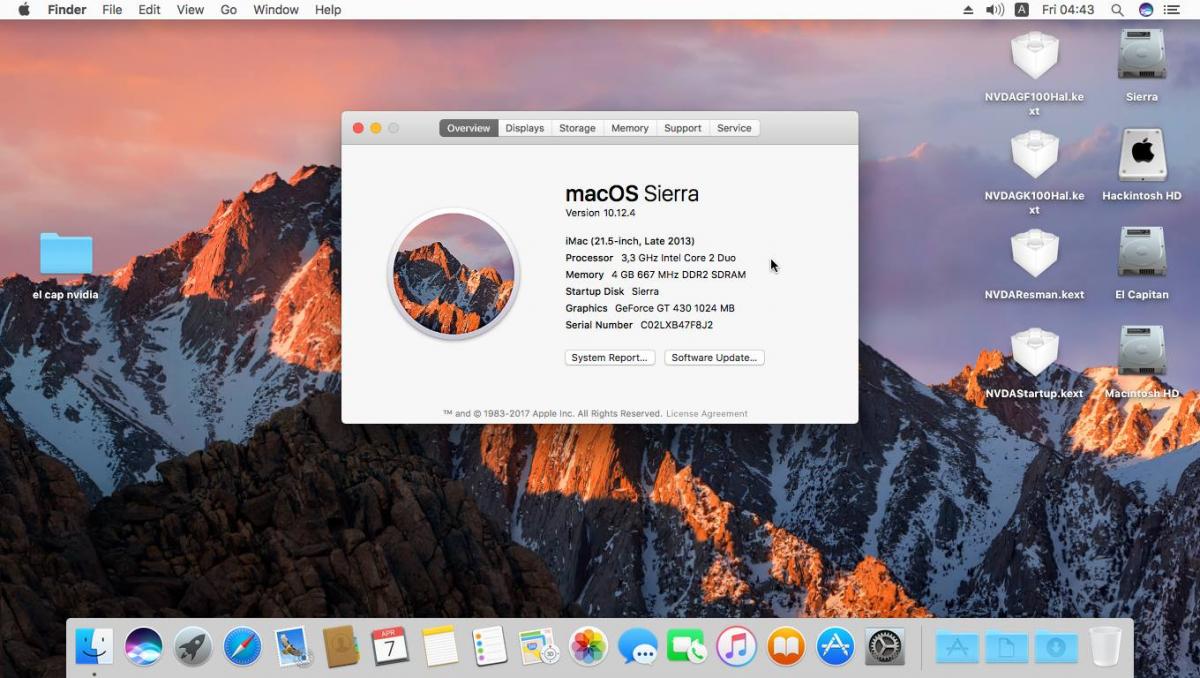

Shaneee Posted April 14, 2017 Share Posted April 14, 2017 That got it Took a few reboots but its sticking now! Awesome work! I really appreciate you taking the time to help me. Many thanks..What exactly was done? Apparently my GT 430 now needs web drivers since Sierra. Cant get them to load though. Sent from my SM-G920F using Tapatalk 1 Link to comment https://www.insanelymac.com/forum/topic/231075-chameleon-24svn-official-pkg-installer/page/165/#findComment-2404113 Share on other sites More sharing options...
Badruzeus Posted April 14, 2017 Share Posted April 14, 2017 What exactly was done? Apparently my GT 430 now needs web drivers since Sierra. Cant get them to load though. Sent from my SM-G920F using Tapatalk If what u mean is WindowServer crash on login screen, it' s just same problem with GT520M & 610 (GF119), but.. I got it to work after updated to 10.12.5 Beta 2 (16F54b). Recently using Web Driver 378.05.05.05f01 also work with ton of bugs tough.. here's my post yeah, I know that GT 430 is based on GF108 which is different tech. Link to comment https://www.insanelymac.com/forum/topic/231075-chameleon-24svn-official-pkg-installer/page/165/#findComment-2404220 Share on other sites More sharing options...
Shaneee Posted April 14, 2017 Share Posted April 14, 2017 If what u mean is WindowServer crash on login screen, it' s just same problem with GT520M & 610 (GF119), but.. I got it to work after updated to 10.12.5 Beta 2 (16F54b). Recently using Web Driver 378.05.05.05f01 also work with ton of bugs tough.. here's my post yeah, I know that GT 430 is based on GF108 which is different tech. It'll boot with nv_disable=1 and if I use Clover the web drivers load but it's all glitchy. This is a screenshot from the System Information, http://i.imgur.com/eMXewch.png The desktop background also doesn't load. This is on 10.12.4. Not sure about 10.12.5 as I'm on an AMD CPU. 1 Link to comment https://www.insanelymac.com/forum/topic/231075-chameleon-24svn-official-pkg-installer/page/165/#findComment-2404232 Share on other sites More sharing options...
Badruzeus Posted April 14, 2017 Share Posted April 14, 2017 It'll boot with nv_disable=1 and if I use Clover the web drivers load but it's all glitchy. This is a screenshot from the System Information, http://i.imgur.com/eMXewch.png The desktop background also doesn't load. This is on 10.12.4. Not sure about 10.12.5 as I'm on an AMD CPU. Hmmb... on my friend's Desktop PC with Intel Core 2 Duo, GT 430 also hang after login screen. On /Library/Logs/DiagnosticReports it shown that WindowServer crashes CoreDisplay (seems solved after 10.12.5 Beta 2). He, then use 10.12.3's CoreDisplay binary located on /S/L/Frameworks to be used on 10.12.4.. and it works, w/o NightShift for sure, and non-native display reso caused system hang... idk about AMD mach.. Link to comment https://www.insanelymac.com/forum/topic/231075-chameleon-24svn-official-pkg-installer/page/165/#findComment-2404248 Share on other sites More sharing options...
Shaneee Posted April 14, 2017 Share Posted April 14, 2017 Sorted. Enoch now booting with GE=Yes as it used to without web drivers. Seems Sierra doesn't like the DVI adapter but HDMI is working. Sent from my SM-G920F using Tapatalk 1 Link to comment https://www.insanelymac.com/forum/topic/231075-chameleon-24svn-official-pkg-installer/page/165/#findComment-2404266 Share on other sites More sharing options...

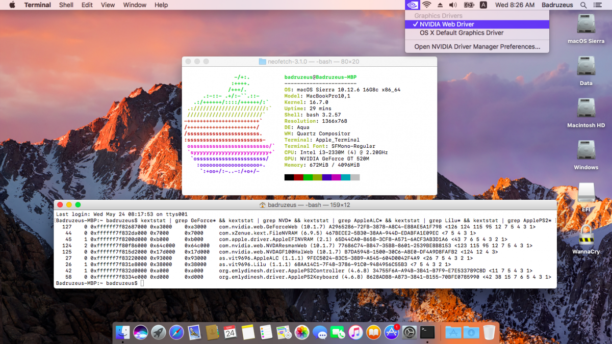

Badruzeus Posted May 24, 2017 Share Posted May 24, 2017 Well, for report only; Enoch rev.2883 boots my system successfully with macOS Sierra 10.12.6 Beta (16G8c) and OS X El Capitan 10.11.6 (15G1602). IDK here's the right place or not, but I still get a not working PS2 TrackPad (ELAN: ACPI\VEN_ETD&DEV_0101) np for KB, both using EmlyDinesh's ApplePS2SmartTouchpad (and also Rehabman's VoodooPS2Controller). A little bit confusing me, since it works OOTB with Clover; also got no report about dependency problem while on verbose mode. So, I attached both ioreg(s) below and I appreciate ur helps. << Mach specs is exactly same on my signature. Again, thanks for ur great progress @ErmaC & Others. Extra-A43SJ.zip Enoch-rev.2883-bootlog.txt My_MBP_10.12.6_(Enoch-r2883).ioreg.zip My_MBP_10.11.6_(Clover-r4077).ioreg.zip 1 Link to comment https://www.insanelymac.com/forum/topic/231075-chameleon-24svn-official-pkg-installer/page/165/#findComment-2430054 Share on other sites More sharing options...

mitch_de Posted May 29, 2017 Share Posted May 29, 2017 What does bdmesg tells you? For me the kextpatcher works (AppleRTC, ...) [ KERNEL PATCHER START ] Will patch for 15.6.0 kernel version compatible. KernelBooter_kexts state: enabled! KernelPm state: disabled! KernelLapicError state: disabled! KernelLapicVersion state: disabled! KernelHaswell state: disabled! KernelcpuFamily state: disabled! KernelSSE3 state: disabled! - Searching for booter extensions pattern: Found El Capitan SIP pattern: patched! Found EL Capitan EXT pattern: patched! 2 substitution(s) made. Kernel patcher: end! [ KEXTS PATCHER START ] Patching IOAHCIBlockStorage (trim enabler SATA): 1 substitutions made! Patching AppleRTC: 1 substitutions made! Patching AppleAHCIPort (orange icon fix): 3 substitutions made! Kexts patcher: end! Link to comment https://www.insanelymac.com/forum/topic/231075-chameleon-24svn-official-pkg-installer/page/165/#findComment-2432364 Share on other sites More sharing options...
