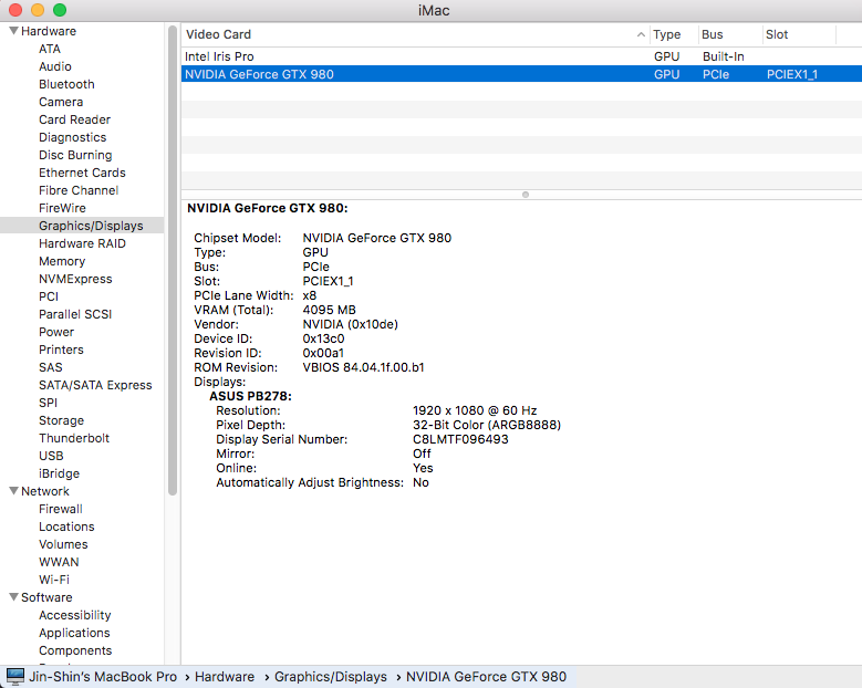

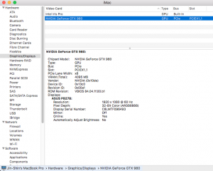

gabryele Posted March 3, 2017 Share Posted March 3, 2017 I don't know HOW, but NOW works... I change only org.chameleon.Boot.plist <?xml version="1.0" encoding="UTF-8"?> <!DOCTYPE plist PUBLIC "-//Apple//DTD PLIST 1.0//EN" "http://www.apple.com/DTDs/PropertyList-1.0.dtd"> <plist version="1.0"> <dict> <key>Graphics Mode</key> <string>1920x1080x32</string> <key>Kernel Flags</key> <string>kext-dev-mode=1 nvda_drv=1</string> <key>KeyLayout</key> <string>mac-it</string> <key>SMBIOS</key> <string>/SMBios.plist</string> <key>Timeout</key> <string>4</string> <key>UseIntelHDMI</key> <string>Yes</string> <key>UseKernelCache</key> <string>Yes</string> </dict> </plist> and kernel.plist <?xml version="1.0" encoding="UTF-8"?> <!DOCTYPE plist PUBLIC "-//Apple//DTD PLIST 1.0//EN" "http://www.apple.com/DTDs/PropertyList-1.0.dtd"> <plist version="1.0"> <dict> <key>KernelBooter_kexts</key> <string>Yes</string> </dict> </plist> but, there is a BUT In the Nvidia icon I see select OS X default graphics driver... why? is a fake information? Link to comment https://www.insanelymac.com/forum/topic/231075-chameleon-24svn-official-pkg-installer/page/161/#findComment-2377040 Share on other sites More sharing options...
mitch_de Posted March 3, 2017 Share Posted March 3, 2017 Yep, the Nvidia Menue Information is wrong - but only an cosmetic problem. I think that checks Nvidia/OS X drivers used by nvram check, which fails using the chameleon patching NV use way. So, we could disable ".. show in Menue Bar" option of the Nvidia Prefpane because its wrong. My WebdriverCheck (in download sektionof the forum) tool shows the real life - if you see com.nivida....Web then you use the web drivers and not OS X default drivers. 1 Link to comment https://www.insanelymac.com/forum/topic/231075-chameleon-24svn-official-pkg-installer/page/161/#findComment-2377056 Share on other sites More sharing options...

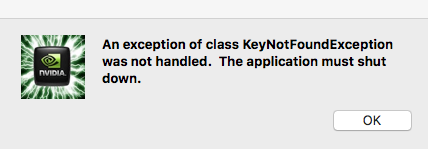

jsl Posted March 8, 2017 Share Posted March 8, 2017 Yep, the Nvidia Menue Information is wrong - but only an cosmetic problem. I think that checks Nvidia/OS X drivers used by nvram check, which fails using the chameleon patching NV use way. So, we could disable ".. show in Menue Bar" option of the Nvidia Prefpane because its wrong. My WebdriverCheck (in download sektionof the forum) tool shows the real life - if you see com.nivida....Web then you use the web drivers and not OS X default drivers. Thanks for your WebdriverCheck app. However it crashed on open in my Z87 hackintosh. How to fix it ? Link to comment https://www.insanelymac.com/forum/topic/231075-chameleon-24svn-official-pkg-installer/page/161/#findComment-2380272 Share on other sites More sharing options...
mitch_de Posted March 8, 2017 Share Posted March 8, 2017 We can discuss your crash of my WebDriverCheck tool by pm. I send you one. Thanks for report. EDIT: "The member jsl cannot receive any new messages" Is your message box perhaps full? 1 Link to comment https://www.insanelymac.com/forum/topic/231075-chameleon-24svn-official-pkg-installer/page/161/#findComment-2380298 Share on other sites More sharing options...
jsl Posted March 8, 2017 Share Posted March 8, 2017 We can discuss your crash of my WebDriverCheck tool by pm. I send you one. Thanks for report. EDIT: "The member jsl cannot receive any new messages" Is your message box perhaps full? I have sent a PM to you and thanks for your kind help. Also deleted some messages and it's not full now ! The crash_report and screen are attached here: crash_report.zip Link to comment https://www.insanelymac.com/forum/topic/231075-chameleon-24svn-official-pkg-installer/page/161/#findComment-2380373 Share on other sites More sharing options...

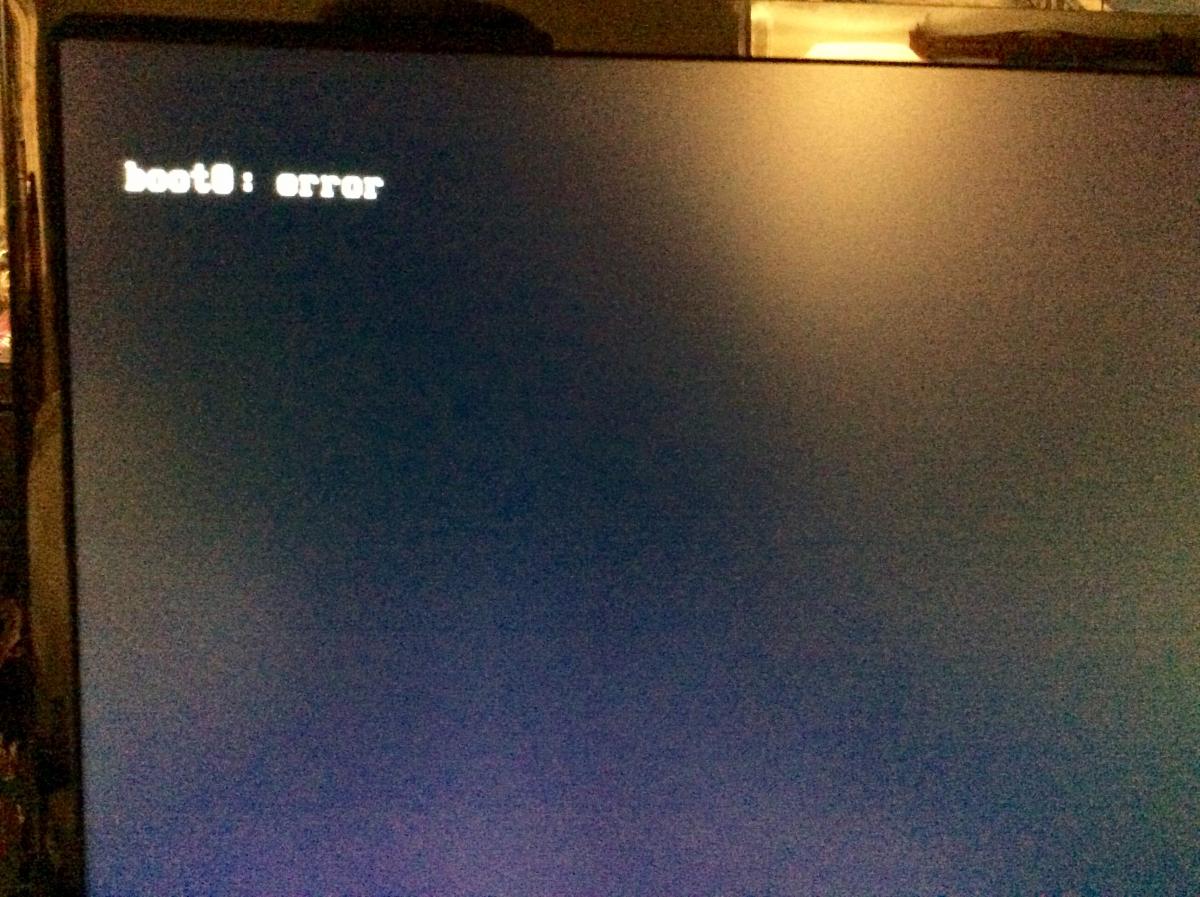

Gigamaxx Posted March 20, 2017 Share Posted March 20, 2017 I picked up a Ryzen 7 1700 and Asus Prime X370 mobo. Using clover bootloader UEFI gives black screen, nothing at all appears. Using clover Legacy bootloader (attached via USB port SSD adapter ) gives me the error on bottom of post. Using Enoch on USB connection gives me this. So far with this Ryzen setup UEFI leads to black screen and legacy clover or chameleonenoch leads to at least to some error message. Is there anything I can provide to help make a bootloader that will get us into Sierra using the new Ryzen CPUs? It seems as though the Other OS option on the motherboard doesn't have an Other capability. Is there a way to collect CPU info for a bootloader upgrade/modification in windows? I was referred to this thread to check in and see if anyone has any thoughts or recommendations to help with Ryzen support. So far it seems like UEFI booting doesn't look promising. Link to comment https://www.insanelymac.com/forum/topic/231075-chameleon-24svn-official-pkg-installer/page/161/#findComment-2388293 Share on other sites More sharing options...
Micky1979 Posted March 20, 2017 Share Posted March 20, 2017 @Gigamaxx, you know that you are talking about an AMD cpu? Sorry but here you need a developer that already own such that processor and that know what to do and which provide code.. And boot0:error just means that Enoch is bad installed, maybe you can have better results formatting your pen drive in Fat32. Link to comment https://www.insanelymac.com/forum/topic/231075-chameleon-24svn-official-pkg-installer/page/161/#findComment-2388327 Share on other sites More sharing options...
