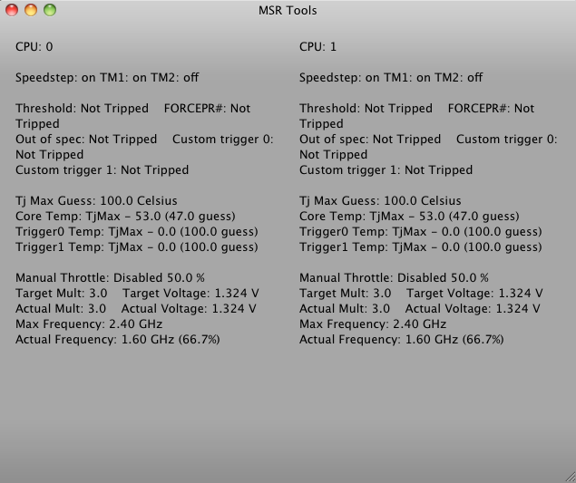

chibchan Posted July 27, 2010 Share Posted July 27, 2010 speedstep works but the voltages stay the same. Removed P and C states from dsdt. Added Drop ssdt, p & c state options to the com.apple.boot.plist. Removed smbios and used chameleons default smbios. Cpu runs at default speed. What am i overlooking? Provided dsdt and com.apple.boot files. Archive.zip Link to comment https://www.insanelymac.com/forum/topic/225766-chameleon-rc5-mode-with-mem-detection-enabled-and-automatic-p-states-c-states-generation-for-native-power-managment/page/9/#findComment-1519326 Share on other sites More sharing options...
