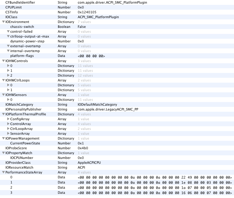

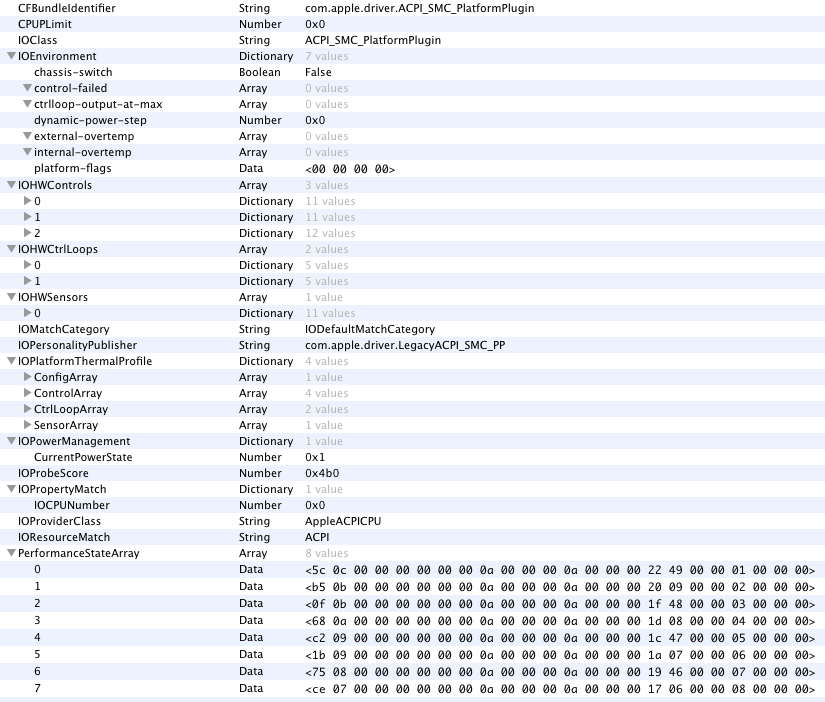

I've extracted RC5 rev 300 from the installer provided earlier in the thread (grazie iFabio!) and installed it manually. I was using AsereBLN 1.1.9 before.
(/Edit - now on rev 318)
I removed the P- and C-state code from my DSDT (I had 4 P-states and at least C1E working) and gave the CPU declarations their old names back (I had changed them to CPU0 and CPU1) so as to match the declarations in SSDT. I set DropSSDT, GenerateCStates and GeneratePStates=y.
I got these good old messages on boot, it's been a long time since I've seen them :blink: :
ACPI_SMC_PlatformPlugin::pushCPU_CSTData - _CST evaluation failed
ACPI_SMC_PlatformPlugin::registerLPCDriver - WARNING - LPC device initialization failed: C-state power management not initialized

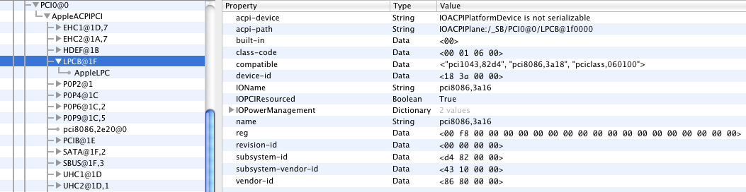

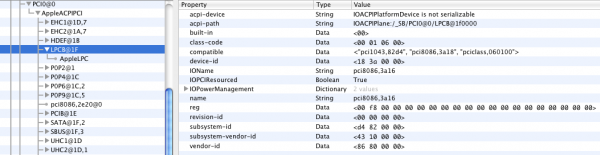

ICH10R LPC dev ID (3a18 -> 3a16) is patched via DSDT and it loads, look:
This is how SMC_PlatformPlugin looked in ioreg before (note CSTinfo):
Now it looks like this:
I got 8 P-states - but lost C-states!
Memory detection is flawless and my hardware UUID stayed the same as the one set by AsereBLN 1.1.9.
Performance is like it was before, no audio stuttering and temps are fine, just below 40 degrees celcius at idle and hovers around 50 under full load.

It turns out that if i load all my five SSDT dumps and use the above processor scope I am back to four P-states. If I only load the two C-state SSDTs and the "cpupm" SSDT I get 8 P-states AND C-states working.
Random irrational bla bla: I think the 8 P-states have to do with the 'Penryn' CPU profile that OS X loads for my CPU, Penryn is the mobile version of my Wolfdale CPU which is used in the iMac9,1 and it makes sense that it would have twice the P-states. My instincts say that it's probably better to stick with four P-states since that's what I have in Windows and Linux.
