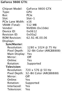

rednous Posted August 11, 2010 Share Posted August 11, 2010 Have you changed (modded) VideoBios in gpu/mem/shader MHZ clocks or how/why you use that videorom loading ?... I decided to test (specifically with Cham r352 - there's a comment in the trunk) the VBIOS=Yes key cause Asere's boot loader wasn't reporting my nVidia Video BIOS version (as attachement above). Before without VBIOS and VBIOS=Yes the ROM Revision was displayed as XX.XX.XX.XX in System Profiler. AFAIK for the UseNvidiaROM key we should specify a file holding the dumped nVidia video firmware. Im not loading modded video BIOS and I have never tried to OC my video. Link to comment https://www.insanelymac.com/forum/topic/225766-chameleon-rc5-mode-with-mem-detection-enabled-and-automatic-p-states-c-states-generation-for-native-power-managment/page/17/#findComment-1528802 Share on other sites More sharing options...

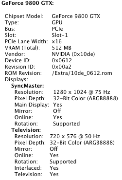

Gringo Vermelho Posted August 11, 2010 Share Posted August 11, 2010 Before rev 352 (and when using AsereBLN 1.1.9) System Profiler would show xx.xx.xx.xx followed by the path to the ROM. I've been using "UseNvidiaROM=y" and /extra/10de_0612.rom until today. With Chameleon 2.0 RC5 r352 it looks like this, it just shows the path: If I use VBIOS=y with /extra/nvidia.rom instead, it shows the ROM revision: I have a burning question about loading vbios. Following advice given by Krazubu over at ProjectOSX, my video ROM is patched by NVEnabler.kext, extracted from ioreg and saved with a hex editor. I see many posts from people loading an unmodified video ROM extracted from their own video card (post #406 by rednous for example). Is there any reason to load the video BIOS if it hasn't been patched? Link to comment https://www.insanelymac.com/forum/topic/225766-chameleon-rc5-mode-with-mem-detection-enabled-and-automatic-p-states-c-states-generation-for-native-power-managment/page/17/#findComment-1528850 Share on other sites More sharing options...
mitch_de Posted August 11, 2010 Share Posted August 11, 2010 I get even more confused now about that video rom loading. I used UseNvidiaROM=Yes and the 10de_191.rom in /Extras (loaded as Systemprofielr shows) What about that VBIOS key ? I thought thats an old / overholed key and UseATIROM or UseNvidiaROM are the key now to use. "Is there any reason to load the video BIOS if it hasn't been patched?" Indeed also my main question. Also if some hardware near things like OC/UC, changing FAN speeds,... not working (cant work perhaps, not boot loaders fault), i am not sure if that option has real benefit. . Link to comment https://www.insanelymac.com/forum/topic/225766-chameleon-rc5-mode-with-mem-detection-enabled-and-automatic-p-states-c-states-generation-for-native-power-managment/page/17/#findComment-1528884 Share on other sites More sharing options...

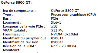

aliab Posted August 12, 2010 Share Posted August 12, 2010 First thank's people for great job successful with my two "old" Asus boards here no need of options for ROM revision to be recognized with rev354 injection with <key>GraphicsEnabler</key><string>Yes</string> in com.apple.Boot.plist finder is much more fast with r354 compared to r300 and before someone ? Link to comment https://www.insanelymac.com/forum/topic/225766-chameleon-rc5-mode-with-mem-detection-enabled-and-automatic-p-states-c-states-generation-for-native-power-managment/page/17/#findComment-1529019 Share on other sites More sharing options...
rednous Posted August 12, 2010 Share Posted August 12, 2010 ...I see many posts from people loading an unmodified video ROM extracted from their own video card (post #406 by rednous for example). Is there any reason to load the video BIOS if it hasn't been patched? Gringo, yes, you're right about loading modded video BIOS only if it's patched, otherwise it's doesn't make sense. I tried the key VBIOS=Yes with r352 and saw the video revision reported correctly in the System Profiler. I think it's my fault to report the video revision injection working with the key VBIOS=Yes. I suspect r352 will report this no matter VBIOS=Yes|No, i'll test at home later and will report. It seems r352 reads and reports the nVidia firmware version by default. @all developers: Please, take some time to document the new feature(s) in the Chameleon CHANGES doc. It takes some time but will also save time and confusions to all contributors, users, testers. Thanx Link to comment https://www.insanelymac.com/forum/topic/225766-chameleon-rc5-mode-with-mem-detection-enabled-and-automatic-p-states-c-states-generation-for-native-power-managment/page/17/#findComment-1529057 Share on other sites More sharing options...

mitch_de Posted August 12, 2010 Share Posted August 12, 2010 Gringo, yes, you're right about loading modded video BIOS only if it's patched, otherwise it's doesn't make sense.I tried the key VBIOS=Yes with r352 and saw the video revision reported correctly in the System Profiler. I think it's my fault to report the video revision injection working with the key VBIOS=Yes. I suspect r352 will report this no matter VBIOS=Yes|No, i'll test at home later and will report. It seems r352 reads and reports the nVidia firmware version by default. @all developers: Please, take some time to document the new feature(s) in the Chameleon CHANGES doc. It takes some time but will also save time and confusions to all contributors, users, testers. Thanx Yep. But its unclear what key we must use. I never used VBIOS=Yes key. Only UseNvidiaROM=Yes which loads my rom (shown in systemprofiler, but NVClock didnt show clock changes) to devs: Need we also VBIOS=Yes, together with UseNvidia / UseAtiROM=Yes or ... ? THANKS (PS: The video rom feature belongs to me to the not high needed features, so no worry if it doesnt work really (shown in systemprofiler but OC/UC clocks not changed) Link to comment https://www.insanelymac.com/forum/topic/225766-chameleon-rc5-mode-with-mem-detection-enabled-and-automatic-p-states-c-states-generation-for-native-power-managment/page/17/#findComment-1529114 Share on other sites More sharing options...

rednous Posted August 12, 2010 Share Posted August 12, 2010 Yep.But its unclear what key we must use. I never used VBIOS=Yes key. Only UseNvidiaROM=Yes which loads my rom (shown in systemprofiler, but NVClock didnt show clock changes) to devs: Need we also VBIOS=Yes, together with UseNvidia / UseAtiROM=Yes or ... ?... mitch, definitely. Maybe we'll get an enlightment from rekursor, or mozodojo Reading Asere's explanation on using the UseNvidiaROM and UseAtiROM keys seems to me that those are the only keys needed to switch on the custom video rom loading, respectively for nVidia and ATI. There's nothing mentioned about VBIOS in regards to custom rom. Link to comment https://www.insanelymac.com/forum/topic/225766-chameleon-rc5-mode-with-mem-detection-enabled-and-automatic-p-states-c-states-generation-for-native-power-managment/page/17/#findComment-1529191 Share on other sites More sharing options...

mitch_de Posted August 12, 2010 Share Posted August 12, 2010 The big question now is, if an loaded video rom can change / setup gpu really different than the BIOS on the card. The systemprofiler rom info is usefull, but that means NOT that something changed (clocks, Volts, Fan settings). That only can be checked by using Nvclock (per loading that .kext). If nvclock shows same clocks , and the bios has different = loaded but NO resetup of the gpu settings. Nvclock DL: http://www.projectosx.com/forum/index.php?showtopic=1246 Would be nice if some users can check clock changes (OC/UC) by comparing NVClock -i results with modded rom loaded / not loaded. Link to comment https://www.insanelymac.com/forum/topic/225766-chameleon-rc5-mode-with-mem-detection-enabled-and-automatic-p-states-c-states-generation-for-native-power-managment/page/17/#findComment-1529319 Share on other sites More sharing options...
