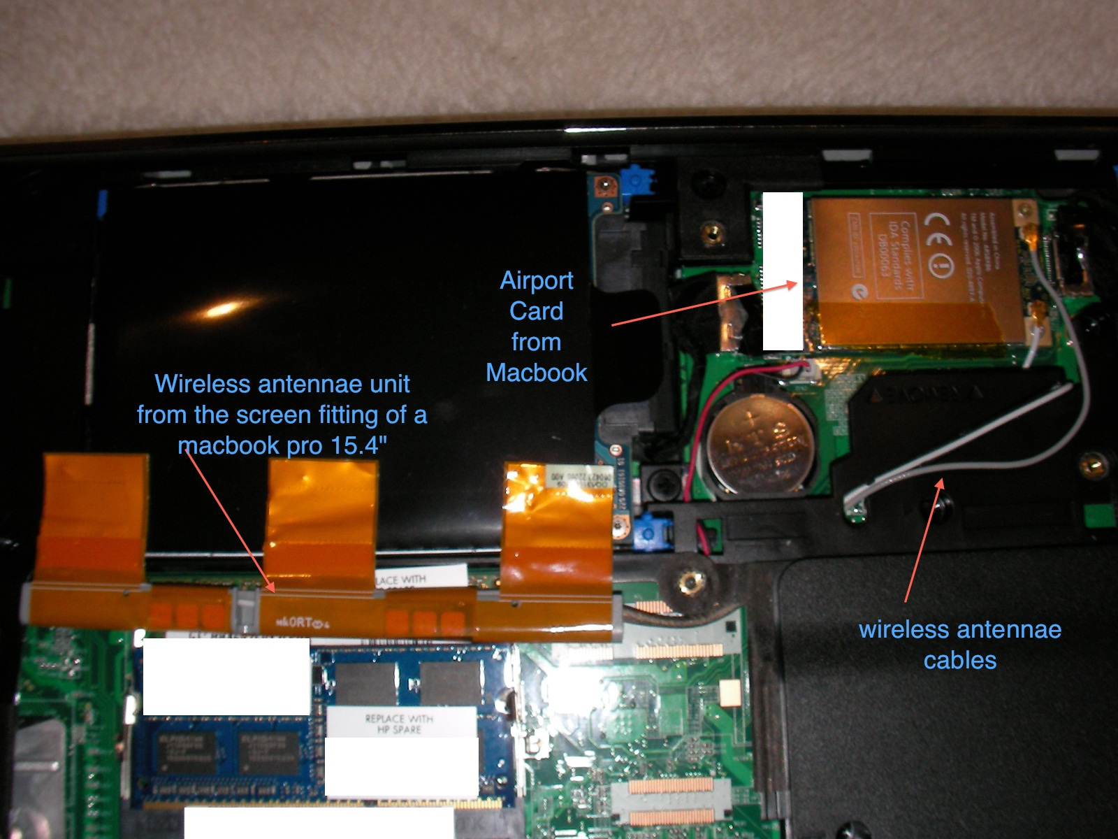

findmory Posted December 13, 2010 Share Posted December 13, 2010 Here's a thought about the WIFI issue. The Apple card you suggest, which requires finding the full height slot and rewiring the antenna, etc is a Apple Airport Extreme Card Ma688z/b which is actually a BROADCCOM Bcm94321mc 802.11n, of course. Dell has a HALF-HEIGHT Broadcom BCM94322 which they sell as DW 1510: http://www.amazon.com/Dell-Half-Height-Bro...s/dp/B002OB0FPI. What do you guys think? it's such a similar Broadcom model number. I was going to take a flyer on it for my Pavillion DV7. Any thoughts? thanks Link to comment https://www.insanelymac.com/forum/topic/221653-guide-hp-dv8-dv7-dv6-dv5-1064-easy-comprehensive-installation/page/27/#findComment-1601656 Share on other sites More sharing options...

Sammity Posted December 16, 2010 Share Posted December 16, 2010 Glad to see someone is making progress with the brightness, it's well beyond my levels although I'm learning dsdt editing along the way I've been fiddling with the wireless, and have an alternative that doesn't involve dismantling the DV8 series (which I have). I've a large amount of old Apple bits so decided to use the antennae cable assembly from the screen of a macbook pro. It's the part that usually resides in the hinge of the screen assembly, I've taken mine from a 15.4" non unibody model. As advised by Mammoth I'm using a broadcomm based wireless card, (Apple original from a Macbook) and have connected the two up in my HP. Success, the signal quality is good and I've no major modification done to the machine. Naturally this may not be the route for everyone, but I'm not inclined to dismantle my HP (yet) so this does the trick. The picture I've taken I hope will help. A step at a time this is becoming a great machine Link to comment https://www.insanelymac.com/forum/topic/221653-guide-hp-dv8-dv7-dv6-dv5-1064-easy-comprehensive-installation/page/27/#findComment-1603633 Share on other sites More sharing options...
Mammoth Posted December 17, 2010 Author Share Posted December 17, 2010 Hello all, Great news! How would you like to be able to install any Wi-Fi card in the top (original slot) and use it? I have found a thread where they show just how to do this, and the links are below. What I would like to request is that if someone figures out how to do this, they could make a couple versions for us to try: DV8, DV7, DV6, and DV5. If possible, make some directions showing the rest of us how to do it. http://forums.mydigitallife.info/threads/2...ns-mod-requests. http://forums.mydigitallife.info/threads/7...modify-the-bios Others are doing this and making it work, so I'm sure we can too! Good luck! Link to comment https://www.insanelymac.com/forum/topic/221653-guide-hp-dv8-dv7-dv6-dv5-1064-easy-comprehensive-installation/page/27/#findComment-1603692 Share on other sites More sharing options...
