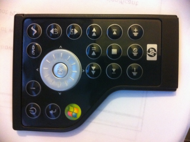

Sammity Posted December 8, 2010 Share Posted December 8, 2010 Glad to hear my DSDT has enabled the sleepy lid and media keys for you. My remote is identical looking to yours but the part number may be different, the details on the back of my remote: RC2332201/01B 3139 228 54781 HP SPS : 488435-001 HP RMN : HSTNN-PR19 If there is any other information or testing you require please let me know, thanks. Link to comment https://www.insanelymac.com/forum/topic/221653-guide-hp-dv8-dv7-dv6-dv5-1064-easy-comprehensive-installation/page/26/#findComment-1598726 Share on other sites More sharing options...

spawnedc Posted December 8, 2010 Share Posted December 8, 2010 Hey Sammity! Keep at it! If you can get that brightness control to work, you will be a star for sure! What BIOS version are you on? EVERYONE: Does anyone have their remote working on a DV8t-1100 (VF836AV) under 10.6.5? Hey Mammoth, I have DV8 1110ea (VY144EA ABU). Should I have a remote controller? Atm I don't have one. If I should, then I need to go to the place that I bought my laptop and start some fight Link to comment https://www.insanelymac.com/forum/topic/221653-guide-hp-dv8-dv7-dv6-dv5-1064-easy-comprehensive-installation/page/26/#findComment-1599047 Share on other sites More sharing options...
Mammoth Posted December 8, 2010 Author Share Posted December 8, 2010 Hey Mammoth, I have DV8 1110ea (VY144EA ABU). Should I have a remote controller? Atm I don't have one. If I should, then I need to go to the place that I bought my laptop and start some fight Check the left-hand side PCI-Express Card slot to see if it's in there. I think most of us had to pay like $15 extra for them when we ordered/bought our machines. Link to comment https://www.insanelymac.com/forum/topic/221653-guide-hp-dv8-dv7-dv6-dv5-1064-easy-comprehensive-installation/page/26/#findComment-1599057 Share on other sites More sharing options...
