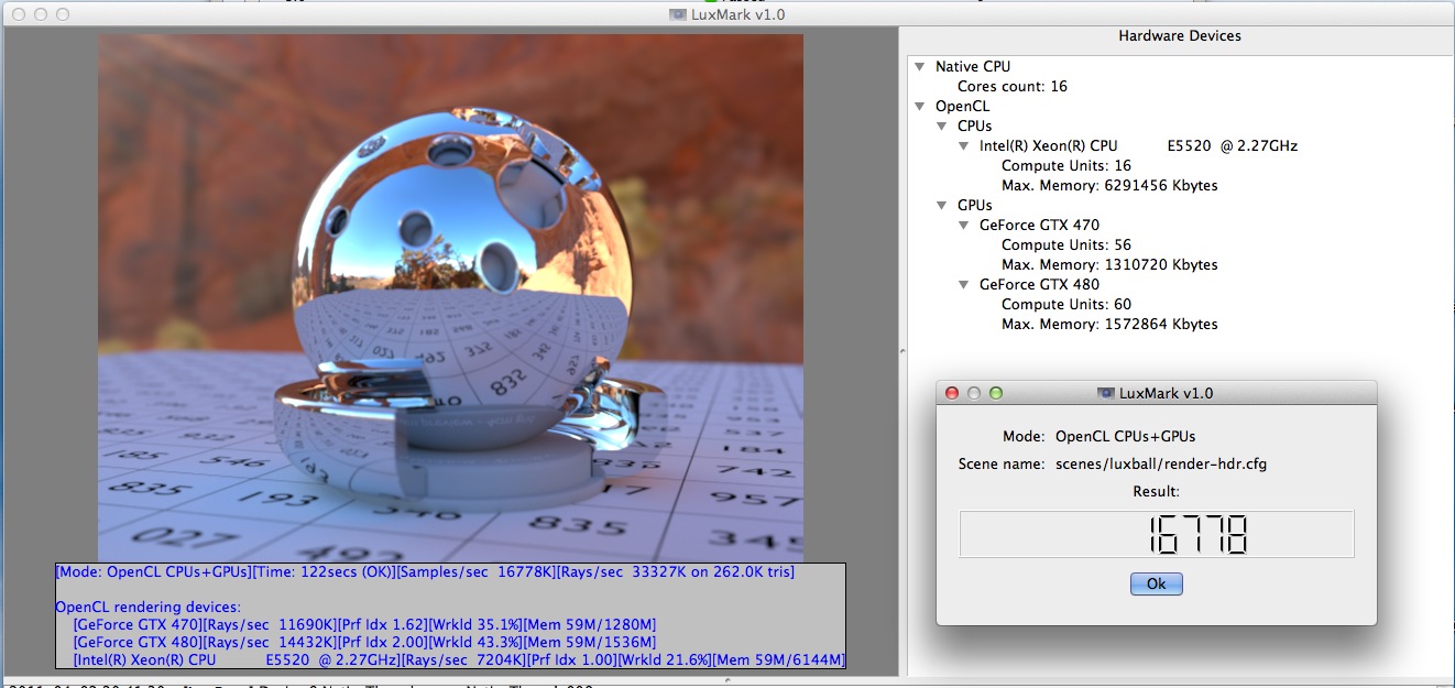

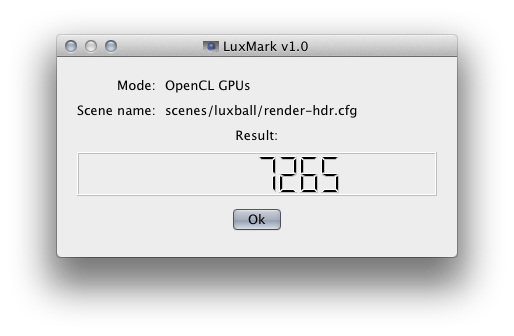

mitch_de Posted April 2, 2011 Share Posted April 2, 2011 Great Luxmark values I think also much faster than GTX260 cards. Link to comment https://www.insanelymac.com/forum/topic/214219-fermigtx-480gtx-470/page/64/#findComment-1665019 Share on other sites More sharing options...

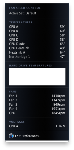

myrorym Posted April 4, 2011 Share Posted April 4, 2011 binaries (copy to /S/L/E): FakeSMC_fermi.zip Thanks. That was the trick. Now I get GPU Fan Heatsink & diode readouts. However, included IntelThermal plugin, and the newer v3 IntelCPUMonitor(which used before) only give me readout of two cores. CPU A and B. Is there a necessary edit to get all cores recognized? I am on single chip 6-core Xeon. Could I be misunderstood here? Shouldn't I be reading out more than 2 CPUs in iStatPro? Thanks for the help. Link to comment https://www.insanelymac.com/forum/topic/214219-fermigtx-480gtx-470/page/64/#findComment-1665635 Share on other sites More sharing options...
cmf Posted April 4, 2011 Author Share Posted April 4, 2011 Thanks. That was the trick. Now I get GPU Fan Heatsink & diode readouts.However, included IntelThermal plugin, and the newer v3 IntelCPUMonitor(which used before) only give me readout of two cores. CPU A and B. Is there a necessary edit to get all cores recognized? I am on single chip 6-core Xeon. Could I be misunderstood here? Shouldn't I be reading out more than 2 CPUs in iStatPro? Thanks for the help. sry, no idea, ask the fakesmc folks. and i haven't used istatpro in a while, but you might want to try istat menus first, b/c it has newer sensor plugins. ... uptime: 1d 12h Link to comment https://www.insanelymac.com/forum/topic/214219-fermigtx-480gtx-470/page/64/#findComment-1665764 Share on other sites More sharing options...

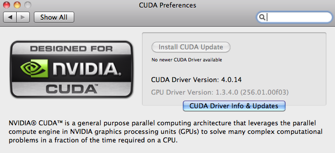

shenor Posted April 14, 2011 Share Posted April 14, 2011 nvidia release new dev. cuda driver 4.0.14 which can install from cuda pref. panel. Link to comment https://www.insanelymac.com/forum/topic/214219-fermigtx-480gtx-470/page/64/#findComment-1670027 Share on other sites More sharing options...
cmf Posted April 14, 2011 Author Share Posted April 14, 2011 nvidia release new dev. cuda driver 4.0.14 which can install from cuda pref. panel. still 4.0.13 here and nothing shows in the pref panel. nv developer page also says 4.0.13. if you really have 4.0.14, could you look if it has r270/lion dp2 support? ls /Library/Frameworks/CUDA.framework/Libraries/libcuda_270.* Link to comment https://www.insanelymac.com/forum/topic/214219-fermigtx-480gtx-470/page/64/#findComment-1670296 Share on other sites More sharing options...
shenor Posted April 14, 2011 Share Posted April 14, 2011 still 4.0.13 here and nothing shows in the pref panel. nv developer page also says 4.0.13.if you really have 4.0.14, could you look if it has r270/lion dp2 support? ls /Library/Frameworks/CUDA.framework/Libraries/libcuda_270.* senol-kocs-Mac-Pro:~ senolkoc$ ls /Library/Frameworks/CUDA.framework/Libraries/libcuda_270.* /Library/Frameworks/CUDA.framework/Libraries/libcuda_270.02.00.dylib /Library/Frameworks/CUDA.framework/Libraries/libcuda_270.05.00.dylib senol-kocs-Mac-Pro:~ senolkoc$ Link to comment https://www.insanelymac.com/forum/topic/214219-fermigtx-480gtx-470/page/64/#findComment-1670301 Share on other sites More sharing options...
rominator Posted April 14, 2011 Share Posted April 14, 2011 Opened CUDA in 10.6.7 and it promtped me to update to the .14 update. It's real. Link to comment https://www.insanelymac.com/forum/topic/214219-fermigtx-480gtx-470/page/64/#findComment-1670323 Share on other sites More sharing options...
cmf Posted April 15, 2011 Author Share Posted April 15, 2011 senol-kocs-Mac-Pro:~ senolkoc$ ls /Library/Frameworks/CUDA.framework/Libraries/libcuda_270.*/Library/Frameworks/CUDA.framework/Libraries/libcuda_270.02.00.dylib /Library/Frameworks/CUDA.framework/Libraries/libcuda_270.05.00.dylib senol-kocs-Mac-Pro:~ senolkoc$ thanks. i grabbed the installer from 10.6 now, installed it in 10.7, and yay, cuda works in 10.7 dp2 so, updating my list from before: dropbox works, cuda works. problems: some ui graphic glitches, no aa in opengl. ... and next lion dp with 270.05 drivers then? edit: haha, speaking of the devil: apple just released an update for lion dp2, including new graphic drivers (270.05 ) and updated opencl/opengl frameworks. device id list is still the same: <key>IOPCIPrimaryMatch</key> <string> 0x06c010de&0xffe0ffff 0x0dc010de&0xffc0ffff 0x0e2010de&0xffe0ffff 0x0ee010de&0xffe0ffff 0x0f0010de&0xffc0ffff 0x104010de&0xffc0ffff 0x124010de&0xffc0ffff </string> edit 2: update went flawlessly. this fixes expose on my gtx 480 and allows multi-sampling/aa in opengl again remaining issues: none? Link to comment https://www.insanelymac.com/forum/topic/214219-fermigtx-480gtx-470/page/64/#findComment-1670649 Share on other sites More sharing options...

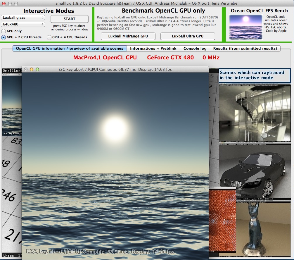

mitch_de Posted April 16, 2011 Share Posted April 16, 2011 Can someone with NV GTX2 or GTX4 try my new smallluxGPU beta , which has now included OceanWave OpenCL FPS bench (beside the known luxball Ultra OpenCL bench) ? If it works (runs in DP1/DP2) please us ethe buildin submit function to submit the results , so that i can them in the upcoming app within the results tab of the app. Some values already submitted (beside my 9600 GT) but no DP2/DP1 and no GTXxxx card I get 23 FPS with my 9600 GT running OceanWave OpenCL FPS / 120 Sec Ultra Luxball. https://www.rapidshare.com/files/457540119/...luxGPU_beta.zip (25 MB) Link to comment https://www.insanelymac.com/forum/topic/214219-fermigtx-480gtx-470/page/64/#findComment-1670873 Share on other sites More sharing options...
rominator Posted April 16, 2011 Share Posted April 16, 2011 Can someone with NV GTX2 or GTX4 try my new smallluxGPU beta , which has now included OceanWave OpenCL FPS bench (beside the known luxball Ultra OpenCL bench) ?If it works (runs in DP1/DP2) please us ethe buildin submit function to submit the results , so that i can them in the upcoming app within the results tab of the app. Some values already submitted (beside my 9600 GT) but no DP2/DP1 and no GTXxxx card I get 23 FPS with my 9600 GT running OceanWave OpenCL FPS / 120 Sec Ultra Luxball. https://www.rapidshare.com/files/457540119/...luxGPU_beta.zip (25 MB) I tried a couple times, keeps saying "Email can't be sent" Link to comment https://www.insanelymac.com/forum/topic/214219-fermigtx-480gtx-470/page/64/#findComment-1671121 Share on other sites More sharing options...
mitch_de Posted April 17, 2011 Share Posted April 17, 2011 I tried a couple times, keeps saying "Email can't be sent" Sorry for that. Which OS X ? I already got lots of OS X 10.6x mails by the new beta. So must be not an general problem. If Lion DP, have you already setup mail and can send mails and allowed, if asked, to acess keychain from the app? You can post result here (screenshoot / gpu type values) also Link to comment https://www.insanelymac.com/forum/topic/214219-fermigtx-480gtx-470/page/64/#findComment-1671307 Share on other sites More sharing options...

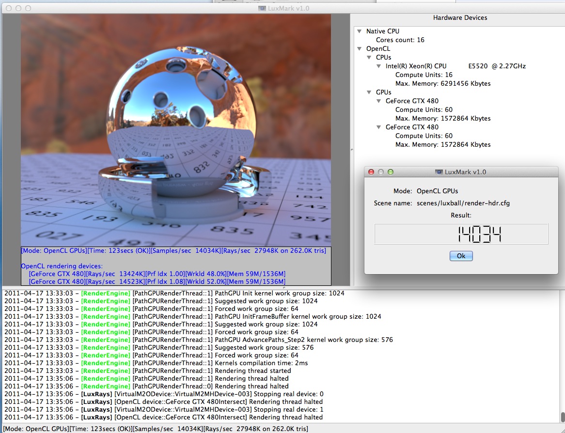

rominator Posted April 17, 2011 Share Posted April 17, 2011 My email works fine, but I still can't send according to app. Anyhow, here is screen shot. I have 2 @ GTX480s in this Mac but only 1 shows up. Also, it gets around 15 fps while a lowly GT120 (9500GT to anyone but Apple) get 10 fps. Perhaps low score is because it is running at 0 Mhz? The Luxrender 1.0 with red dock icon can see both cards and scales benchmark accordingly. Link to comment https://www.insanelymac.com/forum/topic/214219-fermigtx-480gtx-470/page/64/#findComment-1671550 Share on other sites More sharing options...
