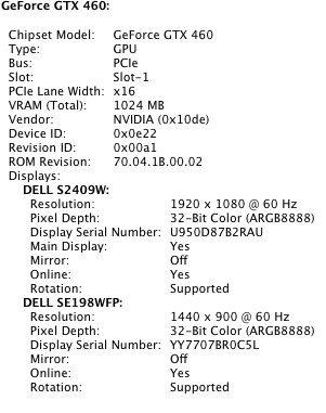

T a D Posted July 12, 2011 Share Posted July 12, 2011 Here's a data point for everyone: 1GB Gigabyte GTX 460 Chameleon RC5-svn-r1138 - Graphics Enabler=Y OS X 10.7 Lion GM Everything seems to be working fine on the graphics front, ripple effect in Dashboard (when not a Space) So far no kernel panics or random lockups like I had on Snow Leopard (10.6.7 or 10.6.8). I have stopped running the iTunes visualiser all the time as well. Games (Portal 2, Assassins Creed) all run well with no noticeable problems. Stock kexts except for FakeSMC. ModelIdentifier set at 3,1 System: Gigabyte GA-P35-DS3P (BIOS F12B), Q6700 @ 2.6GHZ, 4GB RAM Link to comment https://www.insanelymac.com/forum/topic/214219-fermigtx-480gtx-470/page/68/#findComment-1713713 Share on other sites More sharing options...
