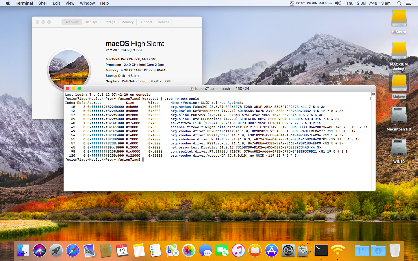

Successfully installed High Sierra Release 10.13_17A365 on my Dell XPS M1530/Intel T9300/GF 8600M (external HFS+ HDD for testing  :))...
Steps to install or upgrade install:
1)  Upgrade Clover to r4220 and latest config.plist & kexts for Sierra/High Sierra.
2)  Download "Install macOS High Sierra.app" v13.0.64 from Mac App Store.
3)  Prior to update, delete NVRAM.plist files from all EFI partitions (incl USB drives) and clear NVRAM (sudo NVRAM -c command in terminal).  This avoids "OSInstall.mpkg damaged/missing" error.
4)  Directly run "Install macOS High Sierra.app" from Applications folder, targeting the desired HFS+ or APFS installation partition --> automatically creates "macOS Install Data" folder on that volume...
5) At first restart, boot to "macOS Install" ---> files from install packages written to disk...
6) At second restart, boot to High Sierra partition, setup user etc.  If there is a kernel panic after kext caches are rebuilt, just boot again into High Sierra.  The Disabler.kext will prevent future panics once it is in the pre-linked kernel cache (blocks AppleYukon2.kext in /S/L/E).
Installation Notes
  • Clover's default values for FF/FFM/PF and BIOS ver/date/Board-ID data (MBP7,1 SMBIOS) --> avoids error while "verifying firmware".
  • Install apfs.efi driver in /EFI/CLOVER/drivers64 only if you need to install on APFS target volume.
  • If upgrading existing OS X on HDD, HFS+ is preserved (on SSD HFS+ will be converted automatically to APFS).

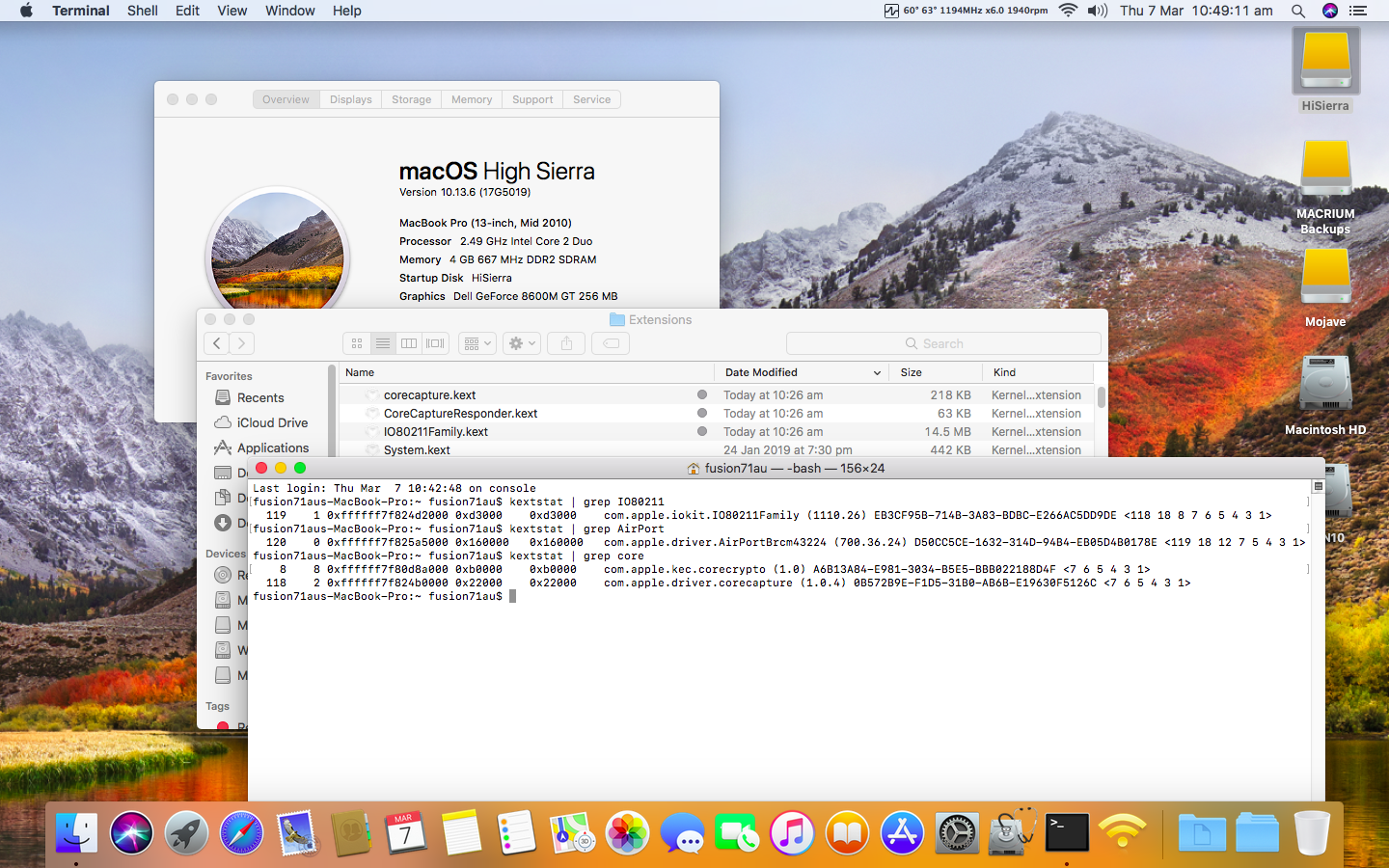

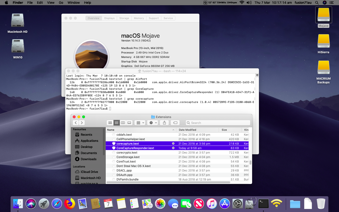

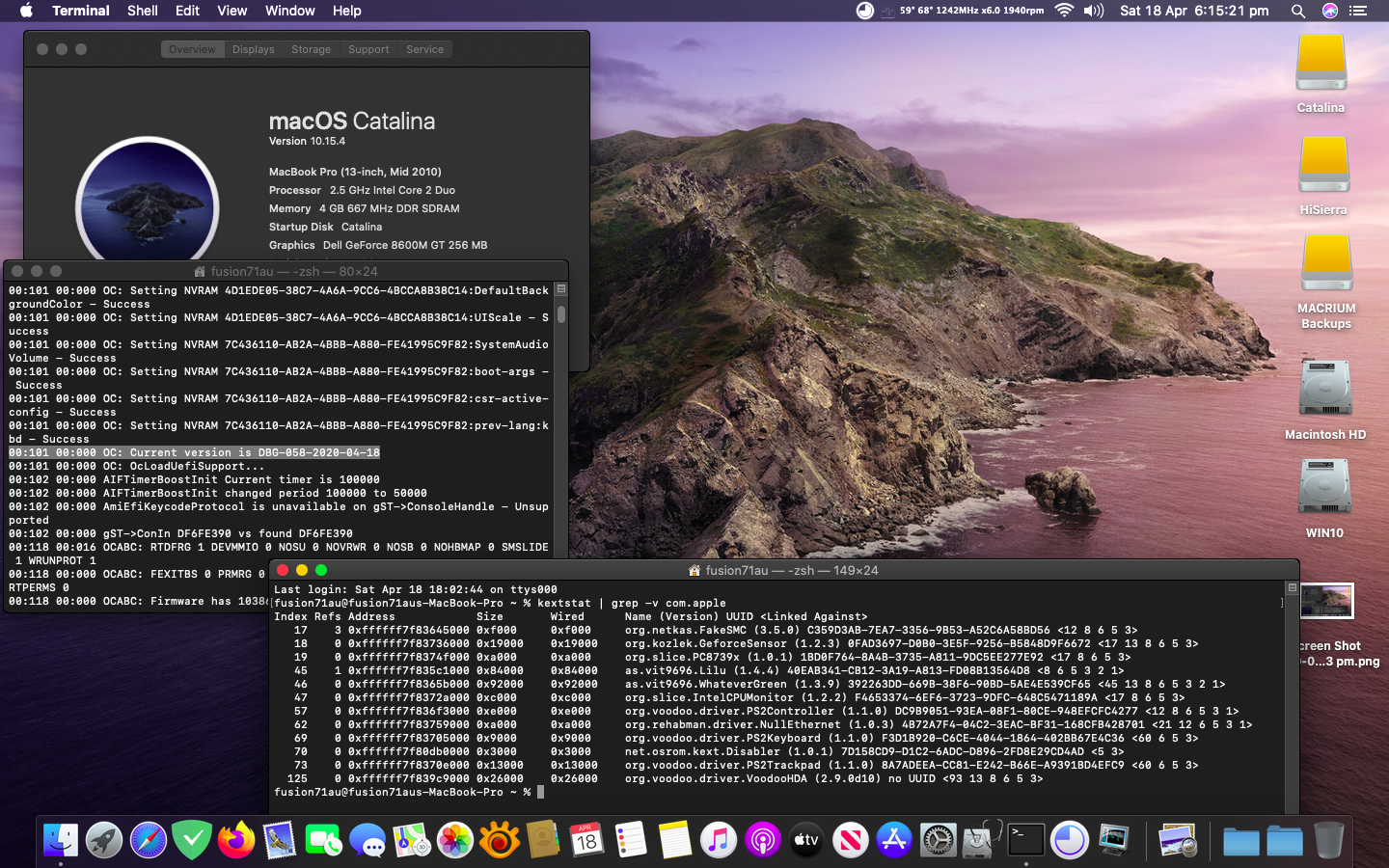

Hi Guys,
I successfully installed the latest High Sierra 10.13.6 update and also the latest Mojave Beta on my XPSM 1530 :thumbsup_anim:.
Spoiler
Attached to this post is my latest Clover config.plist and kexts for installation and post installation.  Recommend you update Clover to the latest r4644 (with ApfsDriverLoader-64.efi in /Drivers64 for apfs filesystem support) and have it successfully booting your system before trying the upgrade.  @crazybirdy’s script can also be used to download the Installer.app for HS or Mojave from Apple’s servers.
Spoiler

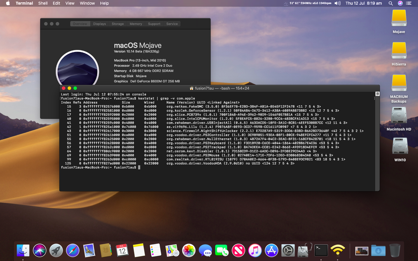

To install Mojave Beta, follow @Asentientbot's instructions detailed in post#2082 (summarized in the spoiler below).  I booted into High Sierra and launched the patched OSInstall.mpkg to start installation on the target HFS+ volume.  On first boot into Mojave, I used single user mode to rebuild the prelinkedkernel and system caches ...
Spoiler

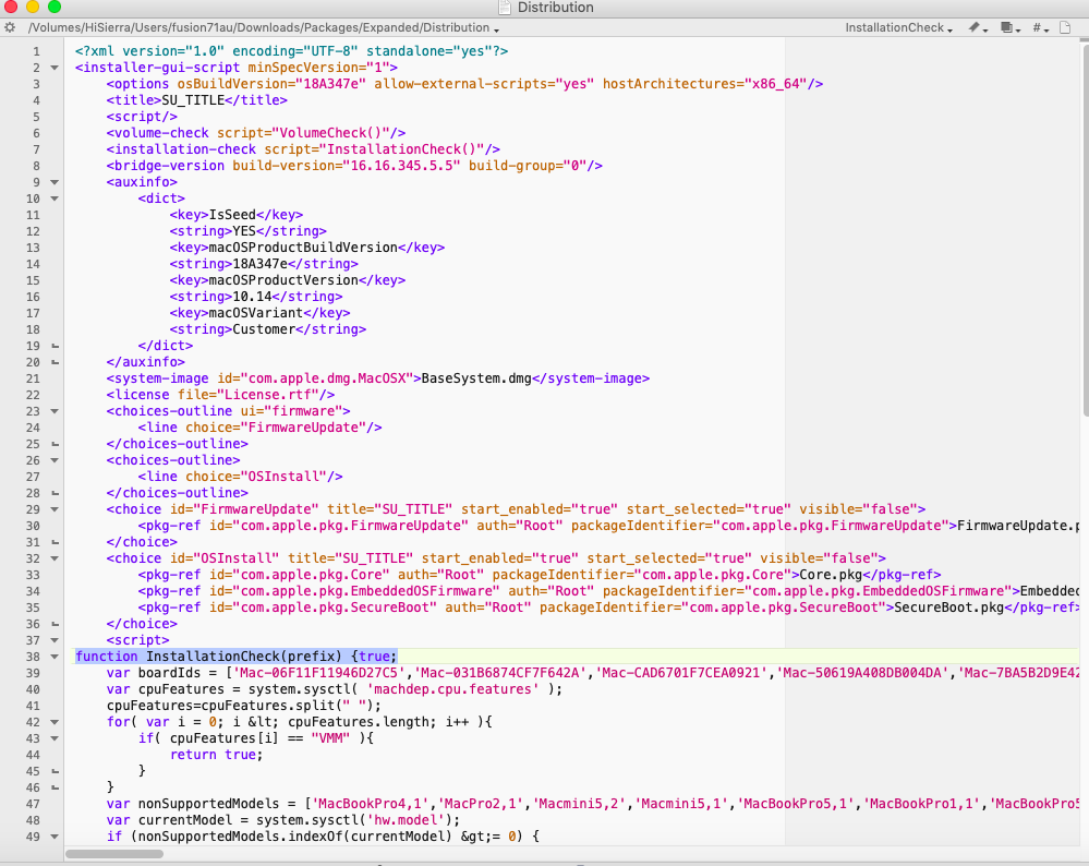

Patch the installer
1. Get a copy of the install app and open Contents/SharedSupport/InstallESD.dmg
2. Copy the folder Packages somewhere you can edit
3. cd to the folder and pkgutil --expand OSInstall.mpkg Expanded
4. Open the folder Expanded and open Distribution in a text editor
5. Find the function InstallationCheck(prefix) and put return true; at the very beginning
6. Remove the text installsOS=true from the same file
7. pkgutil --flatten Expanded Patched.mpkg
You will now have an install file "Patched.mpkg" that you can double-click and install to a HFS+ partition.
Patch the installed system to boot
1. On the partition, copy boot.efi from /usr/standalone/i386/ to /System/Library/CoreServices
2. Open /Library/Preferences/SystemConfiguration/com.apple.Boot.plist in a text editor
3. Make Kernel Flags as <string>-v -no_compat_check keepsyms=1</string>
This will make the disk bootable, bypass the prohibitory symbol (\) and show symbols in kernel panic logs (If it panics, let it reboot and pick your High Sierra partition; it should automatically show the log in "your computer was restarted because of a problem" dialog once it boots.)

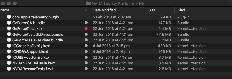

Fix the kernel panic on Penryn systems
Replace /S/L/UserEventPlugins/com.apple.telemetry.plugin with the one from High Sierra 10.13.6, or patch the binary file in place - substitute "Mojave" with the name of your Mojave partition.
For 10.14 db1 18A293u ~ db5 18A347e
sudo perl -pi -e 's|\x28\x07\x00\x00\x85|\xC8\x06\x00\x00\x85|g' /Volumes/Mojave/System/Library/UserEventPlugins/com.apple.telemetry.plugin/Contents/MacOS/com.apple.telemetry
For 10.14 db6 18A353d
sudo perl -pi -e 's|\xD8\x06\x00\x00\x85|\xC8\x06\x00\x00\x85|g' /Volumes/Mojave/System/Library/UserEventPlugins/com.apple.telemetry.plugin/Contents/MacOS/com.apple.telemetry
Patch USB function
Replace from High Sierra:
/System/Library/Extensions/IOUSBHostFamily.kext

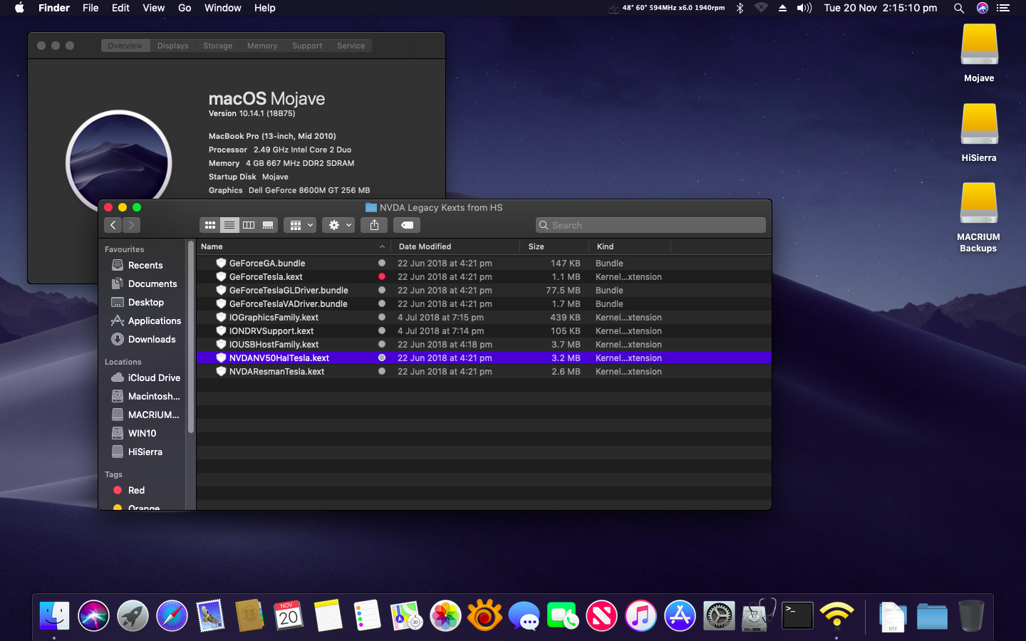

Recognize the Tesla GPU
Copy from High Sierra:
  •     NVDANV50HalTesla.kext
  •     NVDAResmanTesla.kext
  •     IONDRVSupport.kext
  •     IOGraphicsFamily.kext
This allows changing the brightness and shows the correct display in About This Mac
Enable the framebuffer and acceleration
  •     GeForceTesla.kext - patch this kext from terminal
sudo perl -pi -e 's|\x48\x8b\x07\xff\x90\xc0\x00\x00\x00|\x48\x8b\x07\x66\x0f\x1f\x44\x00\x00|g' /Volumes/Mojave/System/Library/Extensions/GeForceTesla.kext/Contents/MacOS/GeForceTesla
  •     GeForceGA.kext
  •     GeForceTeslaGLDriver.bundle
  •     GeForceTeslaVADriver.bundle
On first boot into Mojave, fix kext permissions, rebuild prelinkedkernel and system caches in single user mode
/sbin/fsck -fy
/sbin/mount -uw /
chmod -R 755 /System/Library/Extensions
chown -R 0:0 /System/Library/Extensions
touch /System/Library/Extensions && kextcache -u /
reboot
  Reveal hidden contents
Patch the installer
  •     GeForceGA.kext

13 hours ago, oSxFr33k said:
@fusion71au
Is our 8600M GPU supported in Mojave?   I don't think its a metal supported GPU, do you still get acceleration in 10.14.1?
Yes, after installing High Sierra graphics kexts and patched GeForceTesla.kext as described before in this post...
1515533168_Mojave10_14.1_18B75onXPSM1530.thumb.png.f76c17c76f7e0831e8092967510702d8.png
Process of install and post install patching can be automated with @dosdude's macOS Mojave Patcher.

Hi guys.
Major update for all those with BCM94321 wifi cards - @parrotgeek1 and @dosdude have posted a solution that makes the card function normally in High Sierra and Mojave (tested in 10.13.6 & 10.14.3 :thumbsup_anim:.).
Install the attached kexts into /S/L/E and rebuild caches et voila!...
Spoiler
PS @dosdude also managed to get graphics acceleration working in the latest 10.14.4beta4 (with a non-Metal legacy GPU) in this post.  I will test when the official 10.14.4 release comes out...
BCM4321fix.zip
Edited by fusion71au

On 3/6/2019 at 6:12 PM, fusion71au said:
Hi guys.

On 4/17/2020 at 11:06 PM, oSxFr33k said:
How are you doing.  Have you tried the Dosdude's Patched Catalina installer for the M1530.  Would this bring back functionality for our Ethernet, Wifi, battery and GFX in Catalina?  Have you also tried OpenCore as an alternate to Clover or does our Laptop work better in Clover.   Either way would ACPI_SMC_PlatformPlugin for our LPC device still fail for CST even in Open Core?
How are you doing?
Good thanks.  Yourself?
Have you tried the Dosdude's Patched Catalina installer for the M1530?
Yes, Catalina patcher v1.4.3 working well for installing macOS 10.15.4 on the XPS M153...
84182682_macOSCatalina10_15.4_19E266onXPSM1530OC0.5.8.thumb.png.97c2c207a454ae7d7a910d43b4e1506c.png
Mostly OK for Wifi (using BCM4321fix kexts) and GFX in Catalina but no ethernet with MBP 7,1 SMBIOS and can’t confirm battery indicator working (my battery expired years ago, running on AC power).
Yes, Opencore 0.5.8 works well as an alternative to Clover for booting macOS/Windows/Linux.  Also LPC device will still fail for CST, even using Open Core.
Advantages of OC:  Very fast boot and optimisable.
Disadvantages of OC:  More difficult and technical for newbies, still in beta phase (no GUI themes out of the box).  Can cause Windows activation issues if your Windows is OEM activated.
Kexts for audio and wifi.zip
Clover_r5112_XPS M1530.zip
OpenCore-0.5.8-DEBUG_XPS M1530.zip
formatting
