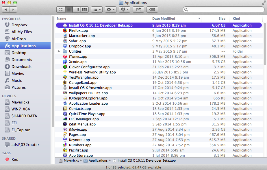

Hi Guys,
I thought I'd do a write up of OSX 10.11 "El Capitan" DP1 on the XPS M1530.
Essentially, the procedure is the same as for installing Yosemite (if you use Clover) but the main problem is that the USB ports won’t work due to buggy drivers in this build.  This means that instead of creating and booting off a USB installer, you need to boot to an installer partition on the hard drive (use the createinstallmedia method) or directly run the Install OS X 10.11 Developer Beta .app in the Applications folder as described below.
How to install
Prerequisites
1.  Working Clover installed in EFI system partition of the hard drive.  FakeSMC and VoodooPS2Controller kexts installed in /EFI/CLOVER/kexts/Other or /EFI/CLOVER/kexts/10.11.
2.  “Install OS X 10.11 Developer Beta” app in the Applications folder
Procedure

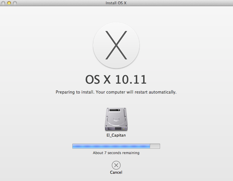

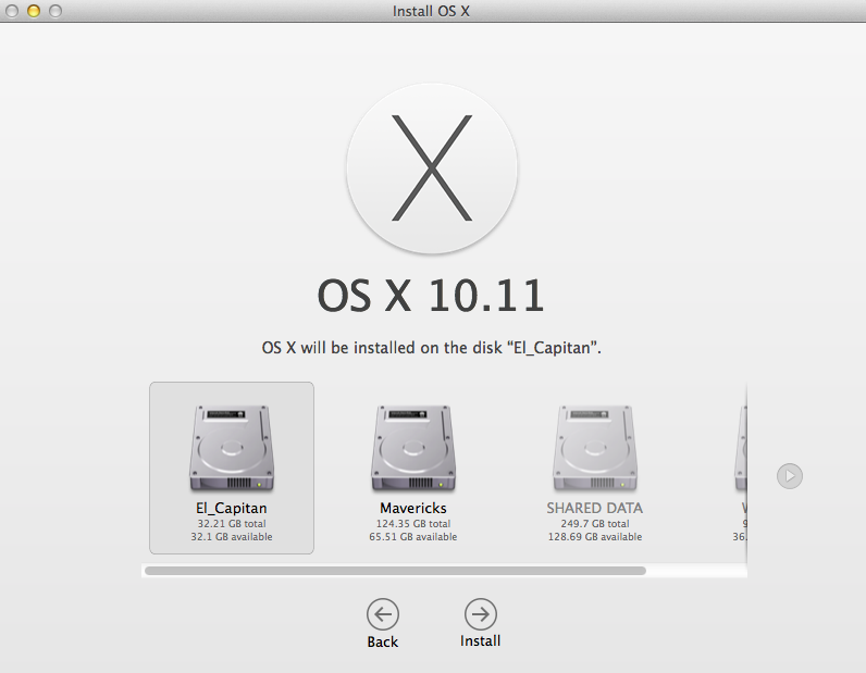

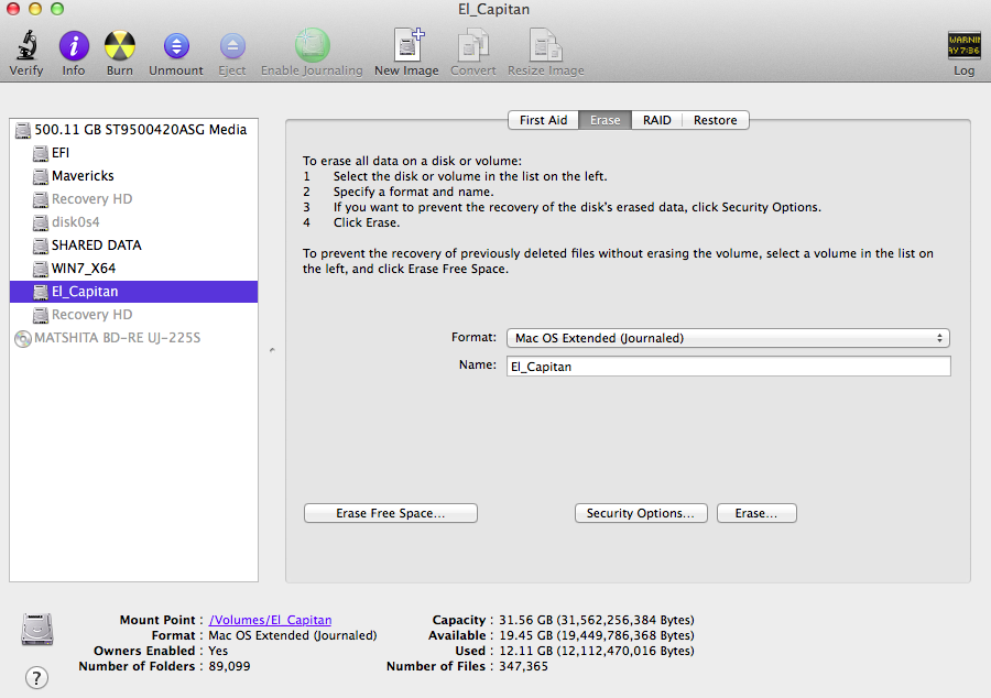

1.  Open Disk Utility and create a new partition or format an existing one for El Capitan.  In the Erase tab, I named the partition “El_Capitan” and formatted as Mac OS Extended (journaled).

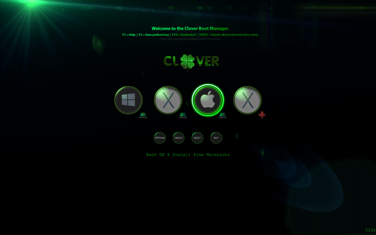

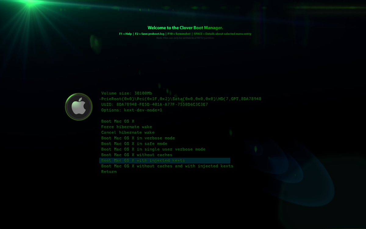

2.  Run the Install app from the Applications folder and choose the El_Capitan partition as the target.  The installer will add temporary installation files to your current OSX partition (in my case, Mavericks) in the first “Preparing to install” phase.  This stage will progress quite quickly after which you are asked to reboot the computer…
3.  At the Clover Main Menu, select “Boot OS X Install from xxxx” and “with injected kexts”, using the arrow keys and <spacebar>.
4.  The actual installation phase on the El Capitan partition will begin with scrolling text on the screen for a few minutes before you reach the installer GUI and progress bar - see the screenshot below.
At the end, it will reboot the computer for the second time…
5.  At the Clover Main Menu, you can now select “Boot Mac OS X from El_Capitan” and “with injected kexts”, using the arrow keys and <spacebar>.
6.  The final phase is pretty straightforward – choose language, keyboard, location and time zone, network, user name and password etc.  When you finally reach the desktop, the “about” screen will initially show “OS X Yosemite” version 10.11 :hysterical:
This will change automagically to “El Capitan” when you connect to the internet and Apple’s servers eg when you sign into the App store or iTunes.

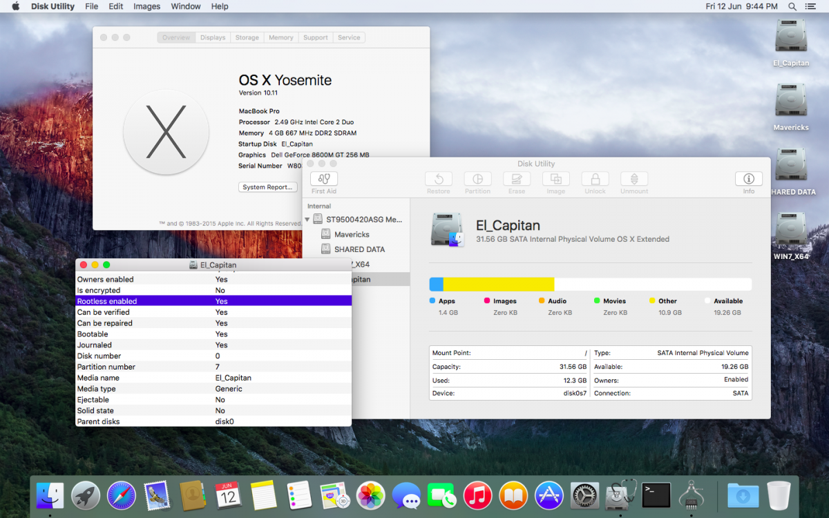

  • New root-less security is based on sandboxing shell and its commands, so you can’t edit system files even if you a root and file has 755 mode
  • files are editable if you boot yosemite
  • To disable rootless mode set boot argument rootless=0
  • You can still set boot-args with sudo nvram even in rootless mode.

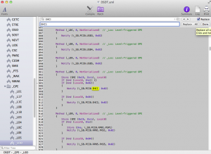

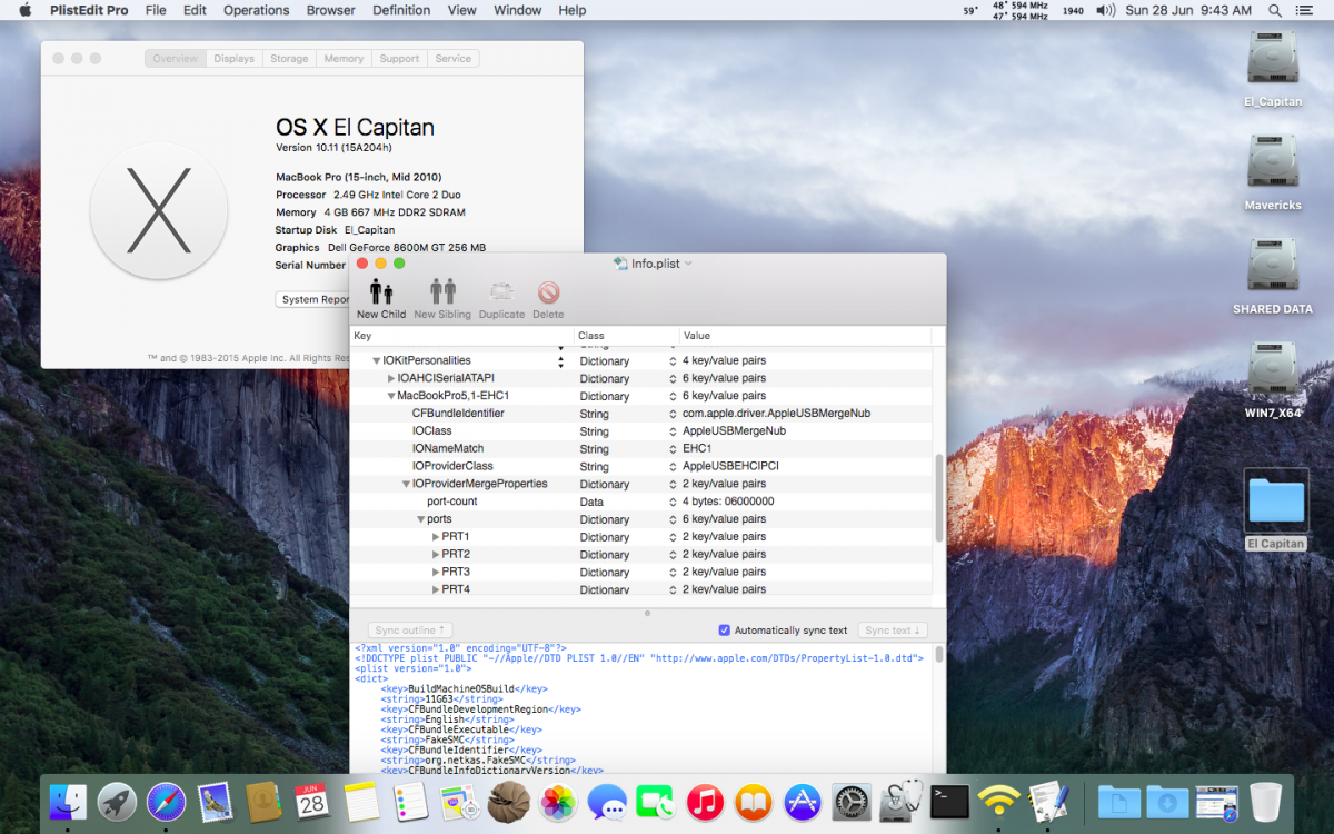

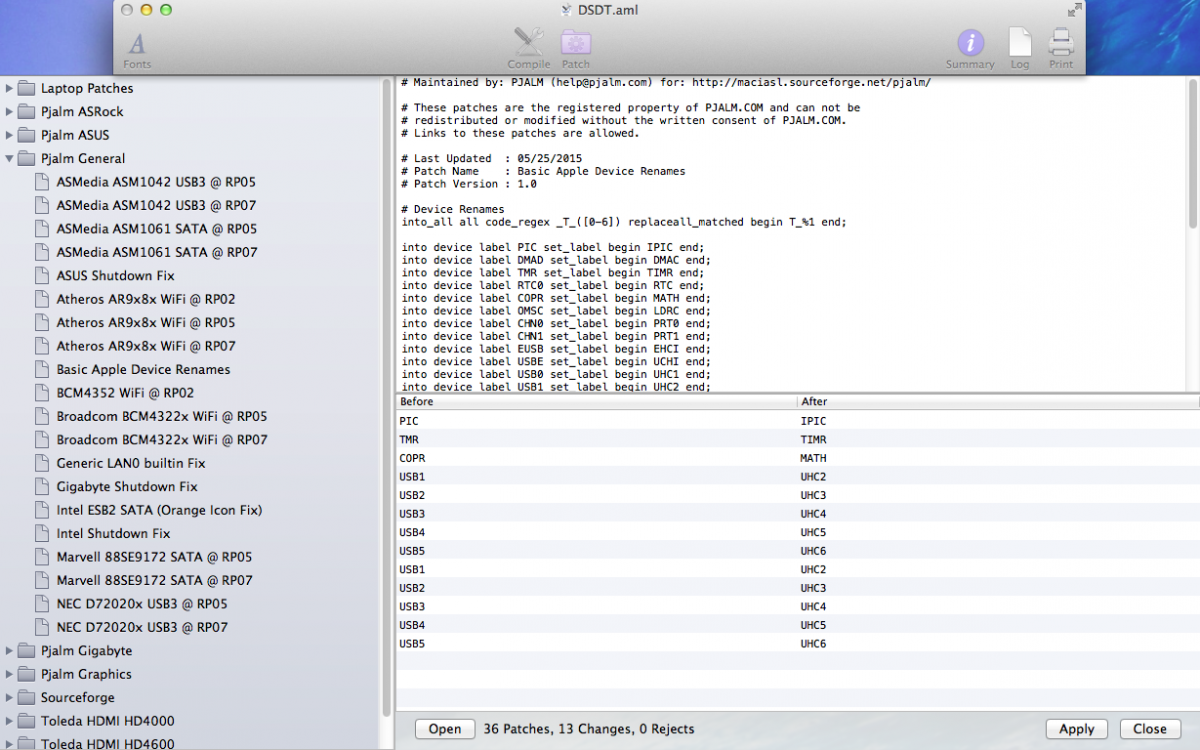

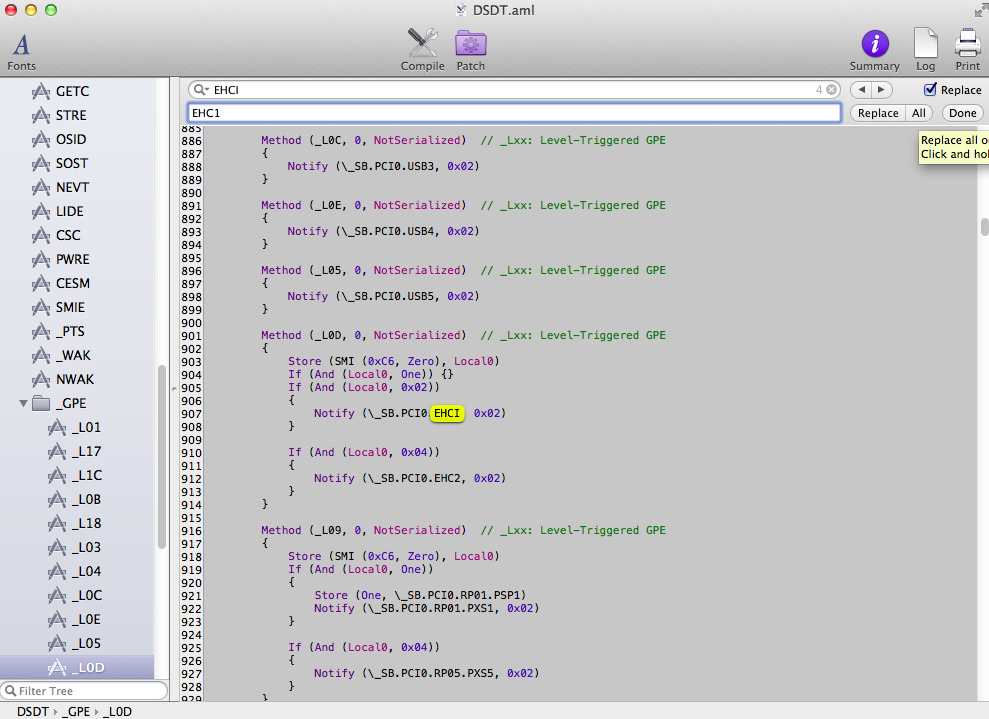

Following a tip from @Polyzargone, I was able to get one of the USB ports (bottom left one) working in OSX 10.11!

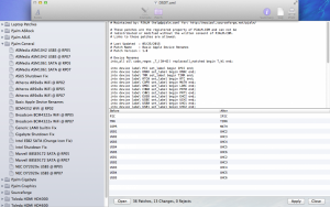

A few additional edits are required to our patched DSDTs (you can use MaciASL with Pjalm's "Basic Apple Renames" patch from his repo):
1.  Rename all instances of USBx to UHC(x+1) where x is a number from 1-5
2.  Rename all instances of EHCI to EHC1
I've used the new DSDT with Mavericks and sleep and all USB functionality seems to be intact.

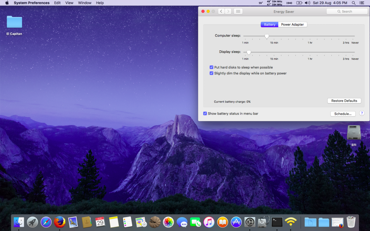

Unfortunately, in El Capitan the 2 other USB ports don't work and sleep is still broken.  The system refuses to go to sleep, even for the first invokation (screen goes blank but fans still run --> can't wake it up without a hard reset).  Audio and other basic functions like shutdown still work however.
Edit 1
The problem seems to be that Apple has defined what ports should be available to the system depending on what SMBIOS is used.  The new kexts controlling USB in 10.11 are AppleUSBEHCIPCI.kext and AppleUSBXHCIPCI.kext found inside IOUSBHostFamily.kext (see @pokenguyen's guide).
Defining extra USB ports for the MBP 5,1 SMBIOS using a legacy AppleUSBEHCIPCIPortInjector.kext enables both LHS USB ports to work.  Only the RHS USB port remains non functional now.
Hopefully Apple will fix the USB drivers in the later DPs or public betas ...
Edit 2
I now have all USB ports working under El Capitan !!!  Using FakeSMC to inject extra USB ports for MBP 5,1 SMBIOS  (copying the native port injection template of MBP 4,1) - thanks @wern apfel's idea.

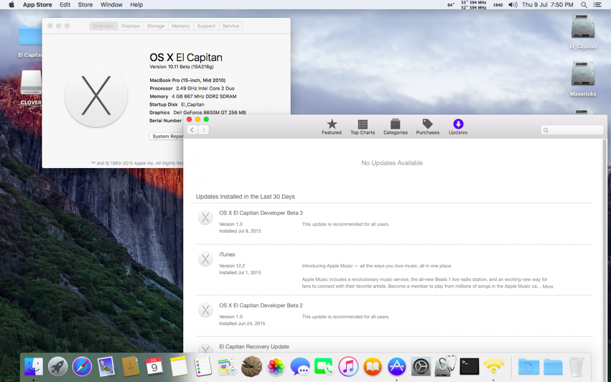

  • 6/28/15 Successful upgrade to DB2  :)...
  • 7/9/15 - Upgrade to DB3/Beta 15A216g with no issues

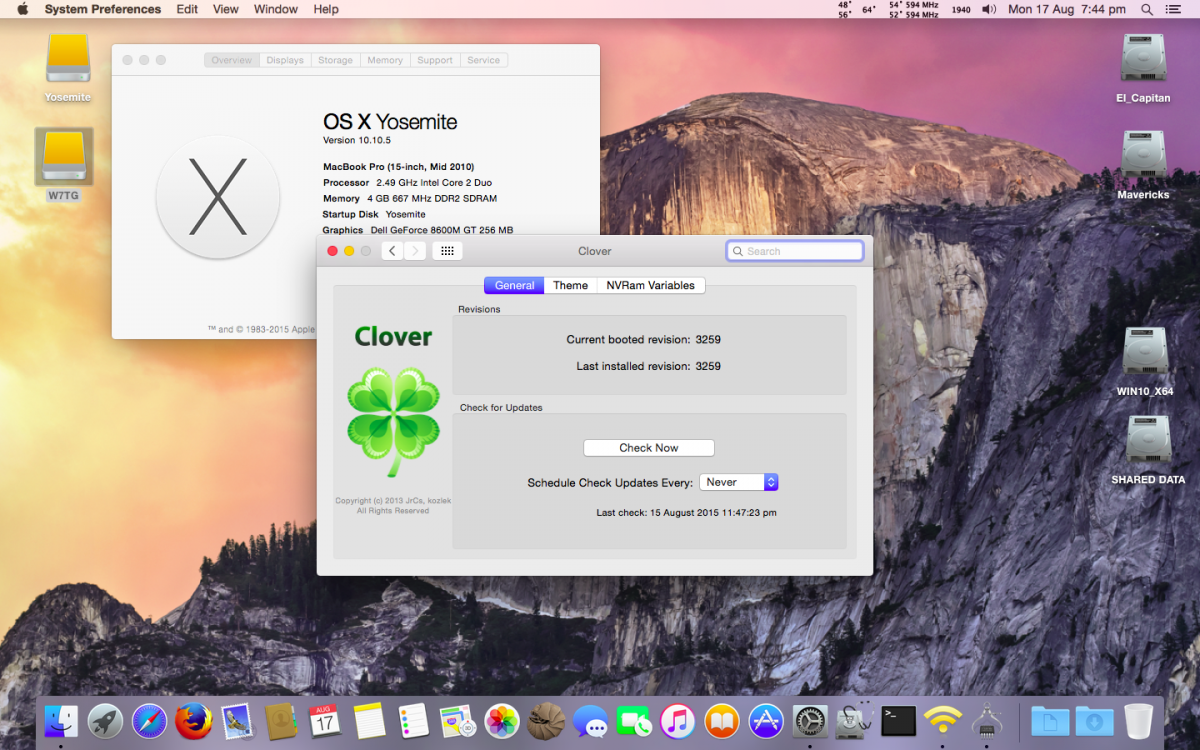

  • 8/4/15 - DB6/15A244d with Clover r3253.  CsrActiveConfig=0x1 in RTVariables/config.plist (allow unsigned kexts) or 0x3 (allow unsigned kexts + allow unrestricted access to file system eg S/L/E) is sufficient for a successful upgrade...
post-846696-0-75894500-1438683588_thumb.

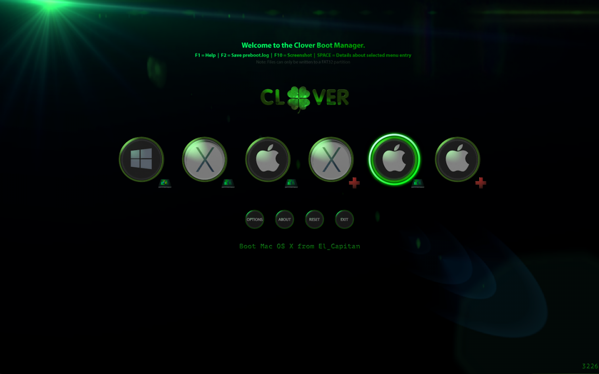

8/15/15 Clover r3258 has kernel patch that fixes kext injection in El Capitan!  If all third party kexts are placed in EFI/CLOVER/kexts/10.11, you can set csr-active-config=0x0 in RTVariables/config.plist and boot with SIP fully enabled.
  • 8/20/15 - DB7/15A263e with Clover r3259.  DB7 has fixed the annoying "you have opened ....app for the first time" bug for auto logon apps introduced in DB6.  Must be getting close to the GM :)....
post-846696-0-63827500-1440066699_thumb.

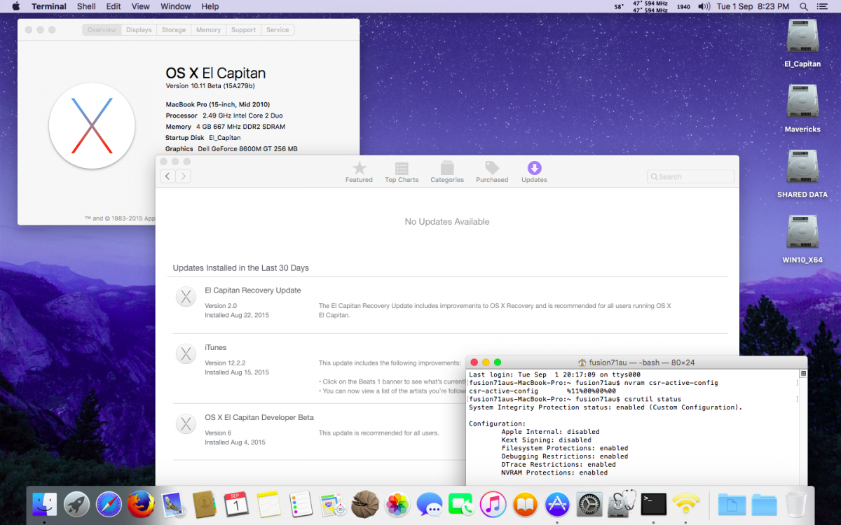

  • 9/01/15 - DB8/15A279b.  All OK after update....

After the final reboot...
post-846696-0-03102600-1441893026_thumb.
You can delete the hidden "OS X Install Data" folder to remove the installer entry from the Clover Main Menu...
post-846696-0-66506600-1441893225_thumb.

I am having a hard time figuring out how to get the battery indicator to work.  I used the DSDT that fusion71au posted (thank you!) in #1888. Tried installing AppleSmartBatteryManager and ACPIBatteryManager with no luck (neither seems to be loading).
Does the DSDT require changes? What am I missing? Thanks!!!
elfox
@elfox,
You can try installing the latest ACPIBatteryManager.kext v1.55 from @Rehabman's repo in /Library/Extensions together with the attached DSDT.aml installed in the EFI/EFI/CLOVER/ACPI/patched folder.
Make sure to have csr-active-config set to 0x3 in RT Variables/config.plist to allow installation of kexts to /L/E, delete or rename AppleSmartBatteryManager.kext in S/L/E and repair permissions/rebuild caches with Kext Utility.
After rebooting the computer, check that the battery kext has loaded by running the kextstat command in OSX terminal eg
fusion71aus-MacBook-Pro:~ fusion71au$ kextstat | grep Battery
   17    0 0xffffff7f80db5000 0x8000     0x8000     org.rehabman.driver.AppleSmartBatteryManager (1.55) 43FC443B-927B-33B3-A081-CCAC54573CB2 <11 4 3>
Unfortunately, my original battery has long since expired (running on AC power only) so I can't test how accurate the battery meter is :).....
More information in the AIO guides: DSDT/SSDT: Enable battery by patching your DSDT using pre-made patches ( Laptop-exclusive ).

You're simply fantastic! Works like a charm. Will see if it's accurate; I am just hoping it will tell me when the battery is almost dead :).
elfox
elfox
Spoke too soon :). Seems to give the correct read after boot, but then the battery meter does not move. Will keep digging; I am certainly further than I was before your help!
