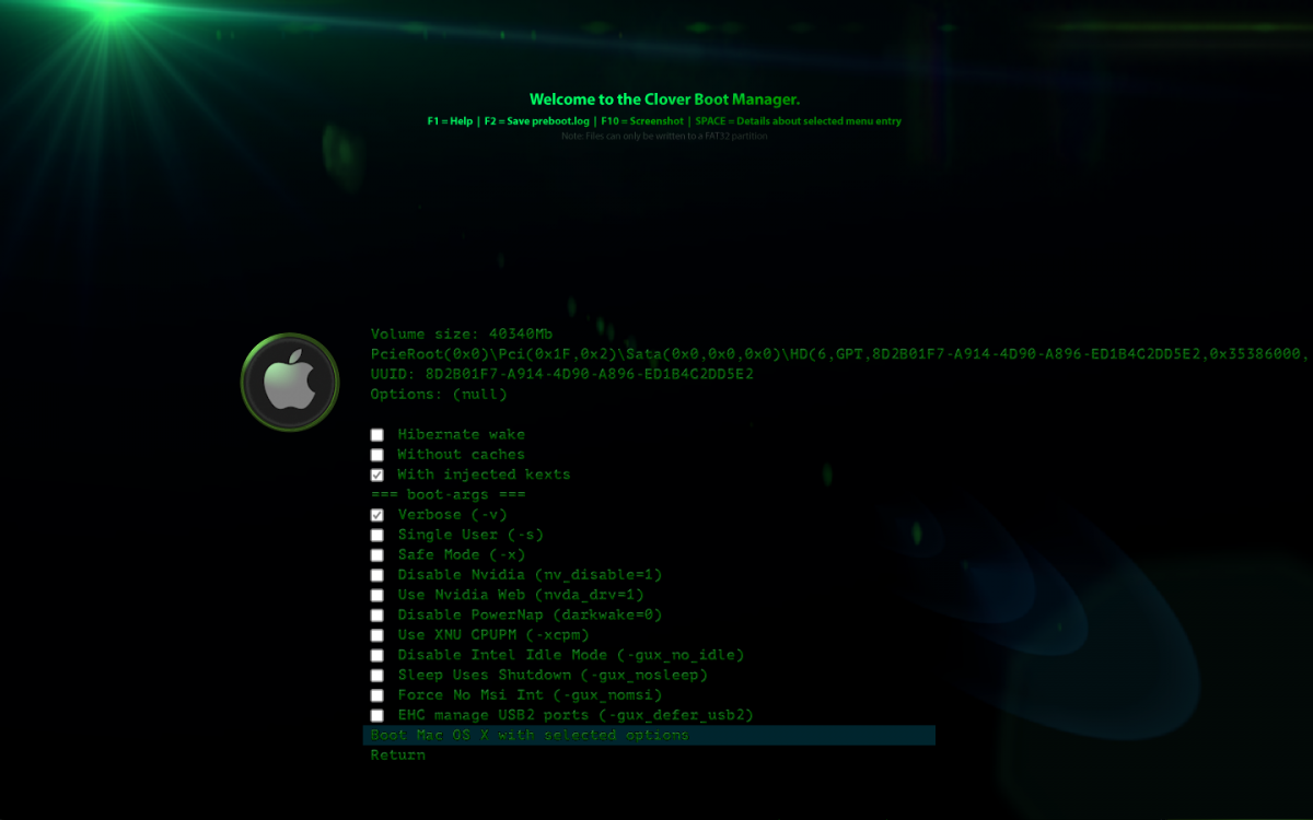

Hi all,
I'm a bit of a newbie and am trying to make my first hackintosh laptop by installing OSX El Capitan on my Dell XPS M1530 laptop using Clover.
The machine spec is Dell XPS M1530 Intel® Core™ 2 Duo T6400 (2.0GHz,2MB,800MHz FSB), 4 GB RAM, NVIDIA® GeForce™ Go 8600M GT with 256MB dedicated graphic memory. It has a Dell 1505 WIFI card.
This is what I have done so far:
1. Installed OS X El Capitan installer media onto a USB stick.
2. Installed the latest version on Clover on the USB stick and customised using the options shown on the following guide  http://www.insanelymac.com/forum/topic/295549-clover-config/?p=1988337
3. From the same post downloaded "El Capitan XPS M1530 Installer Files.zip" and installed the files onto the USB stick EFI partition. I assume I didn't need to install the files from 'Clover files for XPSm150.zip'. I put all the kexts in the Other folder.
4. Booted from the USB stick, partitioned/formatted laptop hard drive and installed OSX El Captain.
5. Once OSX was configured, I installed and configured clover on the laptop harddrive in the same way as based on step 2 and 3.
The graphics/resolution, wifi, keyboard/trackpad are all working.
The items which are not working are:
1. Sound
2. The battery icon is not shown in the task bar and the laptop just switches off when the battery dies :(
3. Bluetooth (I have Dell™ Wireless 355 Bluetooth 2.0 Module)
Any pointers on how I can the above working and how to check the kext's are getting loaded correctly?

For sound and bluetooth, install VoodooHDA and BroadcomAppleBluetooth kexts in /L/E or /S/L/E from DarwinX's 10.9.x kext pack - post#1641.
Battery requires @Rehabman's ACPIBatteryManager.kext - see post#1891 for discussion.  I can't test whether its working 100% in El Capitan because my battery has long since expired and I'm running on AC power.
To check whether third party (non Apple) kexts are being loaded, type in terminal
kextstat | grep -v com.apple
You can also try @Micky1979's kextstatx86 utility which will show where the kexts are being loaded from eg /L/E, /S/L/E, EFI/EFI/CLOVER/kexts/Other etc.
Thank you for replying fusion71au.
  1. Sound is now working :)
  2. Bluetooth still doesn't work. I installed BroadcomAppleBlutooth in /S/L/E but checking with kexstatx86_utility, it doesn't seem to be loading. Is there anything else I need to do?
  3. I installed ACPIBatteryManager and now the icon is displaying in the task bar. Unfortunately the battery percentage doesn't change (or if I unplug the power supply - it still says connected to AC power). Not sure what else I need to configure.  I assume this used to work ok in Mavericks/Yosemite?

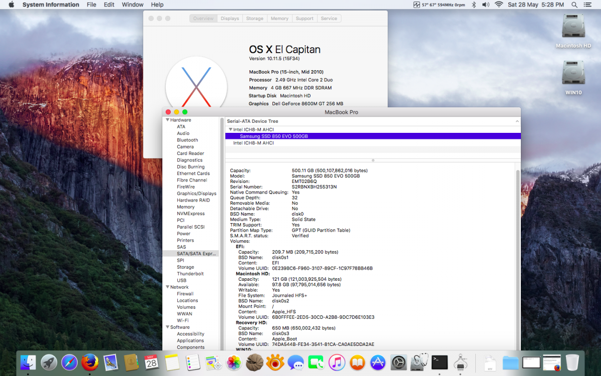

Hi Guys,

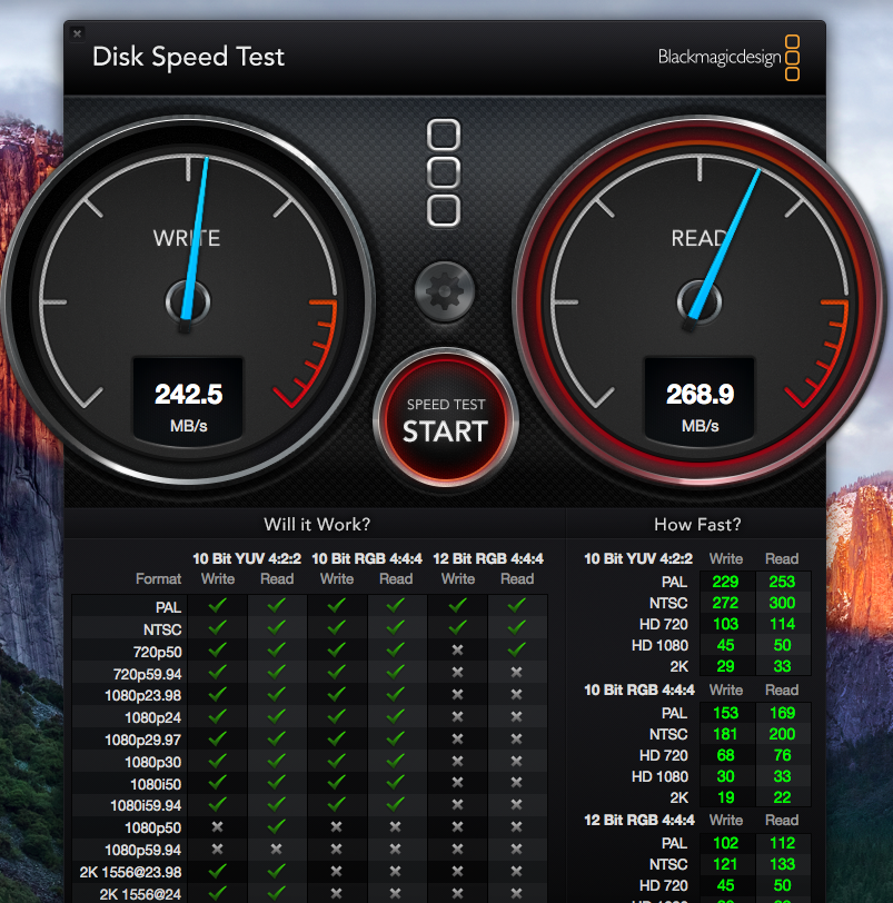

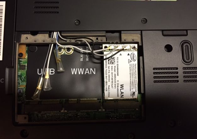

With Apple taking so long to upgrade its MBP lines to Skylake, I thought I would spend a few dollars on hardware upgrades for the old girl :).
I then installed El Capitan 10.11.5 and Windows 10 in UEFI mode (with Clover r3526 using the same settings as in post#5).  The El Capitan USB installer was made with createinstallmedia command in terminal.
Needless to say, the upgrades made for a much more pleasant experience on OSX, significantly improving bootup times, faster opening of programs/apps and native wireless OOB on El Capitan.  You can enable trim on the SSD with either a Clover patch or the trimforce enable command in terminal.  Unfortunately, we can't exploit the full potential of the SSD since the XPS is limited to SATA II 3Gb/s and not SATA III 6Gb/s.

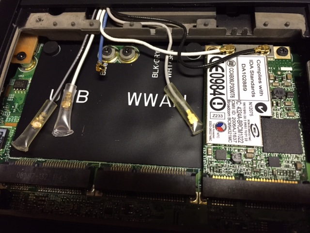

Notes:
  • Link to ifxit repair guides for XPS M1530
  • The DW1505 has only 2 connector ports (white, black antenna cables) while the original Intel card had three (for white,grey,black antenna cables)
  • Owing to the slim SSD (only 7mm vs 9.5mm standard HD), it took several goes before I was able to correctly insert the EVO 850 into the host SATA port (I had a few heart stopping moments where no drive was detected!!).
  • Like 4

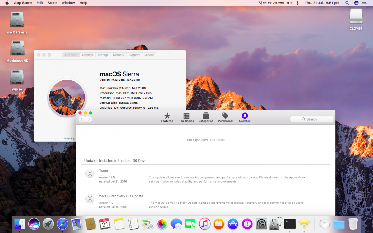

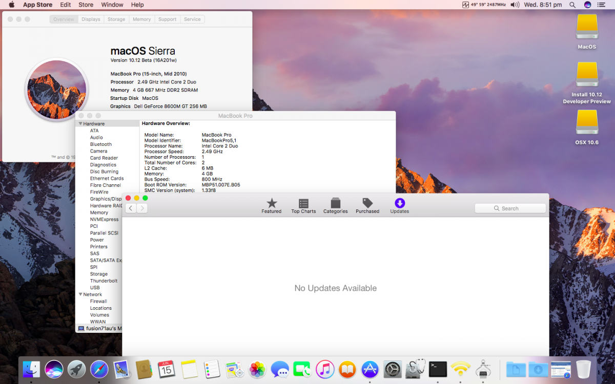

Its that time of year again!  A new MacOS developer preview has arrived…. :)

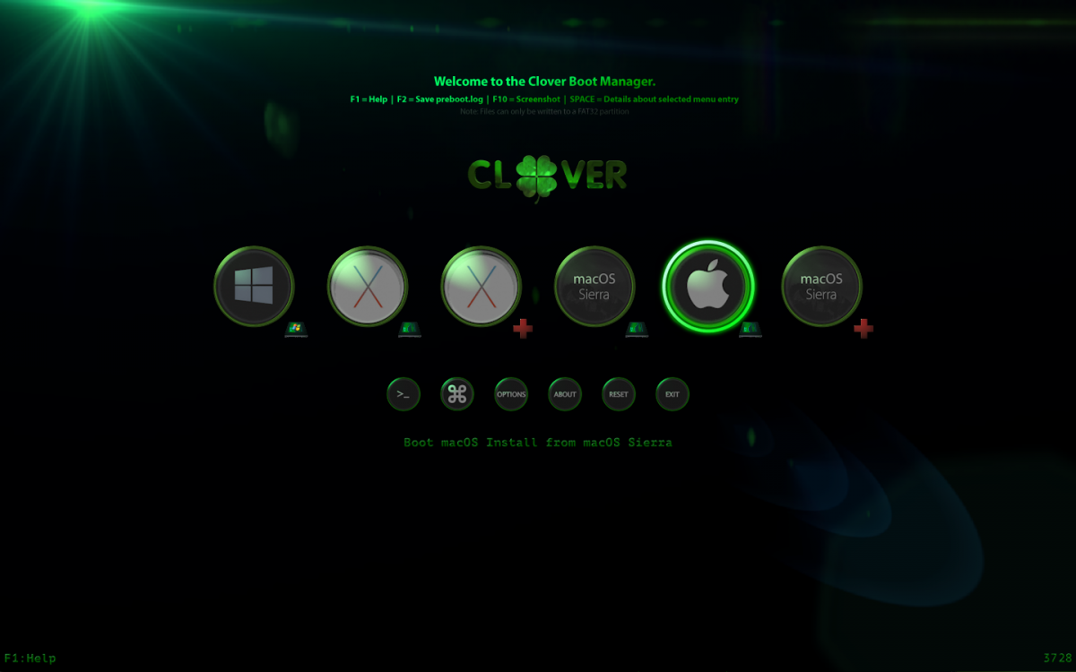

I managed to install the first Developer Preview of MacOS Sierra 10.12 on my XPS M1530 with the latest Clover r3561 and the createinstallmedia method.
Apple has put a stumbling block in our way since the MBP5,1 SMBIOS is no longer on the supported system list for the installer.  One way you can bypass this is by temporarily using a SMBIOS that is on the officially supported list eg MacBook6,1 or MBP7,1.  This has the unfortunate side-effect of causing a kernel panic unless you delete or disable /System/Library/Extensions/IONetworkingFamily.kext/Contents/PlugIns/AppleYukon2.kext.  You can keep the Appstore functioning with the MBP7,1 definition by replacing AppleYukon2 with @Rehabman's NullEthernet.kext.
Once the installer has completed putting all the OS files on the target partition for Sierra, you can boot into another OSX partition and change the SMBIOS back to MBP5,1.  Note that as a minimum, your processor must support SSE4 - Penryn and newer Intel processors OK but not Merom.
The system feels a lot like El Capitan but with the obvious addition of Siri.  Unfortunately, the DW1505/BCM94321 Airport card doesn't work in Sierra (they removed /System/Library/Extensions/IO80211Family.kext/Contents/PlugIns/AppleAirPortBrcm43224.kext) so I had to go back to my trusty old ASUS N10 USB wireless adapter.
I'm using the same kexts and settings as El Capitan.  In the post install phase, I placed VoodooHDA, AppleHDADisabler in /L/E.
Updates
062116
I've attached the necessary files to this post - OSInstall MBP5,1.zip.  Assuming your USB installer is named "Installer":
  • Copy OSInstall.mpkg to /Volumes/Installer/System/Installation/Packages
  • Copy InstallableMachines.plist to /Volumes/Installer/System/Installation/Packages
  • Copy PlatformSupport.plist to /Volumes/Installer/System/Library/Core Services
072116

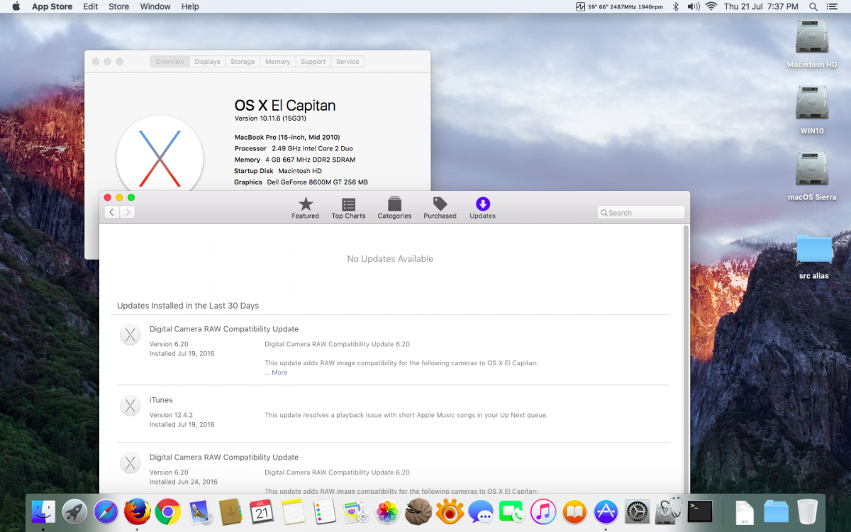

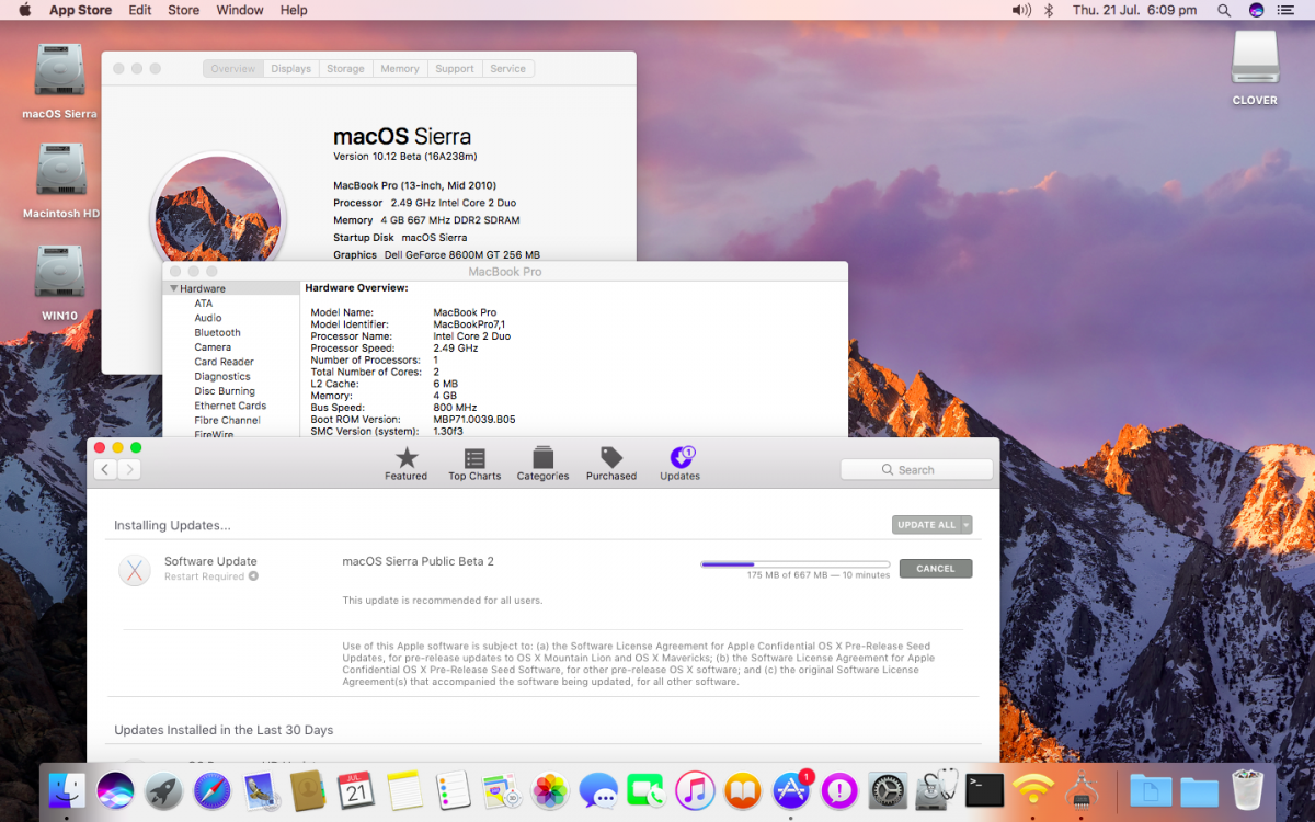

Successfully updated to El Capitan 10.11.6 on my main partition and macOS Sierra Public Beta2 on my "test" partition :).
To upgrade Sierra PB1 to PB2, I changed the SMBIOS in Clover's config.plist to MBP7,1 so the App Store allowed the update for a "compatible machine".  After the installer finished writing files to disk, at the first reboot, I went back into El Capitan to delete /System/Library/Extensions/IONetworkingFamily.kext/Contents/PlugIns/AppleYukon2.kext on the Sierra partition, then booted back into Sierra to finish the upgrade using MBP7,1...
080316
Straightforward update of Sierra PB2 to PB3_16A270f by booting with MBP7,1 SMBIOS.
081616
Sierra PB4_16A286a and PB5_16A294a OK as above....
083016
No problems with PB6_16A304a and PB7_16A313a

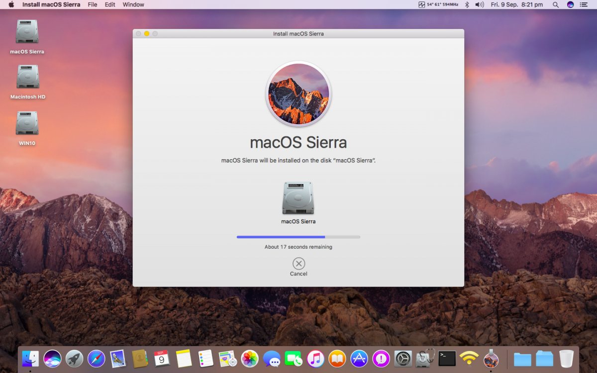

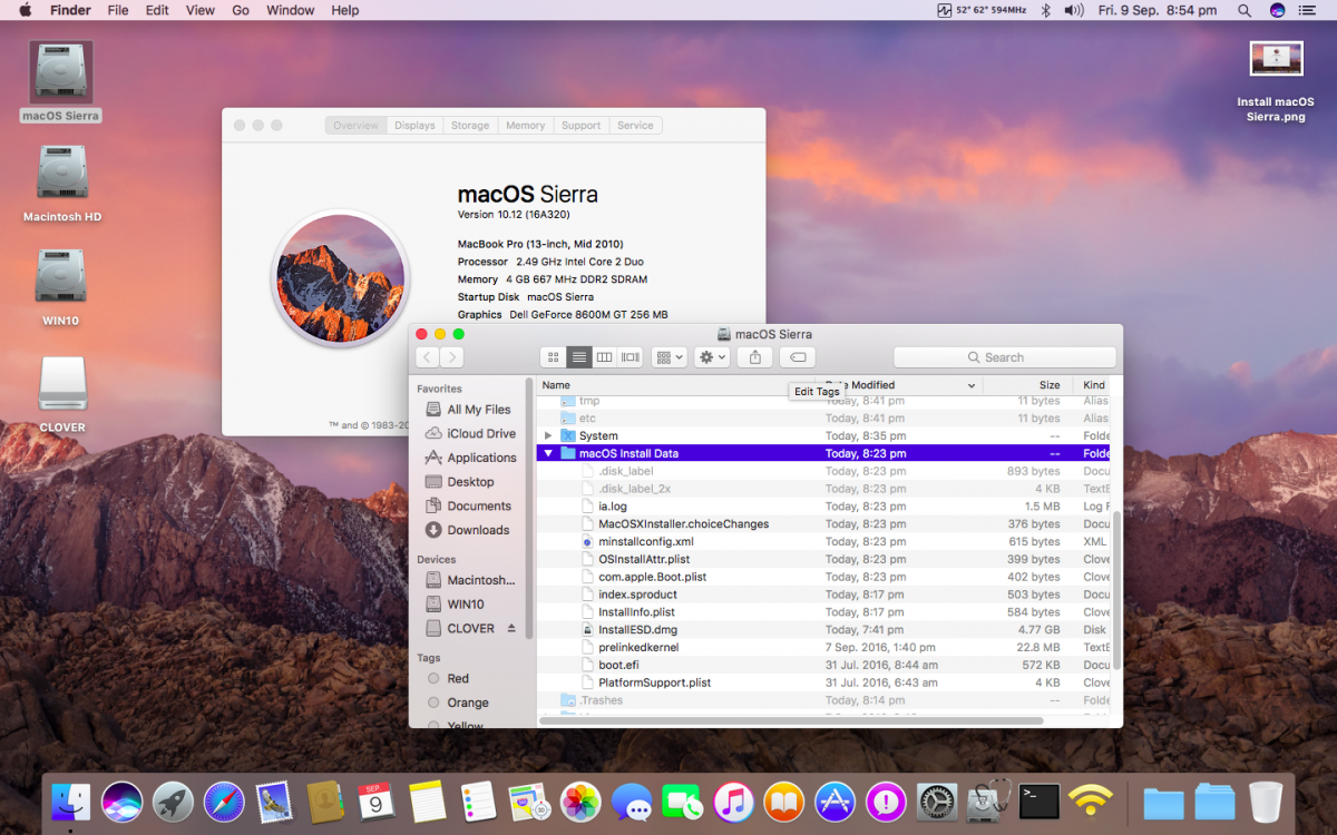

090916 MacOS Sierra GM
Updated successfully to Sierra GM 16A320 by directly running the Installer app from the Applications folder, rebooting into "macOS Install" in verbose mode with injected kexts....
After all the files are written to the Sierra partition, there is a final reboot into the OS proper.  You can then delete the temporary installer files from the folder /macOS Install Data.
XPS M1530_SierraMBP7,1.zip
  • Like 6

Yes, El Capitan 10.11.6 running well with Clover r3650 and no changes to kexts/dsdt/config.plist_SMBIOS MBP5,1 or any issues since 10.11.5 :).  Have a look at your console logs to see if you can find the cause of your kps.

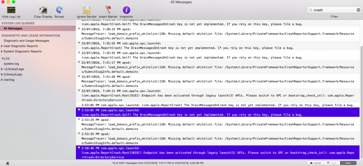

Wow there is something going on.  Seeing these crashes.
7/22/16 7:26:23.248 AM com.apple.xpc.launchd[1]: (com.apple.ReportCrash.Root[514]) Endpoint has been activated through legacy launch(3) APIs. Please switch to XPC or bootstrap_check_in(): com.apple.ReportCrash.DirectoryService
and
7/21/16 7:43:56.816 AM com.apple.xpc.launchd[1]: (com.apple.ReportCrash) The DrainMessagesOnCrash key is not yet implemented. If you rely on this key, please file a bug.
I also see many warning messages regarding the ACPIBatteryManager.
7/22/16 7:43:51.000 AM kernel[0]: ACPIBatteryManager: WARNING! fCurrentCapacity > fMaxCapacity. adjusted fCurrentCapacity from 7800, to 5416
I attached one of the mds_stores report.  I don't actually get a kernel panic after that crash but maybe from continuous crashes the kernel eventually panic's or nothing to do with a kernel panic?
I did a clean install on 10.11.4 crashes started then.  Are you seeing any warning messages or crashes of this nature on your device?
Crash.pdf

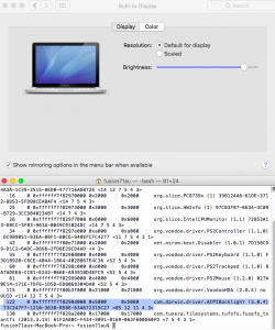

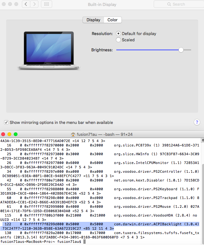

On El Capitan (10.11.x), do the brightness controls on the laptop keyboard work for anybody?
It hasn't been working for me since Yosemite. Does anyone know how to solve it?
With @Rehabman's ACPIBacklight.kext v3.0.4 (RehabMan-Backlight-2015-1001.zip), I get a working brightness slider in System Preferences/Display for El Capitan 10.11.6.  Not sure about keyboard control for it though...
I also get warning messages like "Endpoint has been activated through legacy launch(3) APIs.  Please switch to XPC or bootstrap_check" and "The DrainMessagesOnCrash key is not yet implemented" in my console...
but it doesn't seem to affect the system in any way.  I don't think these are related to your kps/reboots.  Confirm the exact time(s) when the kp occurs and then check the console messages/processes immediately before it happens.
Can't really comment on the ACPIBatteryManager warning (since my battery stopped working, I run my XPS on AC power so don't bother with a battery kext anymore) but most probably harmless.
mds_stores is related to spotlight indexing and may cause excess CPU usage (possibly hangs & reboots?).  You can try disabling spot light indexing (google) and see if that helps.

Re compatible wifi cards - see this wifi list @OSXLatitude.
@Fusion71au
Thanks much. Just did it.
Not sure what the iCloud and App Store deal is. My shared notes don't appear in the app and I can get apps for free that I bought on other devices. But when I log into the iCloud through Safari, I see my shared notes, collaborate spreadsheets and even see Macbook pro in my list of devices on my account lol...
p.s. I see my wifi card Dell DW 1395 BCM4312 on the list. Thank you.
