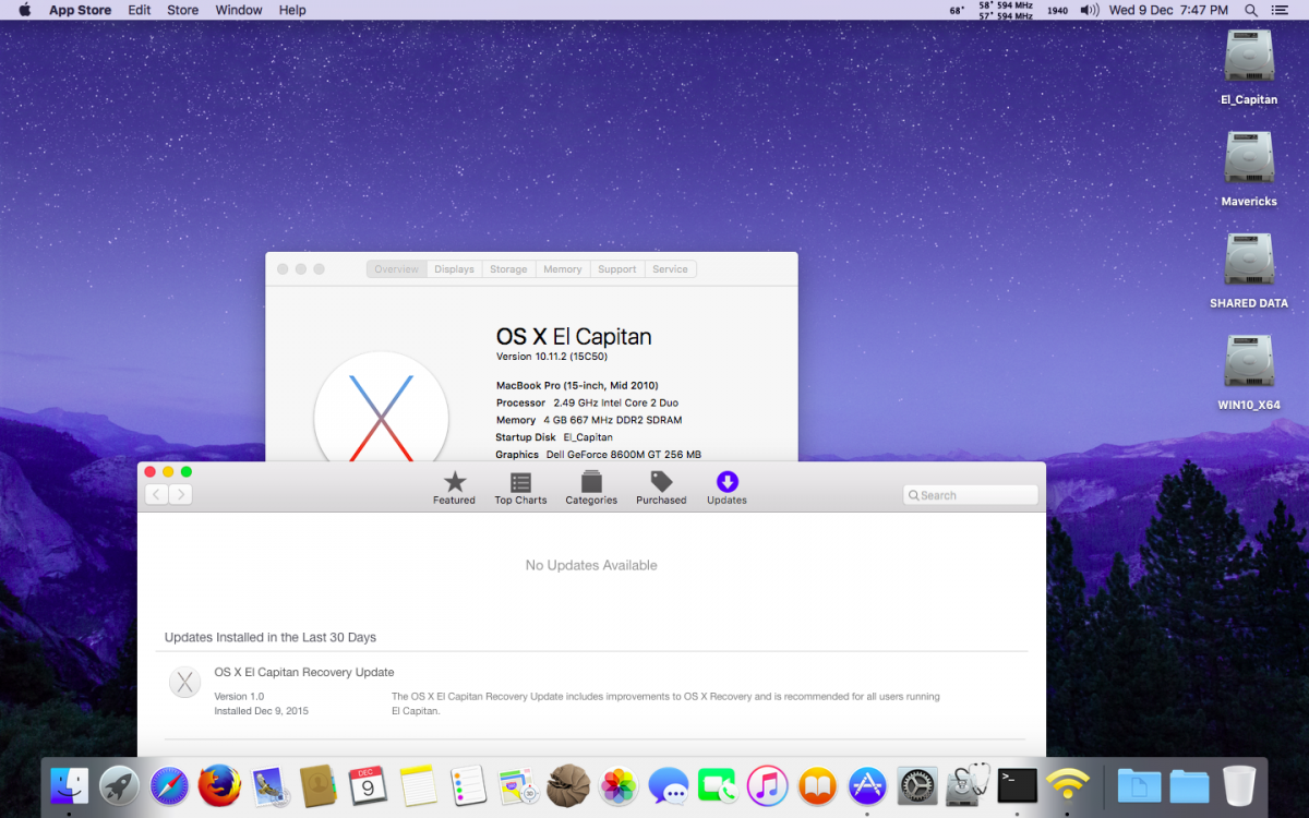

I did the update to 10.11.2, also Security Update to Mavericks, in both cases I lost Sound, my modded AppleHDA.kext no longer loads in neither  :(
As always VoodooHDA only gives sound on the headphones jacks but nothing on the speakers.
kextcache shows this:
WARNING - Invalid signature -67030 0xFFFFFFFFFFFEFA2A for kext "/System/Library/Extensions/AppleHDA.kext/Contents/PlugIns/AppleHDAHardwareConfigDriver.kext"
WARNING - Invalid signature -67061 0xFFFFFFFFFFFEFA0B for kext "/System/Library/Extensions/AppleHDA.kext/Contents/PlugIns/AppleHDAController.kext"
WARNING - Invalid signature -67061 0xFFFFFFFFFFFEFA0B for kext "/System/Library/Extensions/AppleHDA.kext"

Hi @macgirl,
Did you remember to set CsrActiveConfig to 0x3 in your config.plist/RtVariables before running the update?  This will allow you to replace the native AppleHDA.kext in /S/L/E with your patched one and then rebuild caches/pre-linked kernel by running Kext Utility ---> reboot.  Once everything is back up and running, you can set CsrActiveConfig back to 0x0 for maximum security.
I use VoodooHDA on my XPS M1530 so everything worked for me after the 10.11.2 update :).
Yes, CsrActiveConfig is set to 0x3, remember that VoodooHDA never worked with my XPS M1330, so something new is making a conflict with that old AppleHDA.kext
Edit: I didn’t use Kext Utility, before this update I copied the AppleHDA.kext manually and worked, just a moment ago I used KU on Mavericks but still not working.
Edit2: I did use KU on El Capitan with success, sound is back.
Edit3: I just rebuild the kext cache from El Capitan to the Mavericks partition and sound is Back.

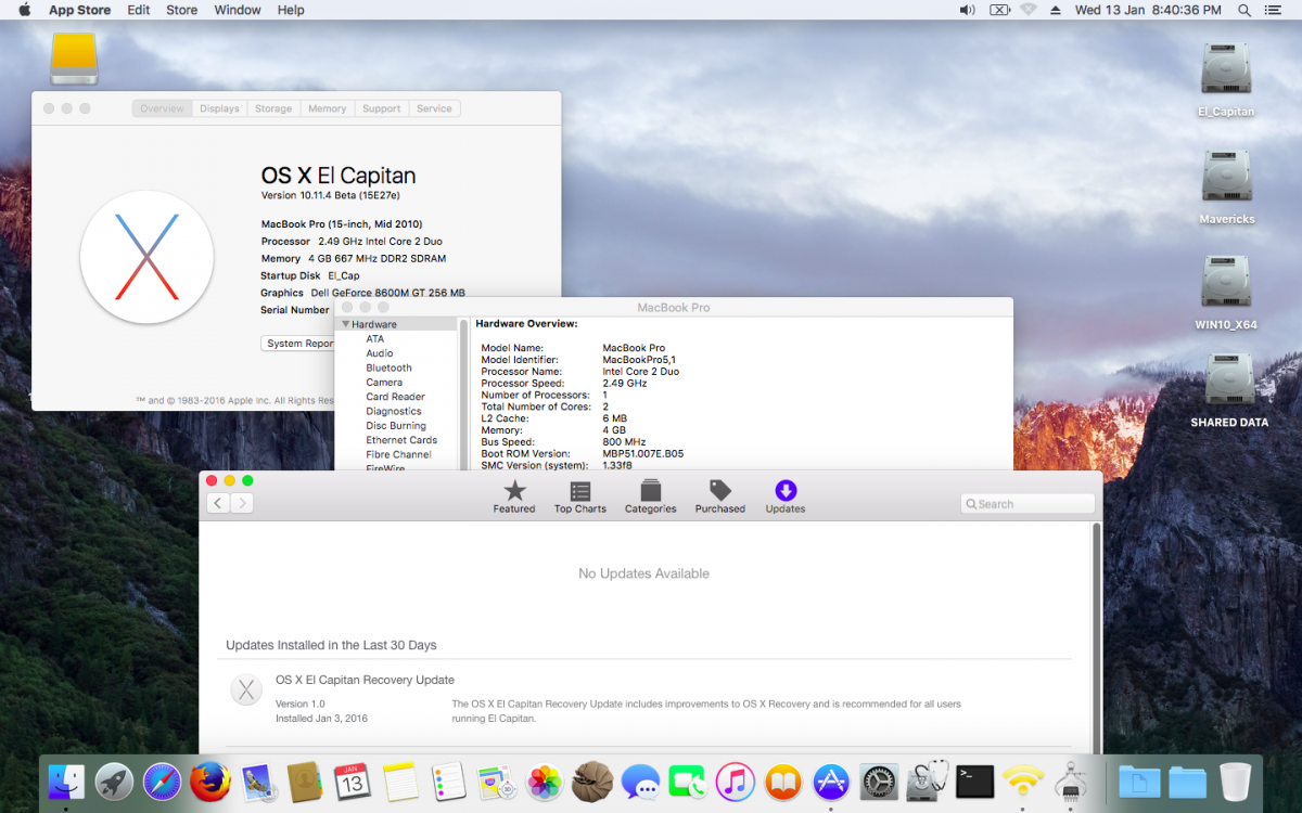

FYI, Apple has released Beta 10.11.4 (15E27e) even before officially releasing 10.11.3 :P...

@macgirl,
What error messages do you see when booting in verbose mode?  Safe mode work with or without caches?
I successfully updated the El Capitan partition on my XPS M1530 to 10.11.4 (Build 15E65) with the combo updater.  The process went without a hitch using Clover r3354 (set CsrActiveConfig in config.plist to 0x3 before upgrade) and VoodooHDA for audio.
@fusion71au,
There was no errors, the boot process just stop, like the disk was not recognised.
On the iMac I didn’t have a change to take a Photo, right now I’m on 10.11.3 again, tomorrow I’ll try it again.
On the XPS 10.11.4 is on the 2nd stage of installing…
FYI MacGirl's problems do not appear to occur when simply updating from 10.11.3 to 10.11.4 on my XPS1330 using App Store, which I imagine is what most of us want to do. I had two problems with 10.11.3 that continue with 10.11.4. Sometimes the kext VoodooHDA does not load (it might even unload on it's own but I haven't been able to prove that yet), and when VoodooHDA isn't working, graphics speed stepping also does not work. When it happens the kextload command can be used to load VoodooHDA manually and sound will work, however graphics speed stepping cannot be made to work using kextload to load the patched AppleGraphicsPowerManagement.kext. Both kexts are located in /EFI/CLOVER/kexts/10.11, and moving VoodooHDA into /System/Library/Extensions does not help. As always I had to patch AppleGraphicsPowerManagement to get GPU power states.
Disclaimer - I only tested 10.11.4 quickly. I haven't used it for any extended period of time.
