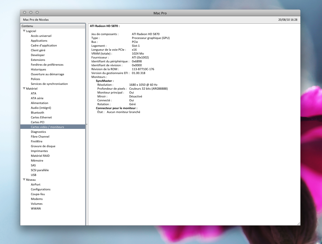

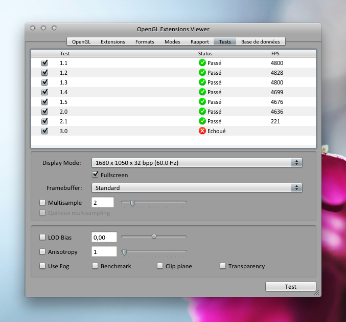

The Real Deal Posted August 20, 2010 Share Posted August 20, 2010 Alright.. another 5870 in club. Props to Netkas. Link to comment https://www.insanelymac.com/forum/topic/189646-radeon-hd-5870-hd-5850/page/17/#findComment-1533679 Share on other sites More sharing options...

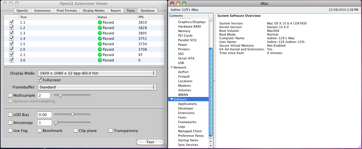

kernel_picnic Posted August 22, 2010 Share Posted August 22, 2010 Hy all, You should take a look here : http://www.insanelymac.com/forum/index.php...;#&post=405 AWESOME, it works! A screenshot and the BIOS ROM are attached The OpenGL scores are as if ATY_init.kext is used instead. My Config : Core i5 750 GA-P55-USB3 XFX 5850 ( Reference ) What I've done : A clean install of SL 10.6.4, install the kexts from iMac update mid 2010: ATI5000Controller.kext ATIRadeonX3000.kext ATIRadeonX3000GA.kext ATIRadeonX3000GLDriver.kext ATIRadeonX3000VADriver.kext ATISupport.kext ATIFramebuffer.kext Rebuild caches and repair permissions using Kext Utility 2.4.2 Add the keys to com.apple.Boot.plist <key>UseAtiROM</key> <string>yes</string> <key>GraphicsEnabler</key> <string>Yes</string> Reboot, and enjoy Keep on your good work Trauma! 1002_6899.rom.zip Link to comment https://www.insanelymac.com/forum/topic/189646-radeon-hd-5870-hd-5850/page/17/#findComment-1534645 Share on other sites More sharing options...
sirbow2 Posted August 22, 2010 Share Posted August 22, 2010 AWESOME, it works! A screenshot and the BIOS ROM are attached The OpenGL scores are as if ATY_init.kext is used instead. My Config : Core i5 750 GA-P55-USB3 XFX 5850 ( Reference ) What I've done : A clean install of SL 10.6.4, install the kexts from iMac update mid 2010: ATI5000Controller.kext ATIRadeonX3000.kext ATIRadeonX3000GA.kext ATIRadeonX3000GLDriver.kext ATIRadeonX3000VADriver.kext ATISupport.kext ATIFramebuffer.kext Rebuild caches and repair permissions using Kext Utility 2.4.2 Add the keys to com.apple.Boot.plist <key>UseAtiROM</key> <string>yes</string> <key>GraphicsEnabler</key> <string>Yes</string> Reboot, and enjoy Keep on your good work Trauma! so you dont need ATY_INIT sweeet! im gunna try this! I have a HIS 5850 can i still use the rom you attached? what version of chameleon are you using? Link to comment https://www.insanelymac.com/forum/topic/189646-radeon-hd-5870-hd-5850/page/17/#findComment-1534928 Share on other sites More sharing options...

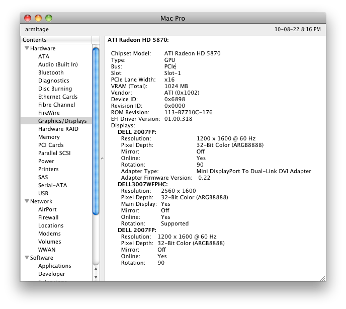

zoob Posted August 23, 2010 Share Posted August 23, 2010 Got mine working on three displays as well! Reference Sapphire HD5870 1GB PCI-E 2.0. Link to comment https://www.insanelymac.com/forum/topic/189646-radeon-hd-5870-hd-5850/page/17/#findComment-1535122 Share on other sites More sharing options...
