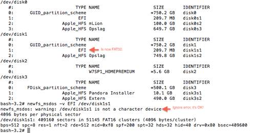

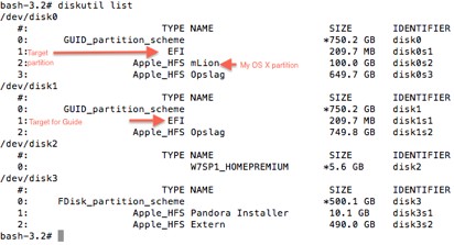

1.)
First we need to find the HDD that has OS X installed on a GUID partition table, and look for the EFI partition. Open terminal and type:
sudo -s
type password
diskutil list
I have Clover already installed on disk0s1, for this guide i will install it to disk1s1, which is my spare HDD, also formatted to GPT.

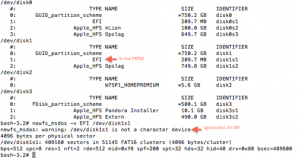

2.)
We need to apply a new filesystem to the EFI partition, remember to replace the X corresponding to your disk setup.
In terminal enter:
newfs_msdos -v EFI /dev/diskXsX
It will give an error, you can ignore it. The EFI partition has been formatted to FAT32 and can now be recognized by UEFI.
3.)
Now it is time to mount the EFI partition and copy the needed files. Type the following into terminal, remember to replace the X's:
mkdir /Volumes/EFI
mount_msdos /dev/diskXsX /Volumes/EFI
NB : You can mount /unmounts EFI partition for every disk with EFI mounter.app or even  better with Clover Configurator.app (http://www.hackintoshosx.com/files/file/49-clover-configurator/)  you will need this later on !
Go to finder, on the left hand side, you will now have a disk called EFI.

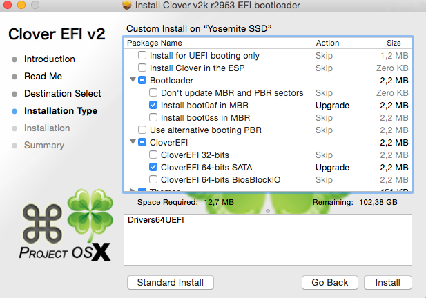

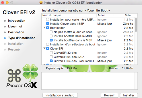

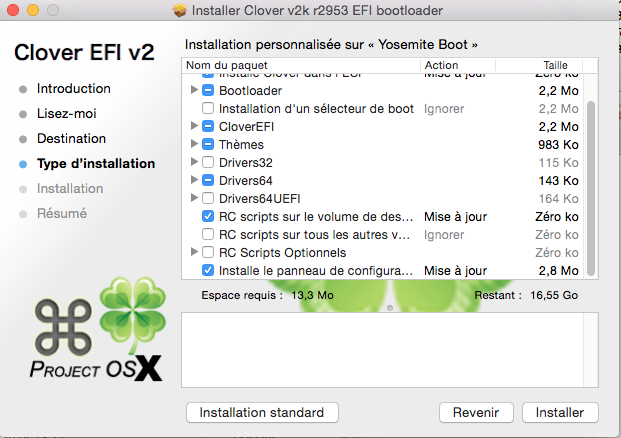

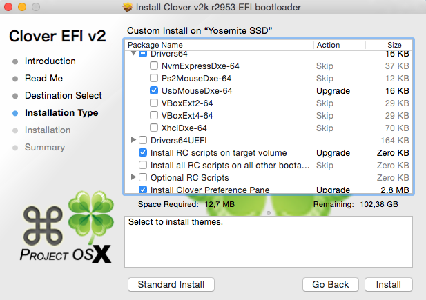

Install Clover with Clover EFI Bootloader  v2K- r2953
Be aware to chose the right disk you want to install it  !!
Personalize your install like this:

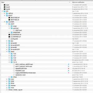

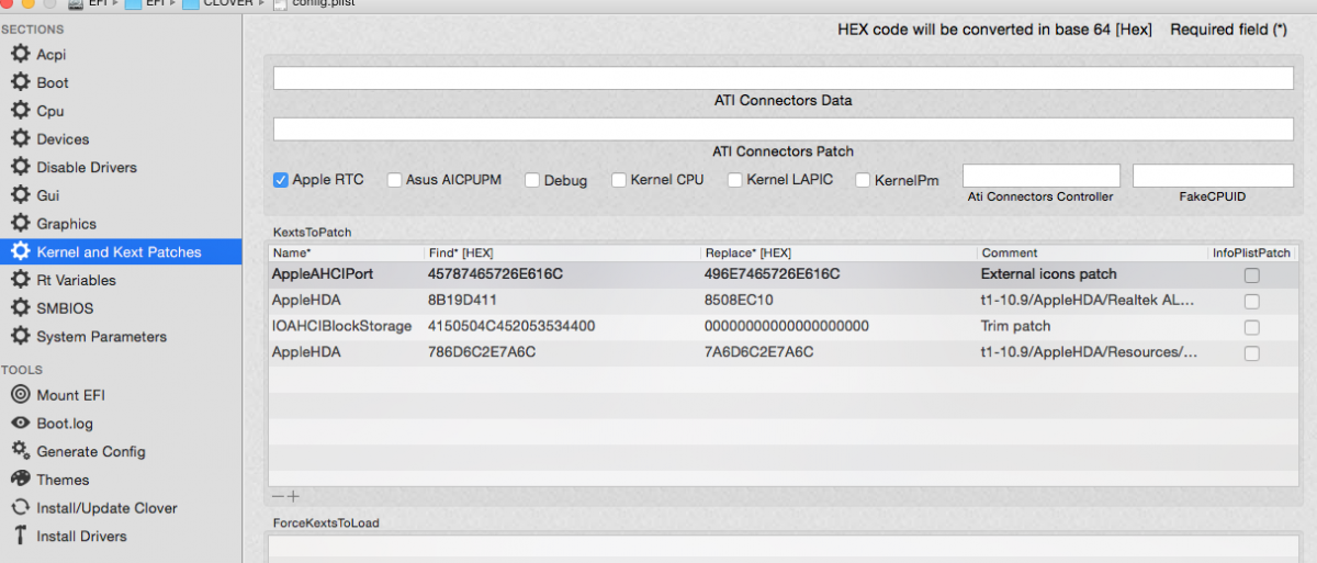

Here is my config.plist for EX58-UD5 to replace the default config.plist in EFI/CLOVER
config.plist.zip

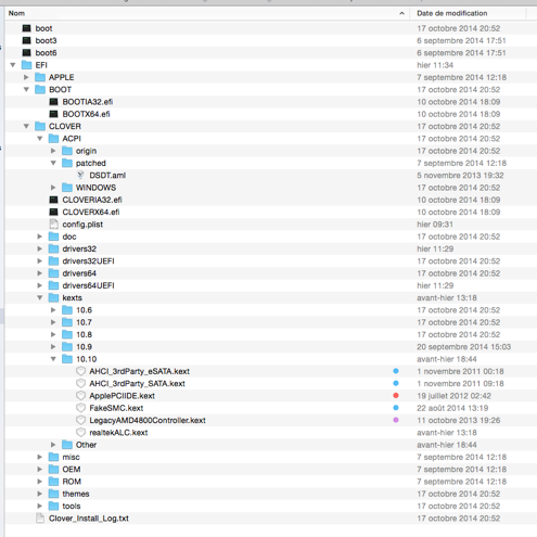

And you get this structure on EFI partition:
As you know already one of the the most important concerns in the hackintosh world is how to create a good DSDT.aml.
If you already have your own DSDT.aml, you can directly place it into/EFI/CLOVER/ACPI/patched/
Put your kexts in EFI/CLOVER/kexts/10.10 folder
(essential one is FAKESMC.kext)
Rebuild permission and cache with Kext wizard for example

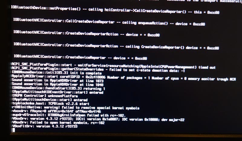

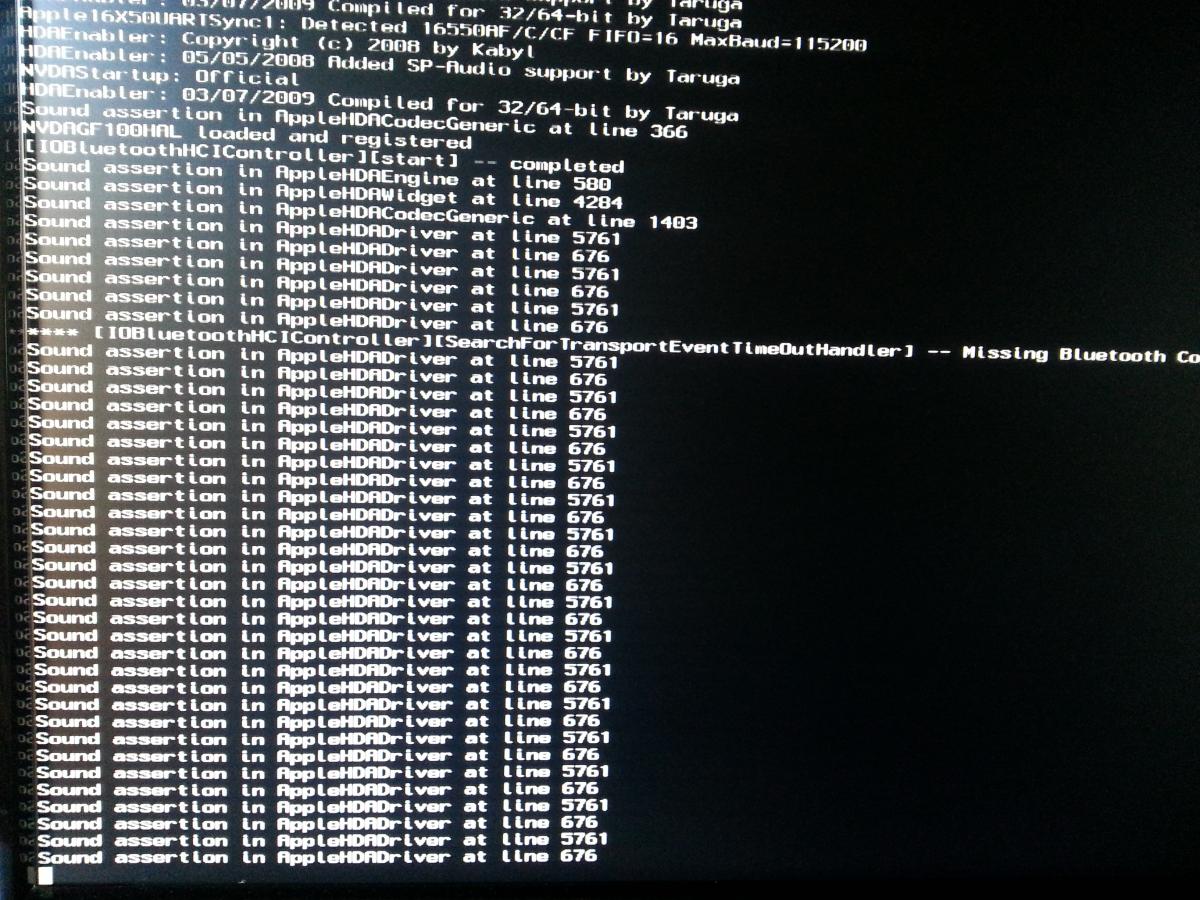

Hi all,
I'm getting a boot loop (sound assertion in AppleHDADriver at line...) with Yosemite. After 5 minutes i got a white screen and nothing else happens.
Here is a screenshot
What can i do?
UPDATE:
If i use "GraphicsEnabler=Yes" i got white screen; if I use "GraphicsEnabler=No" i got "no signal" on my monitor
Hi, I wanted to borrow some of the expertise you guys have if possible, especially you EX58-UD5 users.
I've just moved to Clover after installing Yosemite because I was having problems booting with Chameleon.
Now my Yosemite drive boots but it shuts down during the boot sequence and restarts.
My system is EX58-UD5 F13, 2.67GHz core i7 (I think that makes it a 920), GeForce 9800 GT, 6GB RAM. The Yosemite boot drive is a Crucial 512Gb SSD.
I formatted my EFI partition to FAT 32, installed Clover, replacing the Vboxhfs-64.efi driver with the HFSPlus.efi.
I copied Robasefr's config.plist and used that. I'm not using a DSDT.aml file, though I have one which was working with Mavericks, and fixed my cmos reset problem. I understand Clover should fix that now?
The kexts in EFI/Clover/kexts/10.10 are:
FakeSMC
IONetworkingFamily
NullCPUPwerManagement
I then tried adding the other kexts from my Mavericks install, but had the same restart issue.
Last screen grab before restart: post-642001-0-03038200-1414322540_thumb.jpg
I'm not sure where to begin with fixing this... Thanks for any suggestions!
@ROBASEFR
I'm trying to make the switch to Clover. Attempted this a year ago and didn't have much luck...
In post 4409, you provide two screenshots for the clover custom install setting. The 2 screenshots are identical. I'm assuming one of them should show the bottom portion of the options (drivers, etc.). Would you be so kind to upload the other screenshot?
Thanks!
Colddiver
here are my clover install settings:
General rule of thumb: only install stuff that you know you will need. Try to boot with minimalistic settings first and then add things like audio etc
edit: I described a couple of months ago how to install yosemite. This still applies but I replaced the IONetworking with the RTL811v3 kext from Mieze
edit2: the screenshots here are for my install on the usb thumb drive. If you want to install on the EFI partition, you have to check "Install Clover in the ESP"

Partial success!
Was able to boot Yosemite from Clover (finally!). I had no network and no sound though. I will try the toleda thing for audio. For network, I had the same RealtekRTL81xx.kext I used with the scripted setup in my CLOVER/kext/10.10 folder but somehow it didn't load. FakeSMC loaded fine though.
Will be trying to troubleshoot the audio and network issues - if any of you has any pointers, let me know.
Getting closer now at least!

@ROBASEFR
Thanks!
Colddiver
Sorry about that !
I modified the second screenshot

In config.plist  with "Clover configurator"
Devices:
Did you make  "1" active in Audio ?
This should be your Kernel and Kexts patches menu:(when you apply latest Toleda V3 Clover command) https://github.com/toleda/audio_CloverALC
Good luck
