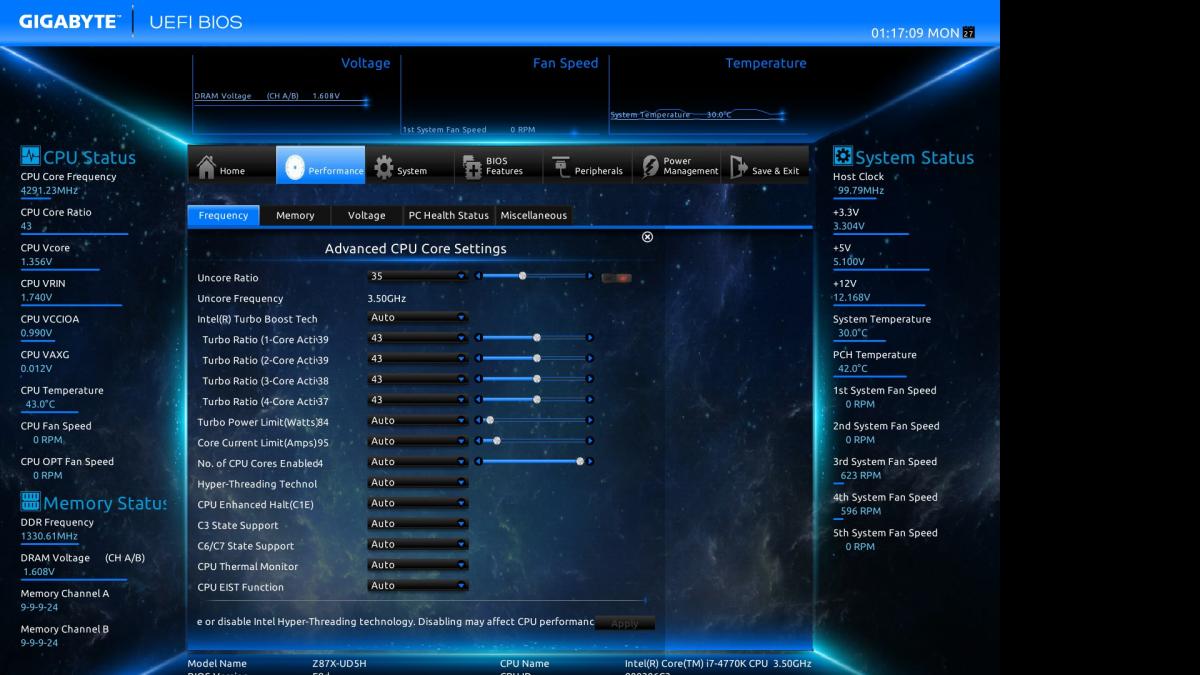

Gigabyte GA Z87X-UD5H by chris1111
See Post
Gigabyte GA-Z87X-UD5H Rev 1.0 Bios F8D Beta Bios by FusselFux
See Post

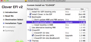

Clover v2.4 r4392 Legacy boot--->CloverEFI
Motherboard:
Dell XPS M1530 A12 BIOS
CPU: Core 2 Duo T9300 2.49Ghz
RAM: 4GB (2x2GB Hynix DDR2 667MHz)
Audio: Sigmatel 9228 using VoodooHDA.kext 2.9.0d10
Graphics card: Dell GeForce 8600M GT 256 MB
Mac Model:  MacBook Pro 5,1 for SL-El Capitan.  MBP7,2 for Sierra & High Sierra.
Patched tables: Custom DSDT (attached Clover files for XPSm1530.zip)
config.plist--->put into EFI/CLOVER folder
DSDT.aml--->put into EFI/CLOVER/ACPI/patched
FakeSMC.kext--->put into EFI/CLOVER/kexts/Other with VoodooPS2Controller.kext

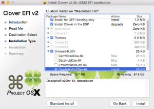

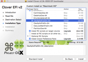

Clover v2.3k r3333 UEFI
install OsxAptioFix2Drv-64 in Driver64UEFI
Motherboard:
GA-B75M-D3H, F12 BIOS
BIOS set to boot UEFI only, HD mode to AHCI, internal graphics memory 64MB
HD 2TB HD GPT dual boot OSX El Capitan 10.11.3/Win10_X64 UEFI with Clover v2.3k_r3333
CPU: Intel I3 3225 3.3GHz
RAM: 8GB (4GBx2 Kingston DDR3 1600 MHz)
Audio: On board Realtek ALC 887 sound ---> Clover/kext patched Realtek ALC by @toleda/pikeralpha
Graphics:  Intel HD 4000 (ID injected with Clover)
LAN: Onboard Realtek GbE LAN--->Mieze's RealtekRTL8111.kext v1.1.3
Mac Model: MacMini 6,2

REVISION:  Clover 2482  :)

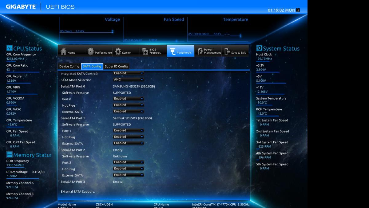

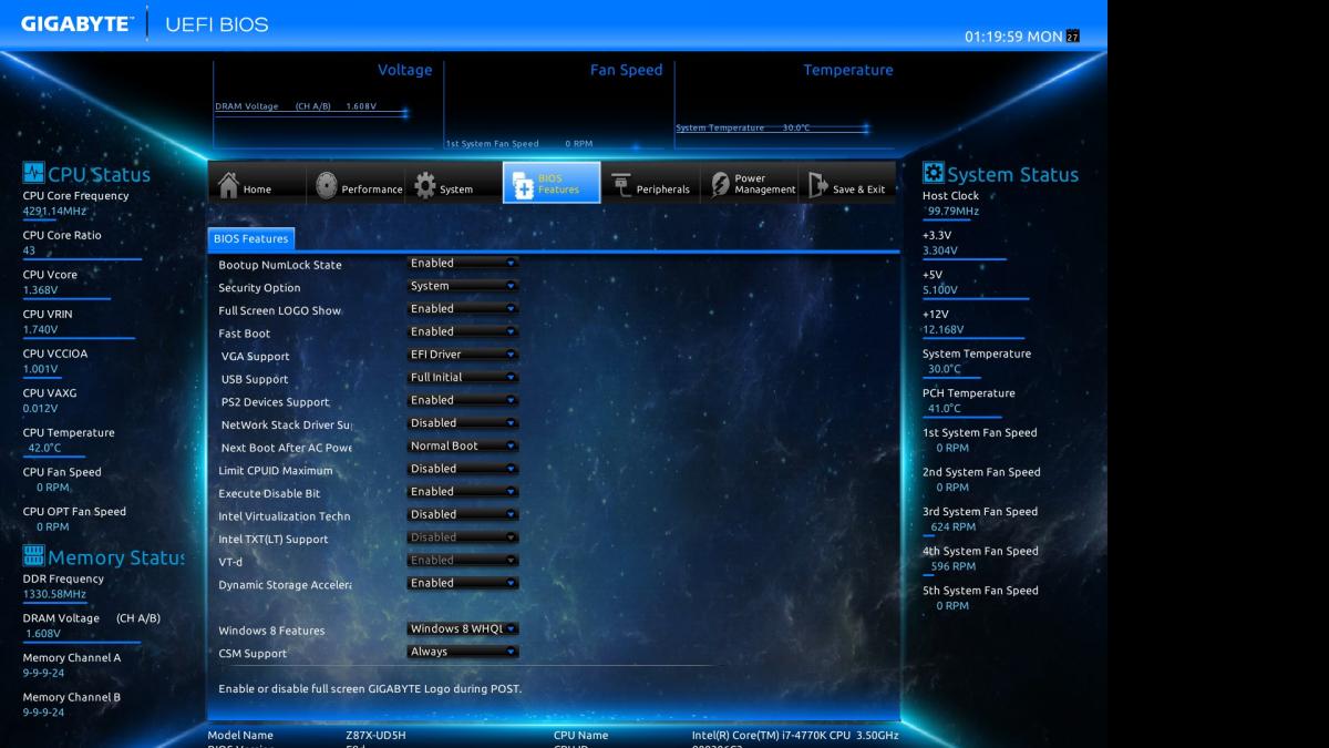

MODE:Only UEFI
Motherboard: GA Z87X-UD5H
CPU: i7 4770k
RAM: 16 GB Vendor: Corsairre Vengences Pro séries 1600 Mhz
SSD: 120gig Kingston
Audio OnBoard: YES : ALC898xx with Clover layout injector and patched with Clover shutdown script
Graphics card1: Nvidia GTX 760 - Clover
Graphics card2: Onboard Intel HD 4600- Desable
Mac Model: iMac 14.2
OS X 10.9.1
config.plist -->

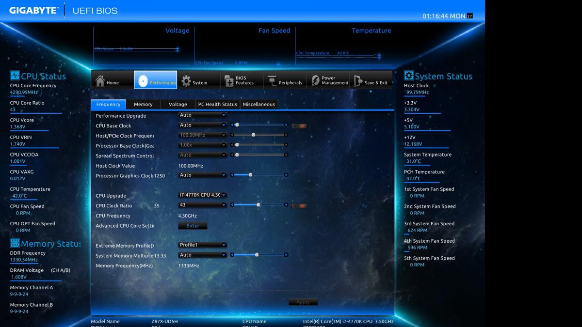

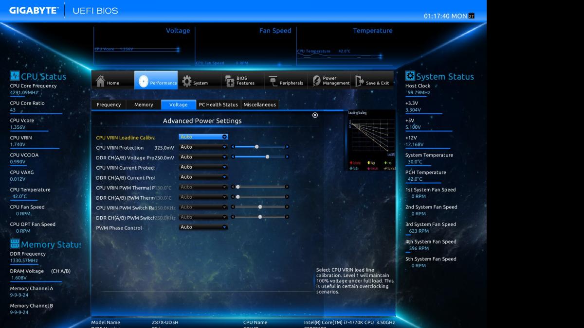

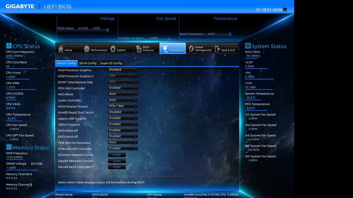

Clover revision 2525 in UEFI
Motherboard: Gigabyte GA-Z87X-UD5H Rev 1.0 Bios F8D Beta Bios
CPU: i7 4770K @3,5GHZ (4,3 GHz Turbo)
RAM: 16 GB Vendor: Corsair 1333Mhz
Audio OnBoard: YES Type: ALC898 with Clover layout injector and patched with Clover shutdown script
Graphics card1: Nvidia GTX 650 Ti OC 2GB activaction method: via Clover Injector
Graphics card2: Onboard Intel HD 4600 activation method: Disabled.
Audio On Graphics Card1: No (never tested)
Audio On Graphics Card2: No
Mac Model: iMac14,2
config.plist --> config.plist
Patched tables: My custom DSDT + custom SSDT + script for generating xStates.
optional:
Theme used: applestyle
Links of Sources of Kext are at the Folders at ZIP-File
config.plist

Edit: added BIOS-Settings
GA-Z87X-UD5H Rev 1.0 Bios F8D.zip

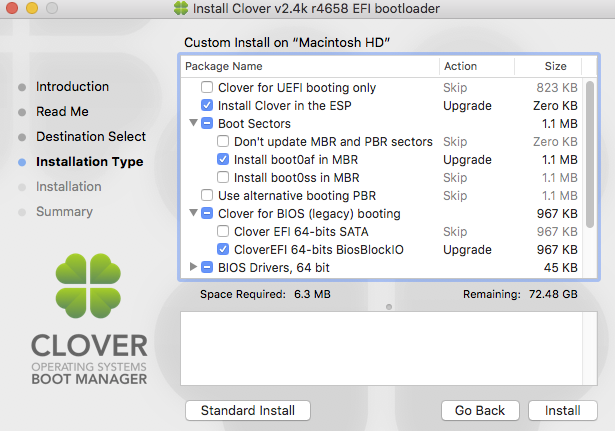

Clover v2.4k r4658 Legacy boot--->CloverEFI.
Motherboard:
Gigabyte P55a UD3 F11 BIOS
CPU: Core i5 750 2.67Ghz
RAM: 8GB (2x4GB Kingston DDR3 1333MHz)
Audio: Onboard Realtek ALC888 Lilu.kext v1.2.7AppleALC.kext v1.3.1
Graphics card: XFX ATI Radeon HD 5770 1024MB
LAN: Realtek RTL8111D using Mieze's RealtekRTL8111.kext v1.2.3
Wifi: TL-WN881ND/Atheros 9287 using Clover Airport Fix + FakeID
Mac Model:  MacPro5,1
Patched tables: Clover patched native DSDT (patches specified in config.plist.  Likely to also work with other Gigabyte socket 1156 motherboards)

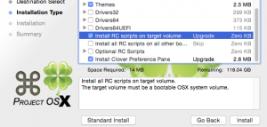

BIOS Drivers to install in EFI/CLOVER/drivers64: HFSPlus-64.efi, ApfsDriverLoader-64.efi
Check "Install RC scripts on target volume" for emulated NVRAM
FakeSMC.kext, RealtekRTL8111.kext -->put into EFI/CLOVER/kexts/Other
Press F1 at Clover Main Menu for useful keyboard shortcuts.  Link to Clover wiki.

  • 1 month later...
Clover revision 2652 in UEFI
Graphics card1: Nvidia GTX 650 Ti 2GB activaction method: via Clover Injector
Graphics card2: Onboard Intel HD 4600 activation method: Enabled. (slower booting with HD4600 enabled)
Audio On Graphics Card2: No (never tested)
Mac Model: iMac14,2
optional: GA-Z87X-UD5H Rev 1.0 Bios F8.zip
bios setting file for f8 bios
do not export a F8D beta bios setting and import to a F8 bios. it will damage the bios (press powerbutton 20 sek for biosreset)...
IGFX must be first for a working HD4600
CSM must be disabled
config.plist
