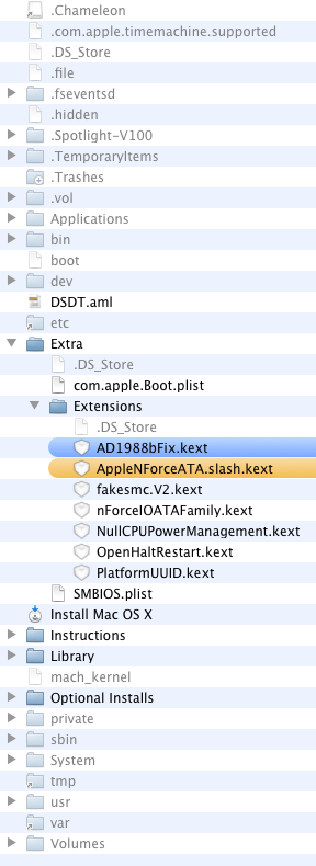

I just was happy, when I was able to reboot normally, but then I noticed that Ethernet was dead :( .
I than just tried to copied the nforcelan kext form S/L/E to E/E. Then Network was working, but again reboot failed(Even when I retried these steps from that point)
Should I delete extensions.mkext?

Suggest you try the following:
1. Remove any nForceLAN kext(s) from /E/E/ and from /S/L/E/
2. Go to /System/Library/Caches/com.apple.kext.caches/Startup/ and delete Extensions.mkext
3. Put nForceLAN.0.64.5.kext in /S/L/E/
4. Reset nForceLAN.0.64.5.kext ownership and permissions:
sudo chown -R root:wheel /System/Library/Extensions/nForceLAN.0.64.5.kext
sudo chmod -R 755 /System/Library/Extensions/nForceLAN.0.64.5.kext
sudo touch /System/Library/Extensions/
5. To ensure that the nForceLAN kext in /S/L/E/ is also included in the Extensions.mkext file in /System/Library/Caches/com.apple.kext.caches/Startup/, go to the Terminal and type:
sudo kextcache -v 1 -t -m /System/Library/Caches/com.apple.kext.caches/Startup/Extensions.mkext /System/Library/Extensions/
6. Reboot with -v
If, once you have sorted out the nForceLAN kext location(s), you are still having problems, nvenet.kext may be the problem..........in which case:
7. Put the modified IONetwokingFamily.kext that I included in my Snow_Support_Files_v2.3 in /E/E/
8. Create a symbolic link in /S/L/E/ for it
cd /Extra/Extensions/
sudo ln -s IONetwokingFamily.kext /System/Library/Extensions/
ls -l /System/Library/Extensions/
exit
9. Rename the vanilla IONetworkingFamily.kext in /S/L/E/
cd /System/Library/Extensions/
sudo mv IONetworkingFamily.kext IONetworkingFamily.kext.orig
ls -l
exit

I installed snow lepord server late last night, it was going pretty slow on a core2duo 2.4ghz with 4gb ram so i let it go for an hour and i think it either finished and restarted or auto-restarted. now i boot chamelon off the thumb drive and choose the server partition. it begins to boot and then sadly a cancel sign apears and it hangs, so via google that is a form of a kernal panic and not being able to find the root directory properly.
soo what am i doing wrong.
USB Thumb drive
Chamelon RC3 with i386flag and graphics enabler yes
USB Thumb drive
An install should take about half an hour.........here are the contents of the USB flash drive installer I use on my MOBO:
The AD1988bFix.kext and the nForceIOATAFamily.kext are not needed for the SL installation procedure.......
Try in order the following:
1. Use Chameleon RC3 alone
2. Use a simple com.apple.Boot.plist file:
<plist version="1.0">
<dict>
<key>Kernel</key>
<string>mach_kernel</string>
<key>Kernel Flags</key>
<string>-v arch=i386</string>
<key>Timeout</key>
<string>5</string>
<key>GraphicsEnabler</key>
<string>Yes</string>
</dict>
</plist>
3. Use only the following kexts in /Extra/Extensions/ with no Extensions.mkext file on the USB flash drive or on the HDD OS X volume
AppleNForceATA.slash
fakesmc.V2
NullCPUPowerManagement
OpenHaltRestart
PlatformUUID
4. PM me a download link for your DSDT.aml file
