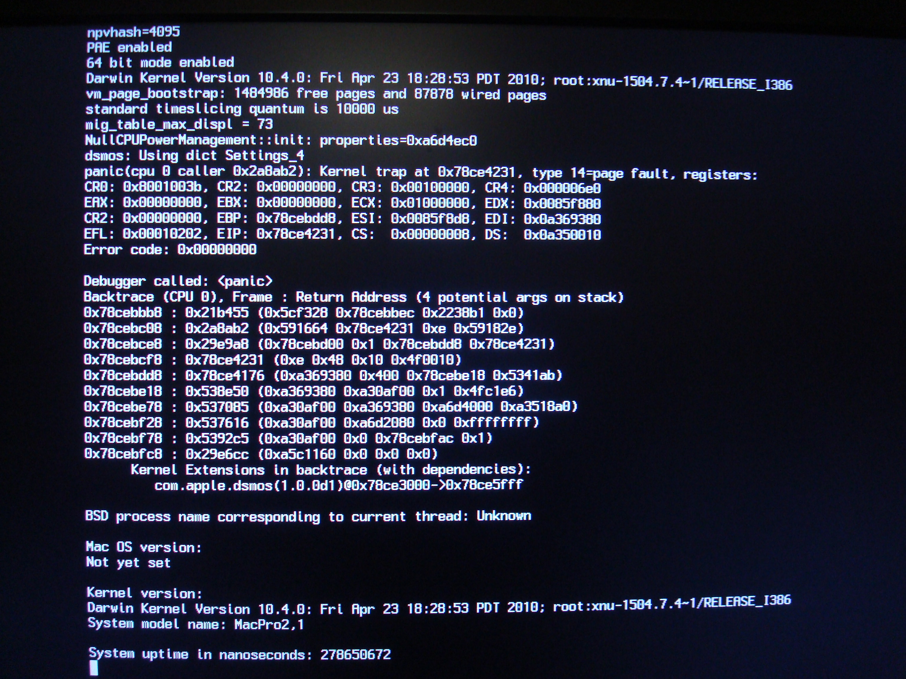

So I just did an install of Snow Leopard onto my internal HDD and strange things.
When I had installed it onto my external I got the LAN to work and the kexts to load. On the internal, I'm not sure if the kexts are loading but the LAN does not work. I can however reboot and it still does not wipe my CMOS.
If I use dsmos.kext, it will not boot. So I run without it.

1. Use fakesmc v2.5 instead of dsmos.kext anyhow.....so, in /Extra/Extensions/ you should have:
AppleNForceATA kext (slash or AnV variant)
fakesmc.V2.5.kext
NullCPUPowerManagement.kext
OpenHaltRestart.kext
PlatformUUID.kext (apparently not required if using Chameleon 2.0 RC4)
and if appropriate/desired
nForceIOATAFamily.kext (for faster booting; see post #1, Part K)
nForceLAN.0.64.5.kext (for onboard LAN)
IONetworkingFamily.kext (for onboard LAN)
as well as whatever kext is needed for your audio to work.
2. Repair /Extra/Extensions/ ownership and permissions
sudo chown -R root:wheel /Extra/Extensions/
sudo chmod -R 755 /Extra/Extensions/
sudo touch /Extra/Extensions/
An Extensions.mkext file is IMHO not really necessary for such a small number of kexts........
3. Type kextstat in Terminal.......this will list the kexts loaded into the kernel........

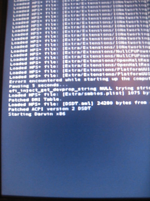

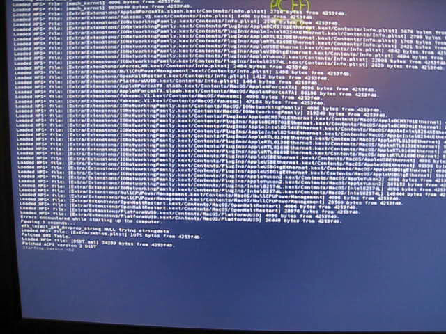

I'm running P5N-E SLI, 8800 GT with E6600 and 4gb RAM.
I have performed all steps in part D, but still cannot get to the installer using a USB stick and Snow Leopard Universal 10A432.
I am using Chameleon 2.0 RC4 with PC_EFI v10.3, patched DSDT.aml and the following kexts:
AppleNForceATA.slash
fakesmc.V1
IONetworkingFamily
nForceLAN
NULLCPUPowerManagement
OpenHaltRestart
PlatformUUID
my boot.plist is
Graphics Mode 1680x1050x32
Kernel mach_kernel
Kernel Flags arch=i386
device-properties (my EFI string)
I am getting a reboot before it starts the installer. The attached screenshot shows the error, "errors encountered while starting up the computer".
Please help!

Try in order the following:
1. Use Chameleon RC3 alone
2. Use a simple com.apple.Boot.plist file:
<plist version="1.0">
<dict>
<key>Graphics Mode</key>
<string></string>
<key>Kernel</key>
<string>mach_kernel</string>
<key>Kernel Flags</key>
<string>-v arch=i386</string>
<key>Timeout</key>
<string>5</string>
<key>device-properties</key>
<string>"Your hex graphics string"</string>
<key>Default Partition</key>
<string></string>
<key>Instant Menu</key>
<string></string>
</dict>
</plist>
3. Use only the following kexts in /Extra/Extensions/ with no Extensions.mkext file on the USB flash drive:
fakesmc.V1
OpenHaltRestart
PlatformUUID
4. PM me a download link for your DSDT.aml file

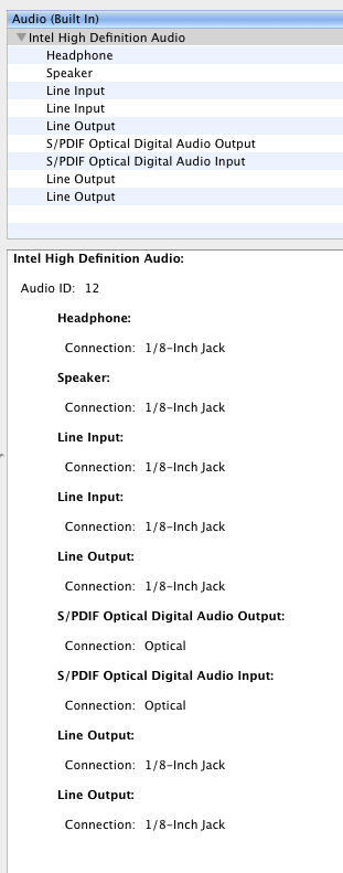

Just wondering if there is a way to get the Sub Channel Front and Rear channels working in mac. I have a logitech Z-5500 surround sound system. Its 5.1 and i have optical working but my cord is really short. And just wondering if there is a way to get the 6 channels works for 6-ch direct for my receiver.
Whilst im here i tried to update to 10.6.4 and figured it would KP right off the bat but thats cool. Im working on getting it up and running unless i should just update to 10.6.2 or 10.6.3. Anyone have some recommendations? I tried pfix'ing and moving the kexts back but no go... Anyway heres a picture of the KP.
*EDIT*
So i got it booting up 10.6.4 but im using the 10.6 kernel from the retail cd. I was guessing its just the kernel thats not wanting to work but it does. Everything seems to work tho. Still would like to run a 10.6.4 kernel tho.
Whilst im here i tried to update to 10.6.4 and figured it would KP right off the bat but thats cool. Im working on getting it up and running unless i should just update to 10.6.2 or 10.6.3. Anyone have some recommendations? I tried pfix'ing and moving the kexts back but no go... Anyway heres a picture of the KP:
According to the error message, the mach_kernel cannot be found/loaded.........download and run the OS X 10.6.4 Combo Update .dmg installer (if you have a Leopard system, or a backup Snow Leopard system, installed....) as it has worked without any issues for me (apart from having to revert to the 10.6.2 AppleHDA kext as expected, in order to restore my audio functions........see post #2)........
As for audio, the AD1988b.FIX.kext (i.e. Legacy or Info.plist-only kext) plus the DSDT audio patching described in post #2, which works for my Asus SupremeFX sound card (which has the AD1988b chipset/codec), gives for Audio (Built In) under System Profiler in 10.6.4 and working audio:
but I do know if this information is any help to you, or if further mods to your DSDT.aml and Legacy Audio kext in /E/E/ will be required to achieve direct 6-channel audio functionality, as I only require 2 channel audio........
@ SilverSix311
Just re-run the OS X 10.6.4 Combo Update .dmg installer..........hopefully, you will then be running as I am:
System Version: Mac OS X 10.6.4 (10F569)
Kernel Version: Darwin 10.4.0

@Verdant - So i got the kernel you sent me but its doing the same thing as the last one. It wont boot from it for whatever reason. Keeps giving me the same errors... And now that i have been running 10.6.4 with the 10.6 kernel ive noticed that my network sharing things have been acting up... My sharescreen doesnt work and half the time my 680i wont show up on the network to be connected to. We have 1 macbook and 2 MBP's and my hackintosh here. Any ideas?
Try repairing the kernel ownership and permissions
sudo chown -R root:wheel /mach_kernel
sudo chmod -R 644 /mach_kernel
and the repair the system using Disk Utility......
