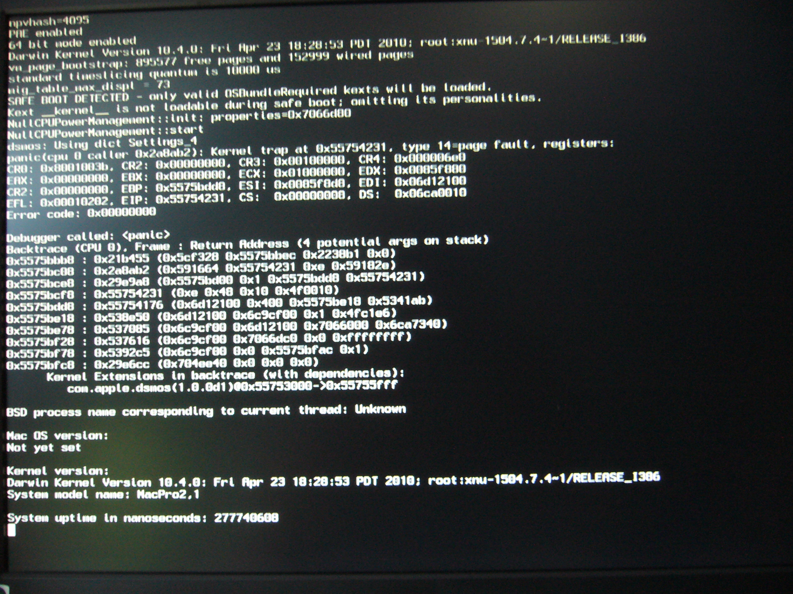

So i tried doin the terminal commands and it didnt work. Still getting the panic, am i supposed to rename any kexts or move them after i install the update?
What kexts have you moved/renamed from/where?
The Combo Update should only replace earlier version kernel and vanilla kexts......you could try booting in Safe Mode and then re-running the Combo Update, followed by Disk Utility Repair Permissions (ideally by booting up from the Retail Mac OS X Install DVD if you are set up to do that)........if still no joy, then you may well end up needing to reinstall as a clean system.......
@Verdant Well basically all i did was install the combo update straight from the software update built in mac, then before it restarted i reinstalled the kexts from your snowleopard 2.3 zip, then i booted up with "arch=i386 -v" and i got a kernel panic before it tried to do anything. The one i have a picture for in an earlier post. Then i reinstalled the kernel from 10.6 and it works fine. I then tried putting your 10.6.4 kernel and i tried your chmod junk to fix permissions, and then i tried fixing permissions and nothin worked. No matter what i get a KP right when i try to boot. Starbuxx seems to be in the same boat so i might try it without nForceLan.kext. If you have google-talk hit me up SilverSix311.

Hey Verdant, I'm back with a question. I was frustrated with osx kept freezing on me so I went back to Windows for awhile, and I discovered that your snow support files is on v2.3(I have the v2.2). In there, I saw AppleNForceATA.64AnV.kext and so glad to try that. To my surprise, it was pretty stable. But the bad thing about it is I can't seem to restart or shutdown. I would need to manually press the reset button. Also, start up takes twice as long, from power-up to usable. Do you know what's going on?
Try repairing /E/E/ ownership and permissions:
sudo chown -R root:wheel /Extra/Extensions/
sudo chmod -R 755 /Extra/Extensions/
sudo touch /Extra/Extensions/
and use Disk Utility to repair system permissions....

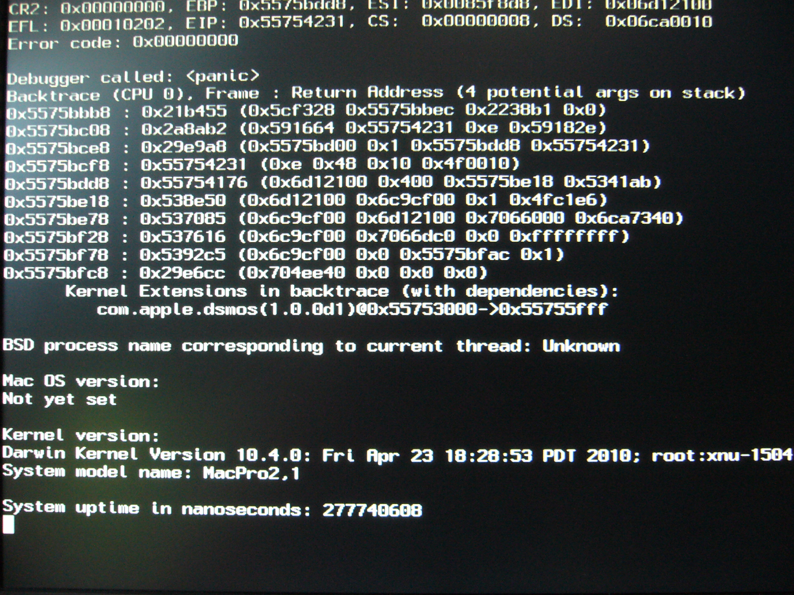

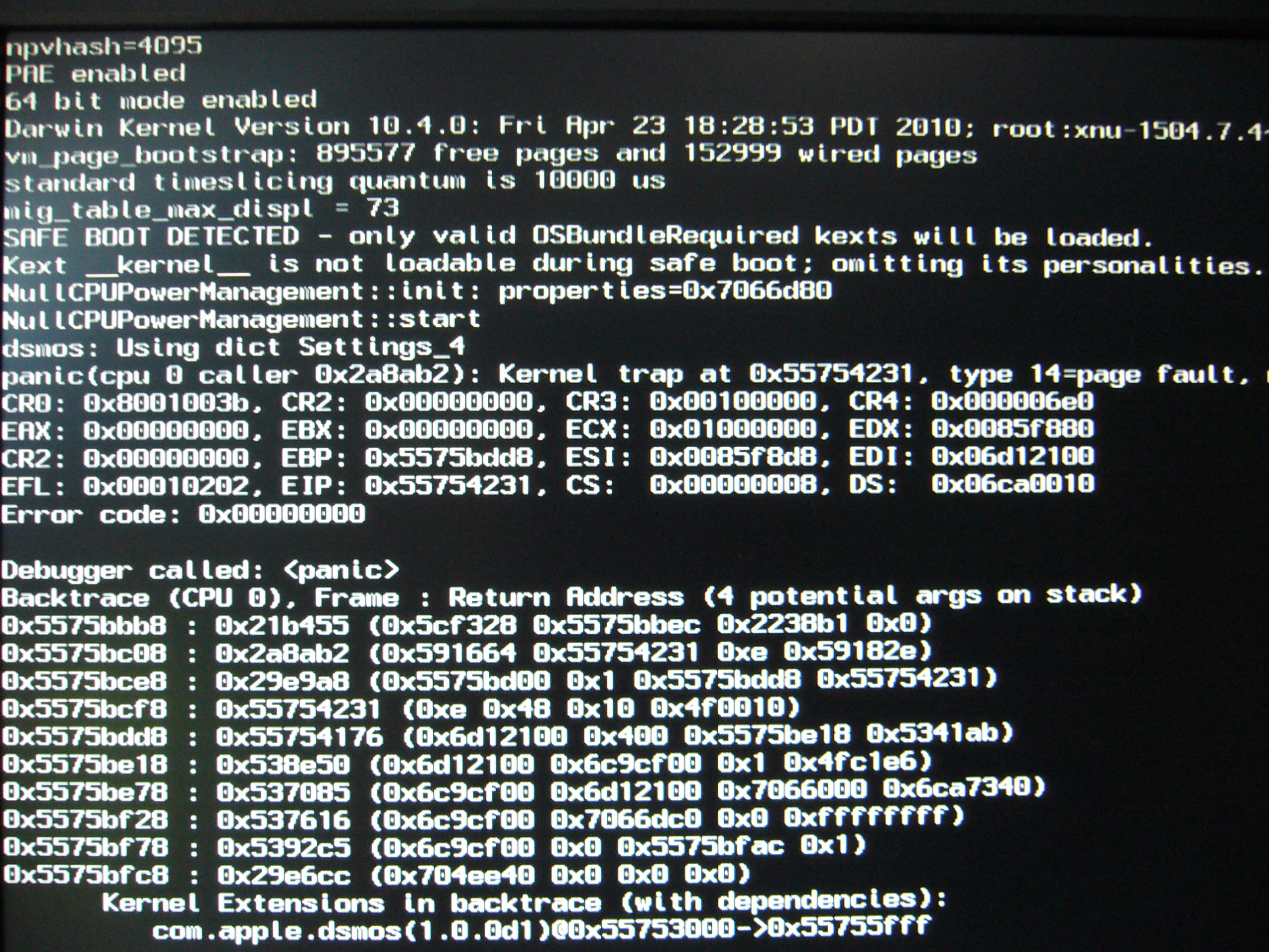

Yes Sir, I used the Combo Update, whats wrong now? :(
Post a screen shot of the KP you now see.........I assume you cannot boot SL 10.6.4 even with -v -f or -v -x or -v -x -f ?
I've tried those, didn't work. Nevermind. I'm upgrading my hardware soon, and probably won't be using this system anymore. I'm thinking of Gigabyte MB because I've heard they are really stable. So for now, I'll just be using Windows. Thanks for your help up to now. I've learned a lot about osx86 and OSX itself!
A pity given the time you spent to get it working.........if you had a backup SL system at least one version behind the latest, you could simply use CCC or Disk utility to clone the 10.6.4 volume back to 10.6.3 or 10.6.2 etc.......

Thank you for the steps, I will try it out. The Panic Screen, is the same as if permissions are not repaired (I did this, I also tried some tools). One thing i didnt tried for example is to repair permissions for mach_kernel.(So I will try :D ).
So What is with that nforceLAN thing, where I cant reboot, is that a known issue? Do I have an alternative?
Thank you Verdant, for this powerfull support!
Thank you for the steps, I will try it out. The Panic Screen, is the same as if permissions are not repaired (I did this, I also tried some tools). One thing i didnt tried for example is to repair permissions for mach_kernel.(So I will try ;) ).

Okay this is what I get, booting with -x -v (Camera is old, quality maybe bad):
It appears that you have the dsmos.kext installed somewhere.........
In /Extra/Extensions/, together with:
AppleNForceATA.slash (or the AnV variant or other AppleNForceATA kext; see post #1)
OpenHaltRestart
PlatformUUID (not necessary with Chameleon 2.0 RC4 installed)
and optionally:
nForceIOATAFamily.kext (for faster booting; see post #1, Part K)
IONetworkingFamily.kext (for onboard LAN problems with nvenet.kext; see post #1)
as well as whatever kext is needed for your audio to work, you should have:
EITHER fakesmc.kext (v1 or v2) and NullCPUPowerManagement.kext (preferred option)
OR netkas' Snow Leopard dsmos.kext and Kabyl's Leopard Disabler.kext (only if preferred option results in kernel panics)
NOT both or a mix of both...........
