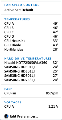

10. Sensor Monitoring via FakeSMC (CPU/MOBO temperatures and fan speeds)I have now tried and successfully got Sensor Monitoring via Slice et al.'s modifed netkas FakeSMC in conjunction with iStat Menus (or in my humble opinion less usefully with iStat Pro)...........see PART K. Developers/Contributors Corner, Item 5.

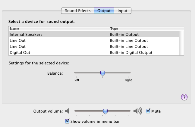

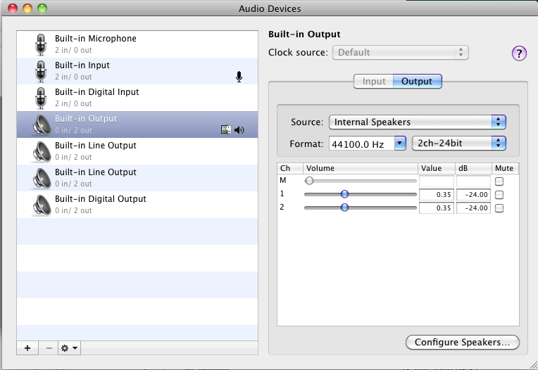

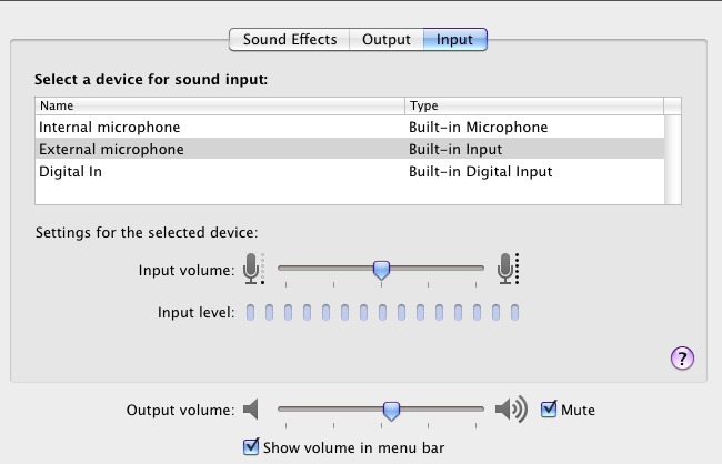

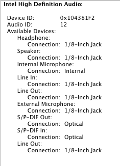

5. Audio has now been fixed for the Asus P5N32-E SLI Plus MOBO Asus SupremeFX audio card (except for Front Panel Headphones).....see post #2 in this thread......

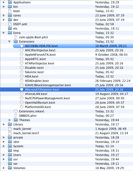

2. An original kext/modified kext/driver "Developers/Contributors Corner" has been set up in Part K (the originator/developer is acknowledged together with the contributor when the developer is known...if any reader can add such information please post the information so that the developers can be properly credited.......
1. Extensions.mkext for /Extra/Extensions/: Many forum readers are having problems with the /Extra/Extensions/ cache file, i.e. Extensions.mkext, not loading/working properly, with the result that key kexts in /Extra/Extensions/ are not being loaded into the kernel.......hence
[1] Delete the Extensions.mkext cache file from /Extra on your USB flash drive OS X Installer AND from /Extra on your target OS X volume.....
[2] Copy "fresh" extensions across from LATEST VERSION Snow_Support_Files (see BREAKING NEWS for links) into the /Extra/Extensions directories
AppleNForceATA.AnV or AppleNForceATA.slash
fakesmc.V2 or fakesmc.V1
NullCPUPowerManagement
OpenHaltRestart
PlatformUUID (although even different UUIDs in SMBIOS.plist and PlatformUUID Info.plist does not appear to cause any problems because according to Superhai the UUID in SMBIOS is not used for anything.....)
Note: With Chameleon 2.0 RC4 PlatformUUID.kext is not needed
If an Extensions.mkext file is not present in /Extra the kexts in /Extra/Extensions will be loaded directly......the Extensions.mkext cache file being more of a convenience than a necessity at bootup in terms of a somewhat reduced bootup time; being a cached version of all the kexts in the Extensions folder, resulting in faster loading of the extensions at boot.
OS X continues to use the Extensions.mkext file until its modified date is different from that of the Extensions folder itself; at which point, it reverts to loading them from the Extensions folder and then re-creates the Extensions.mkext file......

(5) MODIFIED ADVICE: Many forum readers are having problems with the /Extra/Extensions cache file, i.e. Extensions.mkext not loading/working properly.....henceIf in the /Extra/Extensions, you installed all the kexts included in Chameleon 2.0 RC1 or RC2 or RC3 or RC4 /Extra/Extensions,OR if you only loaded one or two kexts in order for the /Extra/Extensions/ directory to be set up by the Chameleon Installer,then delete them and from the downloaded LATEST VERSION Snow_Support_Files (see BREAKING NEWS for links)that I have conveniently compiled in one folder for myself (NOTE: ALL CREDIT goes the developers of the included applications/kexts/bootloaders and boot files etc.; David Elliott, netkas, Superhai, Psystar, eno, slashack, AnV, Dr. Hurt.....),copy across the following kexts:
ESSENTIAL
fakesmc.kext (32bit and 64bit compatible) - emulates SMC to provide the information required for the Don't Steal Mac OS X.kext to decrypt the Apple encrypted files"Choose either V2 or V1.......whichever "works" for you.......see Changelog for V2.1 onwards...."
NullCPUPowerManagement.kext (32bit and 64bit compatible) - A problem with running OS X running on non-Apple hardware (both physically and in VM) is that the AppleIntelCPUPowerManagement.kext invariably causes a kernel panic or at bootup generates endless messages regarding the HPET and links to the CPU. AFAIK the NullCPUPowerManagement.kext plays a couple of tricks with the IOKit service registration process to take over the role of the AppleIntelCPUPowerManagement.kext, essentially disabling it. Also it deals with heat issues.....
OpenHaltRestart.kext (32bit and 64bit compatible) - fixes reboot and shutdown on PC-based machines without binary patching or recompiling the kernel
LESS ESSENTIAL
PlatformUUID.kext (32bit and 64bit compatible) - Fixes some Time Machine related errors by providing a UUID from bootup (fixes UUID 35 errors)
Note: With Chameleon 2.0 RC4 this kext is not needed
ESSENTIAL FOR nForce Chipset MOBOs
AppleNForceATA.kext (32bit only kext proven to work at present - slashack's v0.1 kext or AnV's kext) - but see BREAKING NEWS
OPTIONAL FOR nForce Chipset MOBOs
Modified IONetworkingFamily.kext (from Snow Leopard but with nvenet.kext in Plugins renamed) - found in LATEST VERSION Snow_Support_Files (see BREAKING NEWS for links)
IF YOU ARE USING THE ONBOARD LAN (Enabled in BIOS), then install the nForceLAN.kext (64bit - eno's kext) in /System/Library/Extensions/
Other kexts (32bit or 32/64bit or 64bit) if/when available may be used and/or essential if they work on nForce chipset + Intel multicore CPU MOBOs with OS X 10.6......e.g. for enabling sleep, audio, graphics etc......
(6) Drag and drop your previously modded and saved DSDT.aml file into the / directory
(7) Use TextEdit, Property List Editor, TextMate or your favourite .plist file text editor to modify the SMBIOS.plist template included in the LATEST VERSION Snow_Support_Files (see BREAKING NEWS for links), to suit your system hardware/RAM etc.......
A further modification is to insert your OSX_10.6_USB_Installer volume UUID number under/against SMUUID......and save the modified SMBIOS.plist (renamed from SMBIOS_MacPro21.plist if you are using this file, i.e. only if you wish to rename it.....) and put it in /Extra
(8) Then go to PlatformUUID.kext, and Show Package Contents and select Contents, and then select Info.plist.....use TextEdit, Property List Editor, TextMate or your favourite .plist file text editor to modify the Info.plist and go to IOKitPersonalitiesand select PlatformUUID and insert your OSX_10.6_USB_Installer volume UUID number under/against PlatformUUID and save the modified Info.plist file
(9) MODIFIED ADVICE: Many forum readers are having problems with the /Extra/Extensions cache file, i.e. Extensions.mkext not loading/working properly.....hence

Advice:
1. Delete the Extensions.mkext cache file from /Extra on your USB flash drive OS X Installer AND from /Extra on your target OS X volume.....
2. Copy "fresh" extensions across from LATEST VERSION Snow_Support_Files (see BREAKING NEWS for links) into the /Extra/Extensions directories
OpenHaltRestart
In Leopard (BUT NOT Snow Leopard at present AFAIK) booting with -f forces the kexts to be loaded from the Extensions folder at bootup and then recreates the Extensions.mkext file....
However, you can use the Terminal to recreate the Extensions.mkext file for /Extra/Extensions/
sudo kextcache -v 1 -t -m /Extra/Extensions.mkext /Extra/Extensions/

(6) MODIFIED ADVICE: Many forum readers are having problems with the /Extra/Extensions cache file, i.e. Extensions.mkext not loading/working properly.....hence
If in the /Extra/Extensions directory, you installed all the kexts included in Chameleon 2.0 RC1 or RC2 or RC3 or RC4 /Extra/Extensions,
OR if you only loaded one or two kexts in order for the /Extra/Extensions directory to be set up by the Chameleon Installer, then delete them and from the downloaded LATEST VERSION Snow_Support_Files (see BREAKING NEWS for links), that I have conveniently compiled in one folder for myself (NOTE: ALL CREDIT goes the developers of the included applications/kexts/bootloaders and boot files etc.; David Elliott, netkas, Superhai, Psystar, eno, slashack, AnV, Dr. Hurt.....), copy across the following kexts:
ESSENTIAL
LESS ESSENTIAL
Modified IONetworkingFamily.kext (from Snow Leopard but with nvenet.kext in Plugins renamed) - found in Snow_Support_Files_v2.4
(7) Drag and drop your previously modded and saved DSDT.aml file into the / directory
(8) Use TextEdit, Property List Editor, TextMate or your favourite .plist file text editor to modify the SMBIOS.plist template included in the LATEST VERSION Snow_Support_Files (see BREAKING NEWS for links), to suit your system hardware/RAM etc.......
A further modification is to insert your OSX_10.6_GPT_A volume UUID number under/against SMUUID......and save the modified SMBIOS.plist (renamed from SMBIOS_MacPro21.plist if you are using this file, i.e. only if you wish to rename it.....) and put it in /Extra
(9) Then go to PlatformUUID.kext, and select Show Package Contents and then Contents, and then Info.plist.....use TextEdit, Property List Editor, TextMate or your favourite .plist file text editor to modify the Info.plist and go to IOKitPersonalities and select PlatformUUID and insert your OSX_10.6_GPT_A volume UUID number under/against PlatformUUID and save the modified Info.plist file
(10) MODIFIED ADVICE: Many forum readers are having problems with the /Extra/Extensions cache file, i.e. Extensions.mkext not loading/working properly.....henceIf you get a kernel panic during booting as follows:

(12) Now save the modified com.apple.Boot.plist and put it in /Extra....The folders/files present (including normally hidden ."name" files) prior to installing OS X 10.6 are:PreOSX_Folders.png ( 27.76K )
A further modification is to insert your OSX_10.6_GPT_A volume UUID number under/against SMUUID......and save the modified SMBIOS.plist and put it in /Extra
(9) Then go to PlatformUUID.kext, and select Show Package Contents and then Contents and then Info.plist.....use TextEdit, Property List Editor, TextMate or your favourite .plist file text editor to modify the Info.plist and go to IOKitPersonalities and select PlatformUUID and insert your OSX_10.6_GPT_A volume UUID number under/against PlatformUUID and save the modified Info.plist file
Kernel Extensions in backtrace (with dependencies):com.apple.driver.AppleIntelCPUPowerManagement) and then some random numbers and letters or with references to HPET not being assigned to the CPU etc.
BSD process name corresponding to current thread: kernel_task
this indicates that for some reason NullCPUPowerManagement.kext is not taking over from the AppleIntelCPUPowerManagement.kext, as it should be, by being loaded into the kernel before the AppleIntelCPUPowerManagement.kext residing in /System/Library/Extensions and cached in the Extensions.mkext file in the /System/Library/Caches/com.apple.kext.caches/Startup/directory......
This is because the Kext Utility.app did not build the the Extensions.mkext cache file pathway to NullCPUPowerManagement.kext in /Extra/Extensions properly properly (although it is probably setting the kext permissions correctly which is important).....so that NullCPUPowerManagement.kext is not being loaded into the kernel from Extenstions.mkext.....
Advice:
2. Copy "fresh" extensions across from LATEST VERSION Snow_Support_Files (see BREAKING NEWS for links) into the /Extra Directories
OpenHaltRestart
In Leopard (BUT NOT Snow Leopard at present) booting with -f forces the kexts to be loaded from the Extensions folder at bootup and then recreates the Extensions.mkext file....
(11) Use TextEdit, Property List Editor, TextMate or your favourite .plist file text editor to modify the com.apple.Boot.plist 32bit template included in the Snow Support Files to:A. Boot the kernel into 32bit mode by entering either the arch=i386 kernel flag with the Chameleon 2.0 RC3 boot file installed OR the -x32 kernel flag with the PC_EFI v10.1 boot file installed under/against Kernel Flags in com.apple.Boot.plistB. Provide graphics functionality for your PCI-E graphics card place the graphics string for your graphics card under/against device-properties in com.apple.Boot.plist

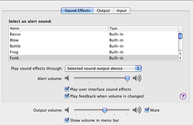

4. Audio has now been fixed for the Asus P5N32E SLI Plus MOBO Asus SupremeFX audio card (except for Front Panel Headphones).....see post #2 in this thread......

4. In your Leopard volume, you will now have an /Extra directory, containing an Extensions folder (containing Disabler.kext.....?) and a Themes folder (as usual when installing the Chameleon bootloader.....)
5. Now into the /Extra directory on your Leopard volume, add a new folder named 10.6
6. Inside 10.6 add a folder named Extra, and inside this folder add a folder named Extensions
7. Inside /Extra/10.6/Extra/Extensions, place copies of the kexts from the /Extra/Extensions folder on your SL volume
8. Inside /Extra on your Leopard volume, place a copy of the com.apple.boot.plist from the /Extra directory on your SL volume, which should contain the graphics EFI string for your video card to enable full functioning with hardware acceleration, multiple resolutions and resolution switching etc. in SL.......
Note: When booting into Leopard, the com.apple.Boot.plist file in Library/Preferences/SystemConfiguration is loaded over this com.apple.Boot.plist......this is my guess......
You should now have something similar to this (although you may have additional kexts as required for your MOBO....):10.6_in_Extra.png ( 25.54K )

I have installed iStat Menus 3.03 on a 14 day trial and now see:
as the iStat Pro 4.92 Desktop widget does not show all 4 core temperatures........I entered 'CPU Fan' for the FakeSMCSuperIO.kext Info.plist 'Name' for Fan0.

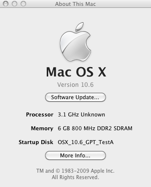

3. About This Mac CPU Speed reporting a CPU speed of 3.0GHz as 3.1GHz
Update 2:
For some as yet unfathomed reason, the issue of mis-reporting disappears when the CPU speed is raised to 3.20GHz in BIOS.........a CPU speed of 3.20GHz in BIOS is then reported as 3.20 GHz in System Profiler and 3.2GHz for the About This Mac CPU Speed...... :huh:
Thus, it is no longer necessary to put superhai's SMBIOSResolver.kext in /Extra/Extensions....... :)
I have again checked the CPU frequency reporting using both sysctl hw.cpufrequency and system_profiler SPHardwareDataType | grep Speed, and obtain the following outputs:
hw.cpufrequency: 3204000000
sysctl hw.cpufrequency_max
hw.cpufrequency_max: 3204000000
sysctl hw.cpufrequency_min
hw.cpufrequency_min: 3204000000
Processor Speed: 3.20 GHz
Bus Speed: 1.42 GHz
CPU-Z reports the CPU speed as 3201.7 MHz
Update 1:
Issue resolved by including superhai's SMBIOSResolver.kext in /Extra/Extensions but its Info.plist was edited by myself to match my SMBIOS.plist data for my RAM and a MacPro3,1 data rather than iMac9,1 data......a CPU speed of 3.0GHz in BIOS is then reported as 3.00 GHz in System Profiler and 3GHz for the About This Mac CPU Speed...... :)

2. AUDIO is now FIXED (except for Front Panel Headphones)......ONLY SLEEP remains to be sorted......
Audio Fix:
This requires the use of the AD1988B.Fix.kext, which is a pseudo-kernel extension i.e. a pseudo-kext (as it contains only an Info.plist file) via lancelotu from XyZ, that needs two DSDT patches.....
This kext is available as a 64bit kext and as a 32bit kext (at least I think so.......and may also not give as high a microphone signal?.......since it was classed as obsolete by lancelotu .....anyhow, this is the one I have used first......both work.........but I will be testing and comparing both when I have more time.....)
They are here.......whichever AD1988B.Fix.kext is chosen, it should be placed in /Extra/Extensions.........
Together these two "devices", i.e. the pseudo-kext (i.e. legacy kext or plist kext) and the DSDT patching, enable sound from the Asus SupremeFX audio card (with the AD1988B chipset) in Snow Leopard.....except for the Front Panel Headphones......
In his post lancelotu says that "Note that this has no front panel headphones working (trying to figure that out) but at least microphone is working great now"......meaning the AD1988b.Fix.kext......hence, I do appear to have front mic but no Front Panel Headphones with Front Panel Audio set to HD Audio in BIOS......with no apparent change when switching to Legacy AC97.....
However, rather than the DSDT patches from lancelotu, which I believe may be specific for the Asus P5K series MOBOs.....see here, I have used THe KiNG's generic audio DSDT patches which should work for all audio codecs.......
On my Asus P5N32E SLI Plus MOBO DSDT, the audio device is on _ADR, 0x000F0001, so find the Name (_ADR, 0x000F0001) and change Device (AZAD) to Device (HDEF).......BUT KEEP the line Name (_ADR, 0x000F0001) in the DSDT...
If the device is not present it must be added......according to THe KiNG, in most other cases the audio device is apparently in DSDT on _ADR 0x001B0000 and the device is often named Device (AZAL)......or Device (AZA). Remember to replace XXXX where XXXX is AZA, AZAL, or AZAD with HDEF in "Notify (\_SB.PCI0.XXXX, 0x02)" to give "Notify (\_SB.PCI0.HDEF, 0x02)"

I had to force compile the dsdt.dsl file to generate the dsdt.aml file, which I then renamed to DSDT.aml......
I guess there are some layout/syntax errors in the patching; BUT if the compiling goes wrong, it does not always mean the patching is incorrect.......some OEMs just ship a poorly written DSDT in their BIOS......
But as you can force the dsdt.dsl file to compile, even if there are errors, using fassl's DSDT Patcher : /path/to/DSDT\ Patcher -f dsdt.dsl
To show that audio is now working (except for Front Panel Headphones), see:

1. My OS X 10.6.3 system installed using a USB flash drive Mac OS X DVD Installer onto a GPT/HFS+ volume on a portable 2.5" USB2.0 External HDD enclosure.......or
2. My OS X 10.6.3 system cloned from the portable 2.5" USB2.0 External IDE HDD enclosure onto a MBR/HFS+ volume on an eSATA/USB 2.0 External SATA HDD enclosure......
3. My OS X 10.6.3 system installed using my nForceSLBoot132DVD onto a GPT/HFS+ volume on a USB 2.0/eSATA External SATA HDD enclosure......
Auto updated to 10.6.1 and then installed optional packages direct from Retail OS X Install DVD without any problems........then using the standalone Combo Updaters, I updated to 10.6.2 and now to 10.6.3 without any problems......
All my SL systems are using the vanilla kernel and 32bit mode via arch=i386 Kernel Flag in com.apple.Boot.plist......with my Netgear GA311 PCI NIC (Realtek RTL8169S chipset) working OTB giving me instant internet/network access.....
Time Machine works.....as did Migration Assistant, transferring all my Applications, User settings and files/documents etc. across from my Leopard 10.5.6 system on my OS_X_Backup volume (MBR/HFS+)..... :)
Sleep is not working properly......display goes black......but PC fans stay on and display cannot be woken up.......needs investigating....... :(
-x32
I assumed it loaded 32bit by default but will try with -x32.....thanks.... :huh:
UPDATE: Same result attempting to run with mach_kernel.....and mach_kernel.test7....... :(
I will repair permissions on kexts and generate a new Extensions.mkext......
UPDATE: Same result attempting to run with mach_kernel..... :thumbsup_anim:

AppleRTC is a recent addition......I did not have it in originally.....just put it in case I had a cmos reset when trying without the modded DSDT.aml.....I will be removing it again....and trying with only nullcpupm, openhalt, applenforce, uuid and fakesmc....
AFAIK PCI_EFI v10.2 Beta has only been tested on Intel chipset MOBOs.....?
Yes I am using a graphics string in my com.apple.Boot.plist in /Extra......
I am using a USB GPT partitioned HDD with Chamelon 2.0 RC1 + PCI_EFI v10.1 boot file, onto which I installed OS X......
