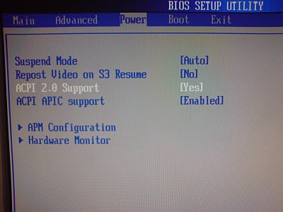

Try enabling all CPU features in the BIOS - except CPU ID limit. And enable ACPI 2.0 as well.
I think it would be a good idea to redump the DSDT after doing that, then copy your modifications over to it.

1. How do you enable ACPI 2.0 in the bios ..gigabyte boards (P35 DS3R)
It should be somewhere under Power Management settings.

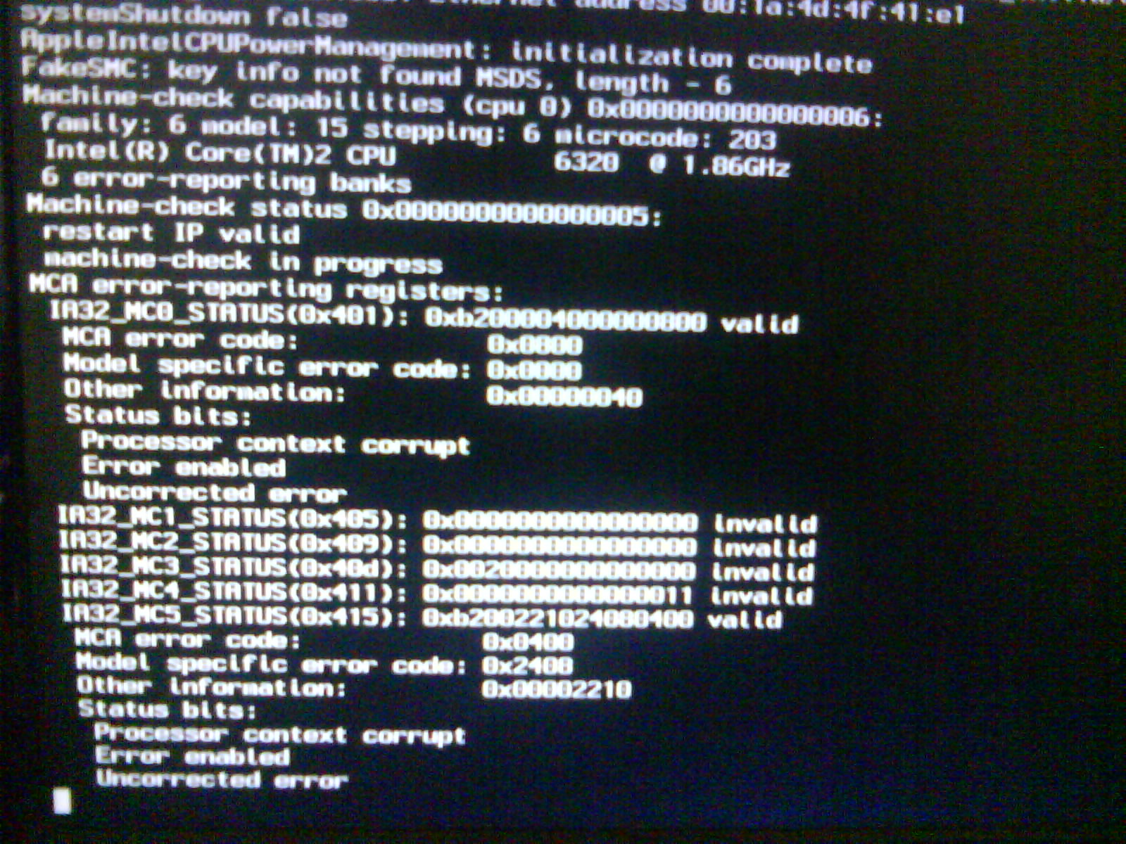

Uncorrected CPU error
Me and a friend are working on this..and seem to be doing most of it rigt, but this "uncorrected error" is driving me nuts.
Any pointers?

OKAAAAAAAAYYYYYYY!!!!!!!!!!!!! To all the above Tension and Panicking! Pun unintended!
Finally I solved the troublesome mystery, Dear Dh.Taran and Beerkex'd!
dh.taran, I faced the same issue today, when I tried to push my CPU beyond! WaaaaaaY!!! Beyond limits. The digi-cam photograph that you have posted,
Same error I too faced right now before posting this. I tried and tried and confirmed with multiple DSDT Edits in SStep and Disabled SpeedStep... Disabling C1E and ThermalMonitoring in the BIOS,...............EVERYTHING!
It so happens that with either of the DSDT edits, If you OVERCLOCK Beyond the capacity of your motherboard,
and the CPU, even with enough cooling (which I do have- check my sig - but supposedly you don't), yet .....
The Snow Leopard Kernel will Panic Out like a Hyperventilating Schizophrenic!
When I reset the BIOS back to my previously acceptable OverClocking values, it booted just fine. <- see my sig!
Hope this may help us all (who overclock) in editing the DSDT or tweaking the mobo to get the max performance out of it, without causing Snow to Panic every 1658794311 seconds! <- just a random figure :D:)
I suggest either of you take up the uphill task of verifying what I just experienced,
or dh.taran you refrain from overclocking your 1.8GHz C2D to 3.01 Ghz!
Dear Dude! That's like almost 50% OverClocking!
Lastly, This just proves that your DSDT, which I had edited was perfectly fine, man! It's a hardware issue!
Regards,
Freaky Chokra :)
