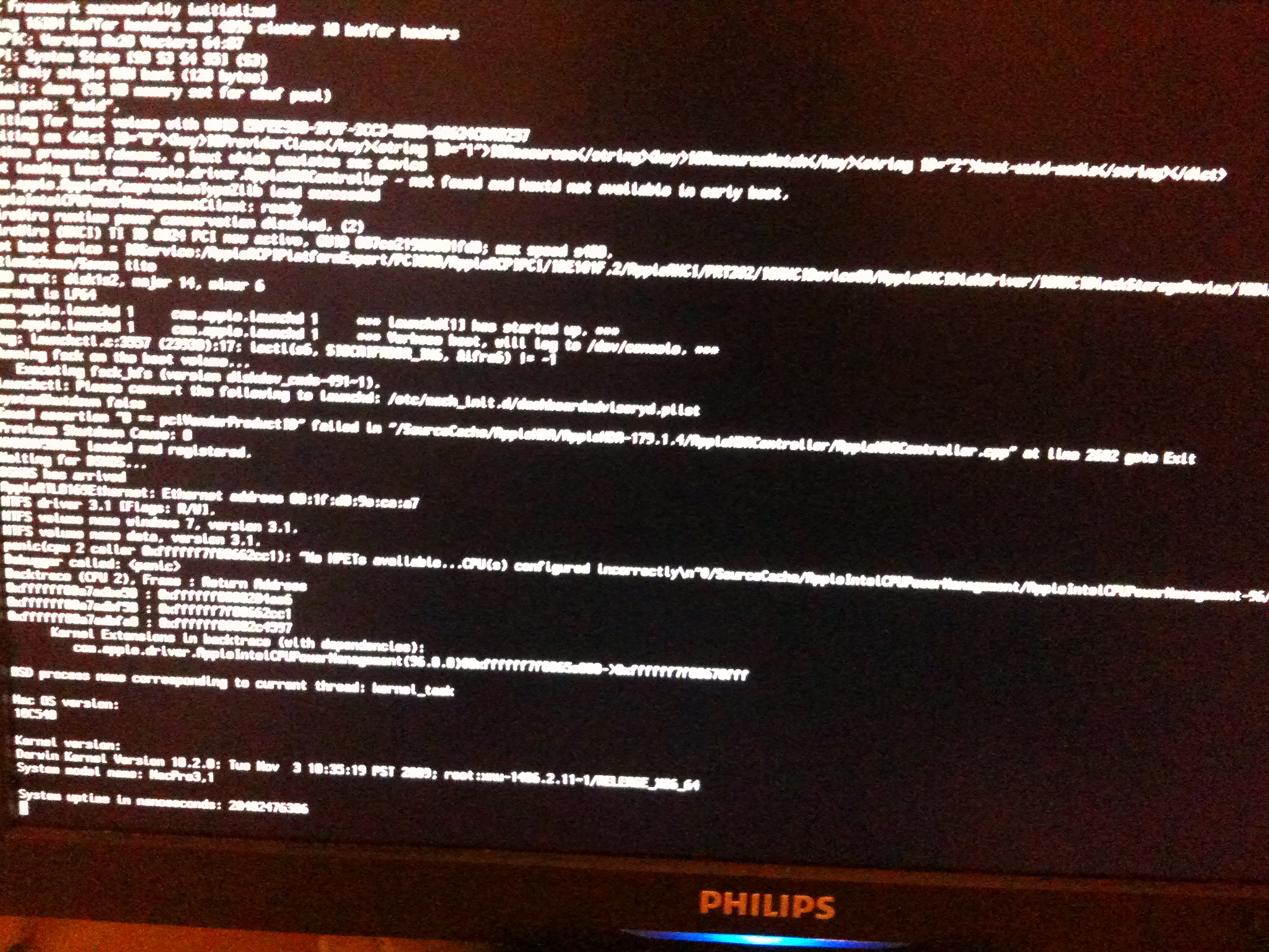

After I entered the generic scope I got a Kernel panic for hpet missing.
Attaching dsdtnospeedstep and dsdtwithit.
dsdts.zip
[Edit] Maybe I found the error in the check regarding OSFX:
My dsdt
                              Device (HPET)
                   Name (_HID, EisaId ("PNP0103"))
                   Name (ATT3, ResourceTemplate ()
                       IRQNoFlags ()
                           {0}
                       IRQNoFlags ()
                           {8}
                       Memory32Fixed (ReadWrite,
                           0xFED00000,         // Address Base
                           0x00000400,         // Address Length
                   Name (ATT4, ResourceTemplate ()
                   Method (_STA, 0, NotSerialized)
                       If (LGreaterEqual (OSFX, 0x03))
                           If (HPTF)
                               Return (0x0F)
                           Else
                               Return (Zero)
                       Else
                           Return (Zero)
                   Method (_CRS, 0, NotSerialized)
                           If (HPTF)
                               Return (ATT3)
                           Else
                               Return (ATT4)
                       Else
                           Return (ATT4)
Your dsdt:
               Device (HPET)
                       IRQNoFlags ()
                           {0}
                       IRQNoFlags ()
                           {8}
                       Return (0x0F)
                       Return (ATT3)
Changed the code removing the check for OSFX and no kernel panic :D
FormerlyKnownAs you are my new hero. :)
